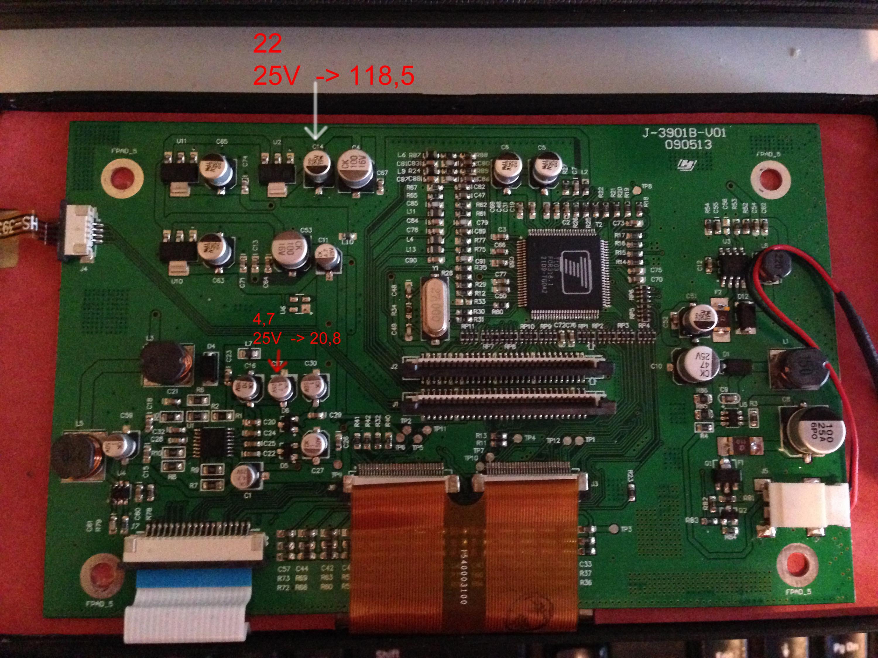

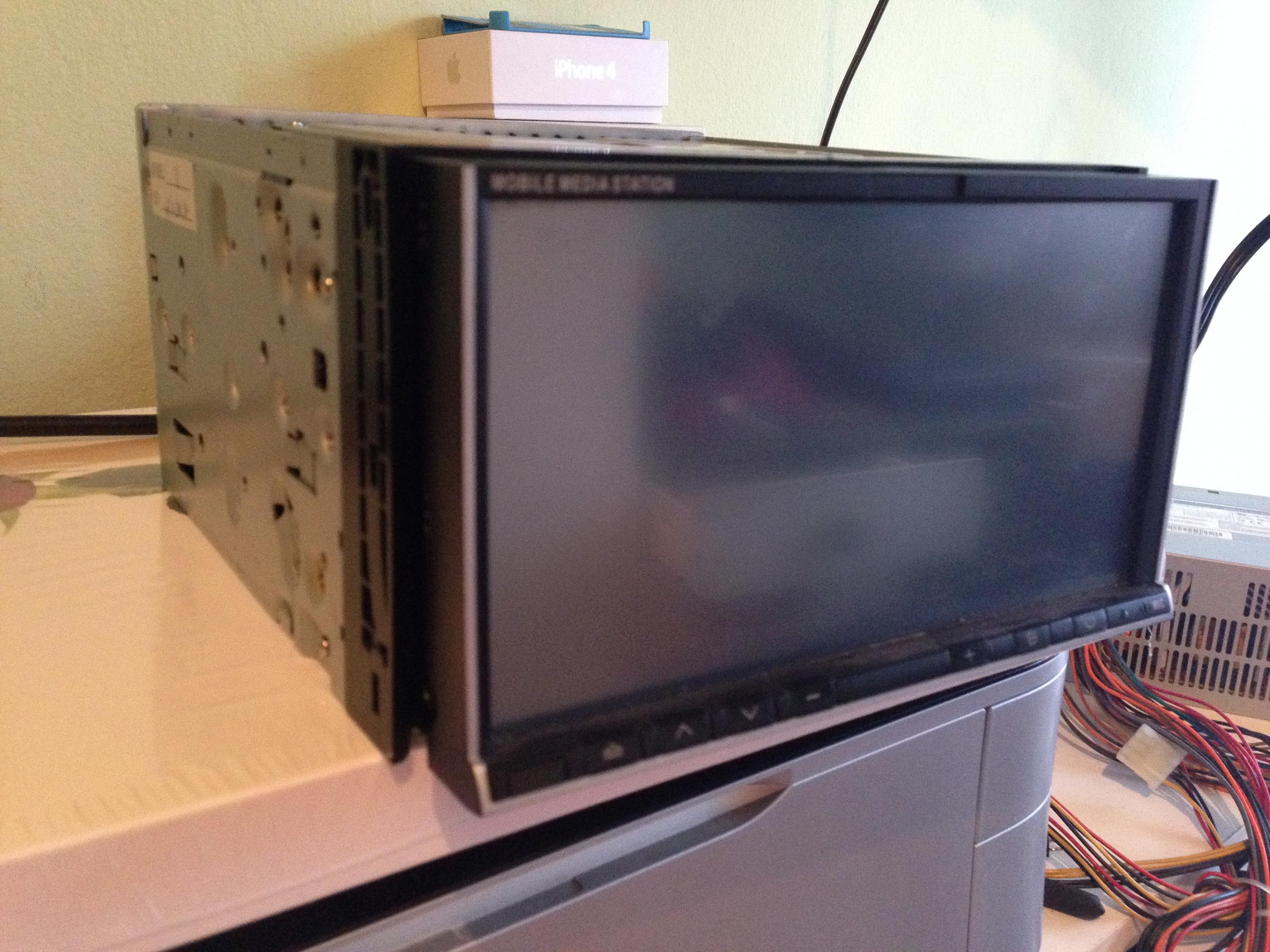

    I have this china no name car radio, touch screen 7''.
    I have no picture on it, only buttons have light, screen are black. I open it and i meassured caps so 2 of them have strange values, migth this is the problem?
    100uF-97uF
    47uF-43,7uF
    22uF-20,9uF
    22uF-21,7uF
    100uF-118,3uF
    22uF-118,5uF
    22uF-22,3uF
    1uF-1,1uF
    4,7uF-20,1uF

        The capacitance measurements are fine. C4 and C14 are in parallel, so you should see around 122uF. Also, C16, C17, C20, and C24 appear to be in parallel. You're measuring the combined capacitance of all those caps.

                      I don't know how is this receiver, but since the display is moving, it may be a broken ribbon cable also.
                      This is why, I don't like the 7" screen receivers or the flip out ones.
                      Did you try using a flashlight on the screen, while playing a DVD, to see if there is an image on the screen?

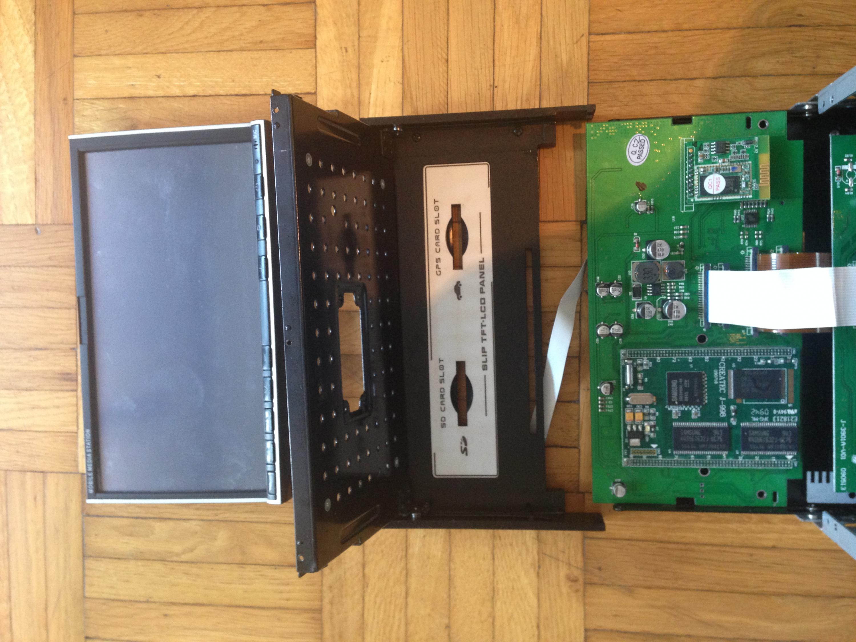

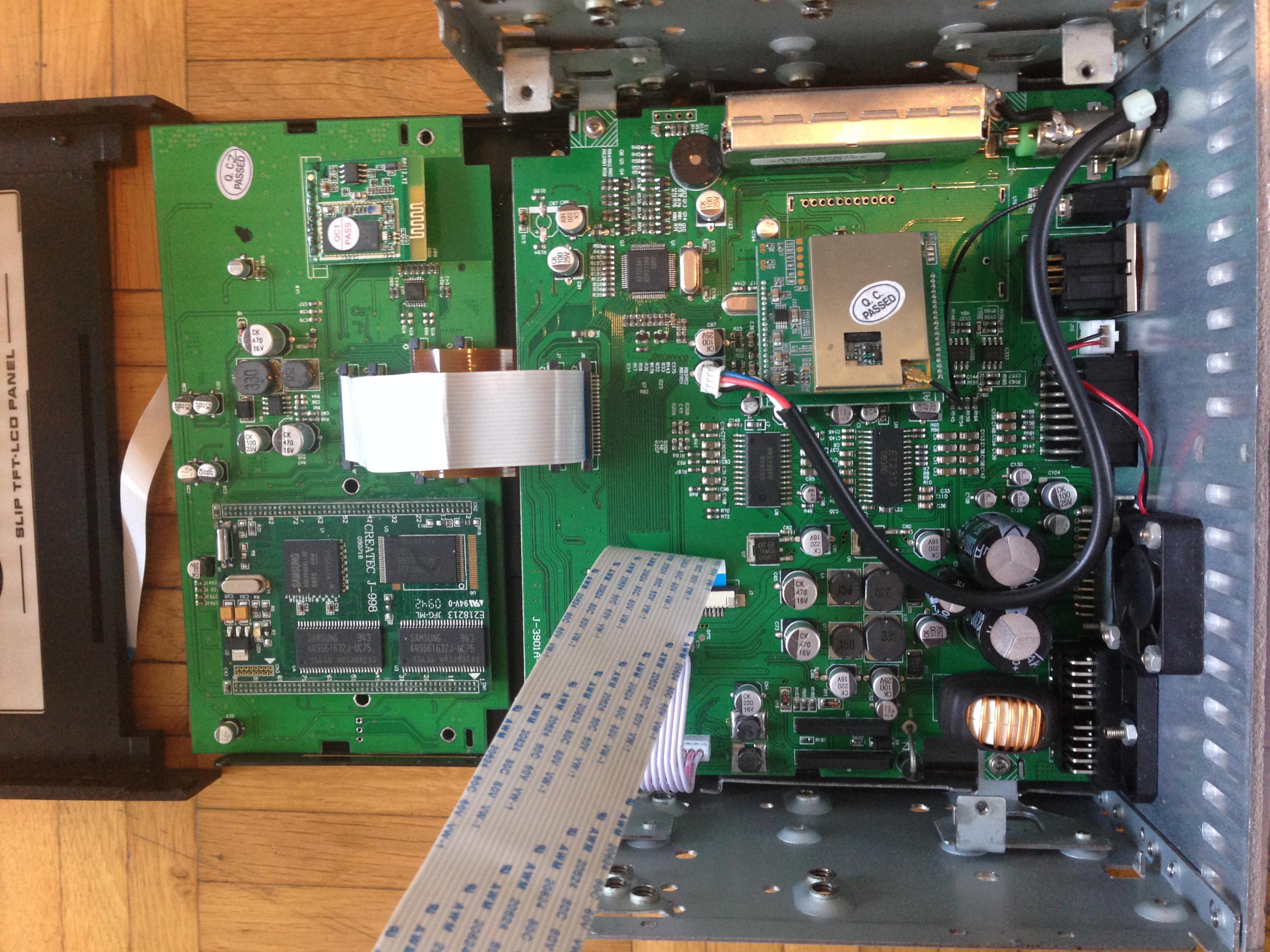

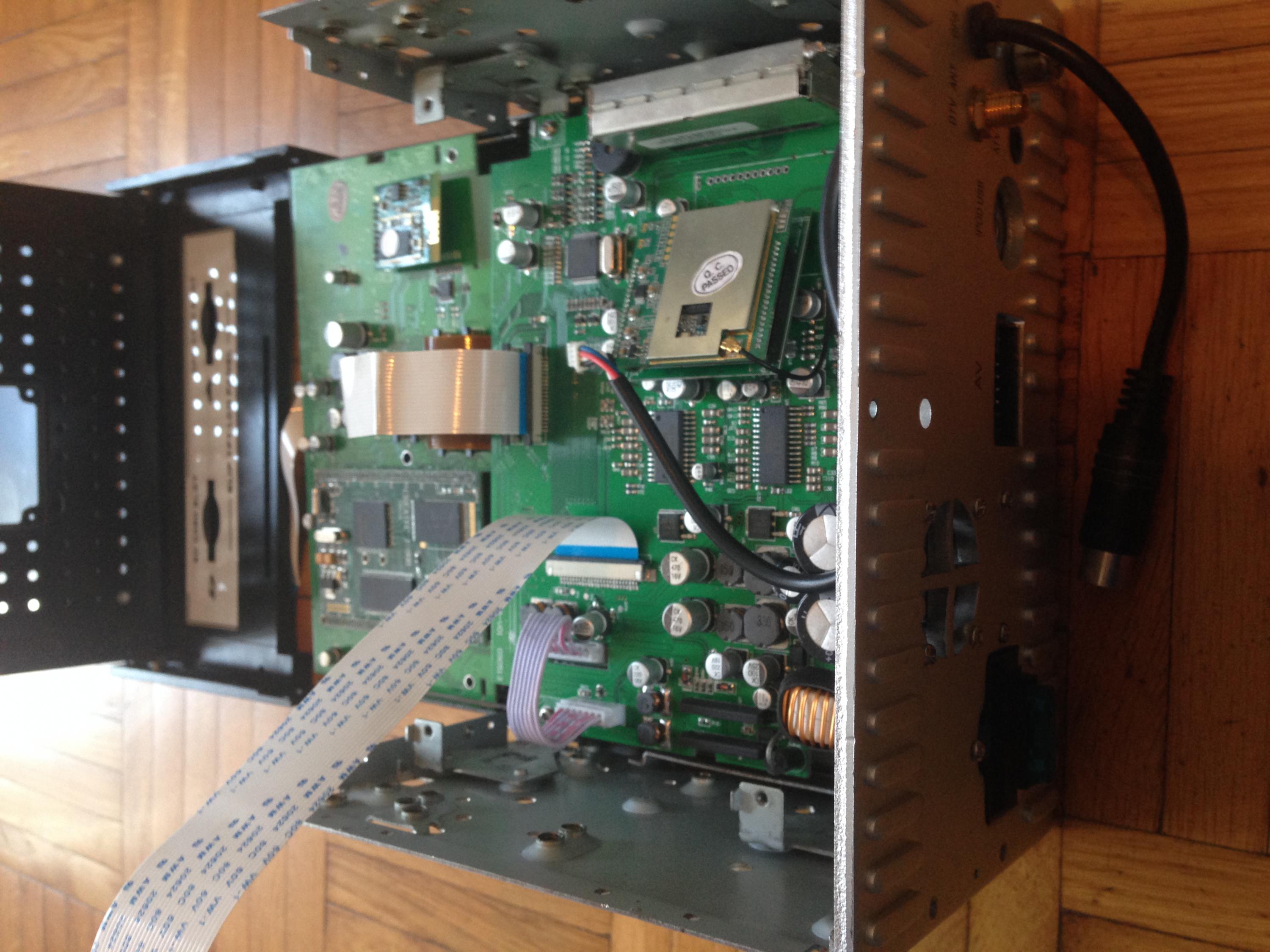

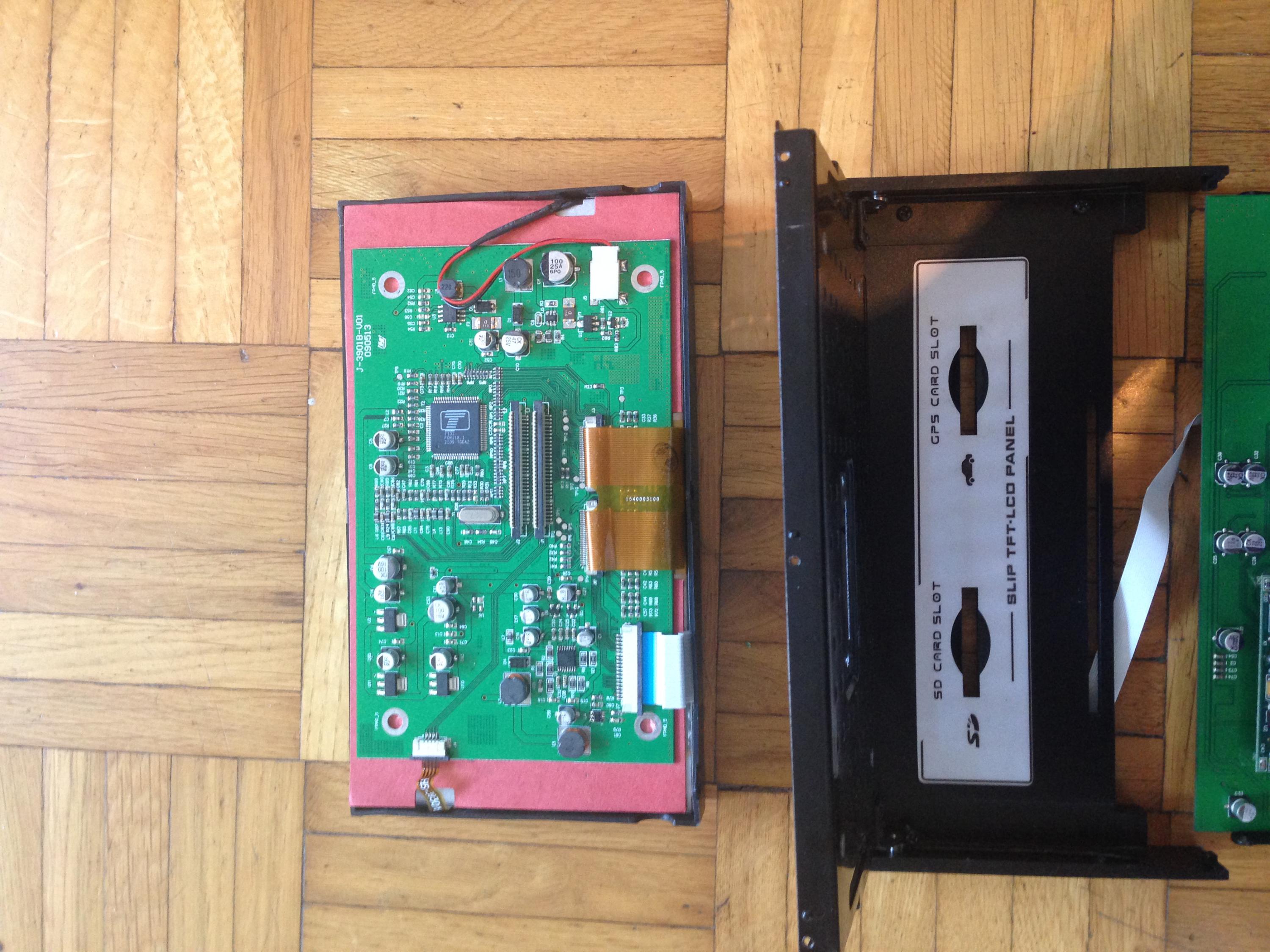

                                    now i opend main unit, is there something i must to check

                                        Re: LCD 2DIN CAR radio screen problem
                                        I'm not here only occasionally.
                                        In the last picture there is a red and black wire with a little white connector on top of the board, that supplies the backlight power to the LEDs.
                                        See, if you are getting any voltage there. If they are LEDs, it shouldn't be high voltage there.
                                        If they are CCFL tubes, you most likely shouldn't measure that connector.
                                        I'm not familiar with these units, I have opened up only Kenwoods.
