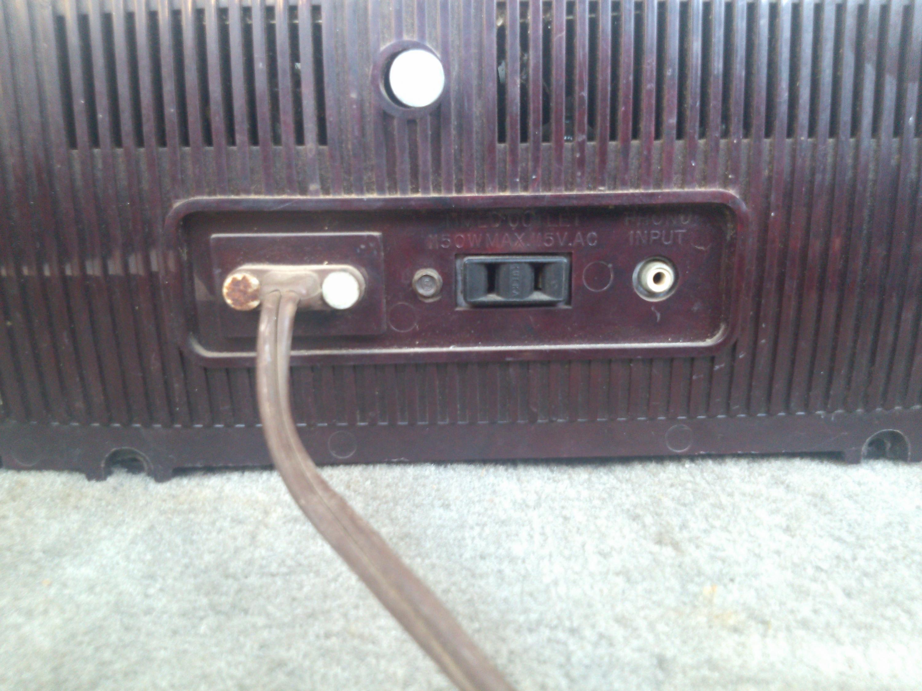

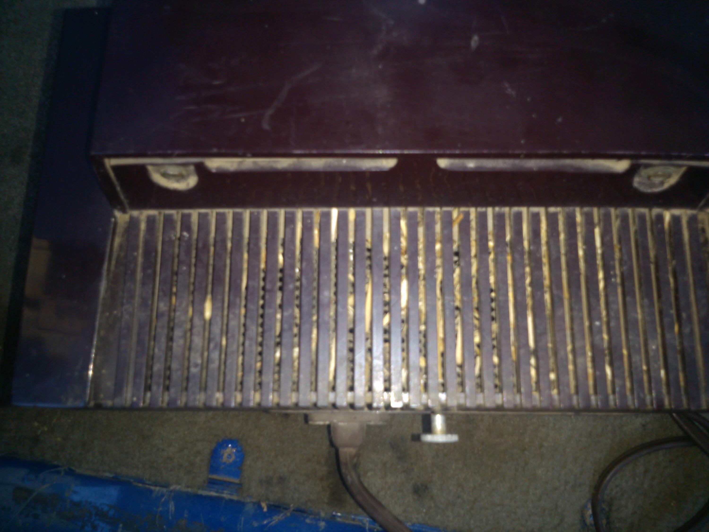

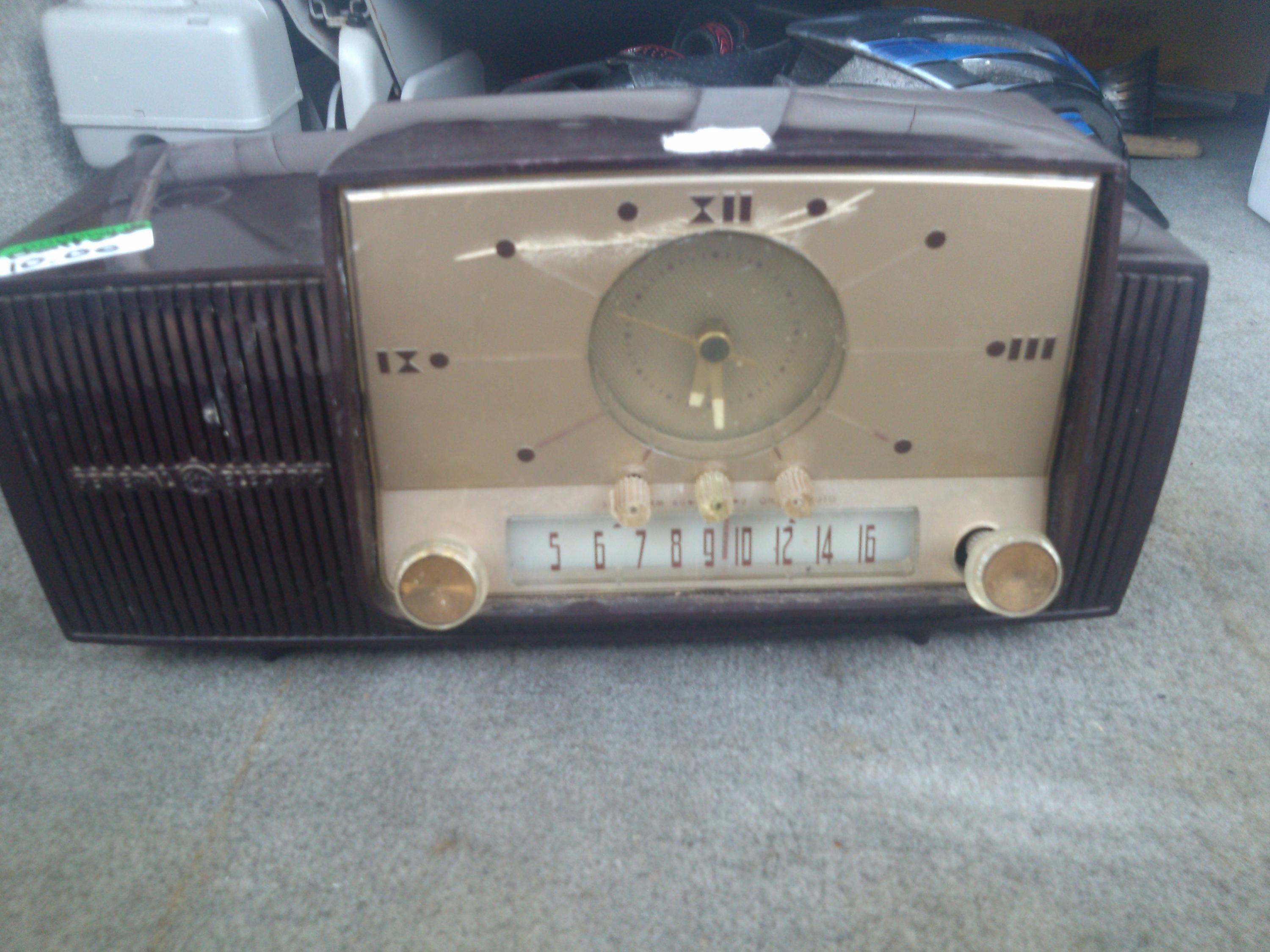

    Picked up my 1st tube radio for $5:
    It has issues... so far, I know it doesn't run. It also looks to have been in a barn or arric for some time:
    It has some nice features:
    From looking at the pcb through the vents, I saw a burnt trace and lots of bad joints... I also saw a datecode sticker that tells me it was made in the 26th week of 1956.
    Besides the series light bulb trick, are there any general pointers I should know?

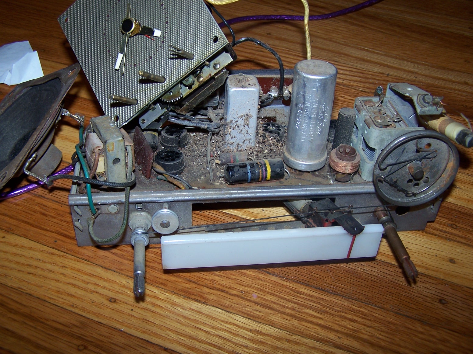

                                  • ratdude747
                                    Black Sheep
                                    • Nov 2008
                                    • 17136
                                    Re: Vintage GE Alarm clock/ tube radio

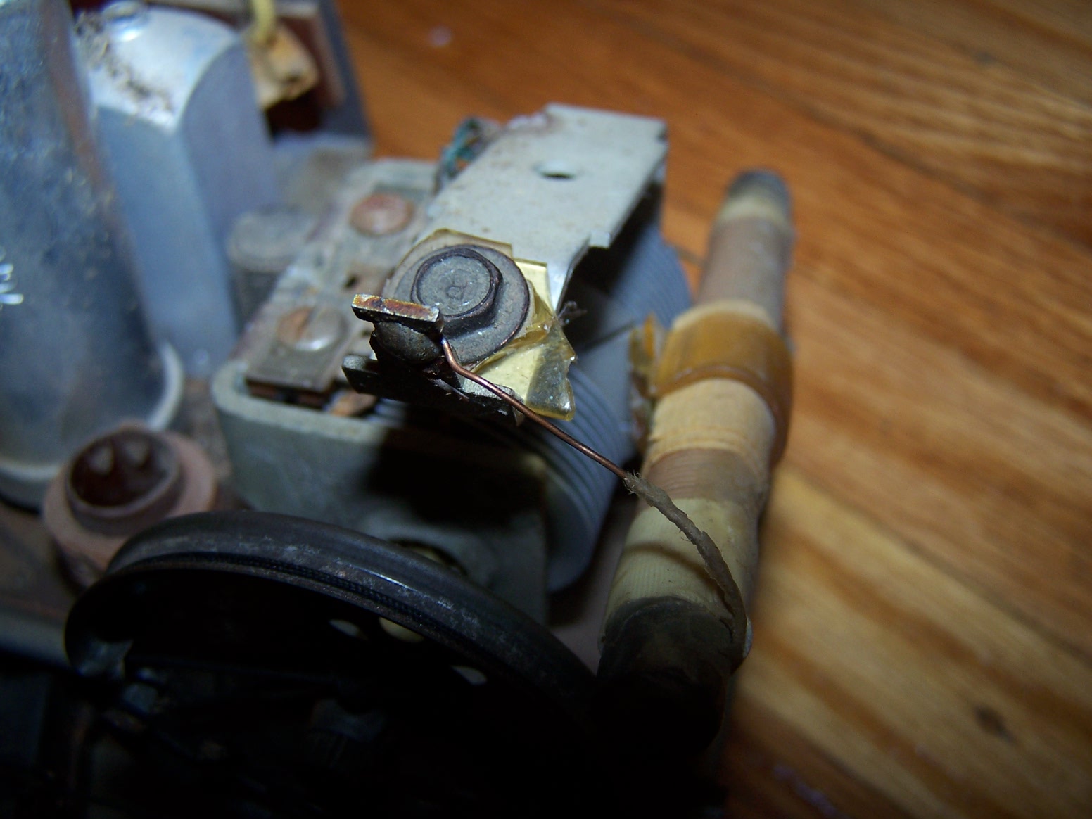

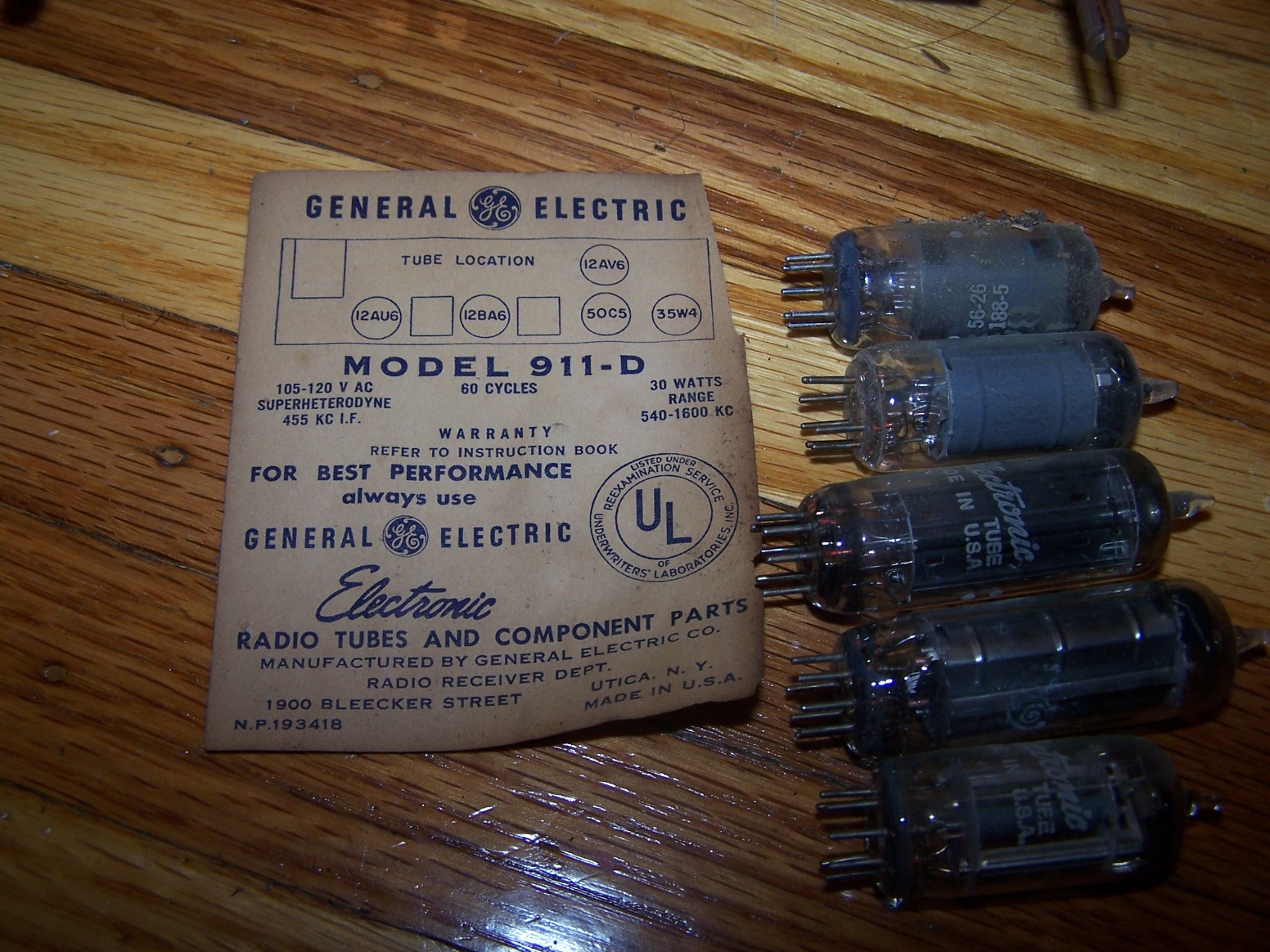

                                    I opened the beast... and here's some pics:
                                    I had already pulled the tubes, whose postions were included on a paper guide inside the unit:

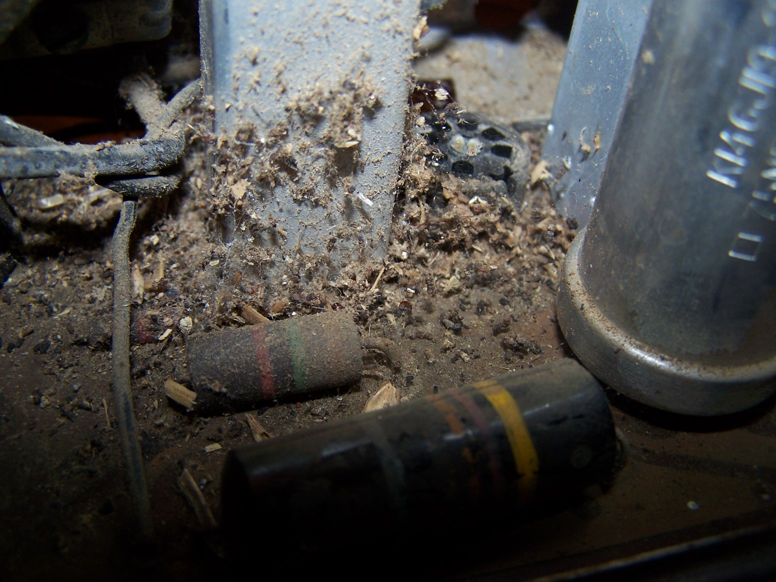

                                    It's pretty nasty inside:

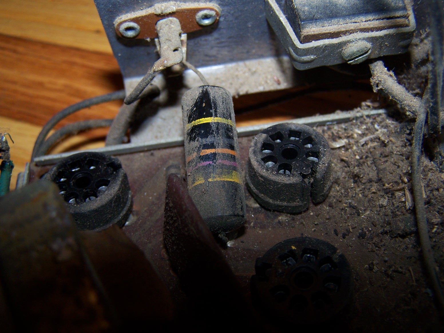

                                    As shown, there are black beauties inside... I didn't find any paper caps or obvious lytics... maybe I am missing something here.
                                    Another black beauty:
                                    When I opened it, the antenna mount was busted:
                                    I think I can use a 1/2" black plastic cable clamp/mount to replace that...
                                    I also restrung the tuner pulley system... the existing string was loose; I added a few knots to get it back to the correct length. However, the varicap is hardish to turn... any way to lube one of those without messing up it's cap range?
                                    It looks like I need to order some mylar caps... how does one translate the color codes on the black beauties (as in where does the range start)?
                                    I also built a series lightbulb rig... it has an on-off switch for the output and a switch to switch it between series light bulb and full 120V.
                                      Boy, those are the same set of tubes I used to build my first electronics project when I was 14 years old. I had to save a lot of money to come up with all the parts. Built on a wooden chassis that is lined with aluminum foil.
                                      • delaware74b
                                        • Apr 2009
                                        • 628
                                        RD - the electrolytic cap is the large round bare metal can, seen from your first and third photos in post #18.
                                        It looks like a combo 75 and 30uF cap.
