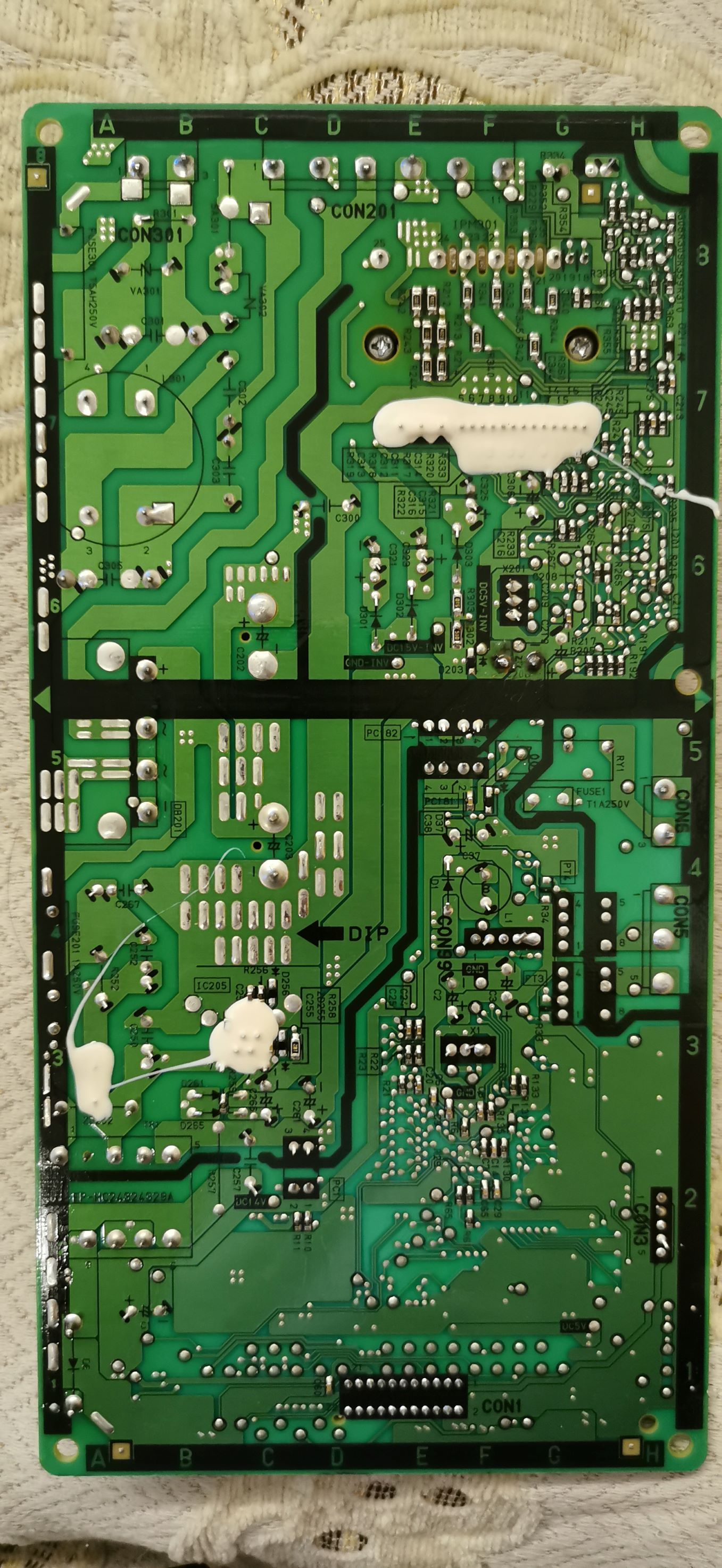

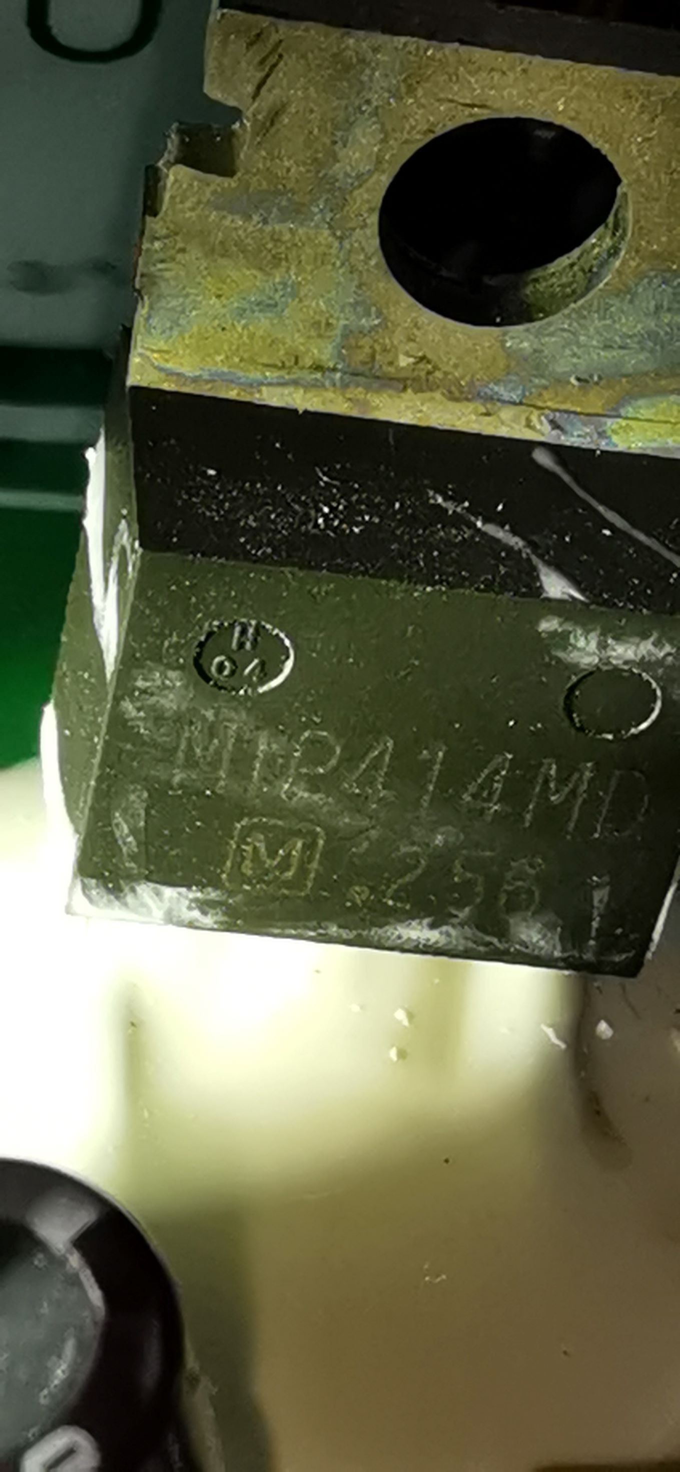

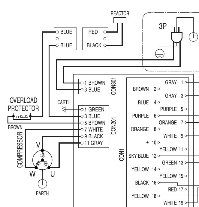

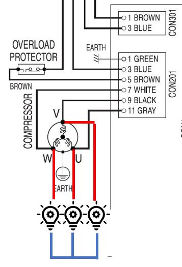

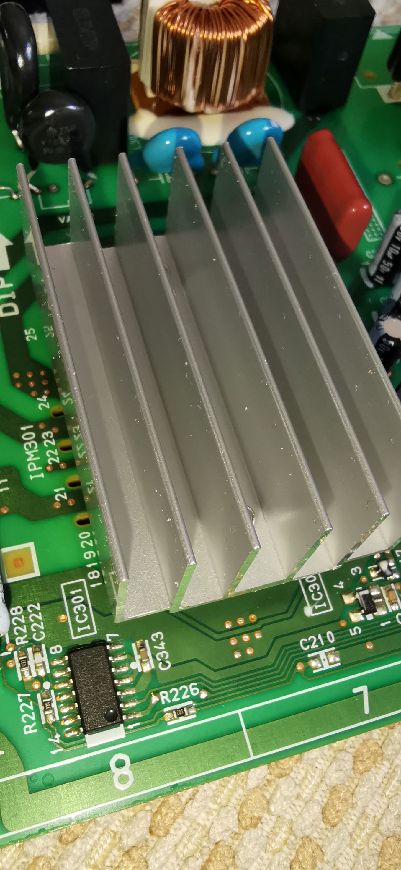

Panasonic Inverter Refrigerator model NR-BY602XS - suddenly not cold overnight
    replied
    Re: Panasonic Inverter Refrigerator model NR-BY602XS - suddenly not cold overnight
    Some info I found about Panasonic Inverter compressor:
    http://web.mit.edu/parmstr/Public/x/...onsumption.htm
    Leave a comment:
    replied
    Re: Panasonic Inverter Refrigerator model NR-BY602XS - suddenly not cold overnight
    i doubt most meters will give decent readings on a high frequency drive.
    Leave a comment:
    replied
    Re: Panasonic Inverter Refrigerator model NR-BY602XS - suddenly not cold overnight
    I see a couple of problem with the power to the compressor
    The compressor data label clearly state that the voltage is 240 volts
    Why are you only getting 160 volts number one
    Why is your amperage look low to me this might be issues number 2
    Issues number 3 is you say that when the compressor run it is not very cool and the heat comes from the condenser coil is not very hot I being to think that something might be wrong with the compressor or your meter device or you might have a gas leak
    Does this unit have a data plate on it if it does can you post a picture of it
    Last edited by sam_sam_sam; 04-26-2020, 09:22 AM.
    Leave a comment:
    replied
    Re: Panasonic Inverter Refrigerator model NR-BY602XS - suddenly not cold overnight
    Originally posted by beetle1303 View Post
    The only one with heatsink is this giant one labelled IMP301 on the board. The only IGBT I can see but without heatsink is MIP414MD
    IMP301 part is not a good part number
    The MIP414MD is a good part number but it a some kind-a power switching power supply regulator
    You have not found something like a IGBT module module mount in the case some where
    Leave a comment:
  • Per Hansson
    replied
    Re: Panasonic Inverter Refrigerator model NR-BY602XS - suddenly not cold overnight
    Originally posted by beetle1303 View Post
    Here's the link for 1 such pic that caused this error: https://we.tl/t-lLIq3zXP41
    ** I just did a resized from 15mb to 4mb, then it loads OK.
    Sorry for the delay, I have changed the PHP settings to allow larger files to upload.
    I tested with your linked picture and it works fine now.
    But this one was 4MB, does the 15MB version upload fine too now or does it still error out?
    Leave a comment:
  • beetle1303
    replied
    Re: Panasonic Inverter Refrigerator model NR-BY602XS - suddenly not cold overnight
    I only have 2x 40 watts bulbs. Can I wire them in series and connect the 2 ends at any 2 of the 3 pins like in the pic below?
    Leave a comment:
    replied
    Re: Panasonic Inverter Refrigerator model NR-BY602XS - suddenly not cold overnight
    How bright do the light bulb get this amperage seems a little low
    Can you do this test with 100 watt bulbs if possible
    Leave a comment:
  • beetle1303
    replied
    Re: Panasonic Inverter Refrigerator model NR-BY602XS - suddenly not cold overnight
    Originally posted by sam_sam_sam View Post
    Now you need to know if the amperage is the same on three legs with the lights bulbs and with the compressor
    Not all amp probes are the same when it comes to reading VFD drive output because of the waveform that a VFD drive has some of can not read it
    But if your amp probe can read it there should not be more than 10% different between legs
    If the test results are very close to the same then it could be that the compressor has issues or you have a seal system fault of some kind
    Or
    You could have a problem with the inverter not working correctly
    I only have 2x 40-watt bulbs, and could get another to try. So I wire up my DMM in series, without the bulbs, with each of the 3 pins, one at a time:
    _______________start-up_____1-minute later
    Pin 7(W):_______~0.265A_____~0.235A
    Pin 9(V): _______~0.258A_____~0.223A
    Pin11(U):_______~0.276A_____~0.210A
    So all the pins started a little higher, and lowered down a little bit after a minute or so.
    Are these readings valid? And of so do they look normal?
    Last edited by beetle1303; 04-25-2020, 09:11 AM.
    Leave a comment:
    replied
    Re: Panasonic Inverter Refrigerator model NR-BY602XS - suddenly not cold overnight
    Originally posted by beetle1303 View Post
    Thank you for confirming the wiring diagram.
    I have done the reading across each leg:
    1) 1 & 2: 160.x vac
    2) 1 & 3: 160.x vac
    3) 2 & 3: 160.x vac
    I did it once only but taken a few readings over a few minutes. Each time the readings are about the same.
    Just to be sure:
    I inserted a straighten paper-clip each into pin 7, 9 and 11, and measure the voltages across 7 & 9, 7 & 11, 9 & 11. Hope this is correct way to measure them.
    Now you need to know if the amperage is the same on three legs with the lights bulbs and with the compressor
    Not all amp probes are the same when it comes to reading VFD drive output because of the waveform that a VFD drive has some of can not read it
    But if your amp probe can read it there should not be more than 10% different between legs
    If the test results are very close to the same then it could be that the compressor has issues or you have a seal system fault of some kind
    Or
    You could have a problem with the inverter not working correctly
    Last edited by sam_sam_sam; 04-24-2020, 11:11 AM.
    Leave a comment:
    replied
    Re: Panasonic Inverter Refrigerator model NR-BY602XS - suddenly not cold overnight
    the lamps are in series-pair so you would need more than 480v to damage them.
    Leave a comment:
  • beetle1303
    replied
    Re: Panasonic Inverter Refrigerator model NR-BY602XS - suddenly not cold overnight
    Originally posted by sam_sam_sam View Post
    Yes you could do that way as long as the voltage rating on light bulbs is above what the voltage of compressor would see
    I would still read the voltage across each leg
    1 and 3 / 2 and 3 / 1 and 2 the voltages should be no more than 10% different from each other unless there is a high leg
    Thank you for confirming the wiring diagram.
    I have done the reading across each leg:
    1) 1 & 2: 160.x vac
    2) 1 & 3: 160.x vac
    3) 2 & 3: 160.x vac
    I did it once only but taken a few readings over a few minutes. Each time the readings are about the same.
    Just to be sure:
    I inserted a straighten paper-clip each into pin 7, 9 and 11, and measure the voltages across 7 & 9, 7 & 11, 9 & 11. Hope this is correct way to measure them.
    Last edited by beetle1303; 04-24-2020, 07:49 AM.
    Leave a comment:
    replied
    Re: Panasonic Inverter Refrigerator model NR-BY602XS - suddenly not cold overnight
    Yes you could do that way as long as the voltage rating on light bulbs is above what the voltage of compressor would see
    I would still read the voltage across each leg
    1 and 3 / 2 and 3 / 1 and 2 the voltages should be no more than 10% different from each other unless there is a high leg
    Leave a comment:
  • beetle1303
    replied
    Re: Panasonic Inverter Refrigerator model NR-BY602XS - suddenly not cold overnight
    Originally posted by stj View Post
    you could wire them so one end of each lamp is joined, and the other end is hooked to the V,W & U signals like in the diagram,
    that would be pins 7,9 & 11
    Pardon me for being extra cautious as I am quite terrified of high voltage wiring - please help confirming the wiring is correct per your description.
    Thank you.
    Leave a comment:
    replied
    Re: Panasonic Inverter Refrigerator model NR-BY602XS - suddenly not cold overnight
    you could wire them so one end of each lamp is joined, and the other end is hooked to the V,W & U signals like in the diagram,
    that would be pins 7,9 & 11
    Leave a comment:
  • beetle1303
    replied
    Re: Panasonic Inverter Refrigerator model NR-BY602XS - suddenly not cold overnight
    Originally posted by stj View Post
    maybe you could use 3 lamp bulbs in parallel to the compressor coils to see if all 3 are being driven.
    I would, if you could kindly draw me diagram on how to wire them up, and presumably using 40w-100W incandescent bulbs?
    I should expect to see these bulbs flickering indicating varying power driving the compressor?
    Leave a comment:
    replied
    Re: Panasonic Inverter Refrigerator model NR-BY602XS - suddenly not cold overnight
    maybe you could use 3 lamp bulbs in parallel to the compressor coils to see if all 3 are being driven.
    Leave a comment:
  • beetle1303
    replied
    Re: Panasonic Inverter Refrigerator model NR-BY602XS - suddenly not cold overnight
    The only one with heatsink is this giant one labelled IMP301 on the board. The only IGBT I can see but without heatsink is MIP414MD.
    The 3 compressor pins all has resistance of 9.4 ohm between them. When powered up, all has around 160.3-5 between them.
    I have powered up the fridge, and turned on the quick freeze function, and the freezer control to max. The compressor started up with normal low temperature, low vibration and low humming sound. After about 30 minutes, it became quite hot (but not too hot to touch) with medium pitch whining sound, but vibration remained low.
    The inlet and outlet tubes to and fro the compressor both feel slightly hot and slightly cold respectively. Evaporator fan is running. Can feel the refrigerant flowing through when placing fingers onto the evaporator coil, but not cold at all.
    I gave the compressor a few bangs with a gloved fist, the whining pitch seemed to have lowered, then returned to same level after a short while.
    Leave a comment:
    replied
    Re: Panasonic Inverter Refrigerator model NR-BY602XS - suddenly not cold overnight
    OK
    I have repaired VFD drive before
    This has to have a IGBT module some where on that board more than likely there is a heat sink on top of it post the part number of it
    Try reading the voltage on terminals 1 and 3 / 2 and 3 / 1 and 2 on the compressor terminals
    The voltage readings should be very close to each other
    If you can not get a stable reading then try read the input voltage at board if you do not get a stable reading there then you have some problem at IGBT module
    Leave a comment:
  • beetle1303
    replied
    Re: Panasonic Inverter Refrigerator model NR-BY602XS - suddenly not cold overnight
    The board looks like tropical rain forest to me...
    Are you able to point it out where do I start checking?
    Leave a comment:
    replied
    Re: Panasonic Inverter Refrigerator model NR-BY602XS - suddenly not cold overnight
    or fix the board?
    Leave a comment:
