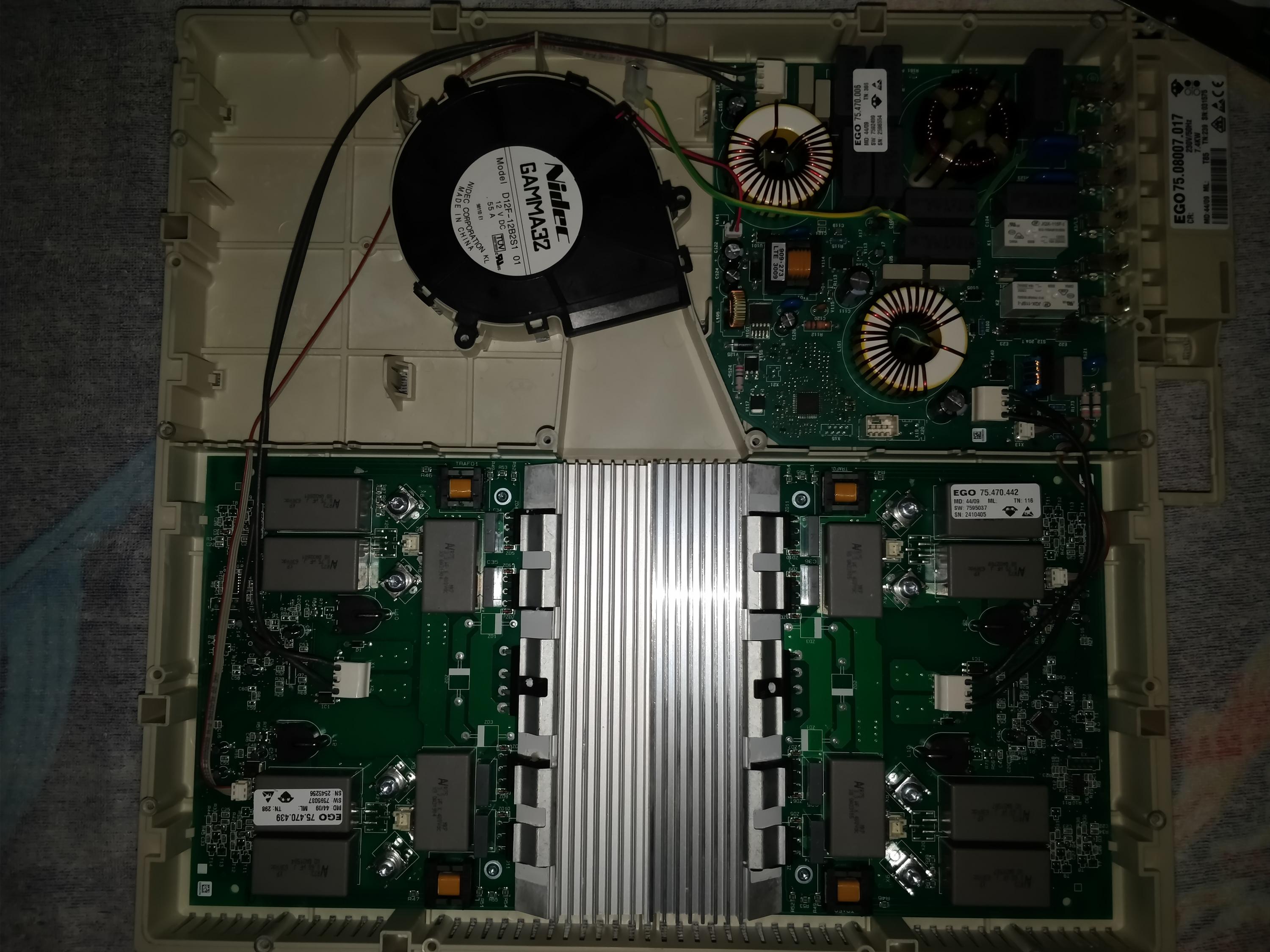

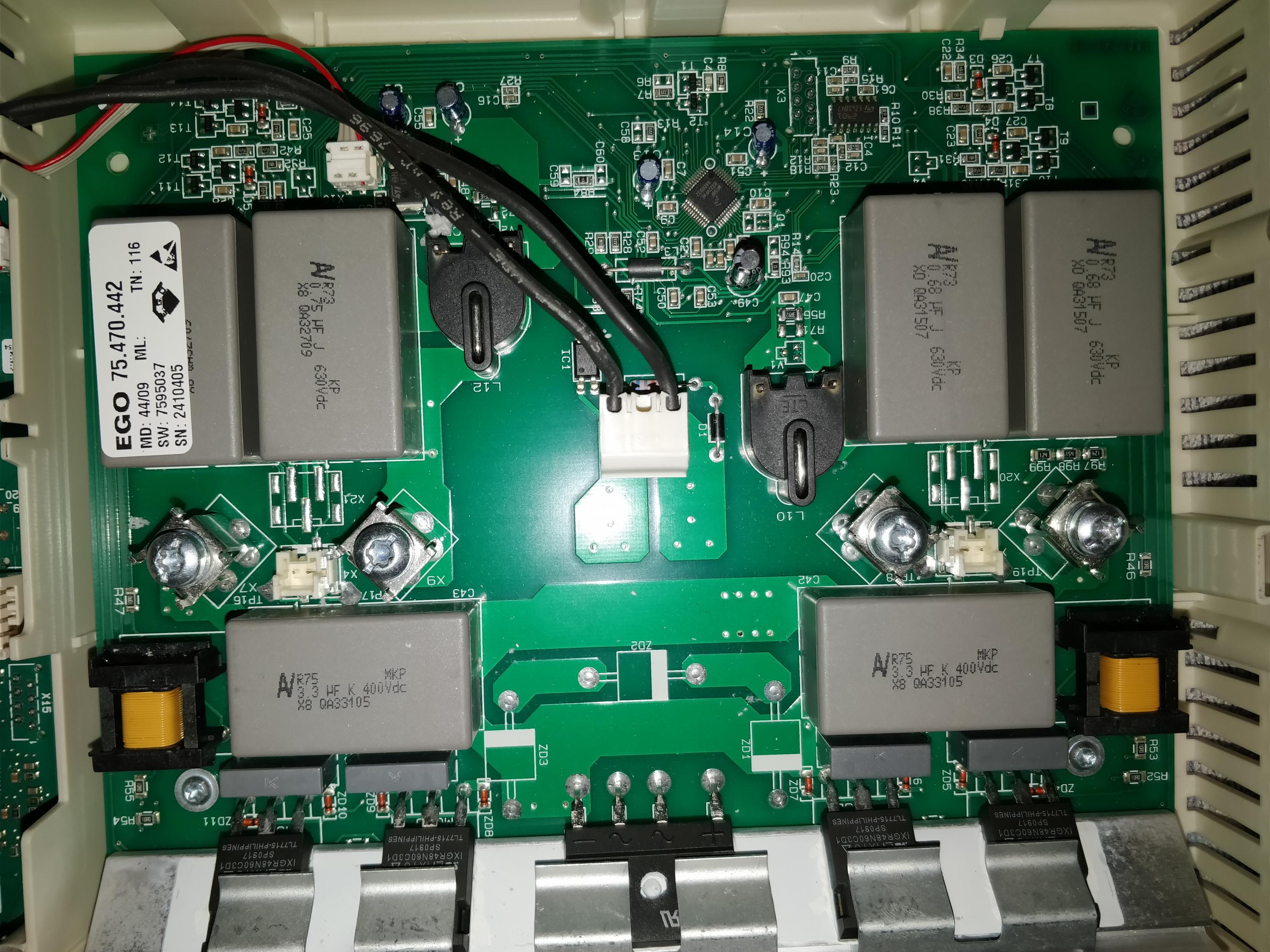

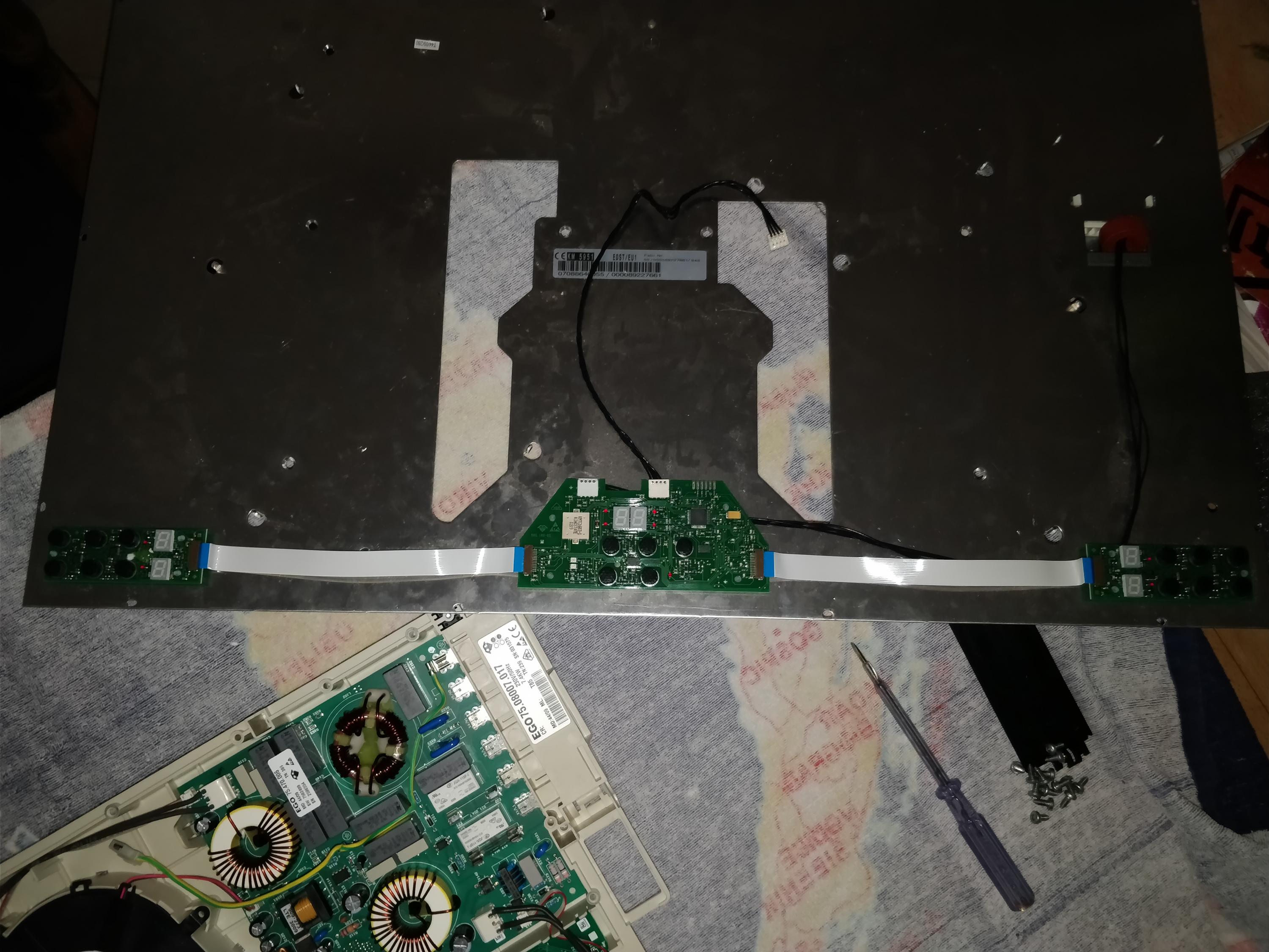

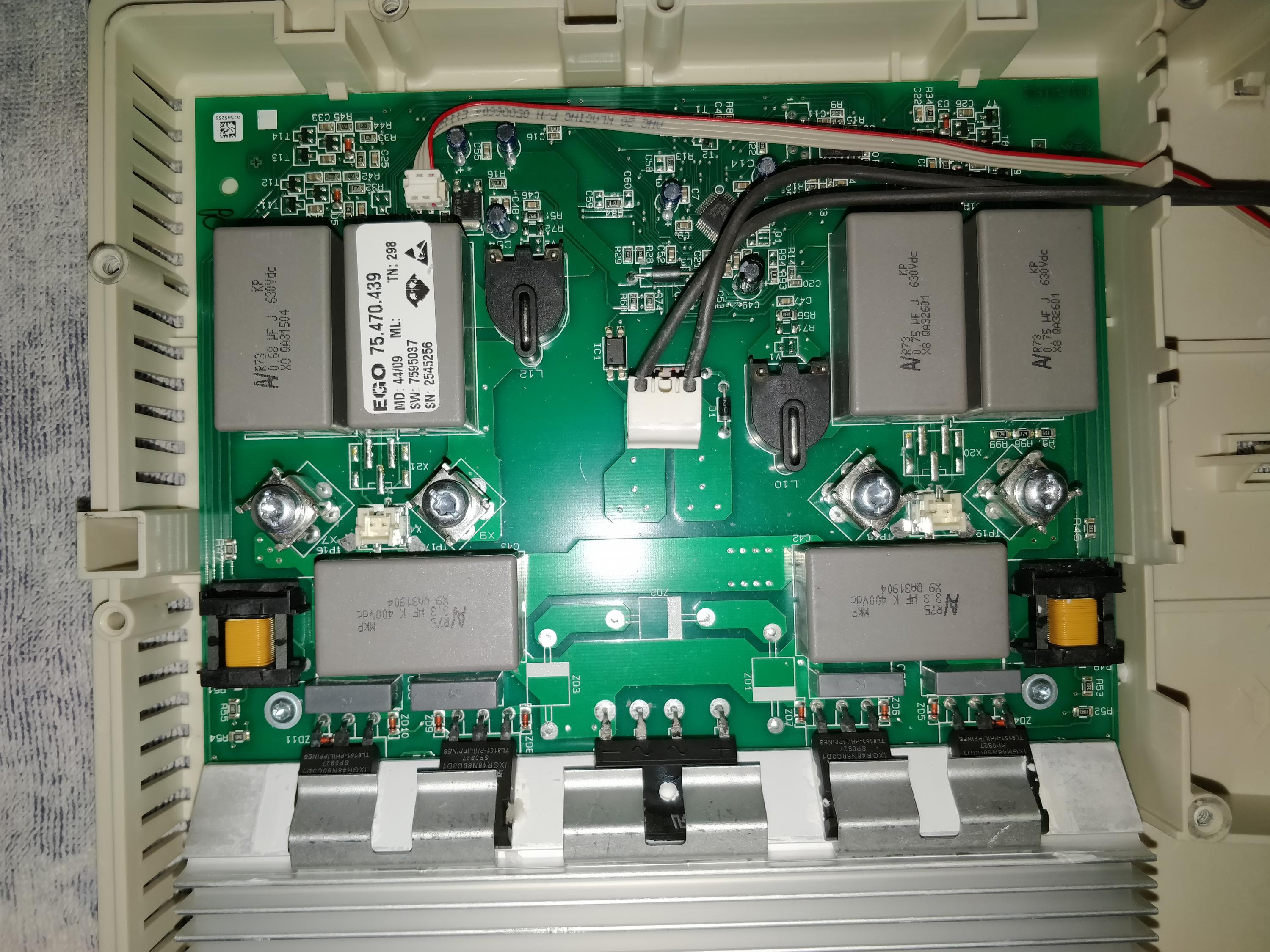

    Okey guys, i managed to keep the cooker. my parents bought a new one but i still really want to fix it because i believe it should be quite simple and not as expensive as a new one (1200 euro's). After i write this i am going to put it back together and test if it is one single cooker that is broken or if it is the whole system. until i have result. here are the pictures you guys asked for:
    The front left board
    The front right board
    The controller board (for the buttons)
    The total picture with the cover removed

      Have you checked the bridge rectifiers and IGBT transistors for shorts ?
      They are the components at the bottom in photos 1 and 2.

            Then i took the multimeter and checked the igbt's and rectifiers. I noted that the bottom left igbt and the rectifier from the bottom right board are both doing weird things. The igbt is completely shorted out and the rectifier does not rectify accordingly. I hope this clarifies some thing for you guys.

                Hey guys sorry it has been so long. I tried removing the units but my soldering kit was too weak. It didn't melt nicely so i had to get a better one. Now i managed to get the solders away nicely but i have to get the units out of that heatsink. they are reaally tight. How can i bend open the limbs of the heatsink so i can remove the units without crushing the whole board?
                hope there is some sneaky trick i did not know about.

                  They look to be held on with three metal clips. Remove the clips and the IGBTs should just be resting on the heatsinks

                    Yeah i see, but there seems to be a lot of stress on them, so i am scared to break them or the components.

                      Remove the whole assembly out and you should be able to slide the clips out, they fit into the groove of the heatsink. Do not bend the clips' fingers too much, it will lose its tension.
