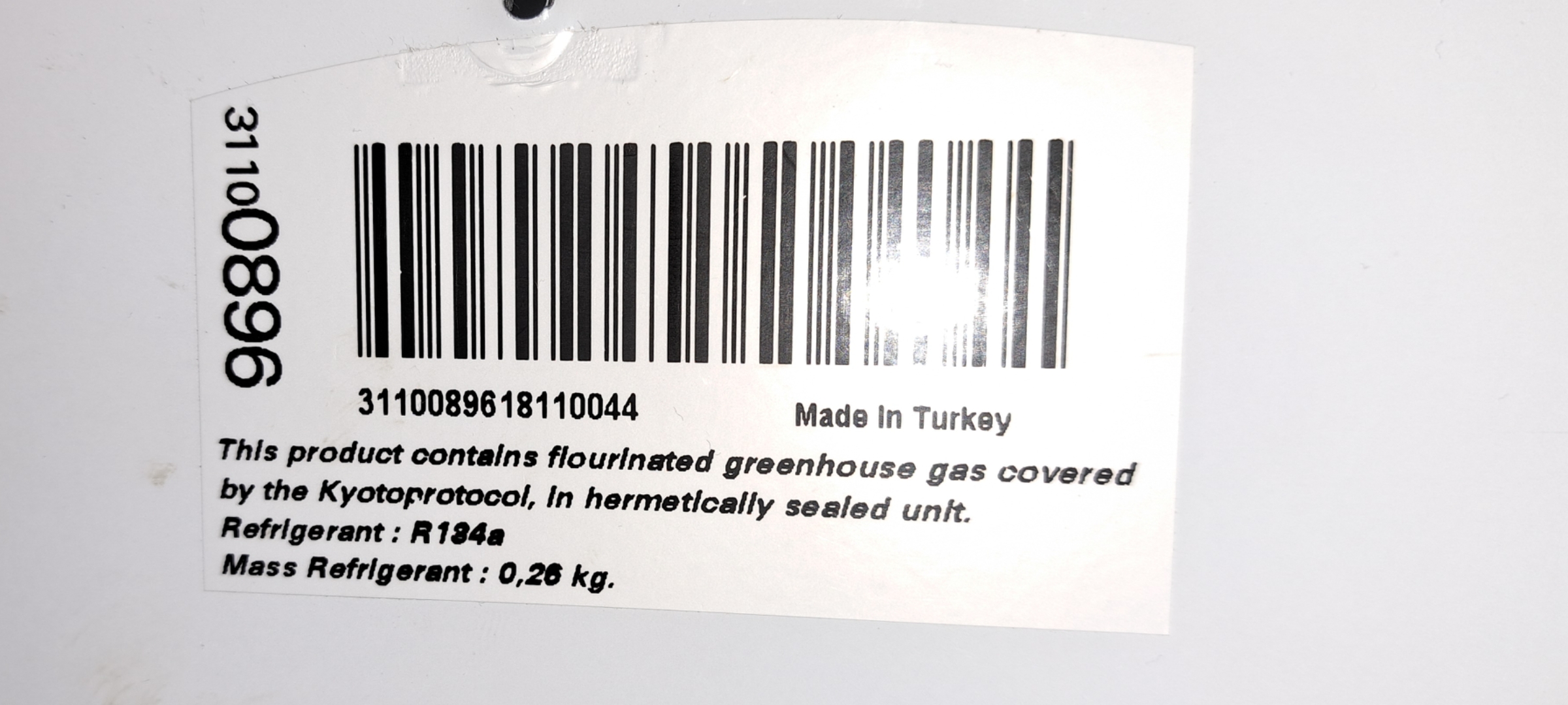

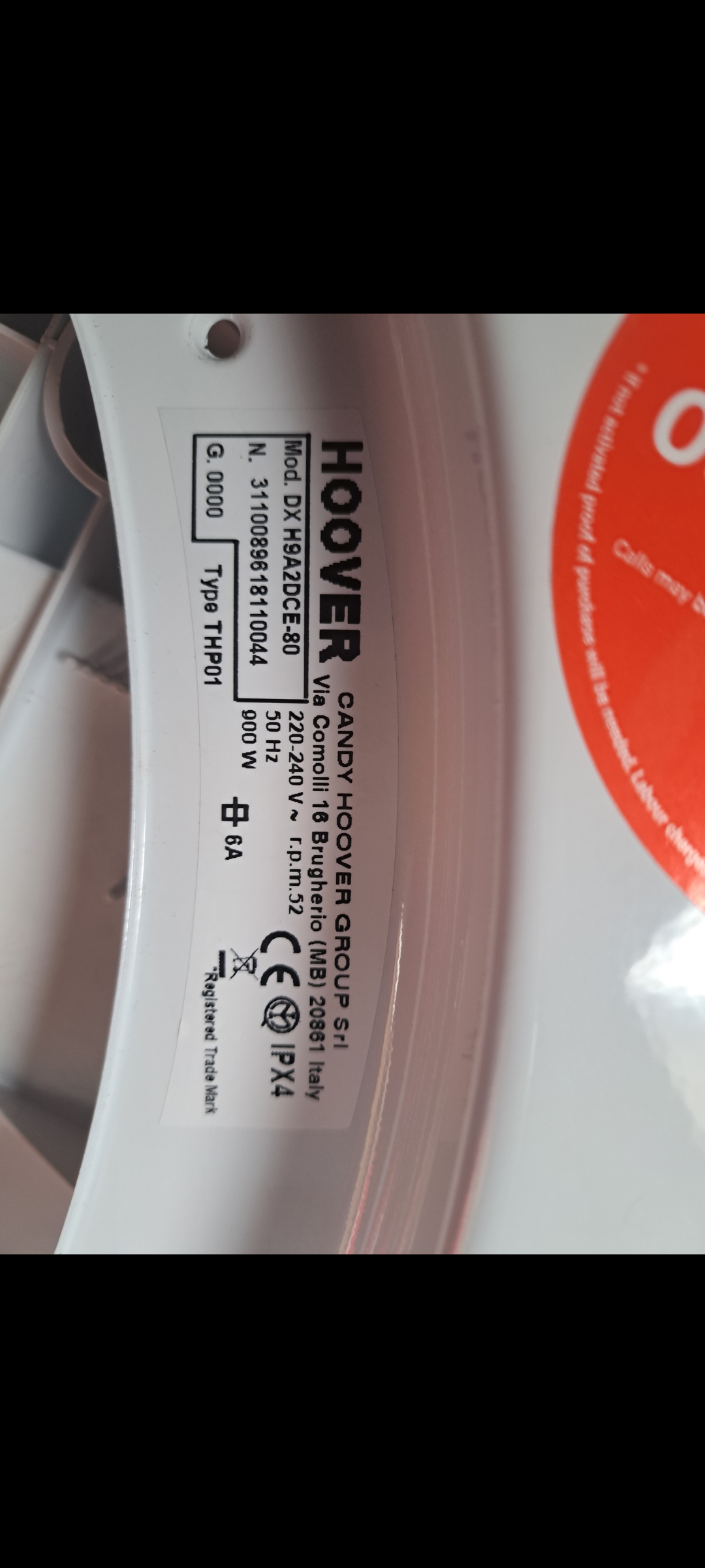

    Can you post a picture of the machines data plate? that tells alot of information.

      Photo of data plate and machine data attached.

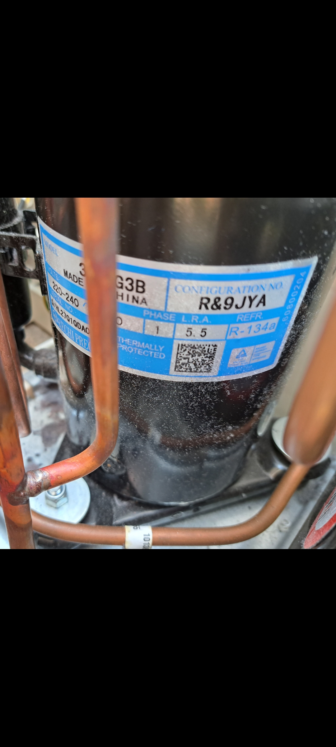

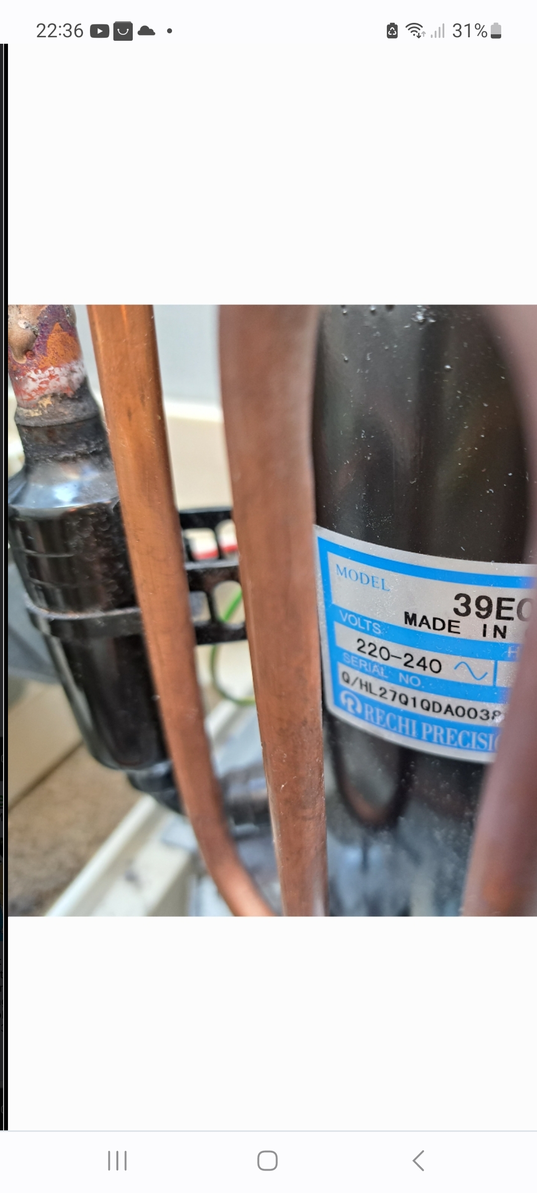

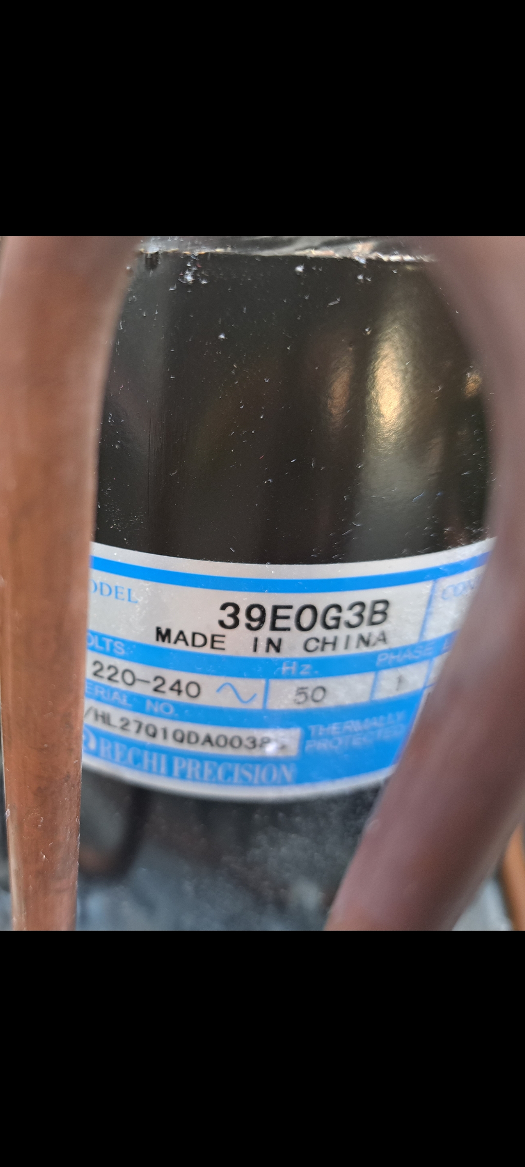

          Re: Heat pump tumble dryer regas
          ok shall get those readings as soon as I can meanwhile photo of compressor plate data

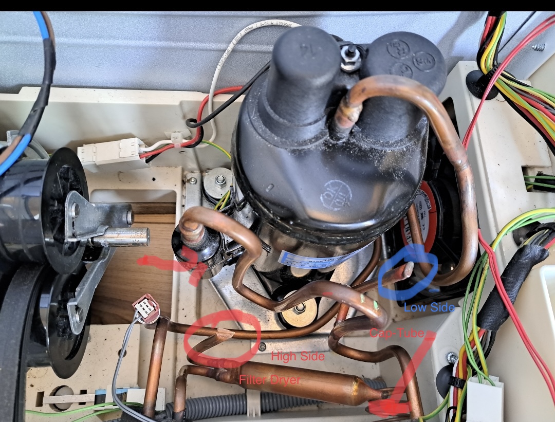

                                        What is this part thats connected directly to the bottom of the compressor? Which is on the low side.
                                          The part you are referring to is known as the “ accumulator ” ( where the RED arrow is located at ) this is used so that it you still have some liquid refrigerant still in the suction line still has a chance to turn into a gas and not damage the compressor
                                          To answer your second question I have answered it with where the low side and where the high side of the system and where the filter dryer and where the accumulator is located at and that is where you would want to put your value at
                                          I caution you that not knowing weather or not it is that the system is low on refrigerant or is restricted or you have a compressor issue you need to know what the high side and low side pressures are in the system when the compressor is running ( you can not assume that it is low on refrigerant without knowing what the system pressures are when adding refrigerant to the system because if it restricted you can easily add a lot of refrigerant in the system and not know it if you are not careful it has happened to me before I have been doing air conditioning and refrigeration for many years and depending on how much it is restricted sometimes it can fool you and it being that the metering device is a cap-tube this is more likely to happen )
                                          When you have gauges hooked up to the system if you would please take a picture of gauges when the compressor running and before you add refrigerant unless you loose the hole charge of the system because of not having the right equipment to just check the system pressure correctly then this another story
                                          Because if you loose the hole charge of the system then your next step would be to add some refrigerant and some nitrogen to the system to have a pressure of around 350 psi ( no higher 400 psi ) and then use a leak detector and very slowly go around all of the brazing joints and coils and the compressor terminals and check for leaks no matter how small you should have NO leaks whatsoever if you do where are they and take a picture of where it is leaking if you have a leak in the system
                                          Under No circumstances should you run the compressor when you have refrigerant and nitrogen in the system you will probably ruin the compressor if you were to do this also when you have the system vacuum out also do not run the compressor then either because the same thing could happen
                                          I hope this helps you with this repair
