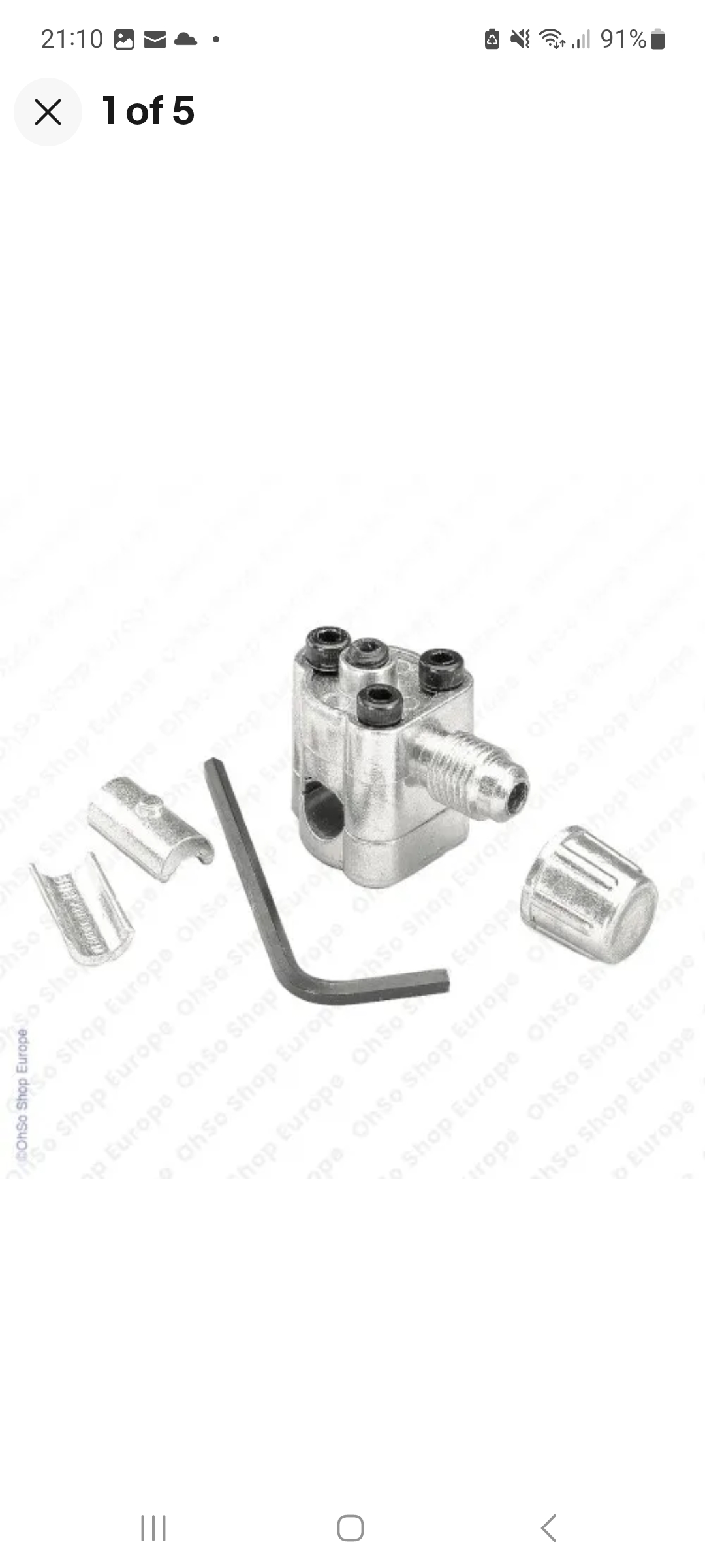

    Just wondering if anyone has successfully attempted a re-gas on a heat pump tumble dryer.
    The dryer currently in question runs on R134a.
    The dryer has been completely stripped down/cleaned/tested and re-assembled however there is no heating/cooling effect so working on the assumption it requires re-gassing. Of course, its likely theres a leak which would require soldering or even the possibility that the compressor has an internal fault even though it is running.
    I was thinking of getting a car aircon regas kit or probably easier but slightly dearer an hvac kit from ebay and clamp valves that pierces the pipe for the connections on the low/high pressure sides so theres no need for any gas torch soldering.
    I'm not sure why it wouldnt be necessary to vacuum the system on a car before filling (perhaps it is) but quite sure it would be necessary on the dryer so a car regas kit may not be suitable.

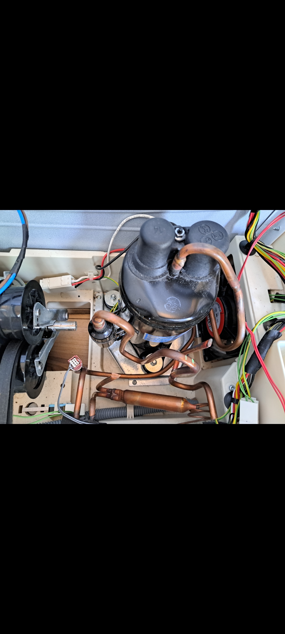

      Please post a picture of the device in question I might be able to help you with it

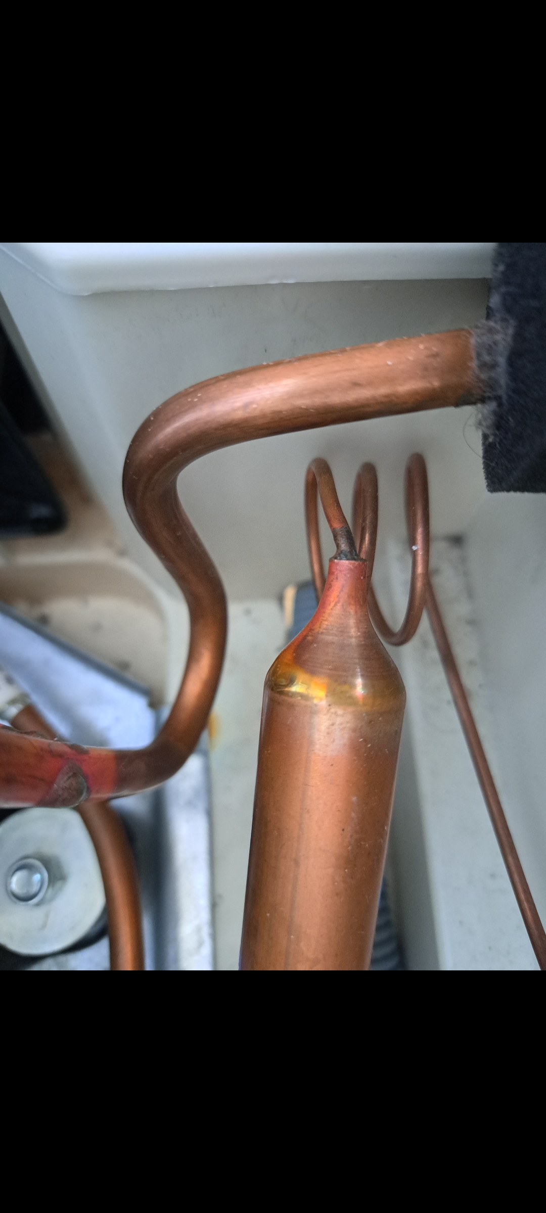

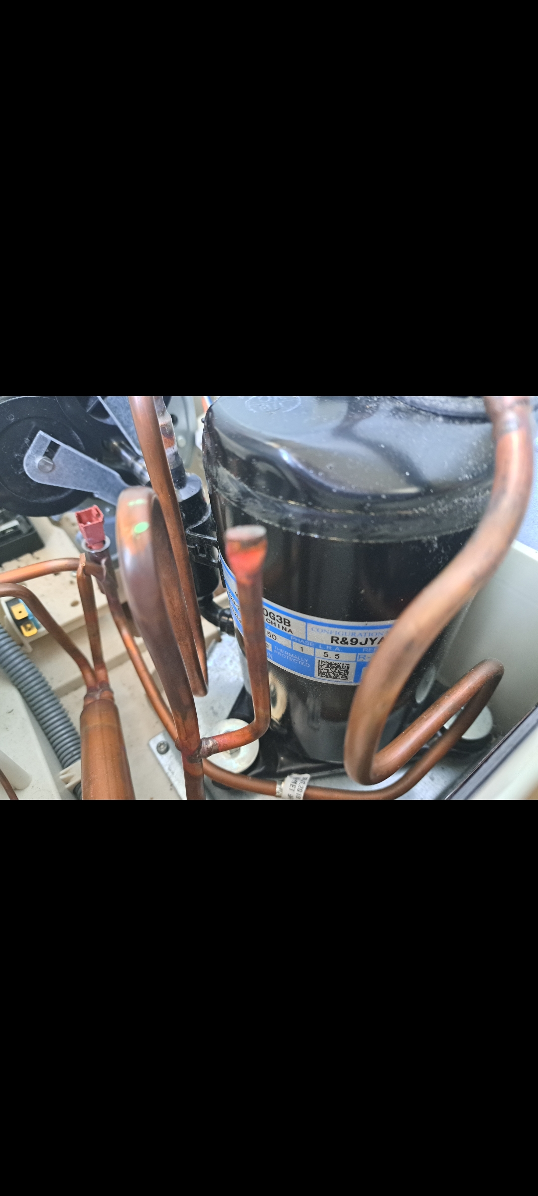

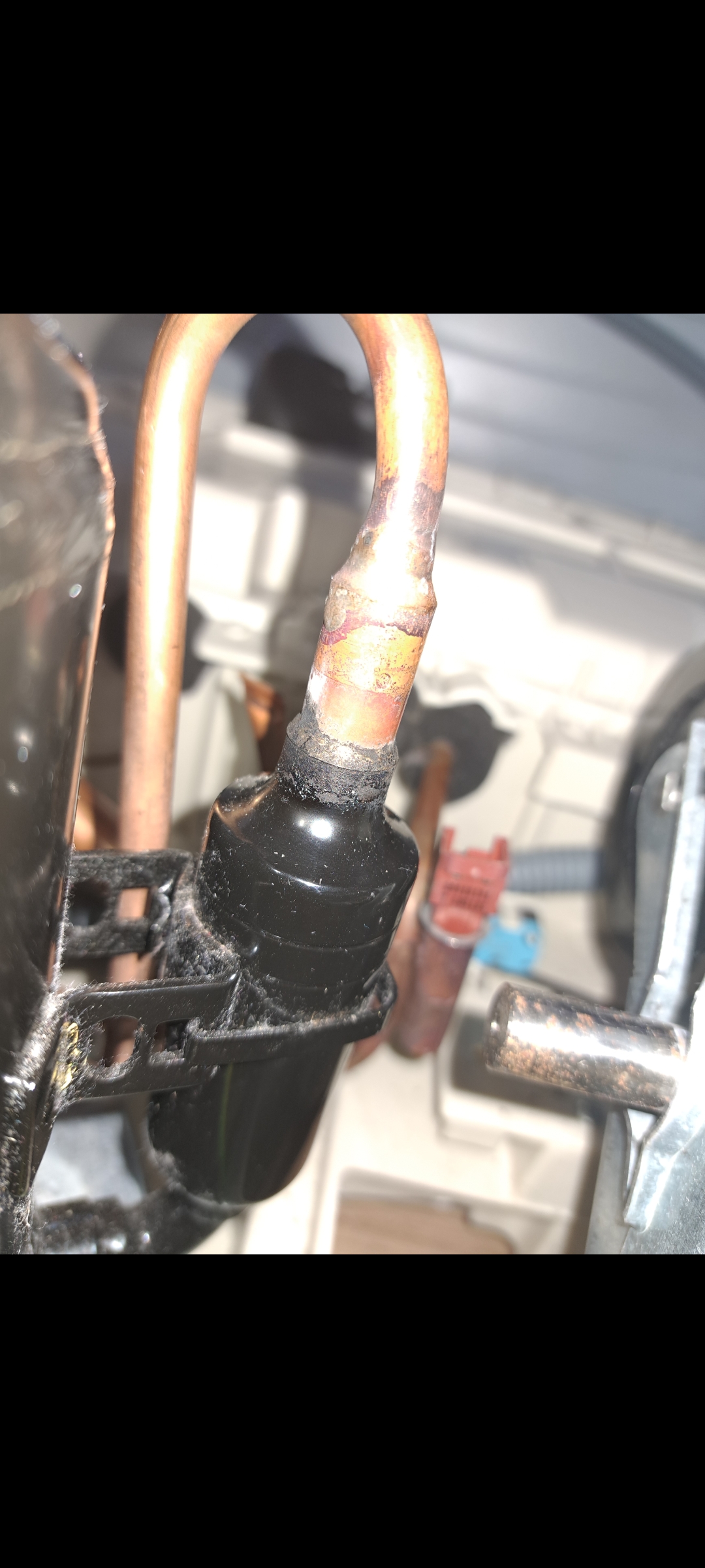

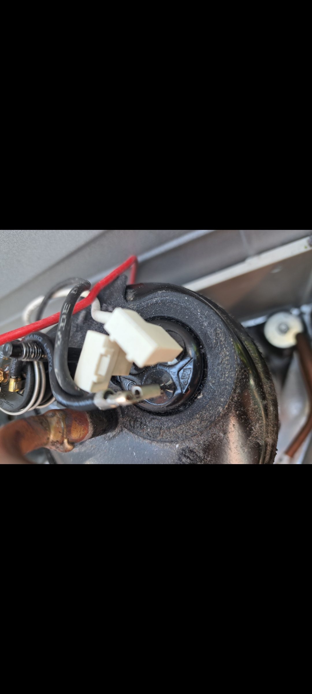

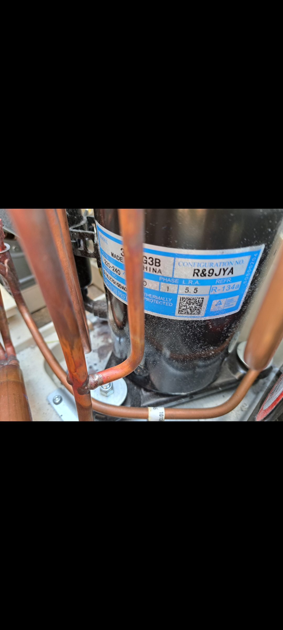

            First dose the compressor run (if so drop down to the next line)
            Second dose small diameter tube on top of the compressor get warm or if hot possible gas leak or restricted capillary tube ( which could be the metering device )
            If you do not hear the compressor running dose the temperature/current overload is it good
            check with multi meter for continuity if you do have continuity do you have it on all three pins on the compressor ( also check the run capacitor for the compressor as well for UF value very important thing to know if the compressor is humming when trying to start )
            Please check and make sure check to see weather or not you have pressure switches ( if so continue to read this section —> ) the pressure switches will be either on the condenser or evaporator side of the system these are screw on type with two wires the majority of the time if there is check the continuity on these pressures switches ( if there are no pressure switches skip this part )
            If all of these items are checked and still no compressor running and no humming is the fans running if not check the door switch or timer for continuity for these items in there running potions dose the drum rotates if not are the breakers tripped or a fuse blown
            Also check for temperature sensor switches for continuity as well because this could cause the compressor not to run as well

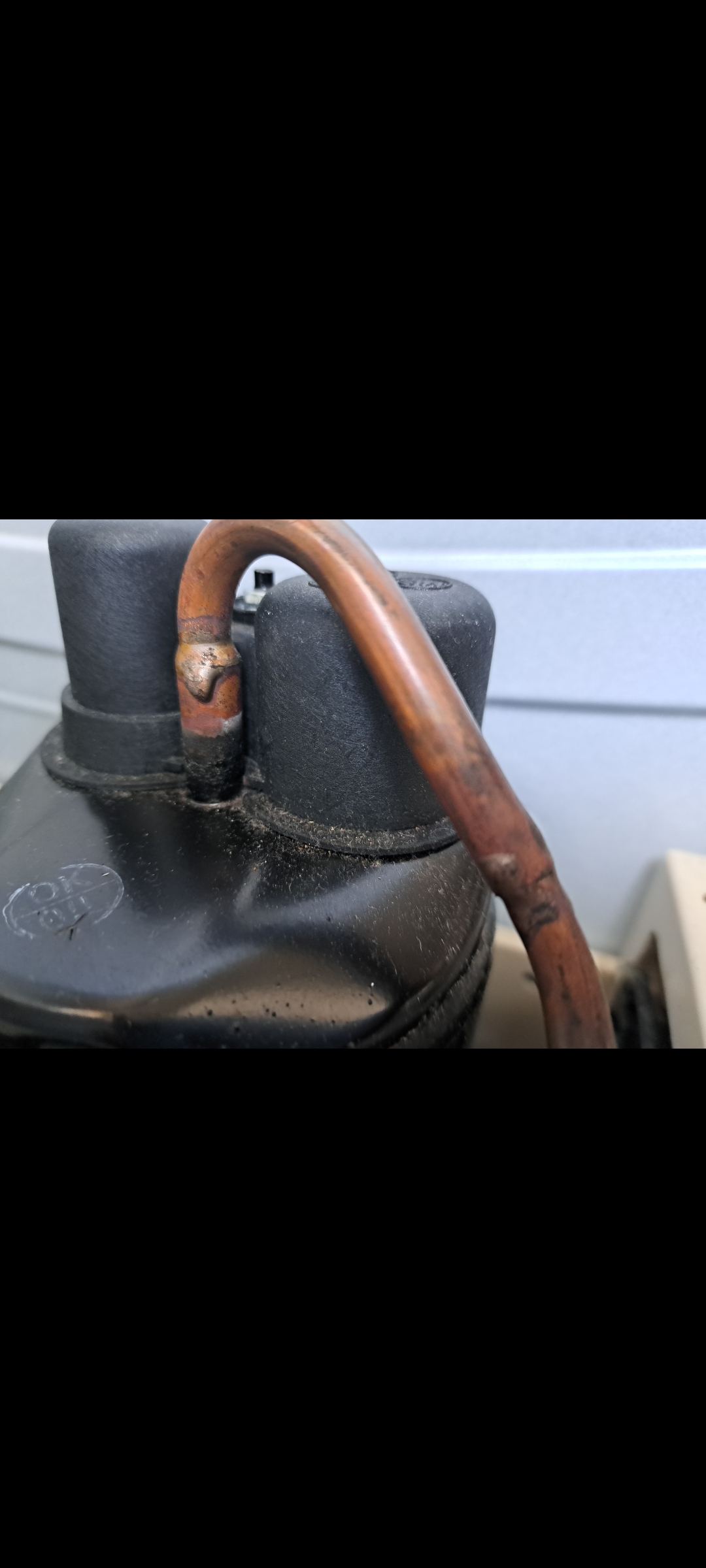

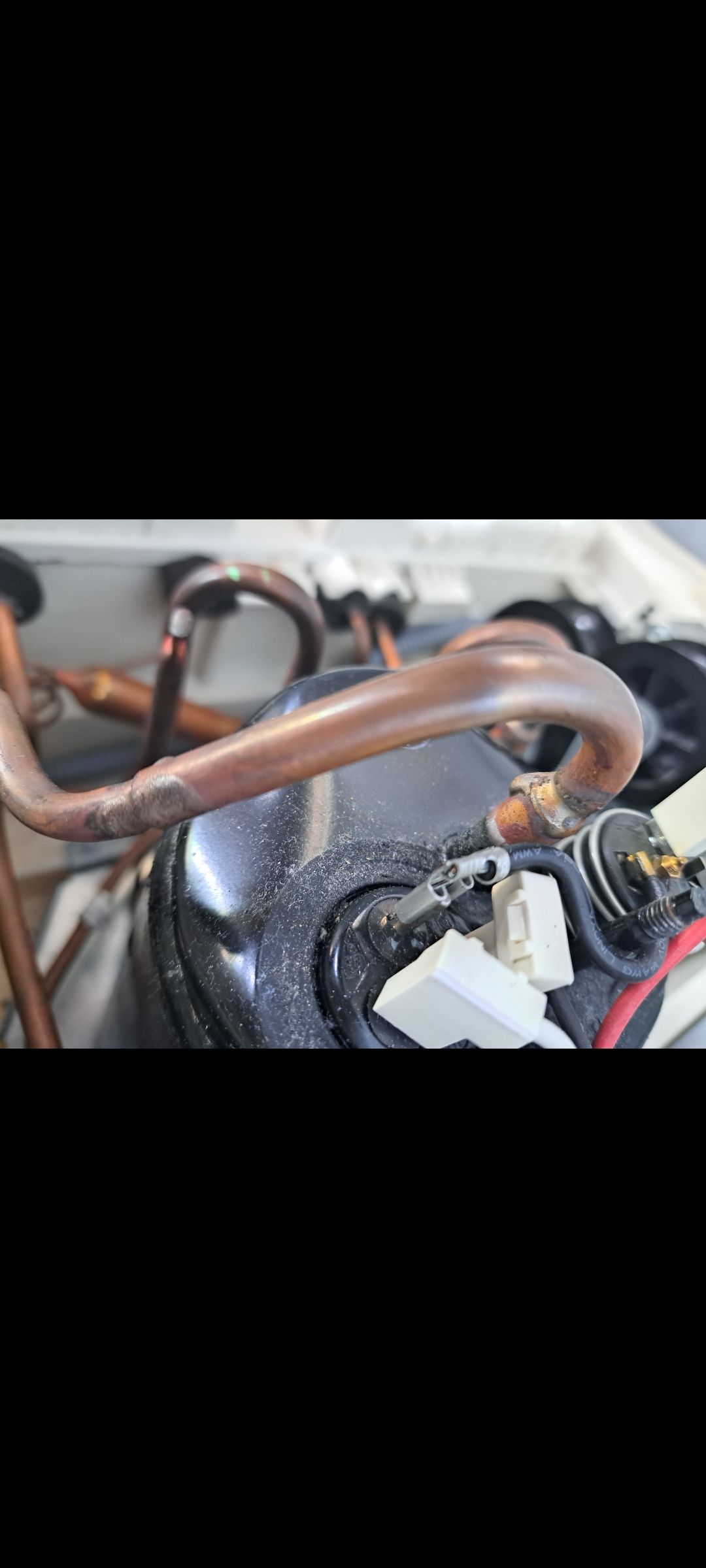

            Very unlikely that if the evaporator coil froze up that you would split the coil or spring a leak however if you had a restriction on the high side either because of a plugged filter dryer or metering device failure it possible but not very likely unless the coil is in very bad condition ( or just plain quality issues ) more often than not it is from bad brazing joints not done correctly is more often the cause for a leak problem

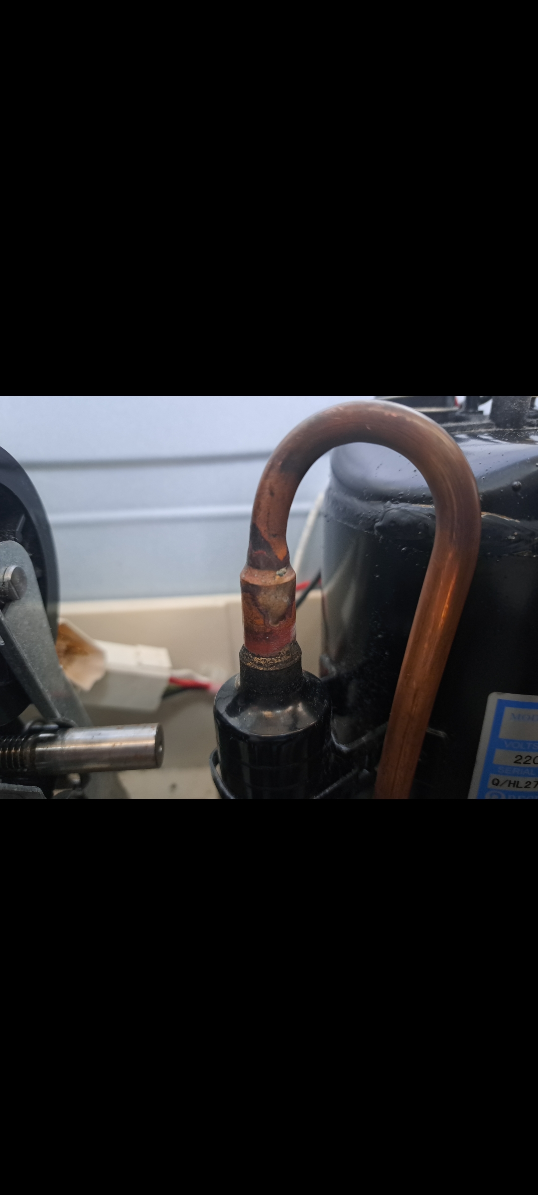

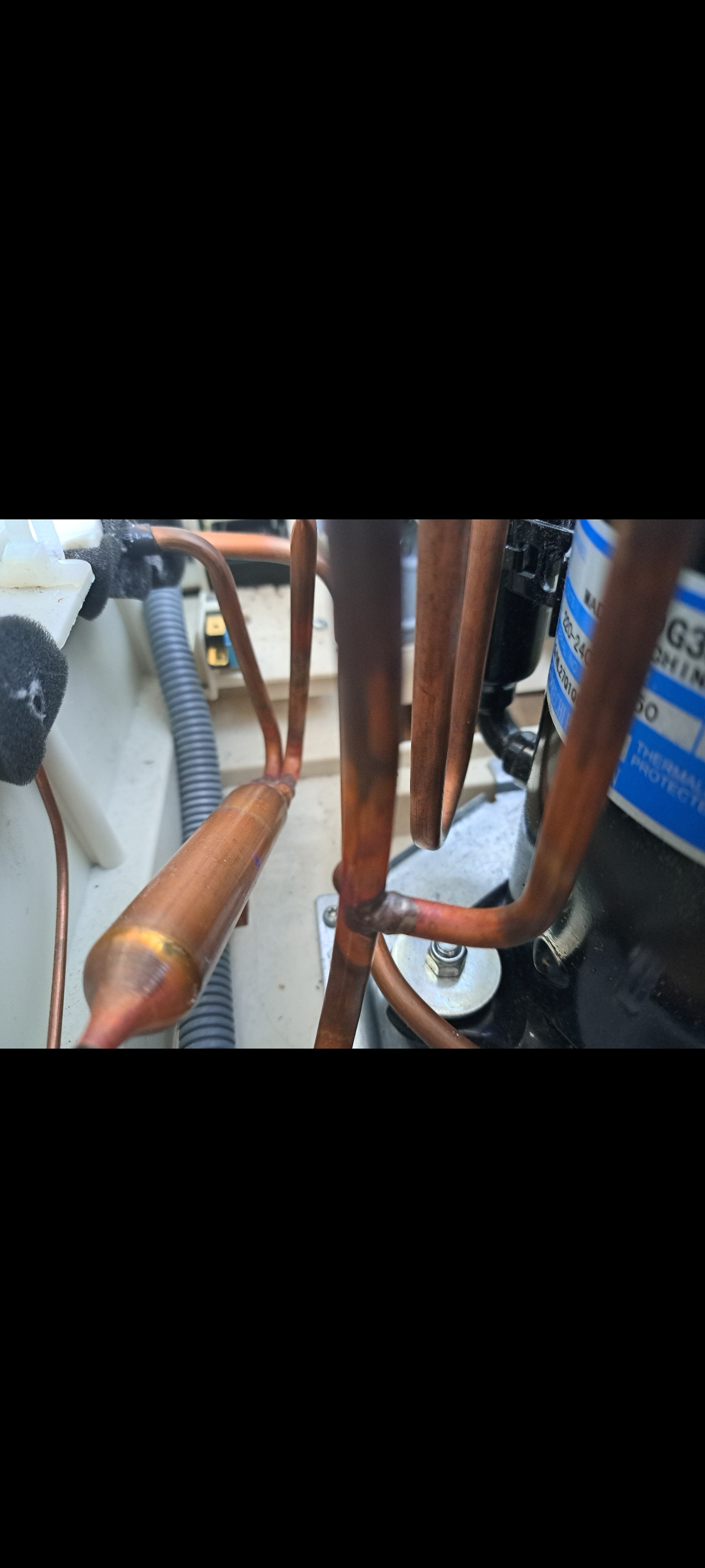

            Take more pictures of the brazing joints and let see if this is a possibility or not

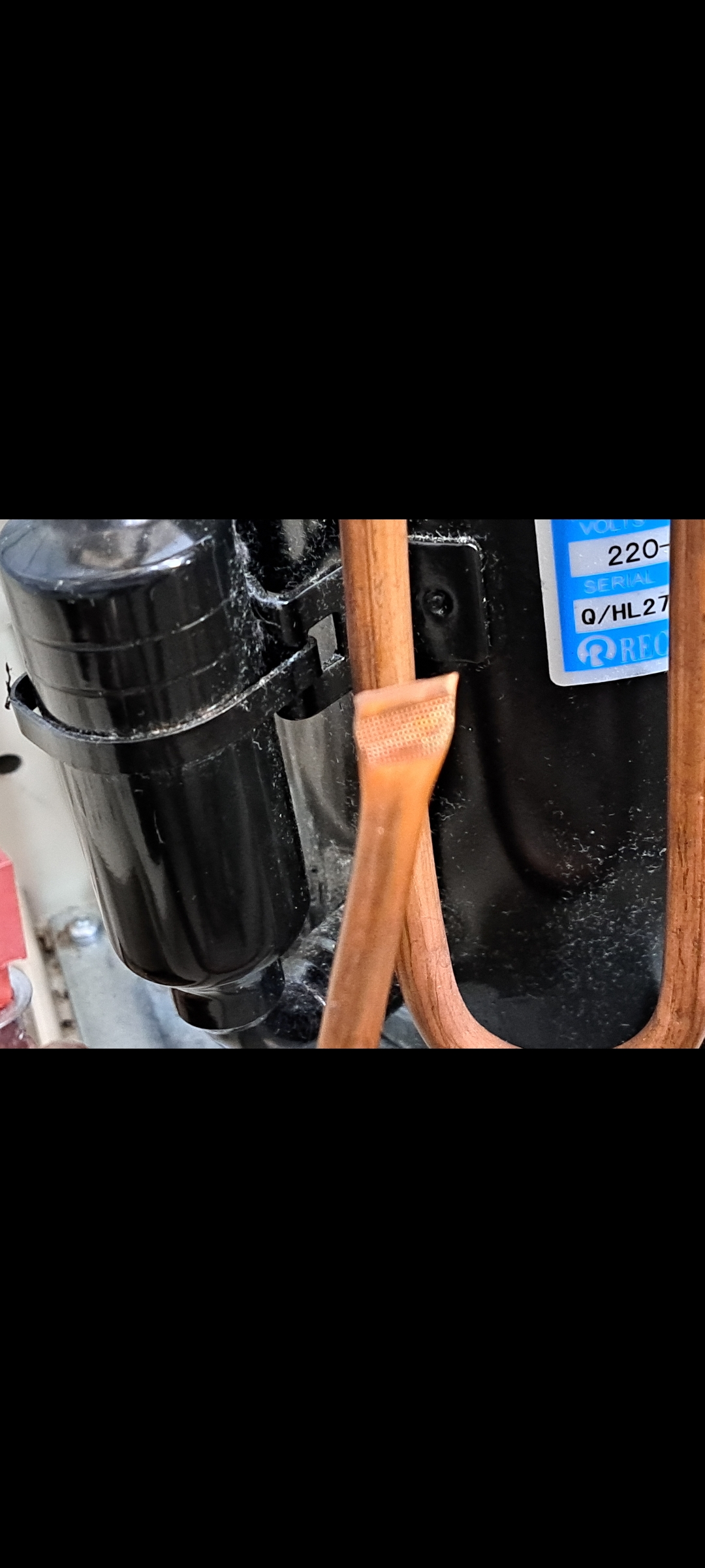

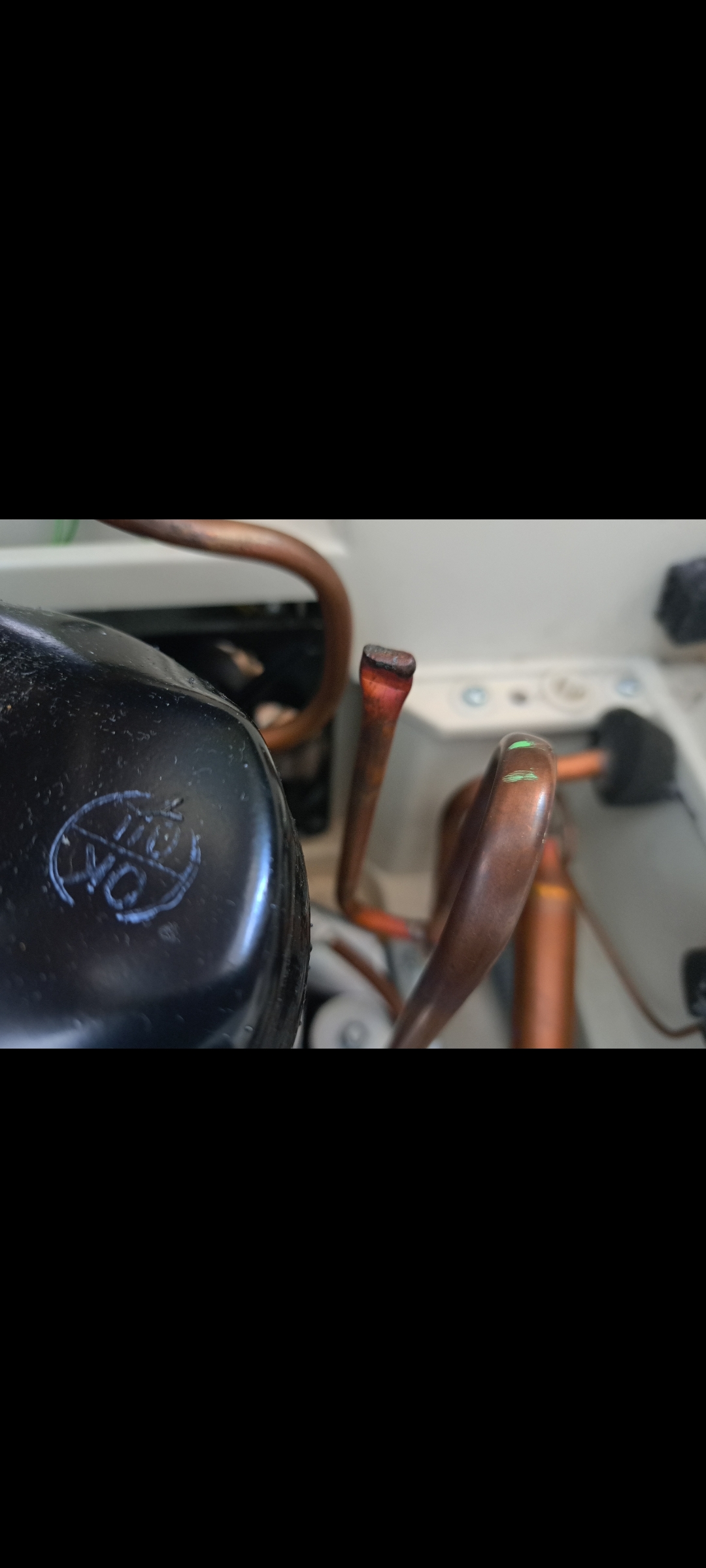

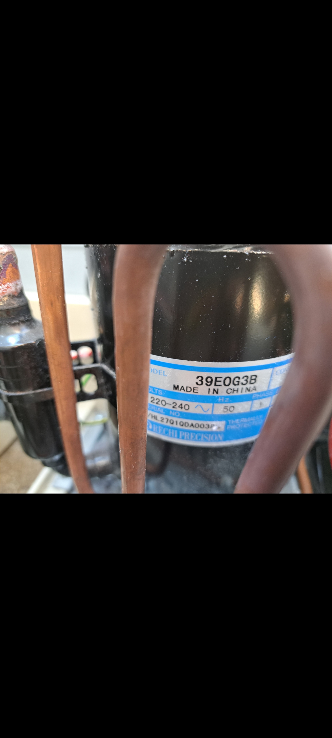

            One note the picture of the compressor terminals and over load was a very good and important picture for me to look at

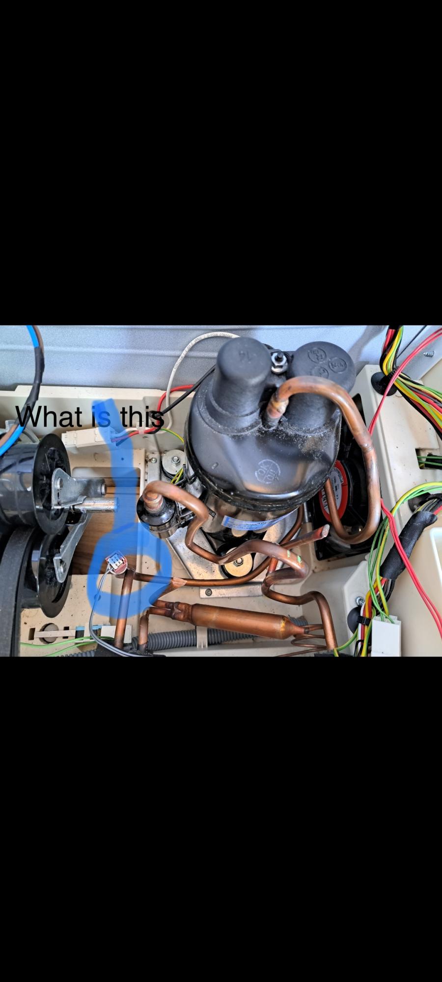

            What is the item that I circled in blue is it a temperature sensor switch or does it have a tube on the device I can not tell from the angle at which the picture was taken to know what exactly is this device
            I hope this helps you figure out what is wrong with your dryer

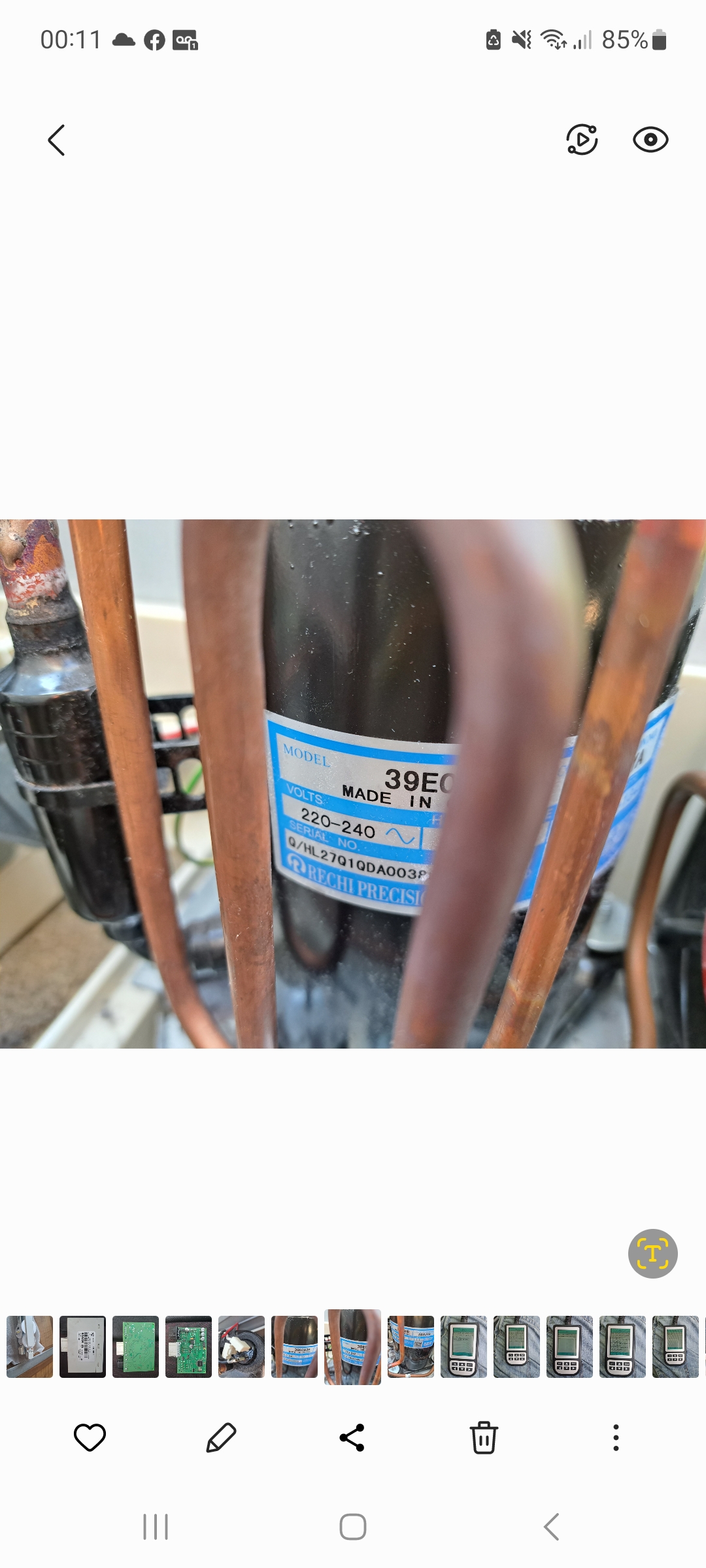

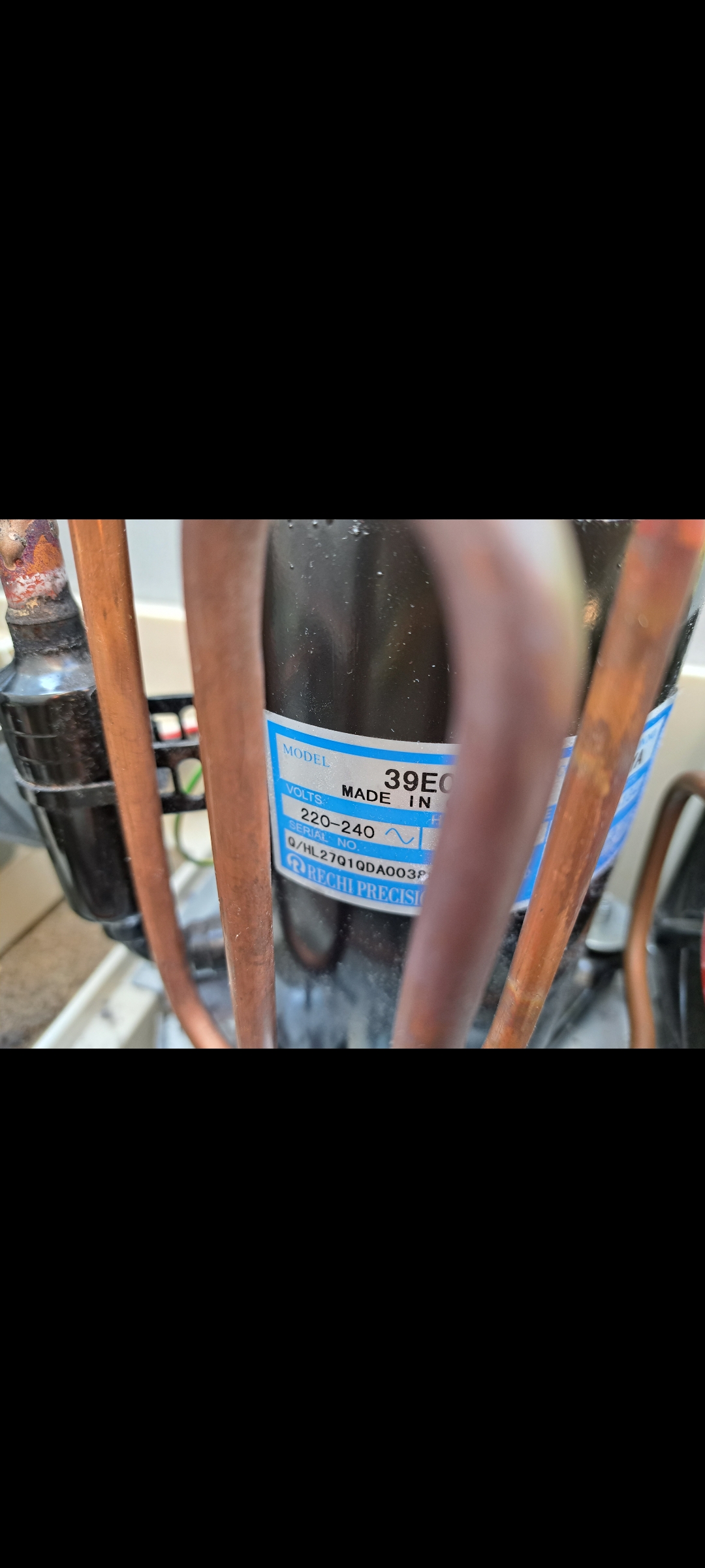

              There are no metering/pressure switches only an ntc temperature sensor (circled in blue which reads 25kohms at room temperature), on the high side which does get warm but might only be from conduction through the pipes from heat generated from the compressor.
              The overload switch located on top of the compressor is good, continuity when cold. The compressor coils have low resistance between run/common (16ohm) and start/common(14ohm).
              The 12uF start cap is about 9.5uF but have connected another in parallel to get around 15uF just to ensure the compressor is getting enough power at start up.
              The compessor does run and is relatively quiet. Also the fan does cut in after some time.

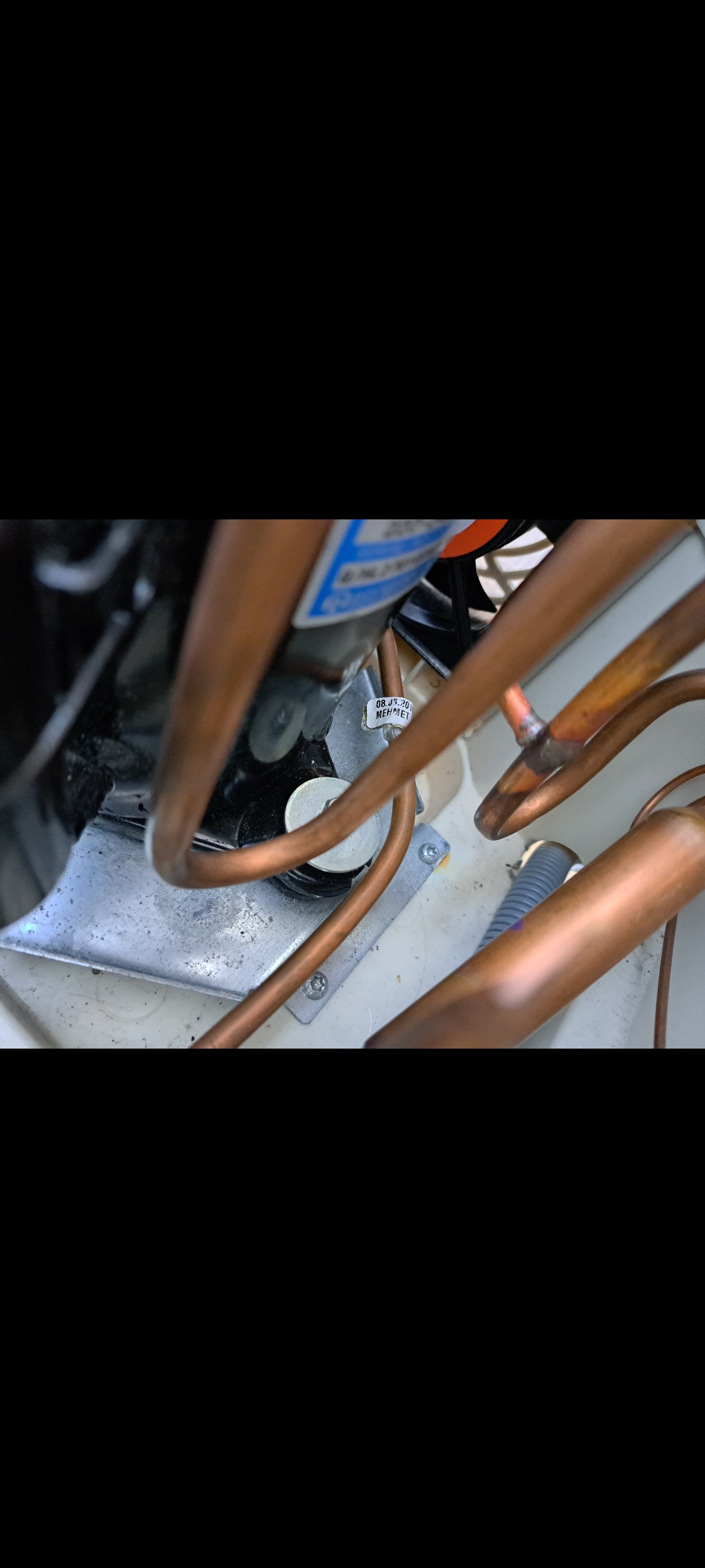

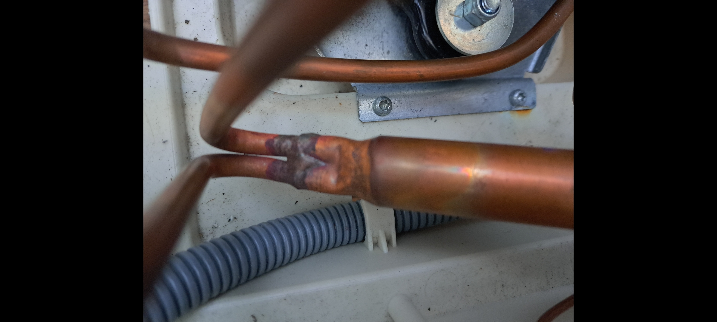

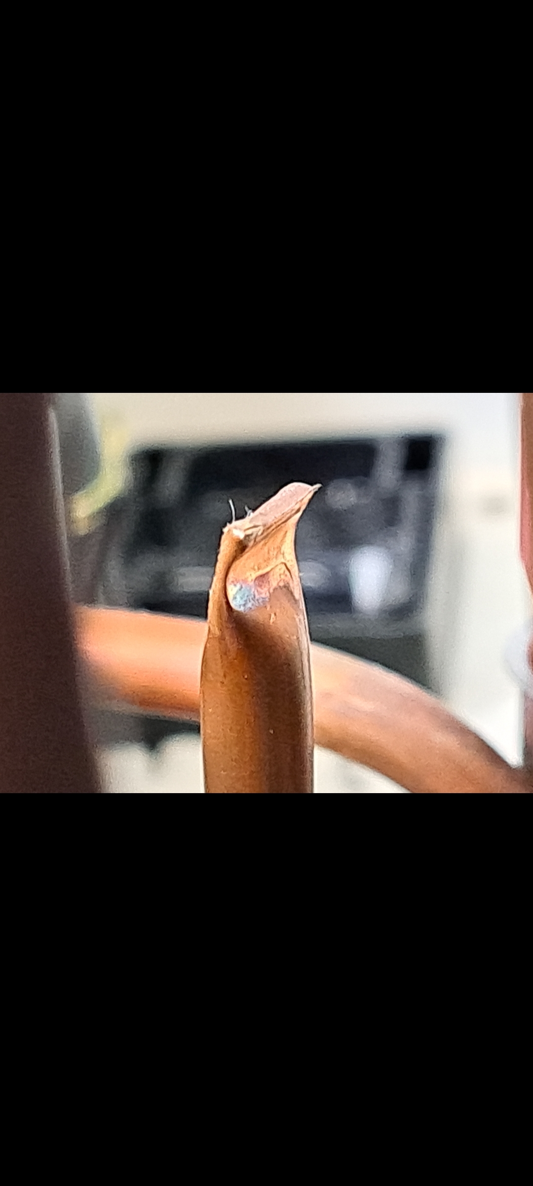

                Photos of joints currently exposed. Shall get photos of evaporator/condenser too.

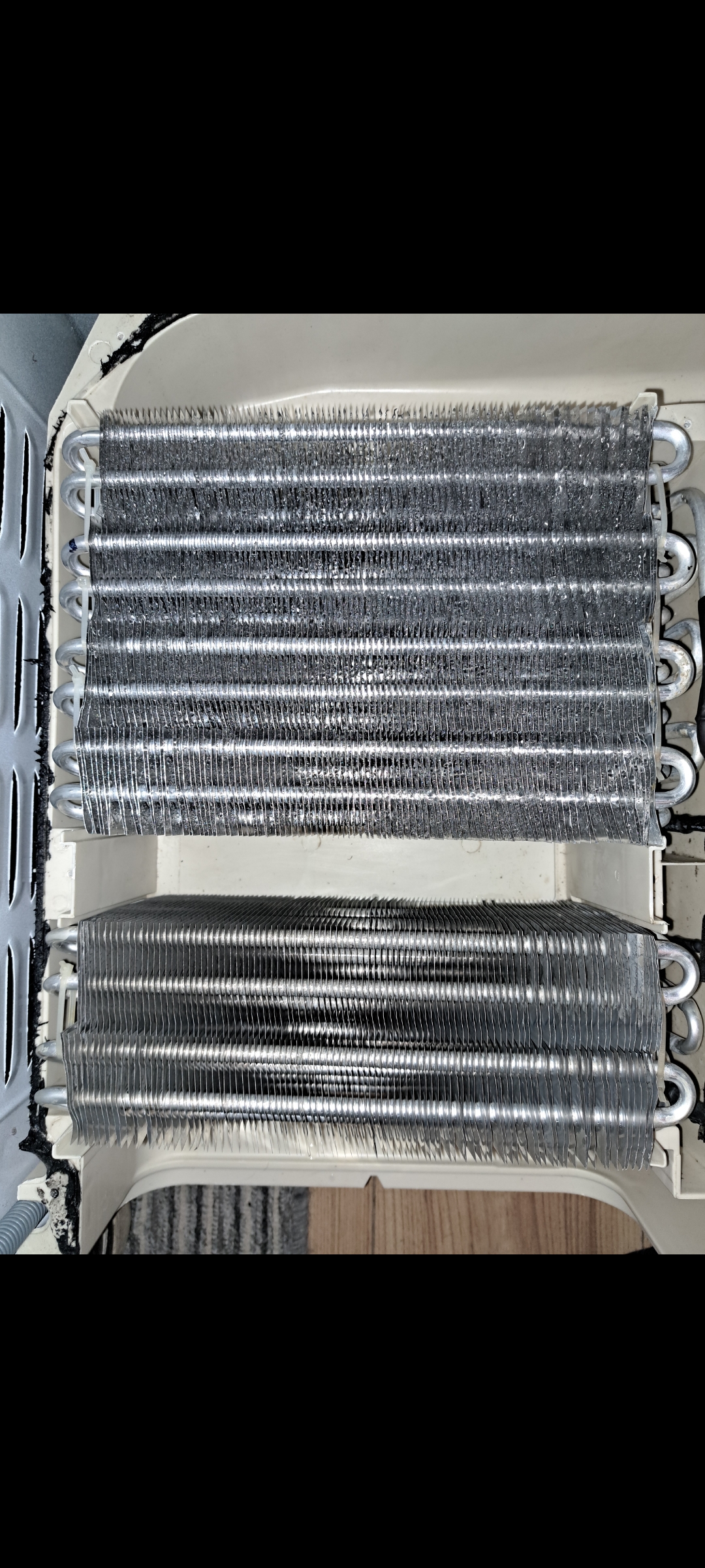

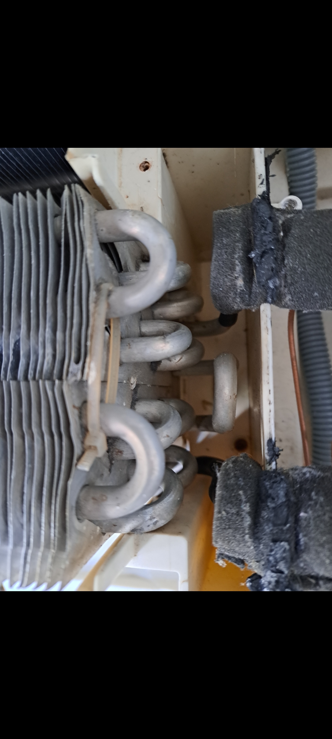

                    Evaporator and condenser photos, without removing completely its not easily accessible to take decent photos really.

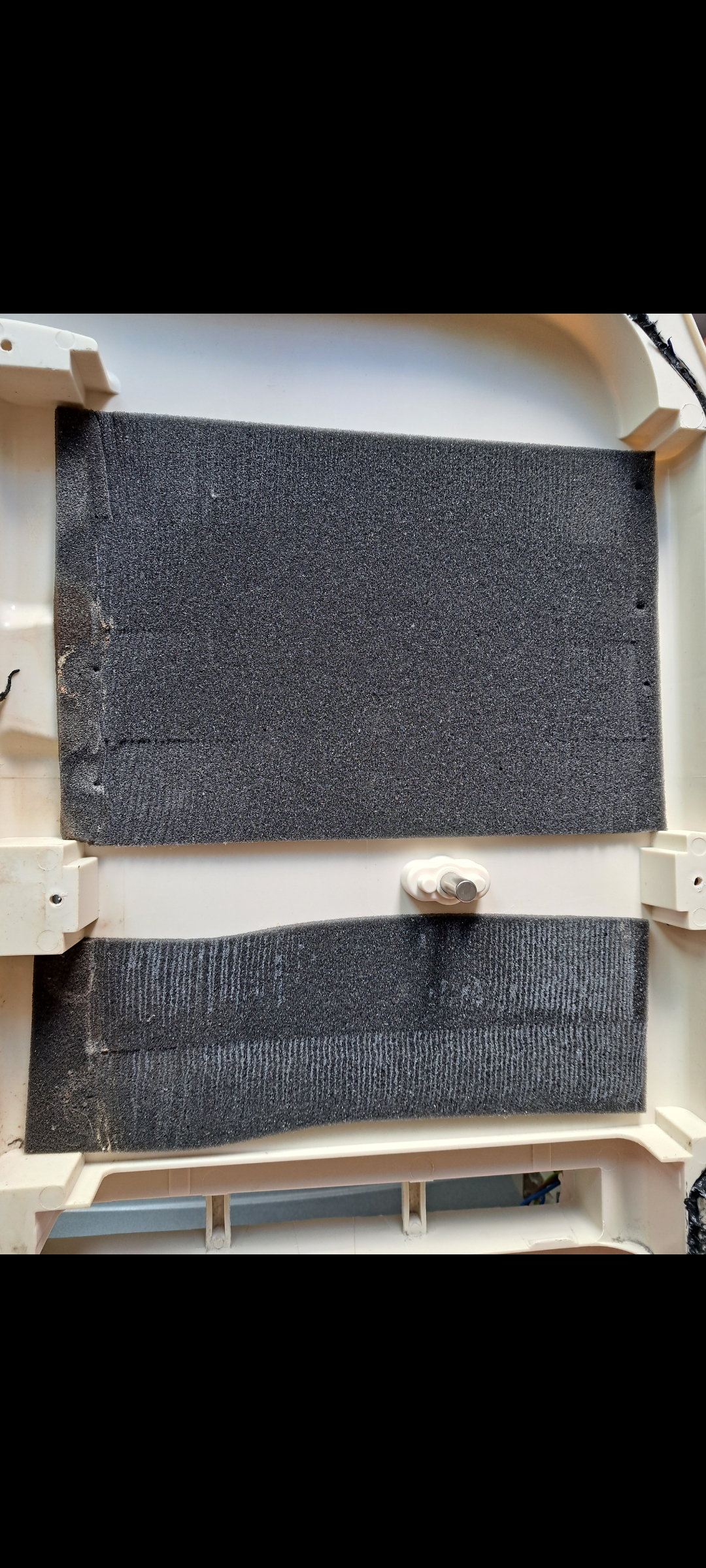

                      Photo of underside of the cover in case its of interest.
                      • notallbad
                        • Oct 2012
                        • 1190
                        Re: Heat pump tumble dryer regas
                        couple more photos, looks crimped rather than soldered
                          • Jul 2011
                          • 6070

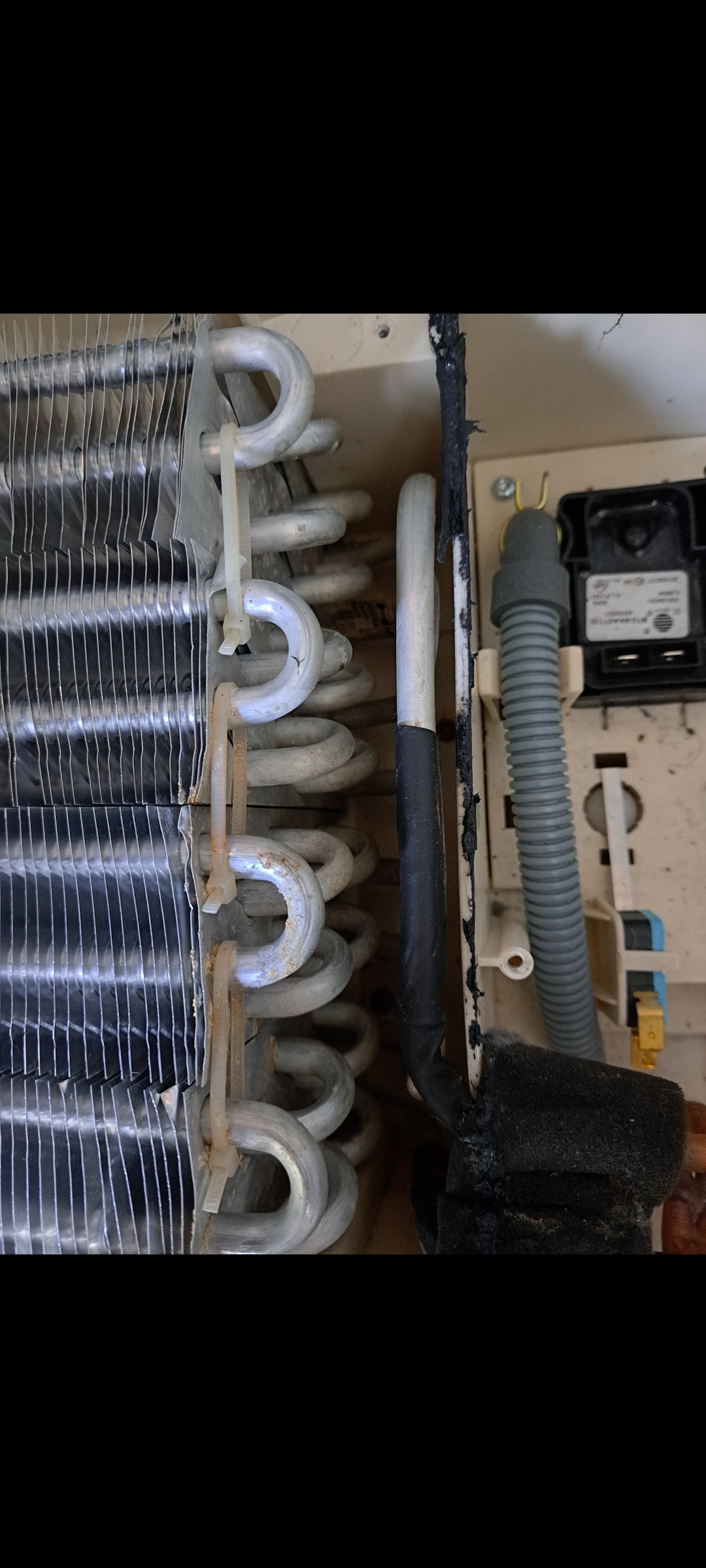

                          This is one big reason why you are having issues with this dryer going by the pictures above in post #11
                          You definitely need to clean this very badly but I caution you about how to clean it properly you need get a fin comb and gently clean the coils with it but make sure that you have the right one other wise you will damage the coil and it will take a lot of time to straighten out the fins you also need to use an alkaline coil cleaner not the the acid type ones you need to get the heavy stuff off of the coil first before you any else
                          Now you can try to clean the majority of it off with compressed air however make sure that you go from the other side of the coil so you do not trap all this lint in side the coil also be careful about how much air pressure you use now you might be tempted to use a pressure washer you could but do not get to close the fins because you will bend them all closed ( please note that you could use an air gun with a rubber tip if do it this way make sure that only up and down the coil not side by side moment because you will close all the fins that way too )
                          When you think that you have the coil ( clean ) take a flashlight and shine it through the coil and see if you can see light coming through the coil if can see it clearly then you probably have it cleaned it enough for government work standards to really get it clean you would need an alkaline coil cleaner mix that 50% cleaner 50 % water and when it starts foaming add more water ( not to much because you want to keep foaming so it pushes out the lint from inside of the coil ) to it if you see smoke coming out of the coil you need to add more water to it
                          I hope this helps you and you understand what I have here

                            • Jul 2011
                            • 6070
                            This coil looks pretty good not much need to be done to this one
                            • notallbad
                              • Oct 2012
                              • 1190
                              Pictures are after it was cleaned, fuff removed but there was not much if any at all either on the coils or on the front filter though its possible it had already been cleaned before I obtained it. Previous owner said it didnt work.
                              The front coil (I think is the evaporator) does look dirty/discoloured but no fluff build up. Does it need cleaning still?

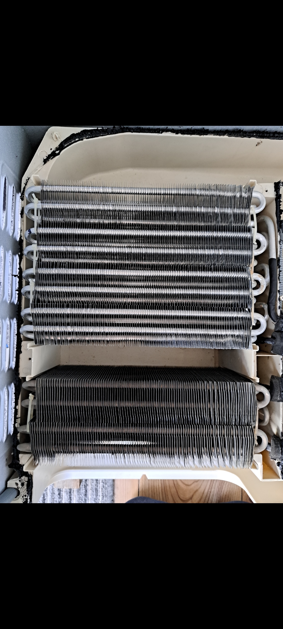

                                  • notallbad
                                    • Oct 2012
                                    • 1190
                                    Cleaned up the evaporator coil, although there wasnt any fluff caught up in the fins the pipes did look somewhat dirty which did not want to simply wash off with water or steam so used a diluted solution of commercial oven cleaner which now makes it look much much better.
                                    Not had chance to test yet, waiting for the oil/refrigerant to settle after having it on its sides and upside down.
                                    I'm not expecting this to make any difference but wanted to experiment to see how best to clean it, what with and what the finished result would look like. Obviously its not possible to scrub anything due to restricted access so need something that will remove it by soaking and then rinsing.
                                    The results can be seen in the photo compared to the before photo in post #10.

                                        Where you live I do not know if you have access to R134A set of gauges that are for automotive style or refrigerator type gauges would be better if you can buy them here in this country you have to have a journeyman license to be able to buy now the automobile type gauges you buy at Harbor Freight and place like that
                                        There pliers that have a fitting that makes a very small hole in the tubing that allows you to put Freon in the system you really need two of them to correctly or braze a fitting that has a valve that allows you access when you need to check the system pressure
                                        The system pressure is going to be the same as a spilt system air conditioning the setup is the same as a dehumidifier system it nothing out of the ordinary
