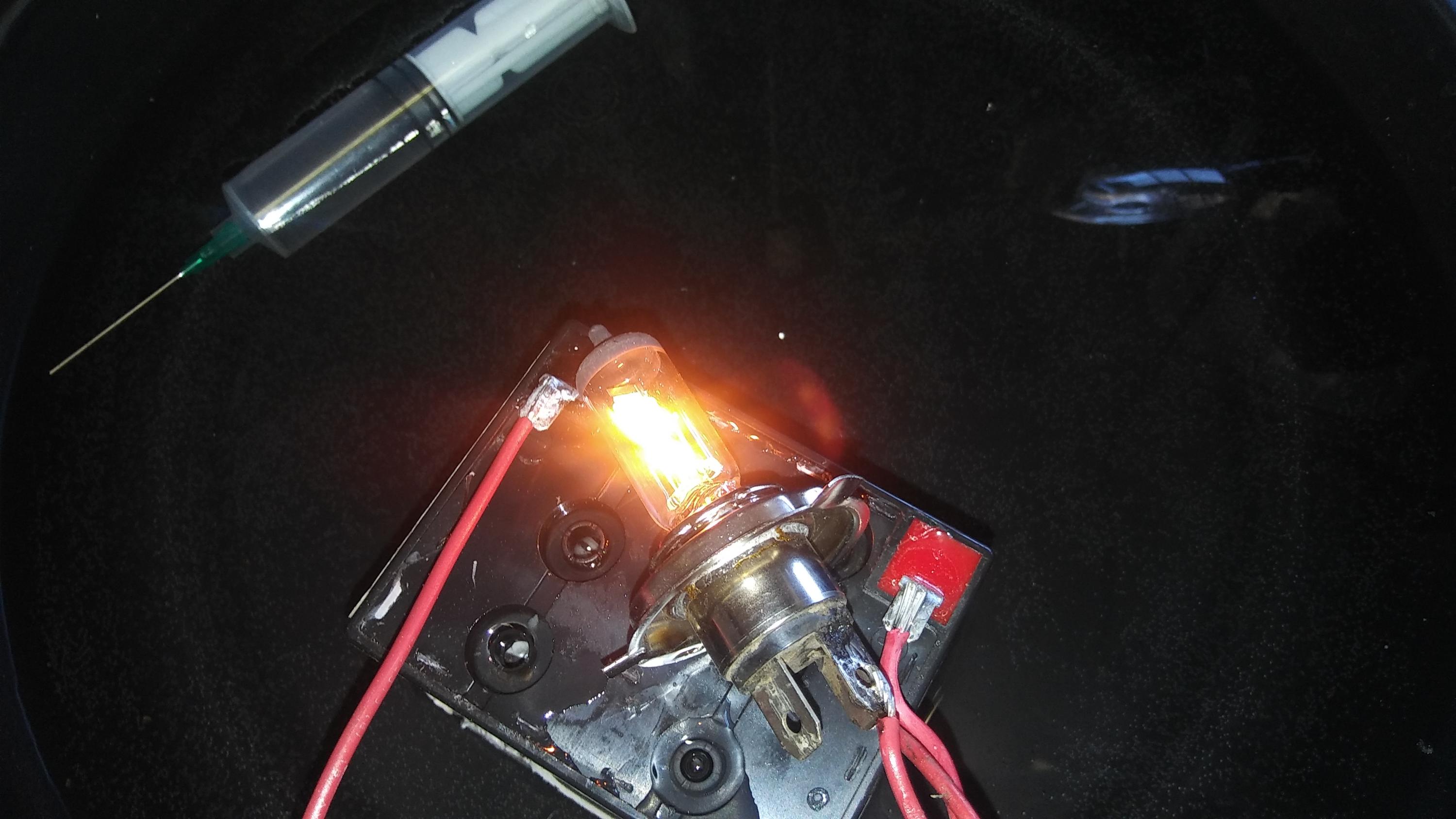

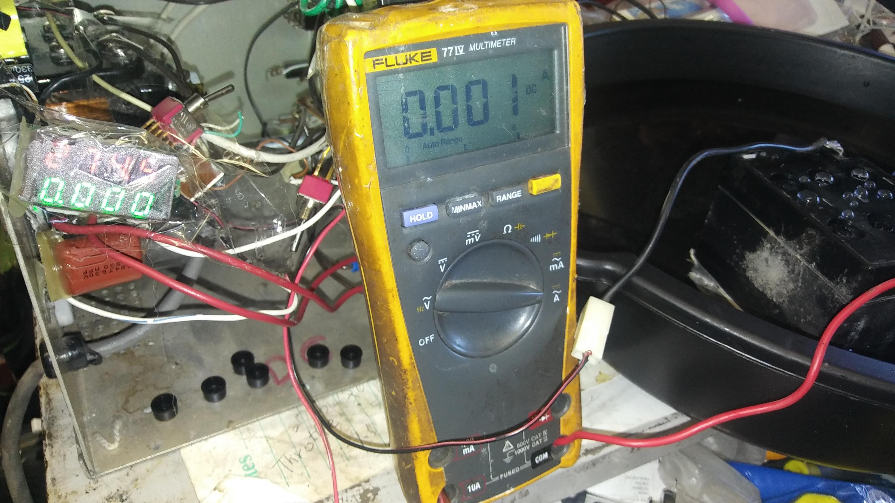

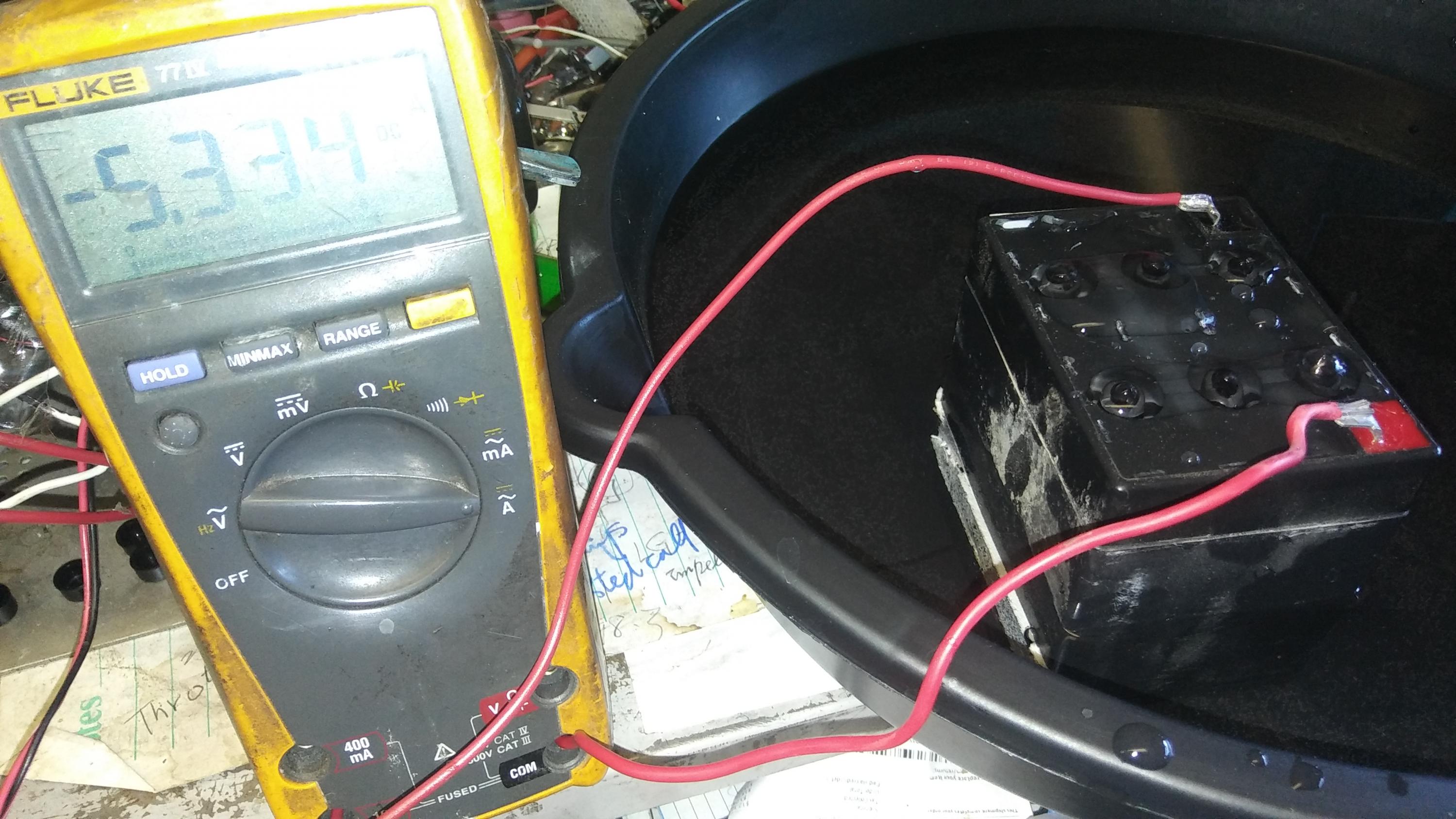

    I use Epsom salt try to rejuvenate, no water, for Razor E100 electric scooter, 12 volts 4.5AH, totally dead, battery.
    I filled it with Epson solution and I tried to charge it up with 247.4 volt DC voltage still nothing happened so I changed the polarity of the battery then it works up to 5A charging current.
    My question is can the battery be used as reverse voltage, I mean black terminal is +12v and red terminal is ground?

      Yes, lead acid batteries can be charged in reverse due to its mostly symmetric design.
      Don't sweat it though. The battery is already ruined.

                      Lead acid batteries can fail due to sulphation or the plates corroding.
                      If the plates are shot and you give it the sulphation treatment, it will just make lots of hydrogen and waste your time.
                      I have never been successful reversing sulphation, electron microscope pics show the lead sulphate crystals are non-conducting and stuck in the pores of the plates. Very hard to dislodge or dissolve.
