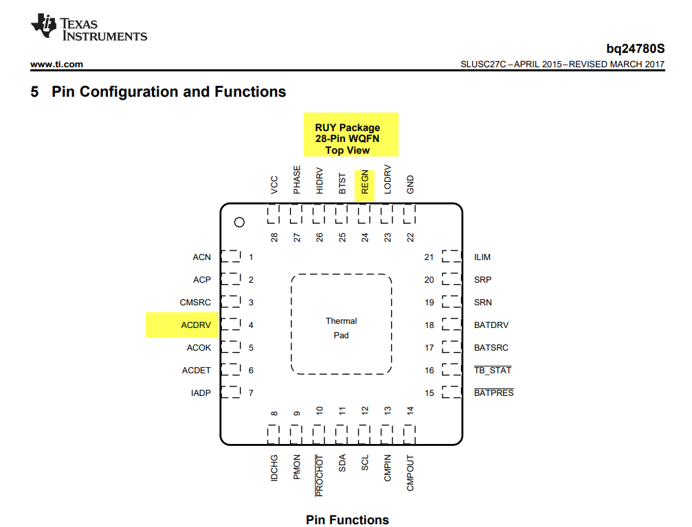

              Only the battery mosfet is a suspect with the source / drain measurement. As a quick test, it can be fluxed and removed to isolate this part off the board. The battery should still charge without this part onboard.
              What is the gate voltage of each of the DCin mosfets with the adapter attached to the logic board? Being N-channel, the enable voltage should be adapter_voltage + REGN voltage = ~25volts.
              Confirm this voltage if absent on the gate pins at the ACDRV pin on the charger IC = pin #4. Also confirm, if necessary, the REGN voltage @ pin #24.

                With adapter plugged in:
                - Voltage is indeed 25.76V stable at the gates of the two DCIN MOSFETS.
                - Voltage at the ACDRV pin on the charger IC (pin #4) fluctuates between 6.86 and 8.40V.
                - REGN voltage (pin #24 of charging IC) is 0V.

                • mon2
                  • Dec 2019
                  • 14652
                  If you have ~25v on the gates of the DCin mosfets, then the ACDRV pin is also @ same voltage since this is the boosted voltage output pin on this charger IC. Perhaps measuring the wrong pins on the charger IC?
                  Also, the same for REGN. If you have ~25v on the gate pins then REGN is also working and should be ~6 volts here.
                  What are the topside markings of the battery mosfet? It should be an N-channel type so for this to enable, the gate pin must be also higher than the voltage being passed between source / drain pins of this mosfet. For the above case, with only the adapter connected, this mosfet should be OFF since the gate voltage is lower, then the N-channel mosfet will be disabled. Looks to be ok here. If in doubt, you can flux and remove this mosfet.
                  The battery should receive a valid charge voltage if the power adapter is powering this logic board.
                  At this time, is there any charge on the battery? If you connect the power adapter & battery, what are the voltages on the battery connector? Also share the voltage markings on the battery itself. To charge this battery, the charger voltage should be slightly higher.

                    My mistake, I indeed measured the wrong pins on charger IC. Find below correct values:
                    - Voltage at the ACDRV pin on the charger IC (pin #4) is 25.77V.
                    - REGN voltage (pin #24 of charging IC) is 6.02V.

                                          The BQ24800 was replaced since it showed signs that it was part of the problem, but possibly the battery was flat at that moment.
                                          If I insert the 19V adapter in the DC jack and measure the current sense resistor's voltage it fluctuates between 0V and 19.5V and the keyboard backlight flashes (probably because the battery is almost flat. It does the same when I run the laptop from battery).
                                          There's a...
