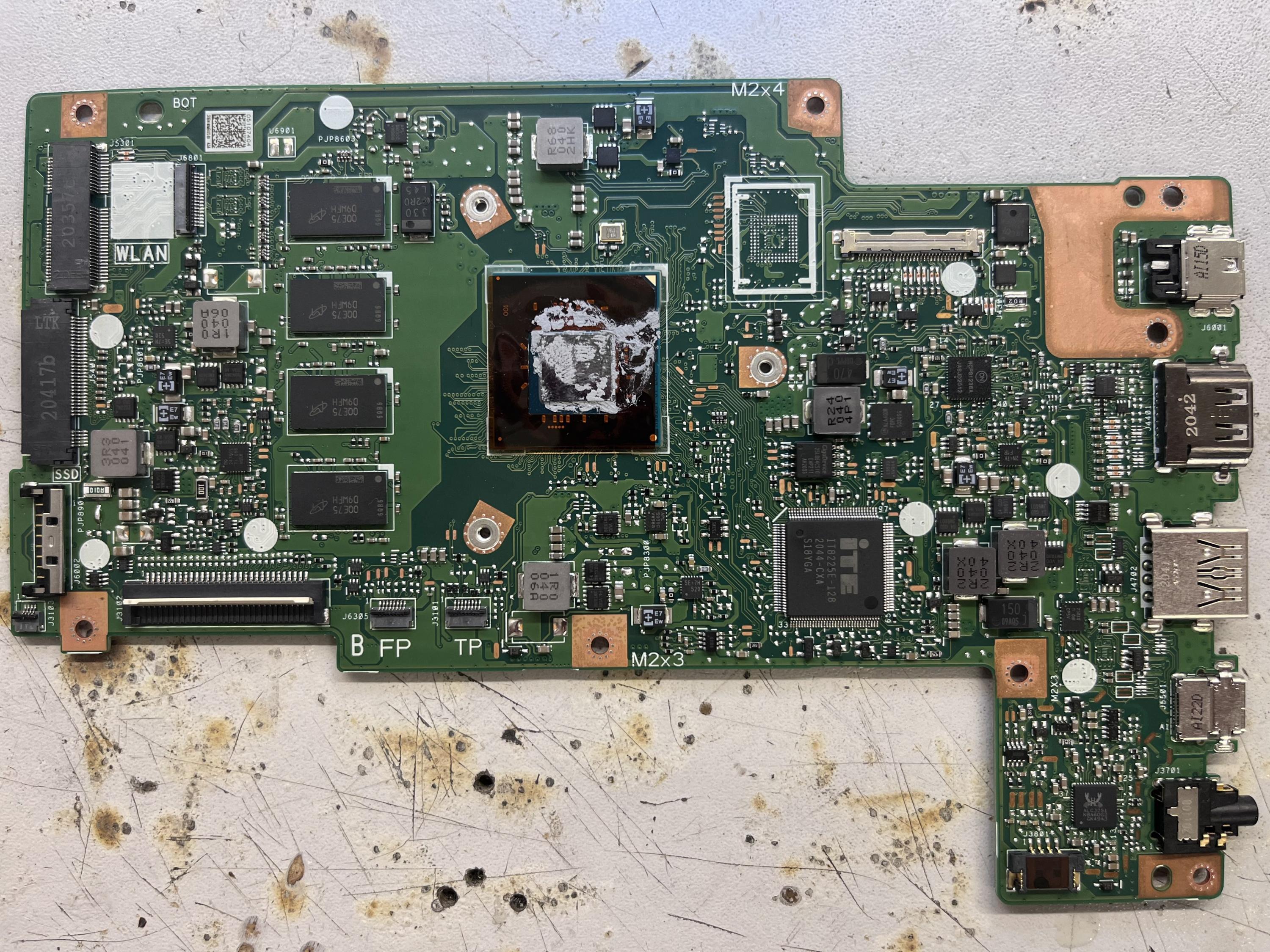

    Hi everyone. Fixed my AC and despite trying to be extra careful, I reversed polarity and got a notable pop sound. Now the PC will only work on battery. Windows still shows the battery as charging but the count actually goes down until empty (I have two of the same laptops).
    I have board R3.0 so the schematics on another thread here do not match mine. I have tested the BQ charge IC and my pin 1, 2 and 3 have 3.35v each - instead of 18v or 19v. Could this be a bad BQ IC or capacitor? Any thoughtful advise sould be greatly appreciated.
    Mobo shows no visible sign of a fried component

    Which BQ charger IC? Post topside pics of the charger IC.

        Post pics of this charger IC. The voltage at these pins is incorrect. Do you see any imperfection on the topside of this charger IC or any other nearby parts? Study where the battery mates with the logic board and continue to review each part to this charger IC.
        Alternatively, you will need to very carefully measure the voltage to ground of each and every pin on this charger IC while the battery & power adapter are attached. Post each measurement in a table with their pin number and function label (ie. ACN / ACP, etc.).
        If this IC is working and powered correctly and the power adapter is deemed to be suitable, then the ACDRV pin will be boosted to 25 volts to enable the 2 x DCin mosfets. We need to study each of the DCin mosfets to confirm the power adapter voltage is reaching this area and how far is the power path travelling onto the board.

                      my board is this: https://www.badcaps.net/filedata/fetch?id=3309962 and the BQ24780s is near the battery socket (and is marked on top as BQ...) if you can identify both it and the inferred mosfets and resistor. But I have also seen some mosfets there indeed and will attempt to test them. But the pic above also shows some markings when zoomed it seemed. I shall feedfeedback shortly soon.

                        Okay it is located bottom left of the ram chips. I see two mosfet to its left. Assuming those are? And if the said resistor can be visually identified. But I am Trying to test the mosfets now.

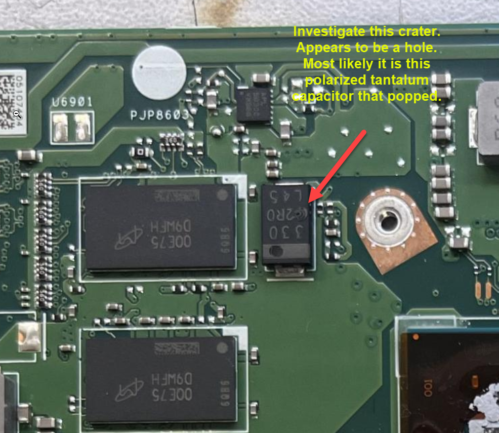

                                        See attached.
