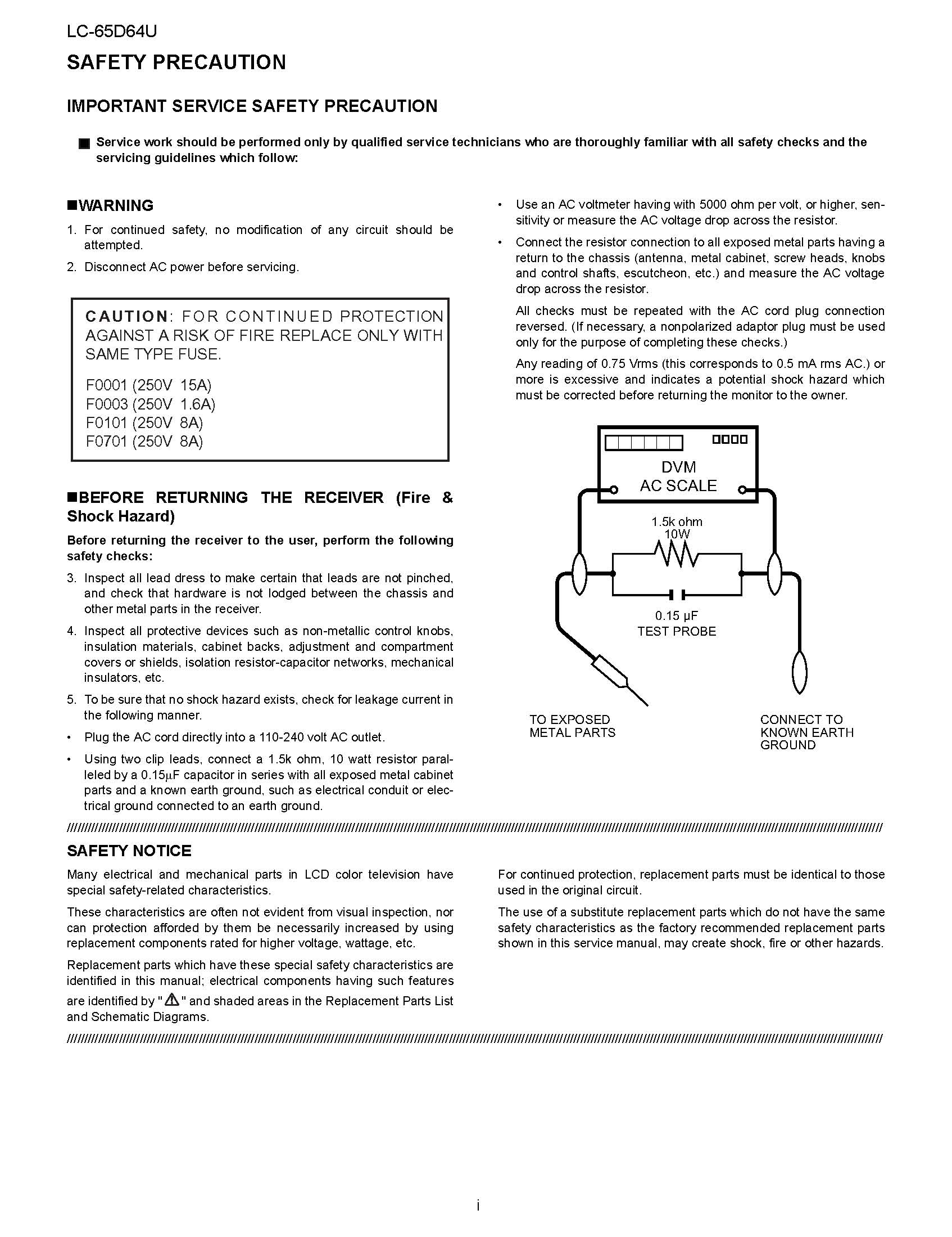

                            Re: Voltage on heatsink
                            I always use GFCI when working on the TV EVERY TIME, no fault tripping yet and if it does I will find out why because there is leakage current limit for monitor/TV. Look at service manual sometime.
                            BTW, here is the TV allowable leakage current.
                            I wonder how may repair shop bother to do safety test, it only take one law suit to wipe out your business. Most shops just do not care.
                            https://www.evaluationengineering.co...safety-testing
