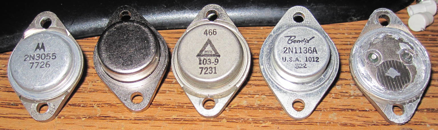

    I was looking through my junk pile and wanted to identify this TO-3 cased apparently transistor that's marked "M" and "10261".
    From my googling around this may be a 2N3055 clone. I tested the B and E pins, and sure enough it seems like a normal B-E junction for a silicon NPN transistor.
    However, I get no conductivity to the case at all (which is usually collector). While this probably means it's bad, this is a very strange failure mode as the collector is usually bonded to the flange on these devices and getting it to go open circuit is kind of tough (no die bonds to break.)
    So, what is this device? (Trash, I think, but how could it fail in this way?)
    This might end up getting the dremel treatment for curiosity...

    I was able to find another psu of the same type and used standard JEDEC numbering.
    The 10261 is a 2n3055 and the 10262 was a 2n3773 in that photograph, so my hunch was correct that the 2n3055 was not a good sub for the 10262... And clearly the 10262 is NOT PNP!
    The 2n3771 is also probably not a good fit due to low Vcemax. Hum.

                          After thinking about it a bit, maybe it didn't get sheared off and perhaps the die broke off from the setting, and that's why the collector went open... Hmm. Either case, the die is gone, not sure if it suffered grinding from the cutter or it fell out...
                          • eccerr0r
                            Solder Sloth
                            • Nov 2012
                            • 8701
                            Re: Failed Motorola 10261 ... transistor?
                            Just a stroke of ... luck? I found the remnants of the die.I don't think I have the pieces in the right place but that's the largest fragments I could find.
                            I wonder how tightly bonded the die is supposed to be with flange/substrate, though it does look like I had something to do with the fragmentation of the die.

                                The die looks fine, not melted or burnt.
                                The die attach failed; I believe it can be epoxy or soldered for high-power parts.
                                Epoxy attach is on LED's and seems to be why they fail, they unglue off the substrate or a bond wire breaks.
                                eetimes Die bonding techniques and methods

                                    I think the common bond wire material is aluminum. I wonder if the die-case connection was bad.
                                    Back in ancient times when I opened "TO-3" cases (I think the modern case is TO-204), I used a hack saw very gently, barely breaking through the metal of the dome most of the way around.

                                      Now what's the difference between TO-3 and TO-204, aluminum vs steel?
                                      Pictured left to right:
                                      2N3055 (aluminum TO-3?) (Silicon NPN)
                                      2SC2930 (steel TO-204?) (Silicon NPN)
                                      103-9 (steel TO-3?) (Germanium PNP)
                                      2N1136A (aluminum flange, steel cap TO-204?) (Germanium PNP)
                                      Guts of the 10261 (TO-3?) (Silicon NPN)
                                        https://cdn.badcaps-static.com/pdfs/...3bfced6226.pdf
                                        TO-204 is a newer case designation.
