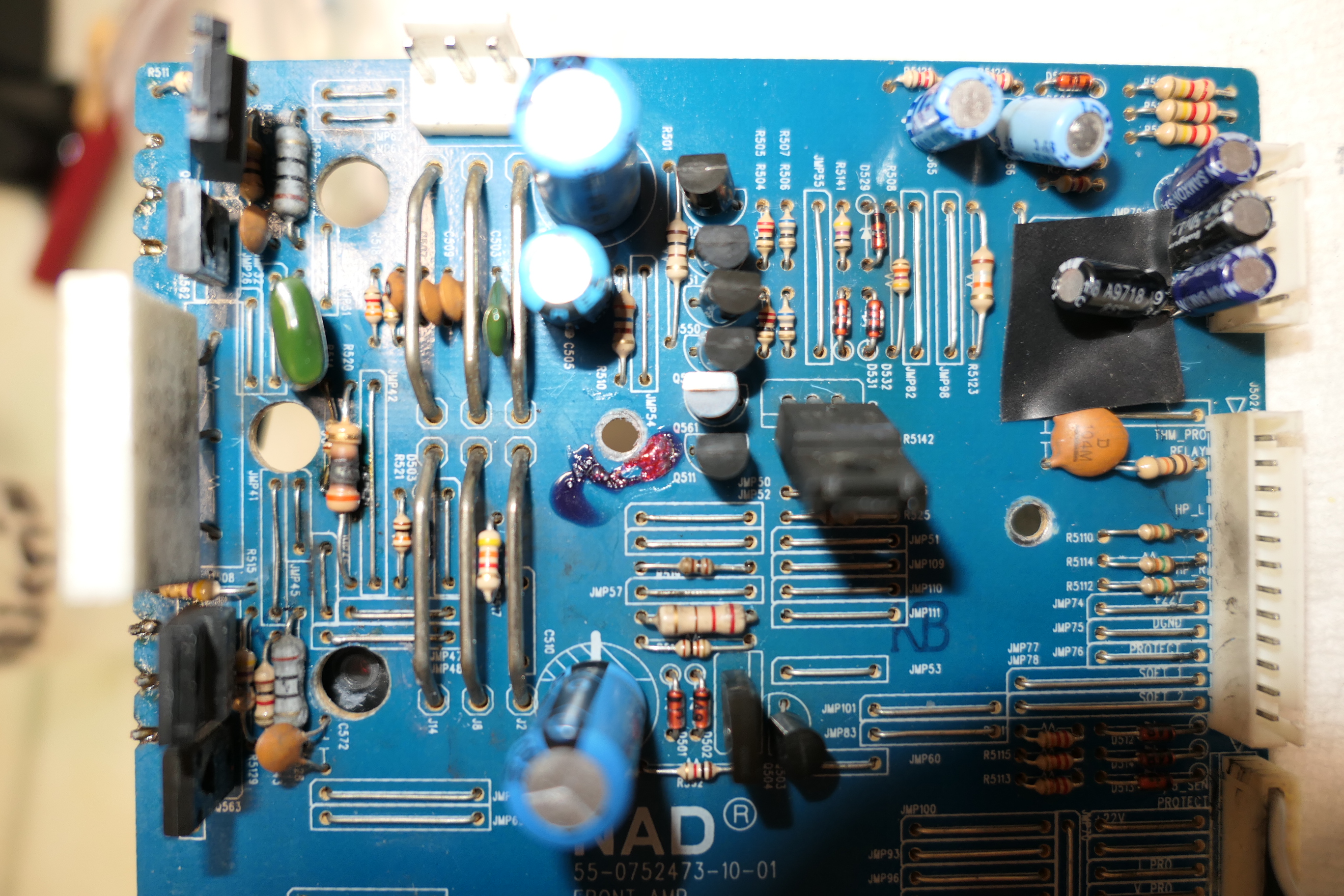

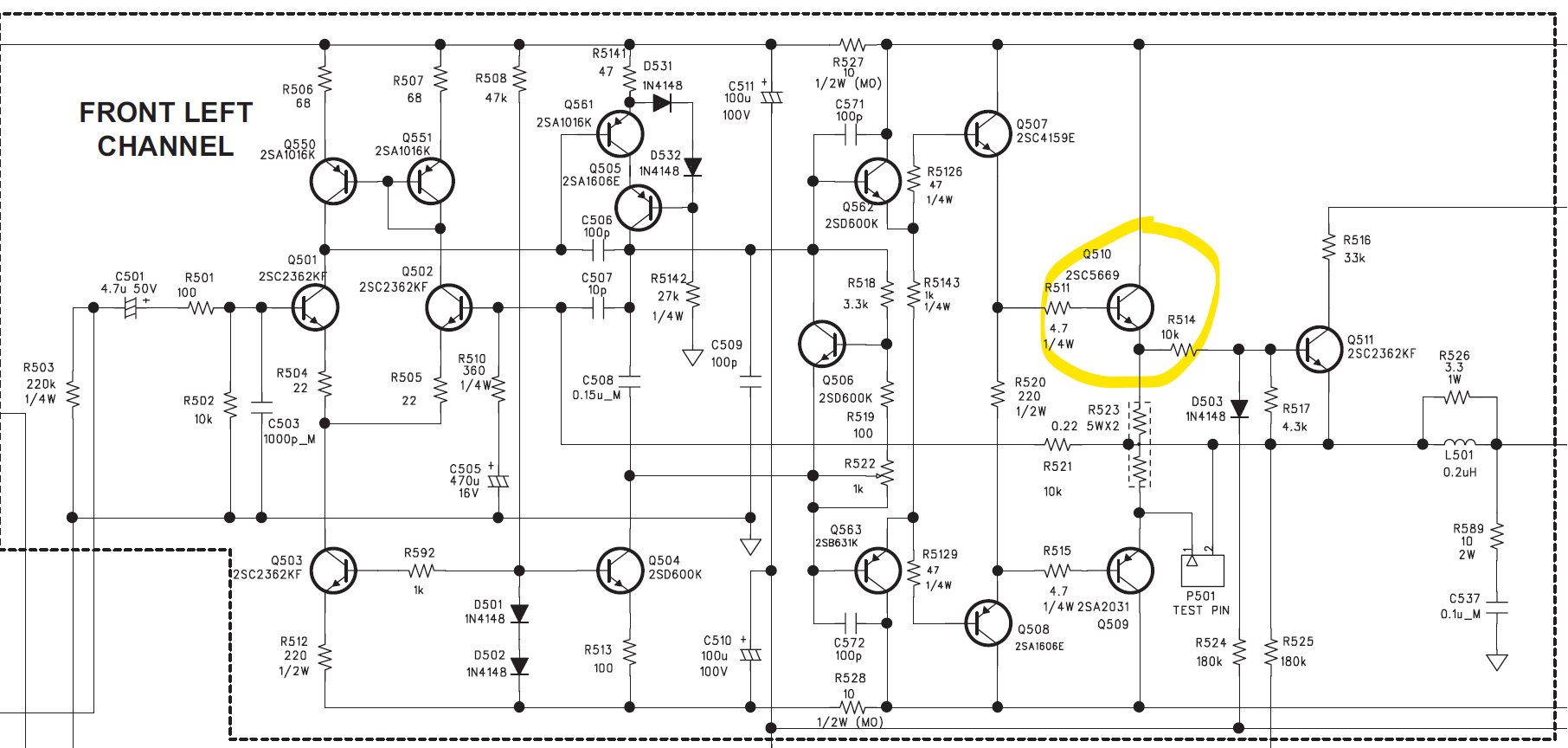

    I guess I need help from the masters to try and find what is frying a 2SC5669 transistor on the left channel of this front center Amp for a NAD T752.
    Was working perfectly and all of a sudden I heard a pop, and then a glow from the amp. Not only did the 2SC5669 burn a leg, but R520 which is a 220 ohm resistor partially burned - it now measures 110 ohms.
    I bought this amp second hand fairly cheap as it was not working, it went into protection mode. I finally traced it down to the same transistor Q510, the one that just popped. It was shorted and so was the paired Q509 2SA2031. I replaced them both along with Q507 (2SC4159E) and Q508 (2SA1606E). I also changed Q511 which is a 2SC2362 which was shorted. Checked every other component on the board for the left channel, removed every transistor and checked them with my transistor checker, checked all caps and changed a few out of range, all resistors, etc. Everything looked fine so reinstalled and it was back to life!
    It played for approximately 4 hours with a beautiful sound. I checked and set the idle current on each channed to 1mV and all was good. After listening to a track fairly loud, is when it popped as shown in the pictures.
    Any ideas what might be drawing so much current on R520 to scorch it and what might be making Q510 pop again? Many thanks for any input, as I'd love to get this amp back to life, it sounds so beautiful!

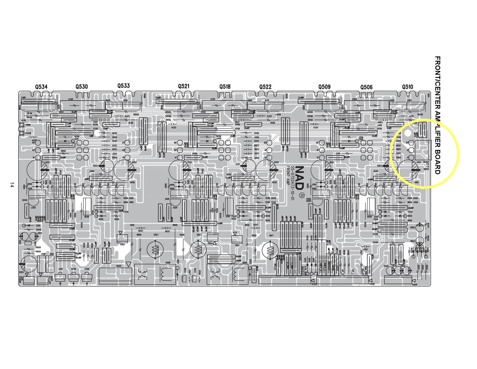

    Here is a photo of the schematic in the pdf file.
    Help and tks!

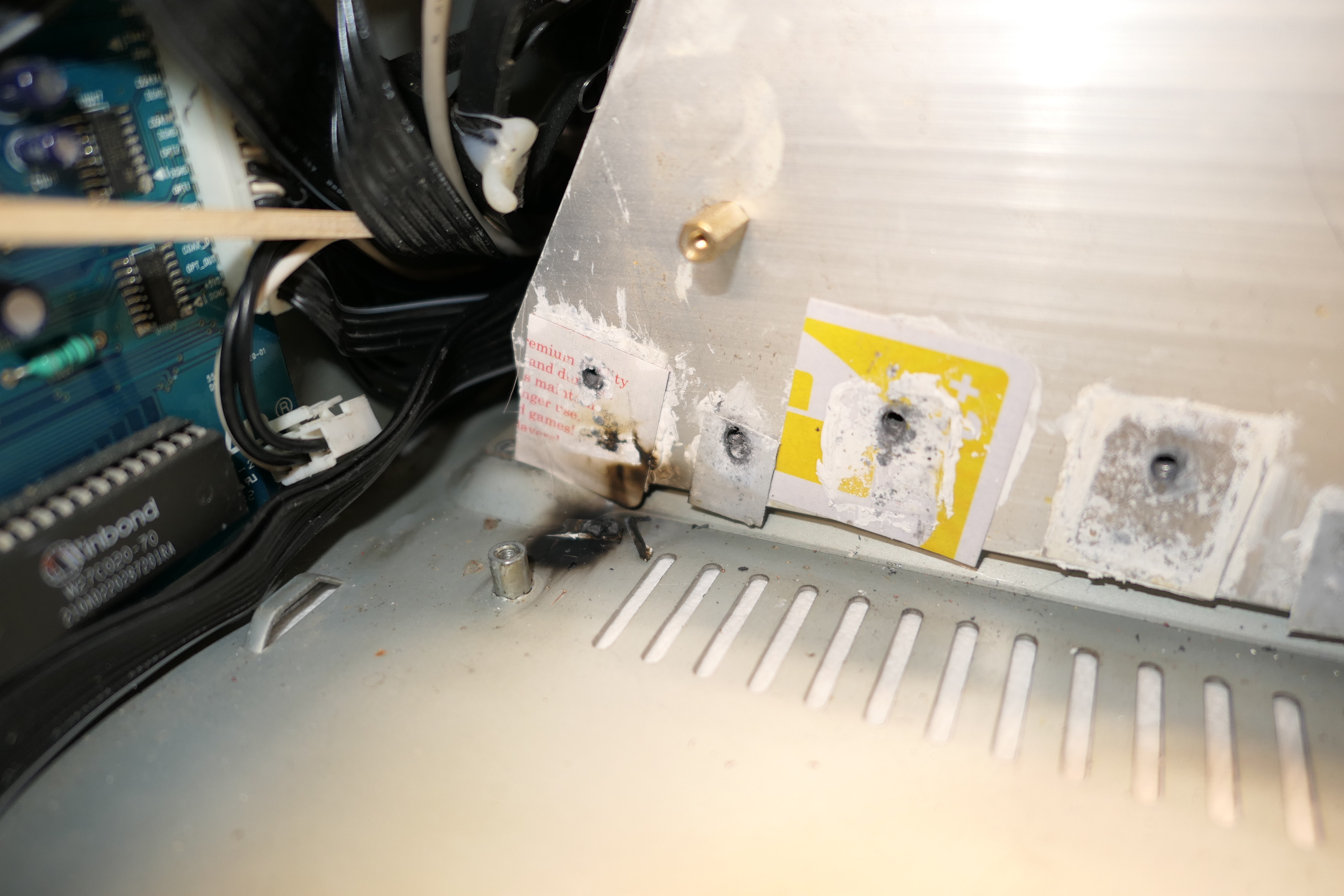

      What type of insulators did you have on the output transistor that blew up? it looks like the collector arced to the heatsink.
      Did you use new insulators and fresh heat sink compound?

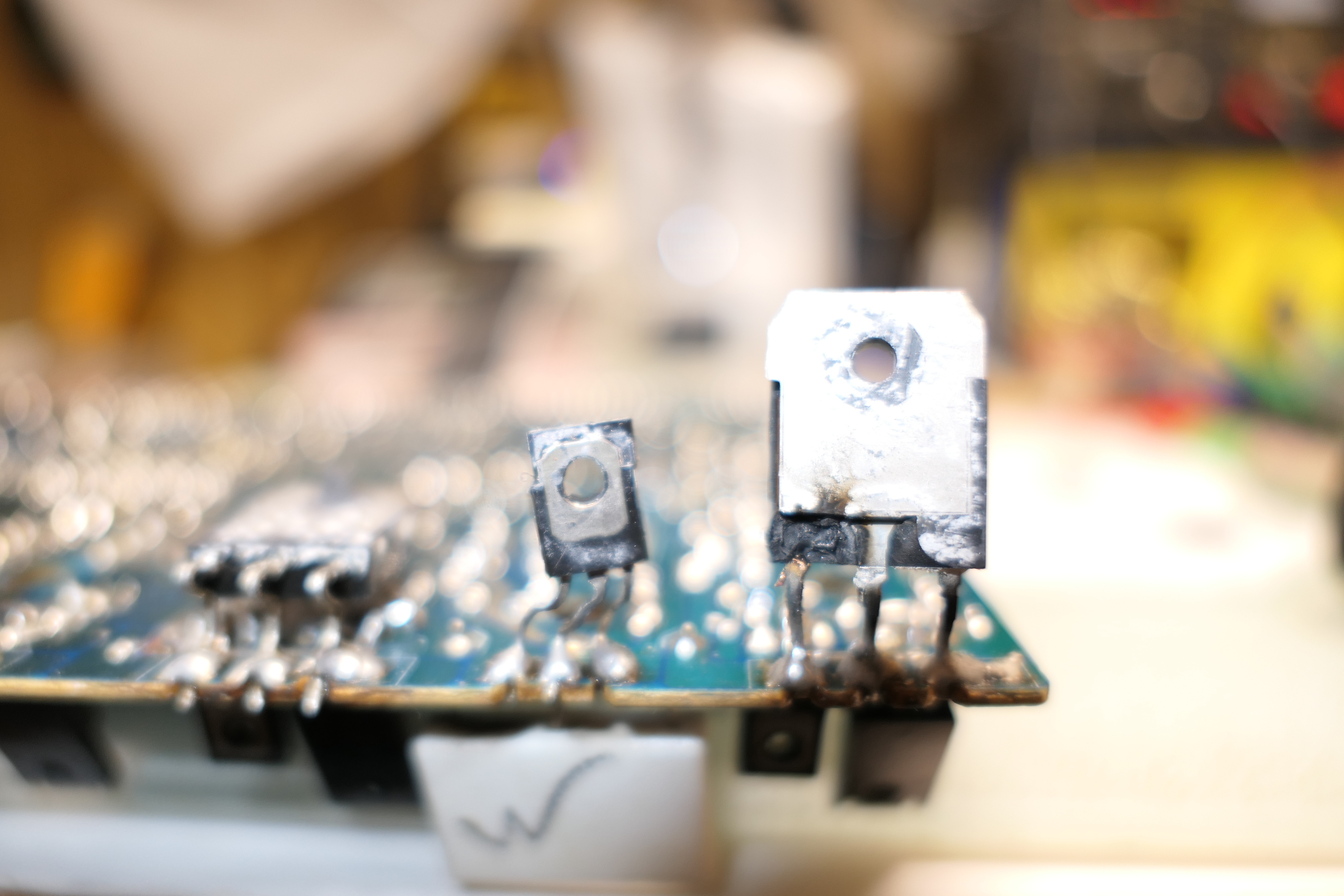

        R_J how are you doing!! Hey, you hit it right on the nail, look at the picture. I feel a little dumb not having thought of that! The insulator moved while reinstalling and that's exactly what happened.
        I made some insulators from a deck of plastified game cards...ok, this time around I'll be careful and check if I have a ground or something. I'll also add new heat sink compound on every transistor to make sure. Thanks a million R_J!.

          Get some proper insulators, playing cards don't transfer heat very well.

            Get some proper insulators, you were lucky the playing cards didn't light on fire...

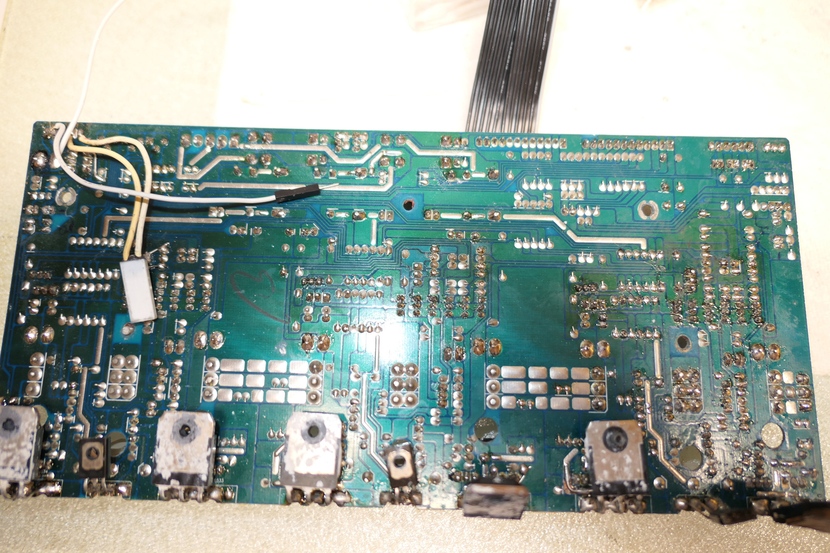

              Ok, so I got some insulators from Digikey for TO-247, installed them with fresh thermal greas and changed Q510 and Q509 + Q508 and Q507 + Q562 and Q563 at the same time. Change R520 and checked all other resistirs and diodes in the left channel, and all was fine.
              Reinstalled, plugged it in and it worked like a charm. Adjusted the bias voltage on all 3 channels to 1mv as stated in the service manual.
              Worked well for about 2 hours, and then a pop and went into protection mode. Opened it up, and again Q510 and Q509 are shorted.
              I'm out of ideas...any help would be appreciated!

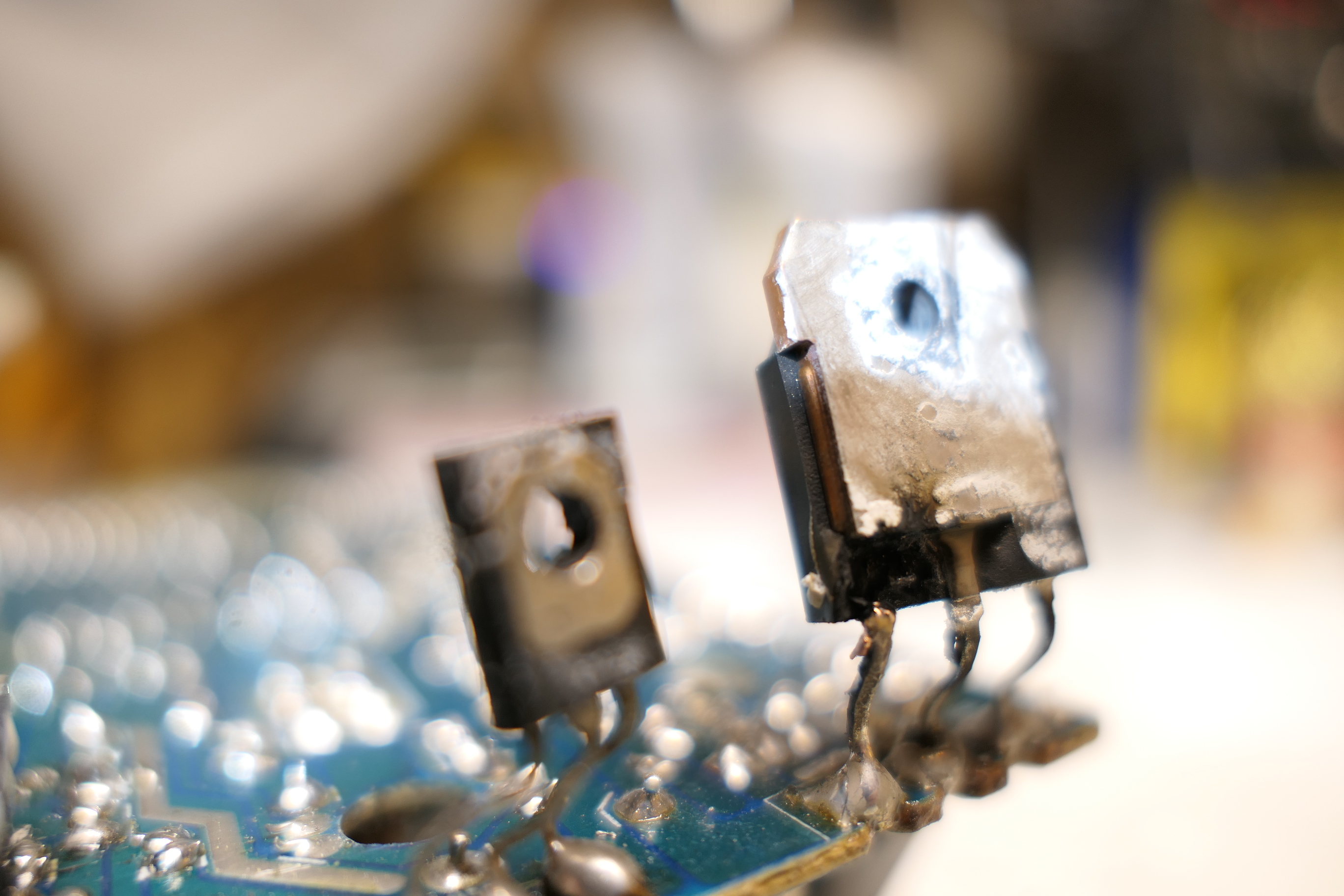

                So something is causing Q509 and Q510 to fry because both of them are short. I checked every other component in the left channel, compared it to the right channel and got the same results.
                So now I have no more 2SA2031, will have to wait to get some others (on their way) before doing any more tests, but I have to find what is frying those 2 transistors.

                    Maybe the transistors are not original (remarked) and they will not match their parameters, the Chinese love to do this.

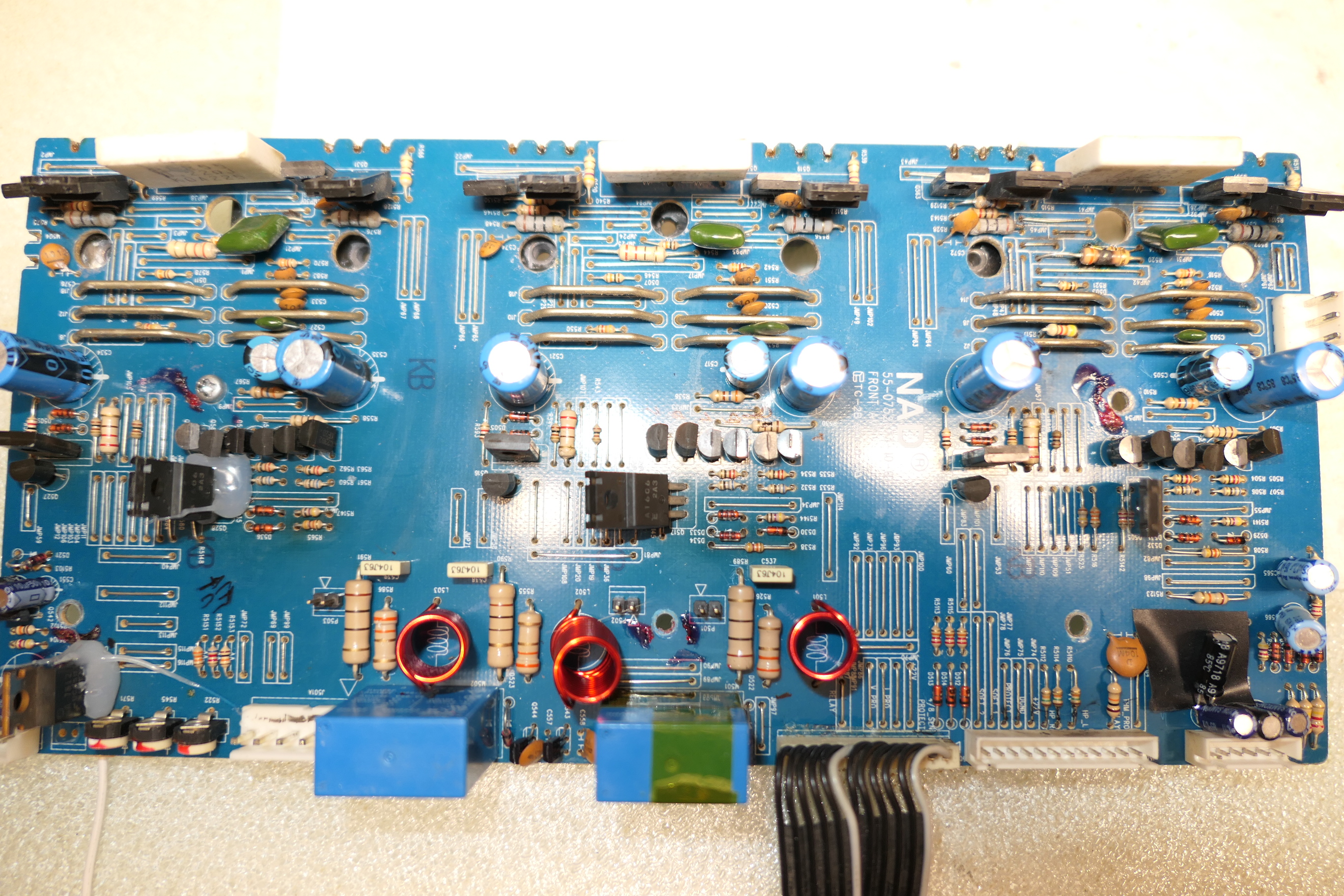

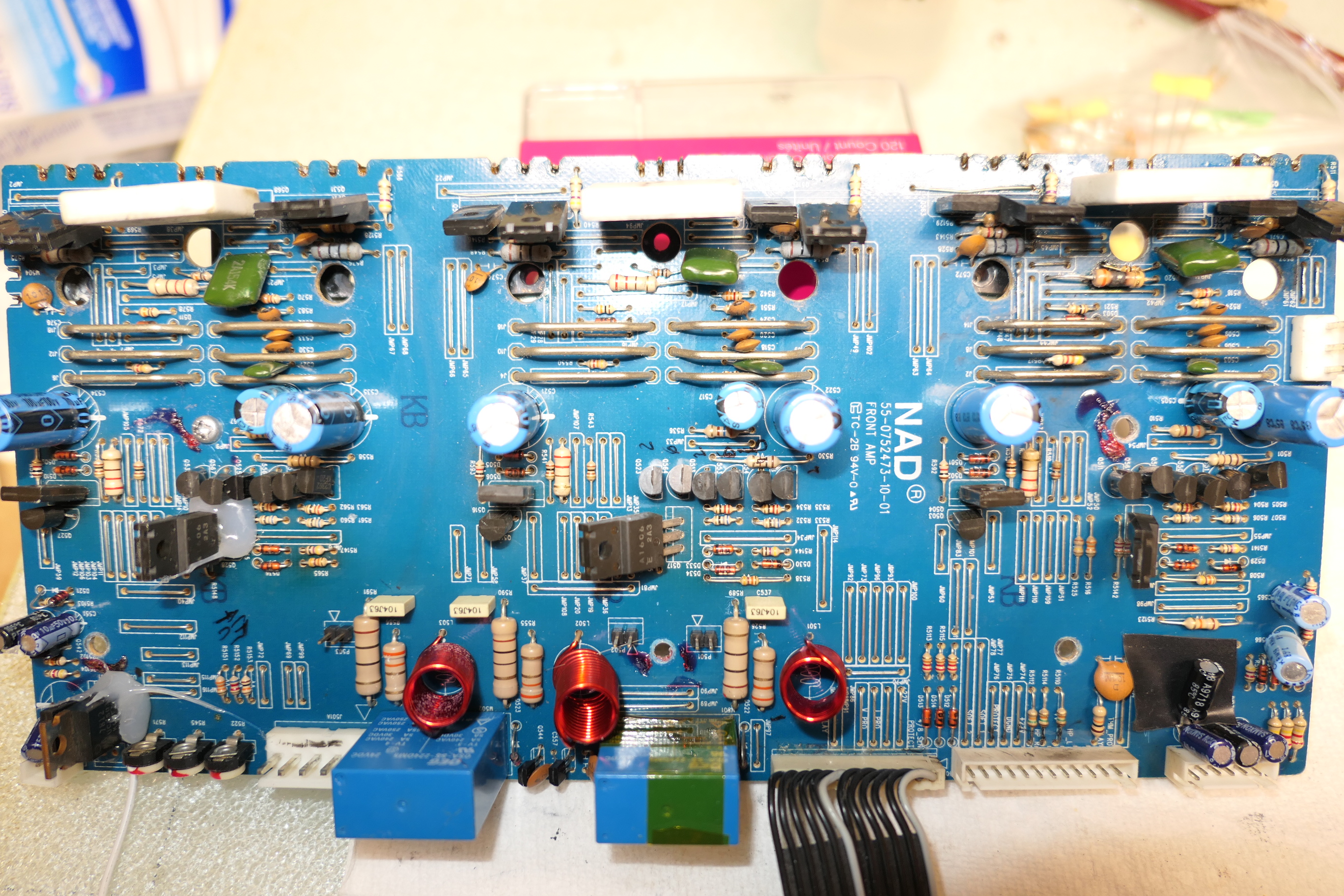

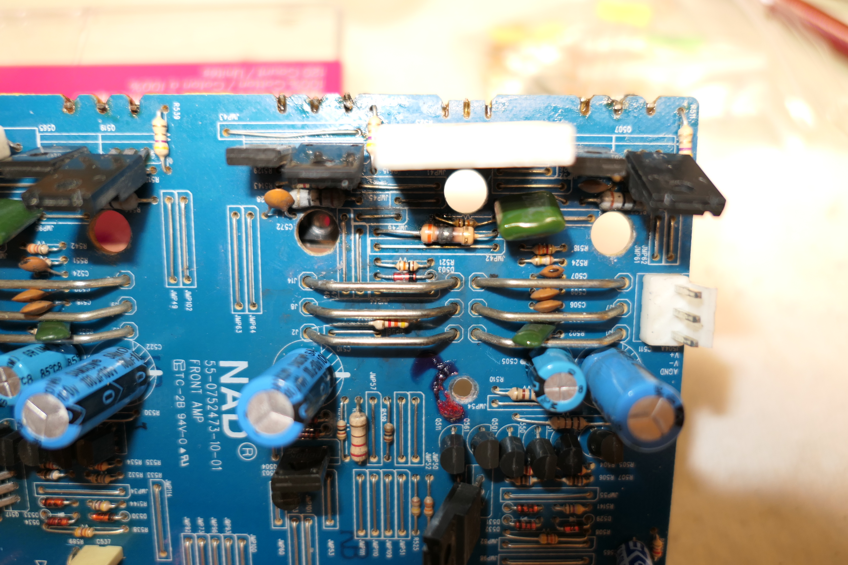

                                  One thing I noticed, I am attaching a copy of the board view of the Front Center amp - notice the circle in yellow, it shows a connector J504 that has V+ V- and Agnd on it. This comes from the surround amplifier and I measured +- Plus 63V on the + side and minus 63V on the - side.
                                  It doesn't appear at all on the schematics that I already uploaded and this time I am uploading the complete service manual with all boards and schematics. 63V sounds a bit high but then, when it was working the sound was just perfect - but didn't last more that a few hours before Q510 blew bringing with it Q515.
                                  Any help, any thoughts I would definetily investigate. Many thanks!

                                        J504B connects to V+ and V- of J781B, via JMP58~61, it will have the full +_ supplies on it. (see page 17) The jack could be either just a test point or it is for a different model.
