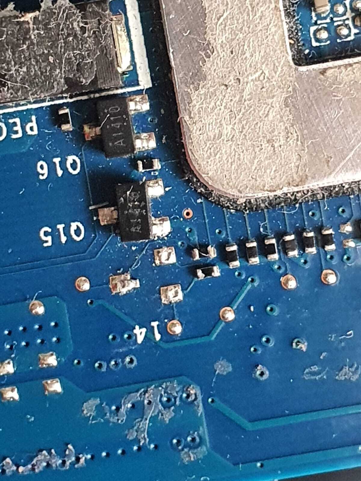

    hi people, i need some help to identify a transistor(q14) that is missing on the board, so the gpu has no voltage i think that q14 activate the phases for gpu, but i dont have schematic or boardview, but i think its the same transistor than q15 and q16, thanks

    anyone? i check the pads and none of them are conected to ground, thanks

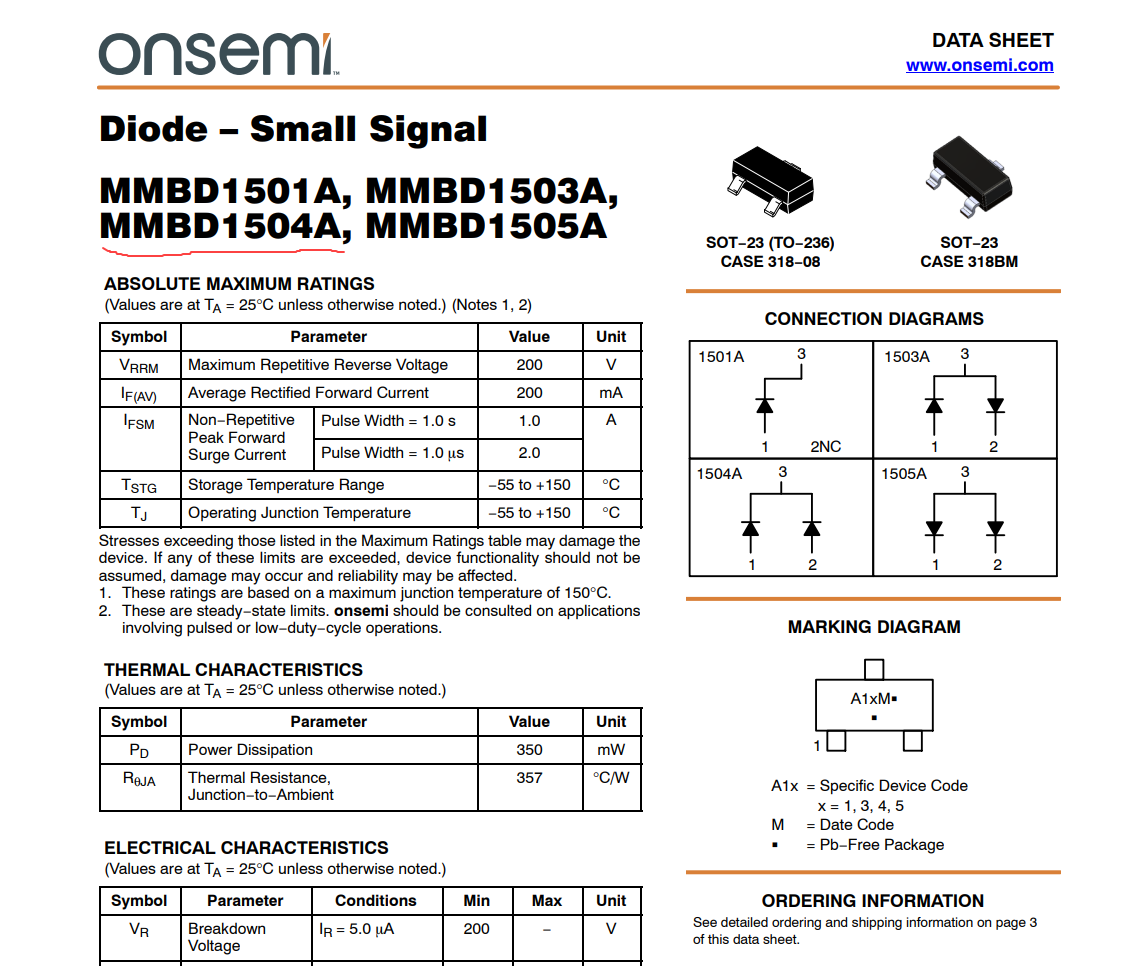

      The part be the MMBD1504A, dual diode.
      See attached. To test, remove all power. Meter in DIODE mode.
      Place red meter probe on the anode (pin 1); black meter probe on common cathode (pin 3). Meter should conduct. Reverse the meter leads and the meter should black. Repeat with pins 2 & 3 - same measurements.

        Wait on other guesses but do test in diode mode and share the measurements.
