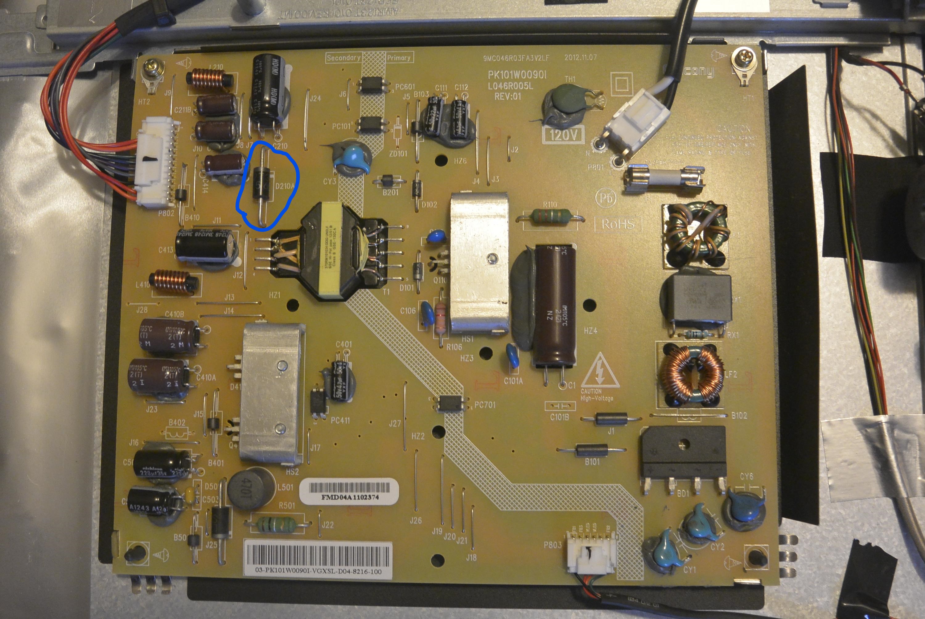

    I've a diode in a tv psb that has a reading forward and bias. This is with it in circuit. Out of circuit, it tested normally. Any thoughts?
    Re: Diode test results show reading both ways
    You need to trace out the connections to see if the diode is connected in parallel with other device or not.
    Pictures of what you are testing?
      Here's a pic of the psb on the tv I am working on. The diode in question is circled. Would it help if I took the same pic of the underside, to show tracings?
        What the fault with the Tv ?
          • 31278
          CY2 ceramic, lower right corner!
              Nope, you are looking at some of that grey adhesive, not a ruptured capacitor. Even so, if there were a problem right next to the main primary side rectifier bridge, do you think that it would cause a secondary rectifier to fail or read incorrectly? I think not.
              The fastest way to check the diode is to desolder one leg and re-measure. It is probably a Schottkey and will measure somewhere around .2 volts forward.
                it could cause anything with a 2pin power cord,
                those are the caps coupling the mains to the groundplane!

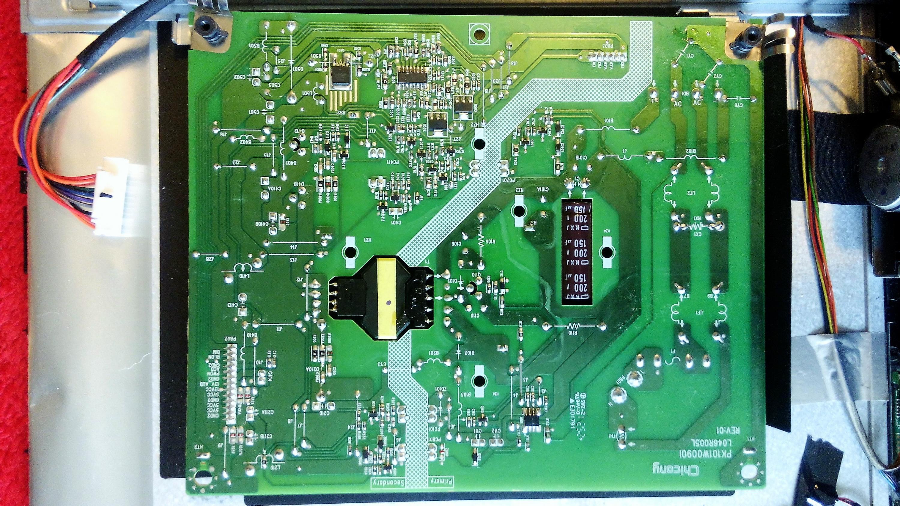

                  Does it show conduction in both direction if the white connector to the main board is not in place.
                  We do need good clean straight shot of the bottom side of the board too.
                            It doesn't show conduction in both directions then. But, it does take a second to get to open OL, after cycling a few numbers around. Here's a pic of the back of the board.
