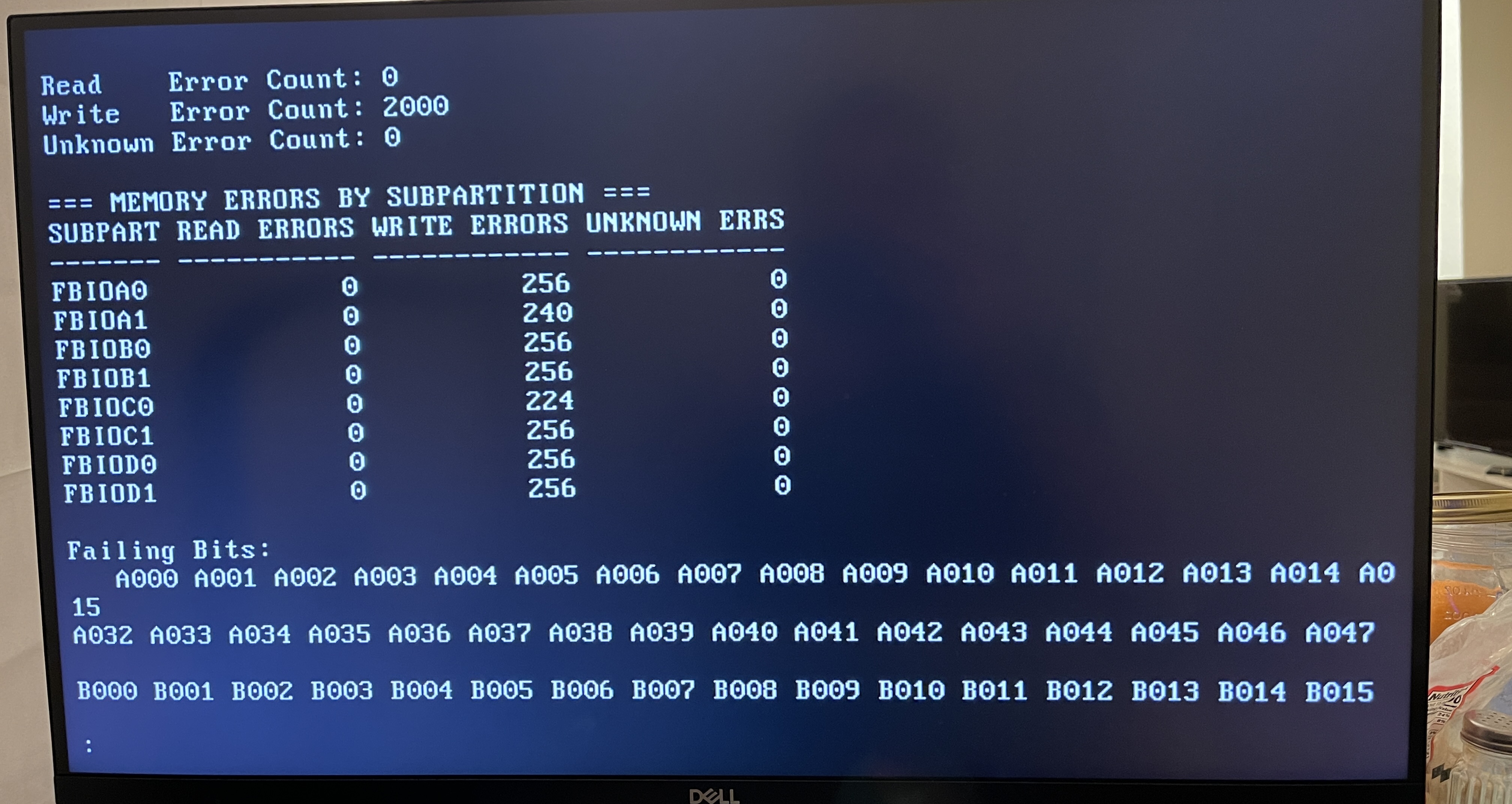

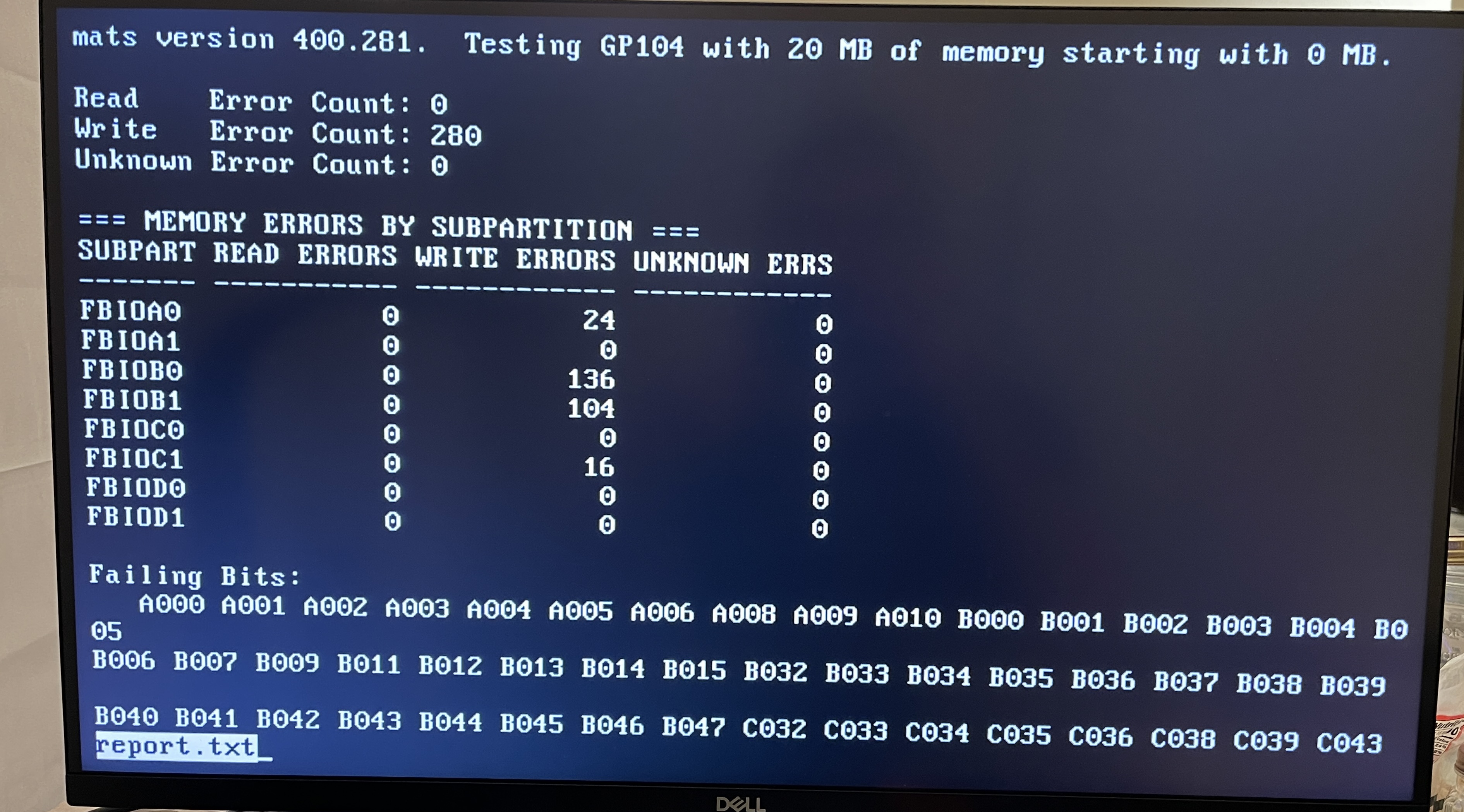

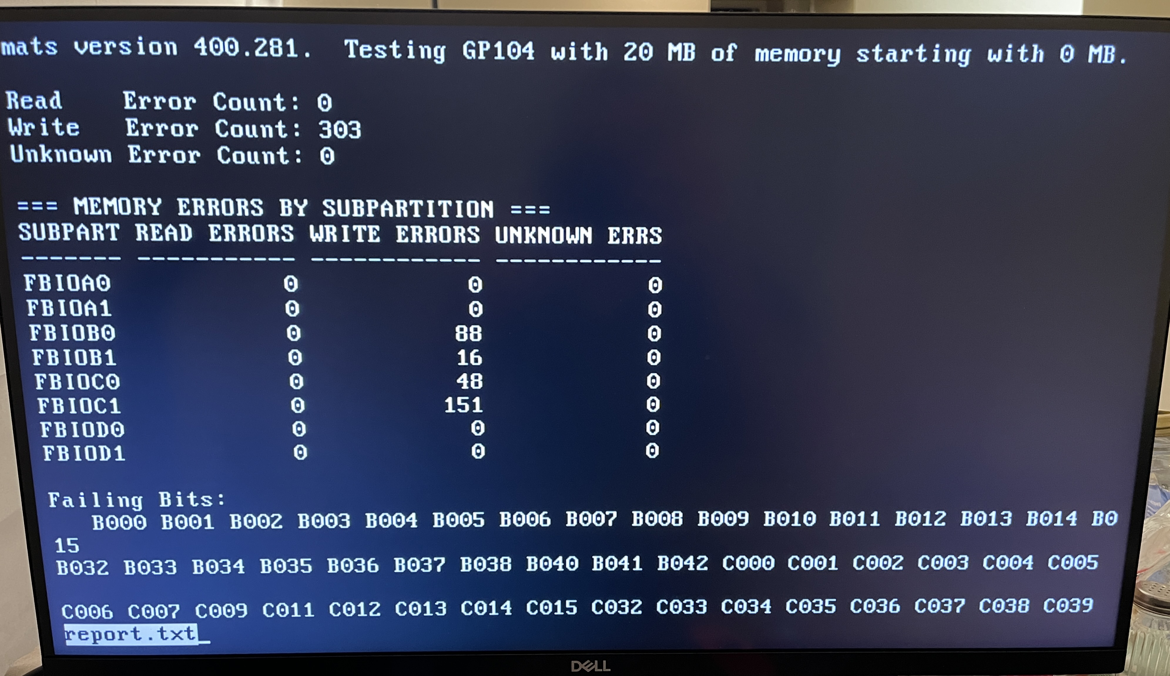

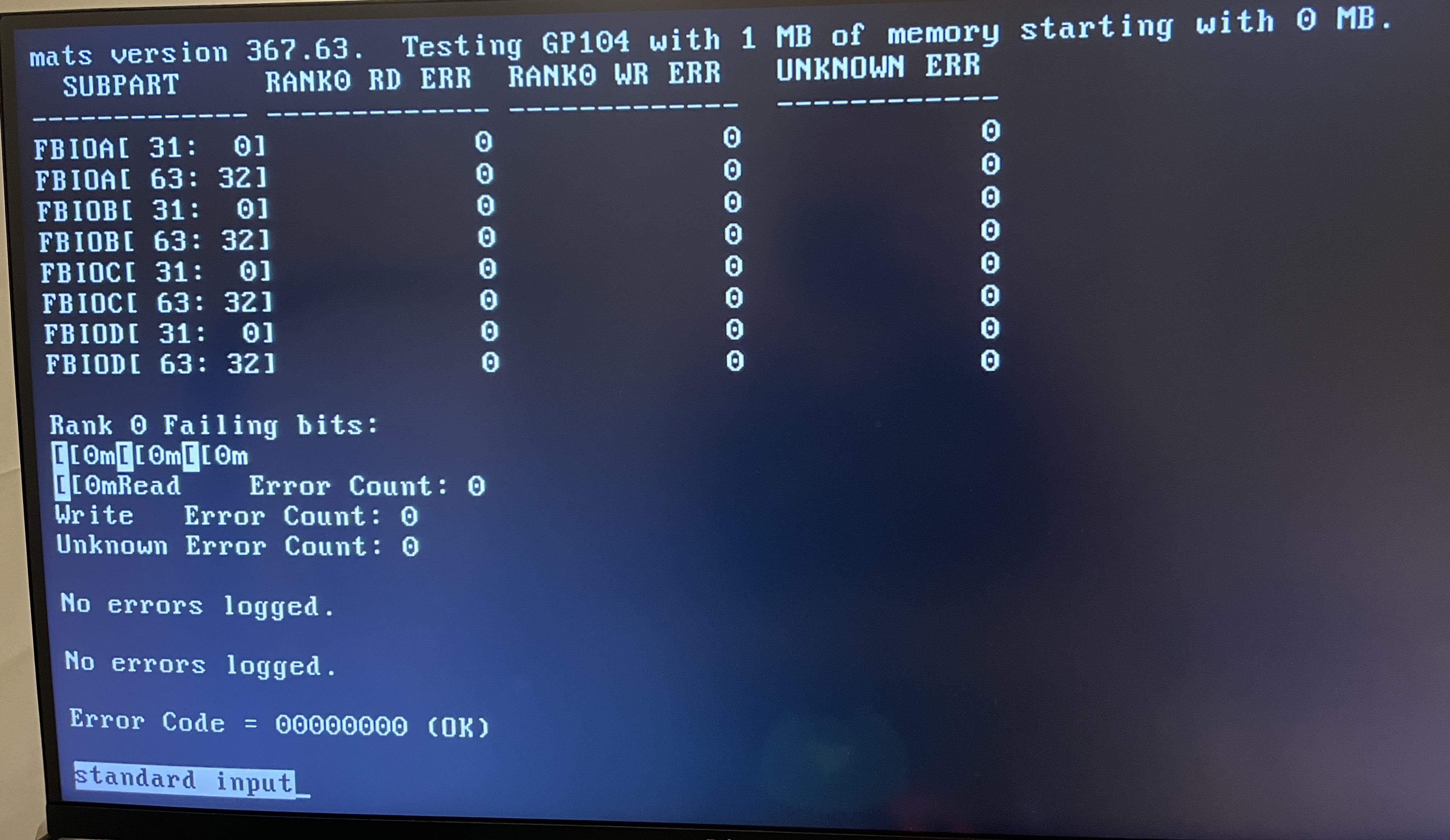

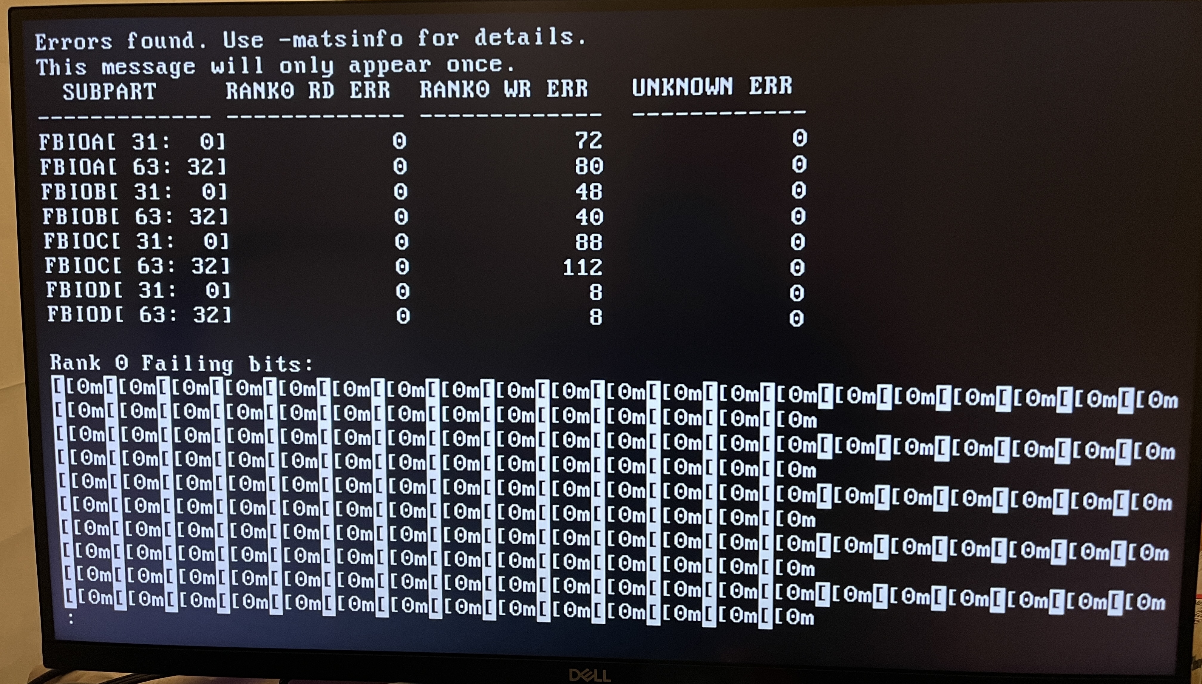

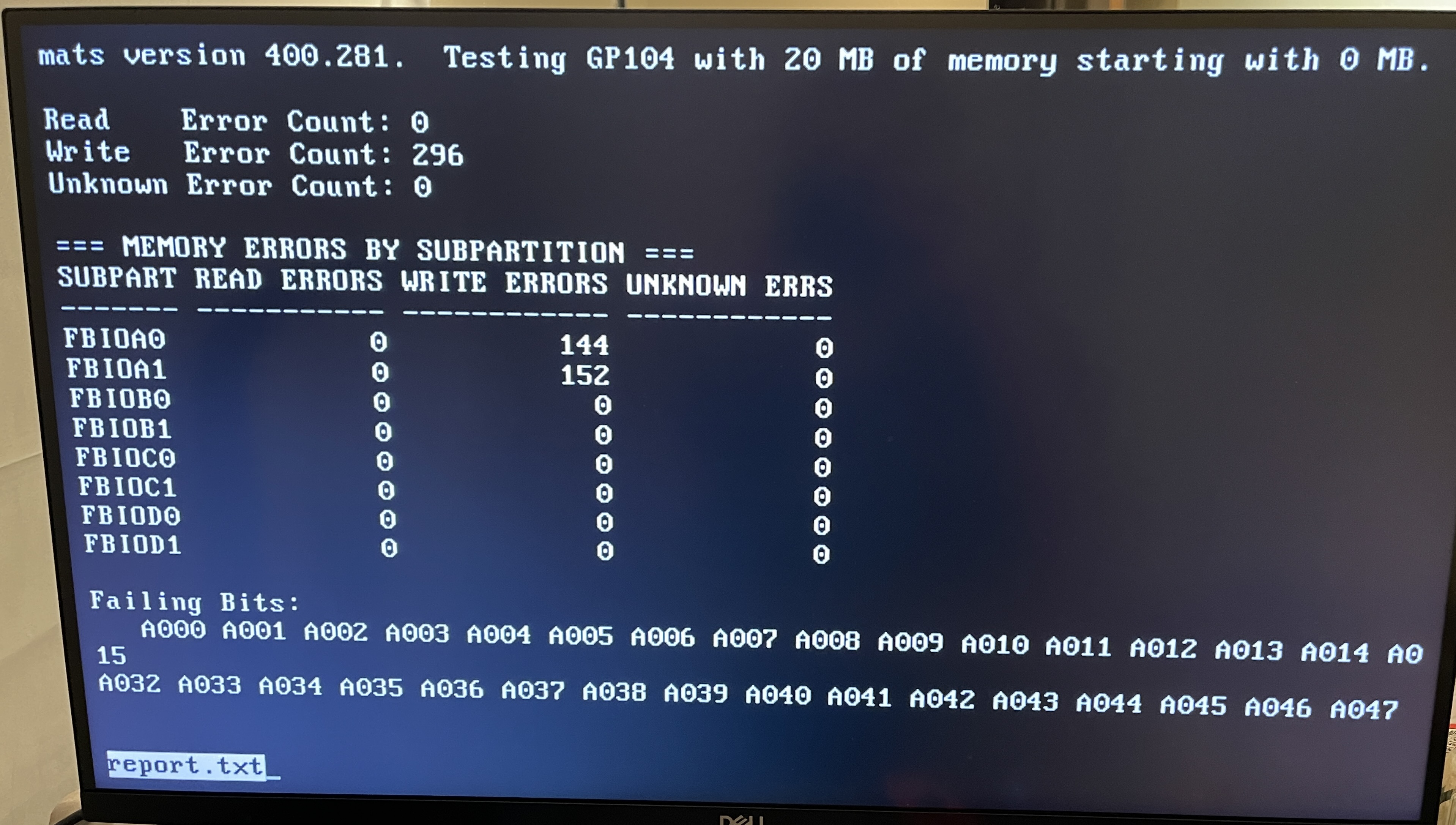

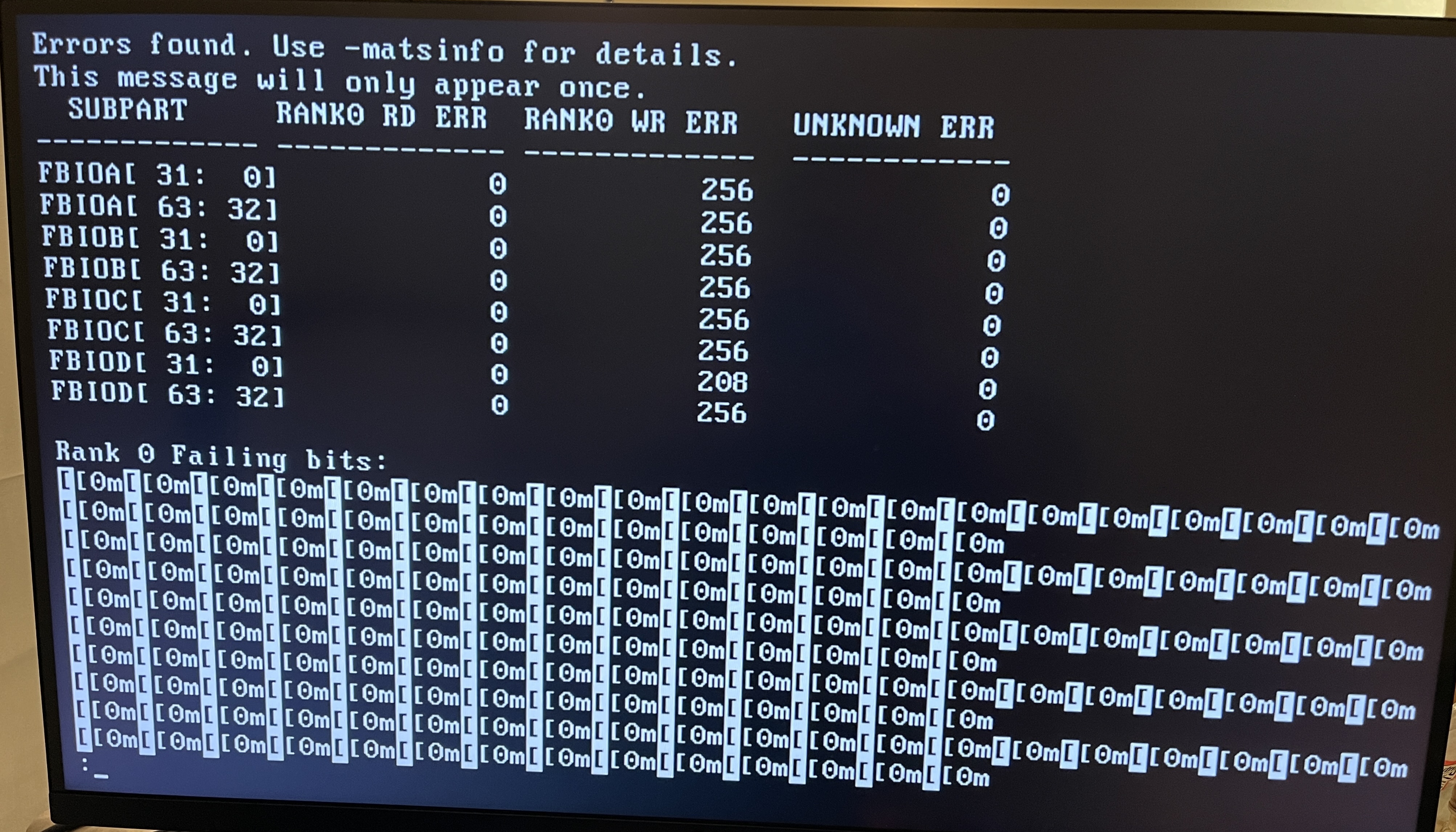

      I decided to run another session of MATS (the previous one that showed no errors I ran couple of weeks ago where to problem was less frequent). Here are some of my results. What's "funny" is that I can run a test showing absolutely no errors just to rerun the same test 5 seconds later and I have a bunch of errors and then another test showing completely different results. I tested multiple version of mats and all of them show random stuff.
      I am not an expert but for me the only logical explanation is core problem. I don't suspect memory is the issue here because it makes no sense to show no errors followed but all memory chips failing at once and then only 2 of them and so on...

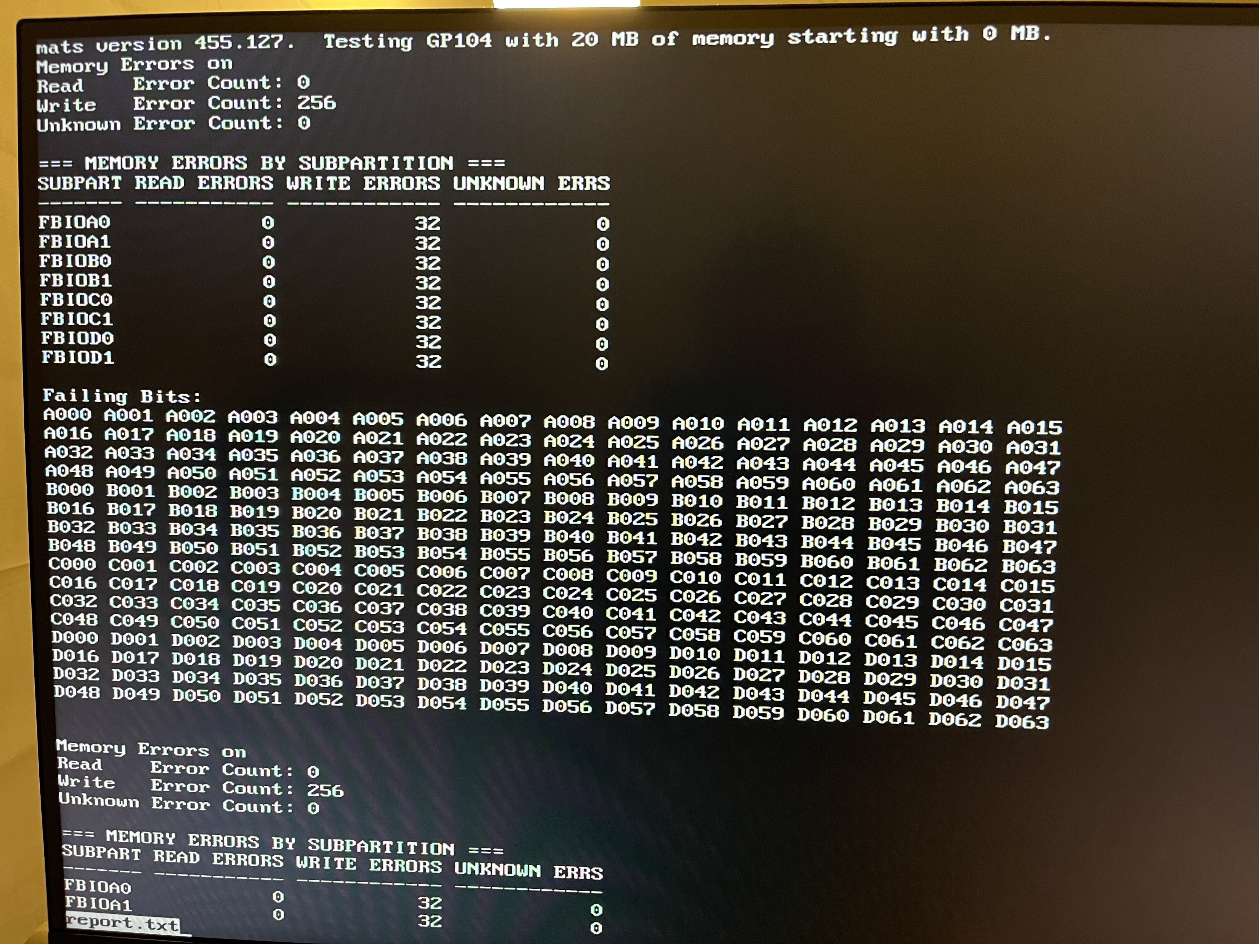

          Originally posted by DynaxSC
          For me it looks like a contact issue resulting from thermal material effects. Sure, it might be inside the GPU, but with luck in an external location. I would not give up so fast. What you can do to narrow down the reason is some bending/pressing of the board during operation, to see if there is a reaction to material stress. If there are cold solder points this might, but must not show it.
          And you are absolutely correct!
          First of all let me clarify my previous post where I claimed that I was receiving random write errors on each test.
          Thanks to this reddit post (https://old.reddit.com/r/GPURepair/c...s_detected_by/) I learned that this is normal and is a false positive because I was testing a card that is working as a current display.
          Running command ./mats -b 60 -e 70 excludes first 60 MB of memory from test and after that all my memory chips showed 0 errors even running ./mats -b 60 -e 150 so I knew memory is good.
