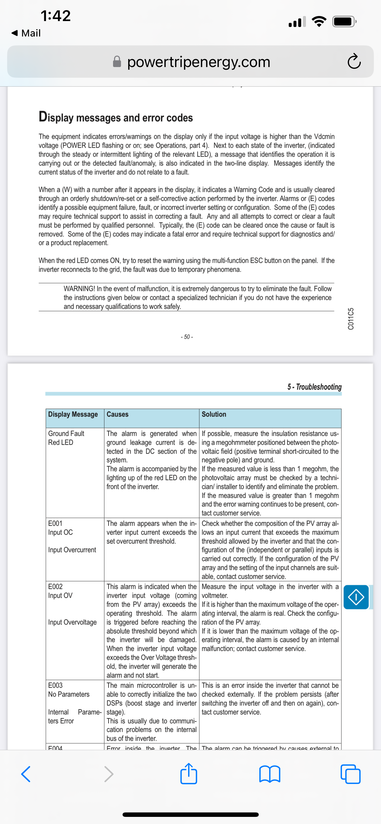

            troubleshooting is page 49 onwards
            • mitsu2k
              • Aug 2013
              • 199
              #146
              OK I think I know what you are referring to now. Please see attached. This is the only test that I can see that would be relevant. And I did perform this test in the following manner:
              tested between positive and earth ground and got over 50 MegaOhms.
              got approximately the same results from negative to earth ground.
              I did not short the positive and negative together because it was daytime and I didn't think that would be a good idea being that there's about 256 V there. However, I wouldn't expect to see any different results if I shorted them being that they were both over 50 mega anyway. I suppose I can do this test at night, but I am just afraid of blowing the diodes on the panels and I don't really want to go up on the roof being that I am afraid of heights

                  Ok I did the test outlined in the manual. (Positive shorted to Negative) at 250v on the megger to earth ground.
                  result= >4000 MegaOhms on the megger (full scale). All good here.
