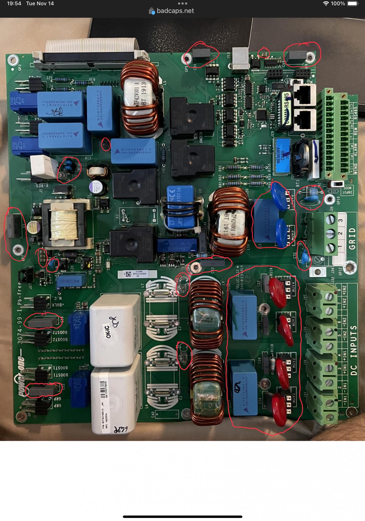

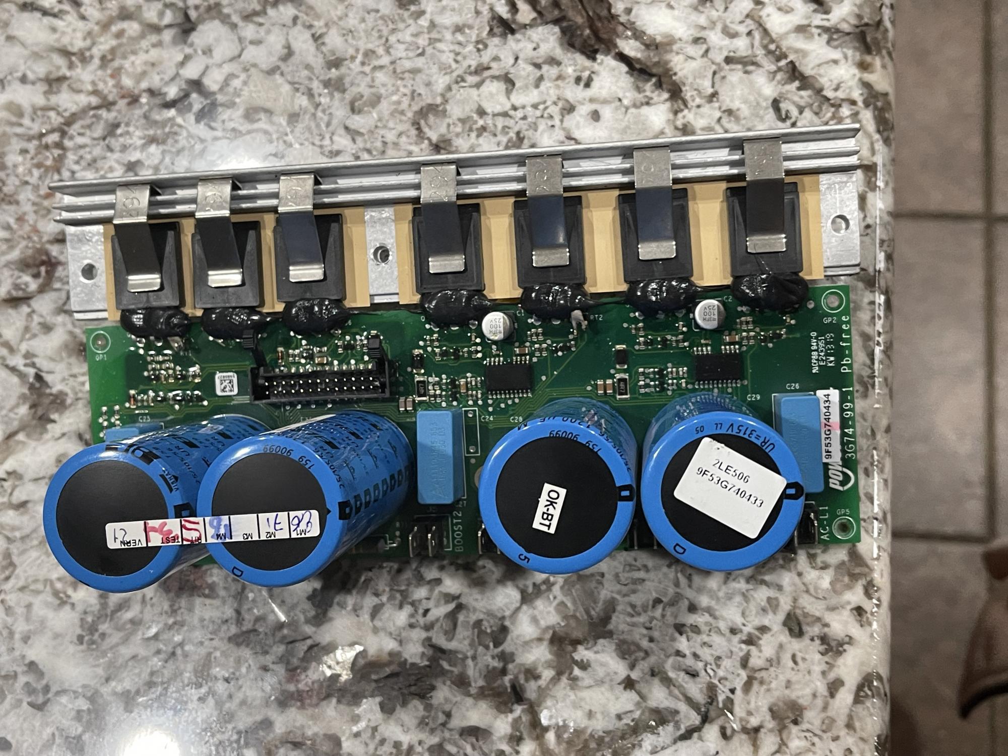

    Hello folks, this is a last ditch effort. I thought I would seek your expertise before giving up.. I have been working on this thing for over 2 months and have gotten nowhere. Here is the issue:
    Inverter powers on and immediately red GFI light comes on and inverter will not complete the initialization process.
    There is no error code on the screen. I have removed most of the Y capacitors and tested to no avail.
    All relays are good.
    I replaced the current transducer- same problem. Checked most of the transistors and diodes and all appear good. I wish I could get my hands on a schematic which might point me to the GFI circuit.
    I just don't know what else to look at here. I have hit a brick wall. Attached is a photo of the board. Anyone have any ideas?
    The Inverter is a Power-One Aurora 3.6. I am sure the issue is not with the panels because I did power it up with a 100VDC power supply and had the same issue

    GFI is the ground fault protection on the solar array. There are multiple reasons why the inverter is kicking off and some of them aren’t even the inverters fault.
    We need to know more on what you tested and how. For example, did you check your solar panels and wiring? Maybe there is arcing? It’s not an easy test to do where you rip out your DMM and go for it. Does the inverter error out by just connecting it in the grid, nothing else.
    Other than that, if she errors out in ground fault and doesn’t give you an error code, it’s not looking good. I do see a GRP pin… where does it go on the other board?

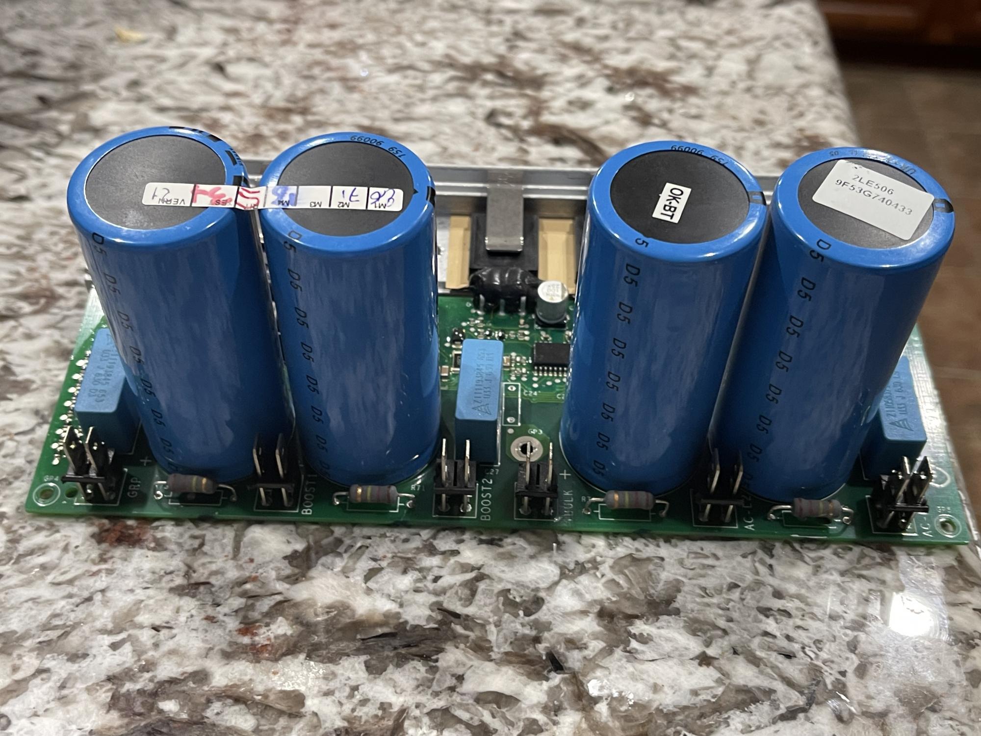

      I am pretty sure the problem is not with the panels as I get the same error without the panel array connected and just using a 109v dc power supply to power it on. I had also tested the panels with an insulation resistance meter and they tested fine with super high resistance. Over 50 mega ohms. The inverter itself tests the insulation resistance of the panels and it comes back 20 mega ohms, which it should be.

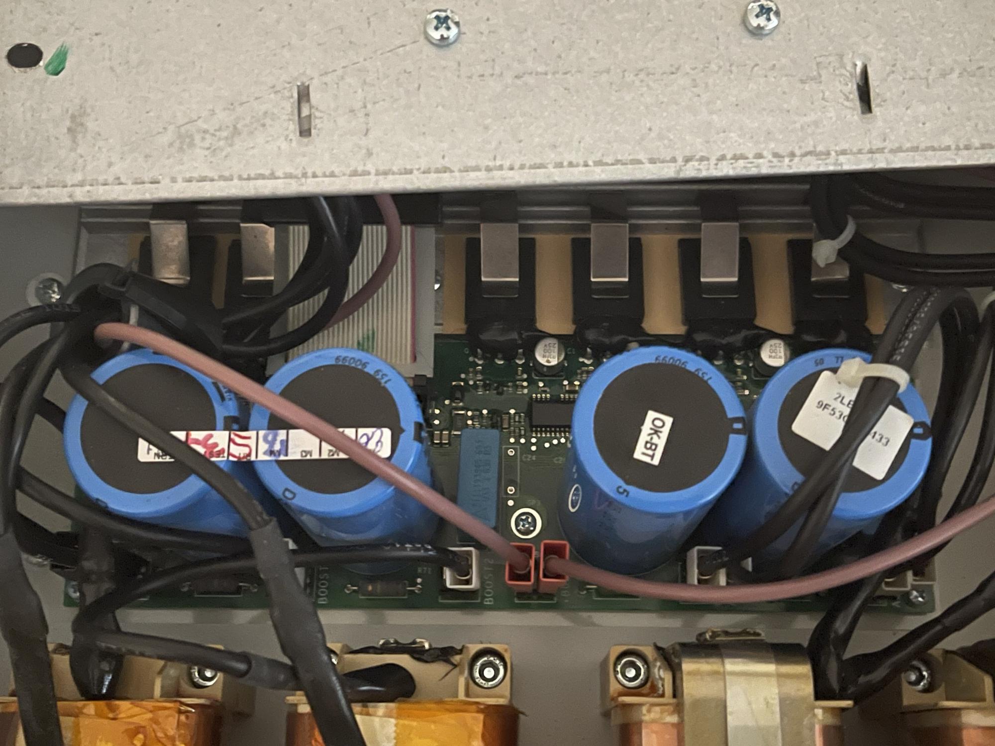

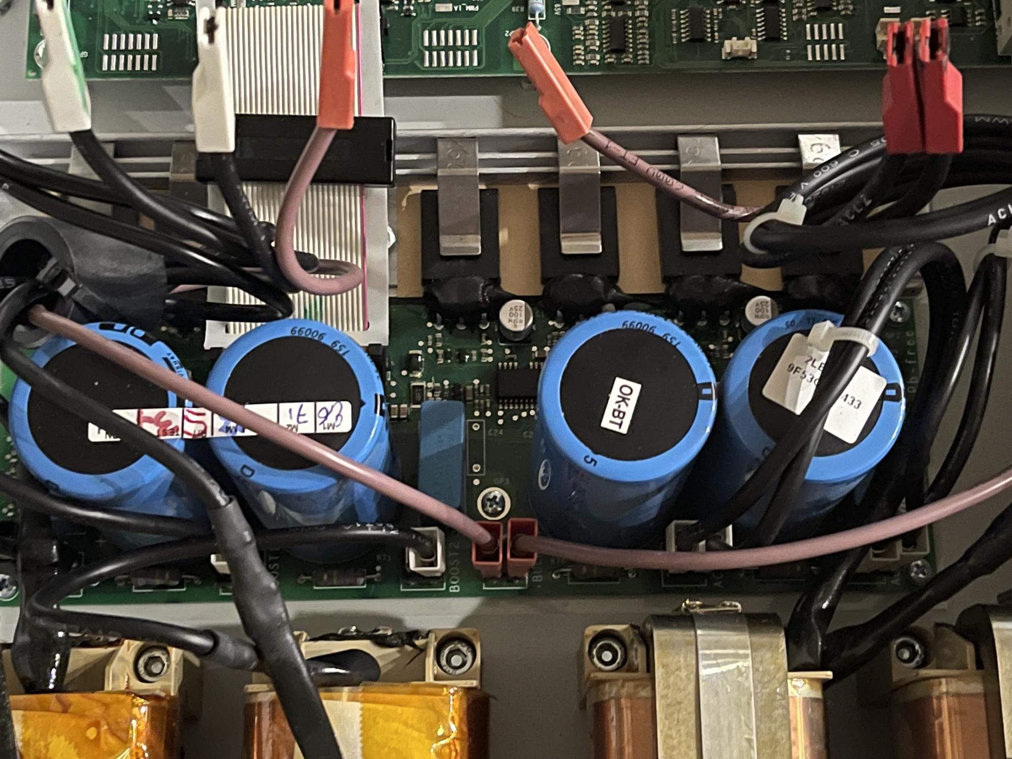

      Like I mentioned, I removed and tested all the caps. I also removed all the Y caps and fired it up without the caps installed. I checked all the relays. Also checked most of the transistors. I visually checked the MOVs and also removed them completely. I checked for cold solder joints.

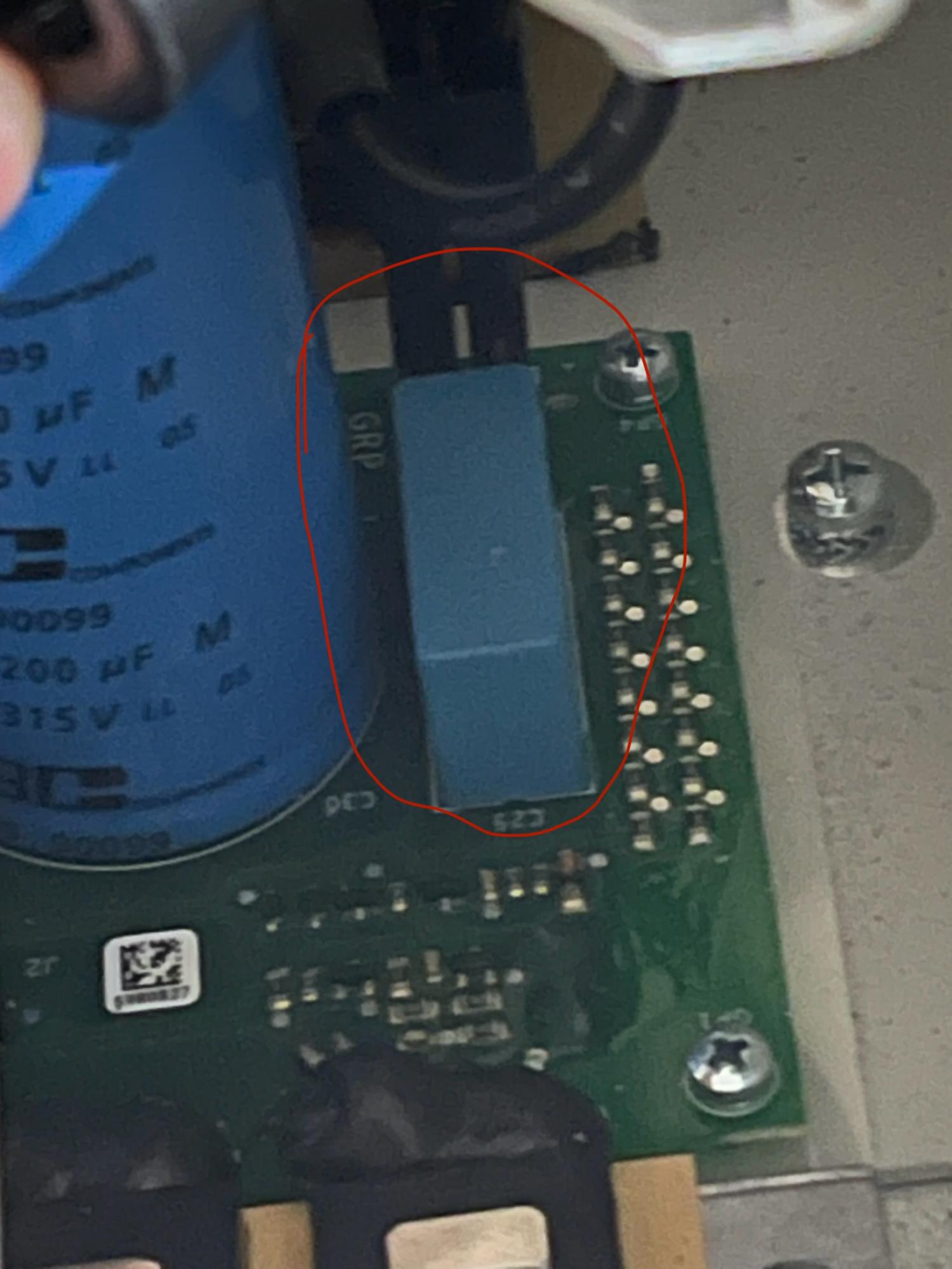

      As for the GRP pins, they go to another board inside the inverter. That board is connected to the transformers and has 4 large capacitors as well as some large transistors and some other components. It's a much smaller board than this one and I have not messed with it because it is going to be a pain to remove due to compound and heat sink situation. I have the inverter assembled right now but I can take it back apart and try to get some photos of the other board. What is GRP?
      By the way, I tested the caps with my Fluke 87 as well as my Peak ESR meter.

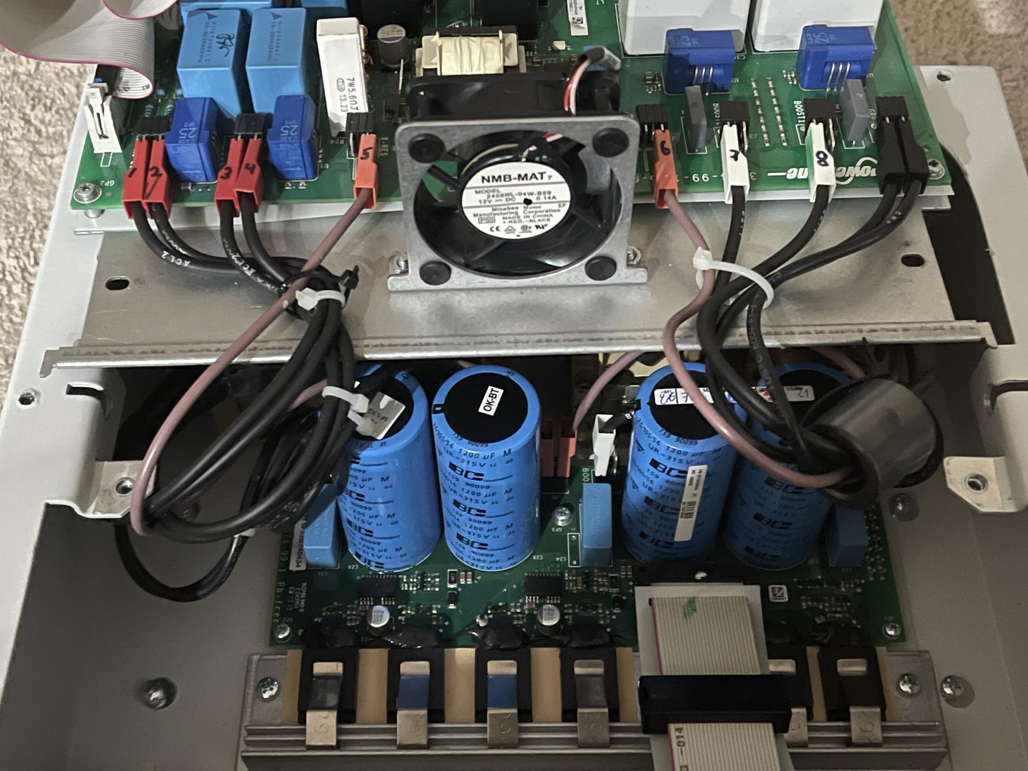

        Here are some more photos. GRP is circled in one of the photos. There are a total of 3 of those rectangular protection caps on this other board. At least I am assuming they are protection caps.
        By the way, Inverter does error out even when not connected to grid.

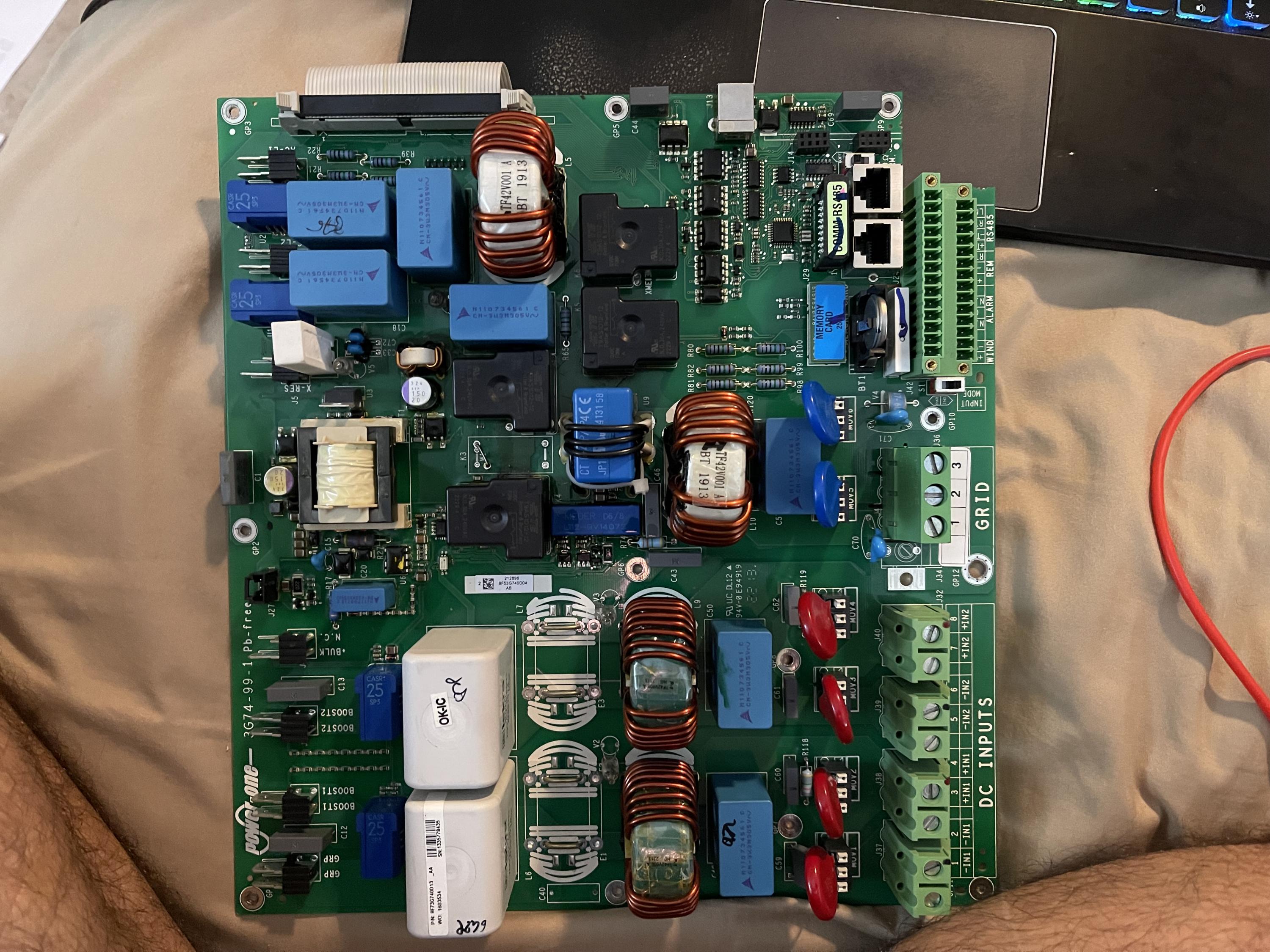

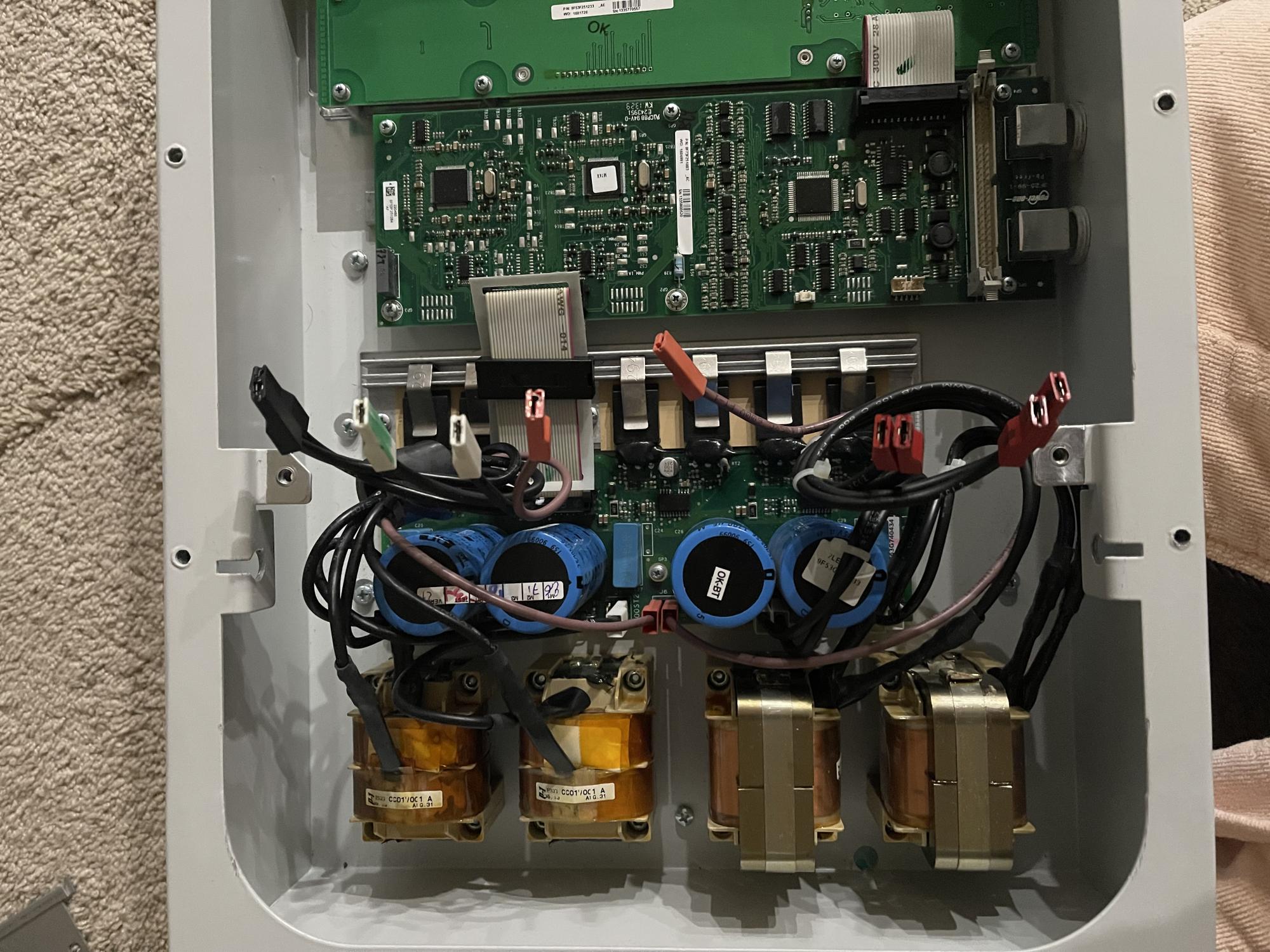

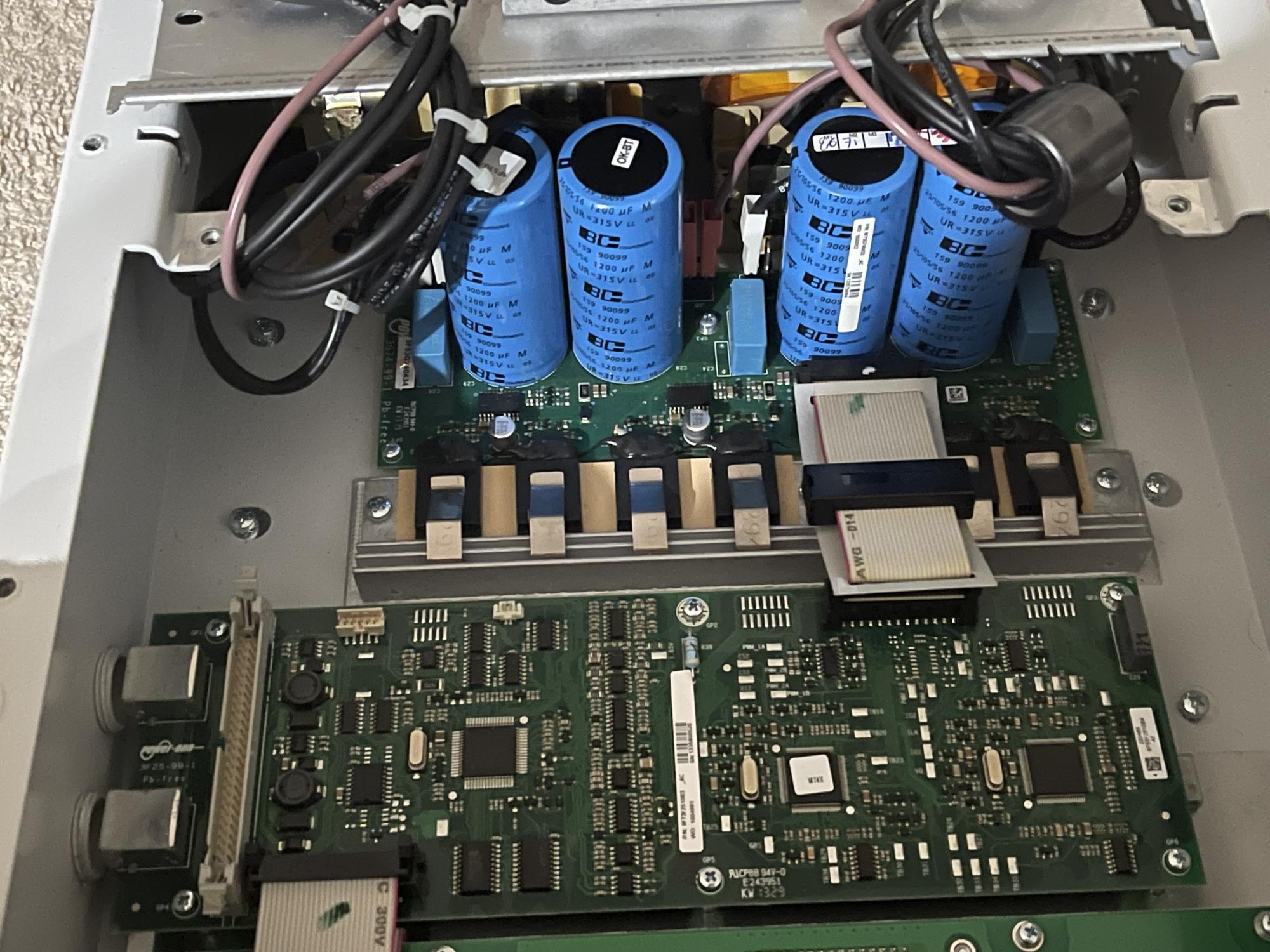

          Here are some better photos of the other board.

            What happens if you wire the inverter to the grid and don't connect anything like panels? I assume GRP is the ground protection. I saw various GRP pins or points that always have a rectangular blue cap or similar connected to ground. I would follow these around.
            A ground fault can be on the DC side, but also a ground fault can be on the AC side where the inverter connects to the grid. If something goes stupid with the DC side, there is always an error code. Since you don't have any, maybe the fault is somewhere else, like on the AC side.
            Your test gear is ok and measurements too, so I agree with the inverter being the problem. The problem could be as stupid as a shorted MLCC SMD cap too.
            I marked up your first picture with things I'd be looking at so you have an idea what components I mean. There are also a bunch of little neon lights…
            Anyway, the problem may not lie on this board.

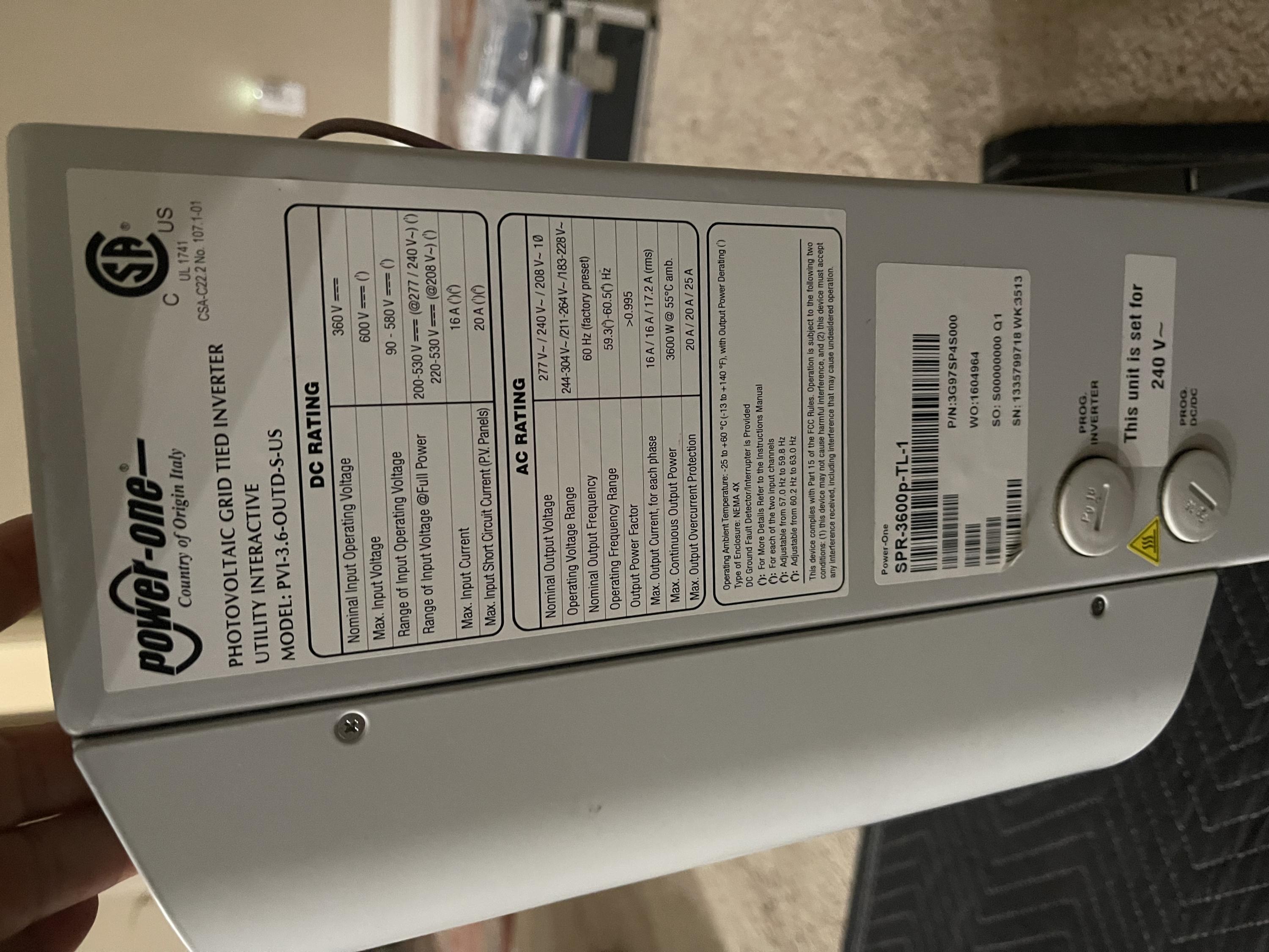

                  as a sanity check take a look at the mains supply .
                  what is the model number of the unit in question ?

                      Here is a photo of the model of the unit.
                      it is PVI 3.6-OUTD-S-US
