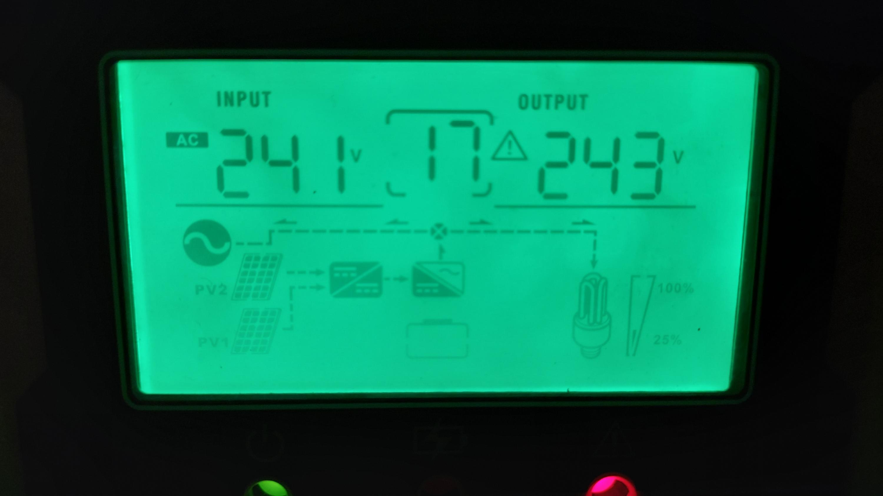

    My parent's solar inverter died after 5 years of good service.
    It's a called hybrid inverter:
    - It can go with or without batteries
    - It has 2 MPPT (8 330W panels in 2 strings) -> 5280Wp
    - A 20kWh lithium battery previously used in a Nissan leaf (14S at 4.1V max) -> 57.4V
    Panel is showing error 17 and the battery connection has disappeared. On the other hand, is delivering load, MPPTs are working and it's exporting energy to the GRID. Not that "bad".

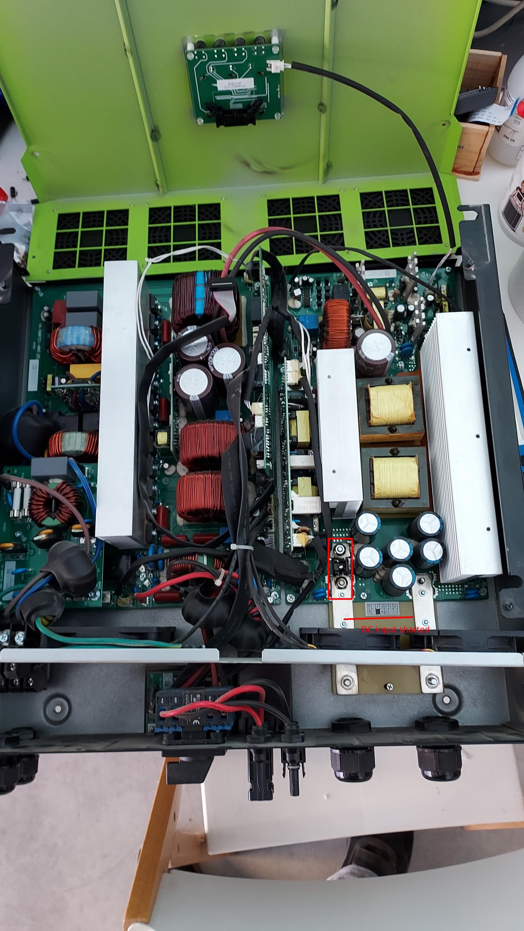

    Let's open it......

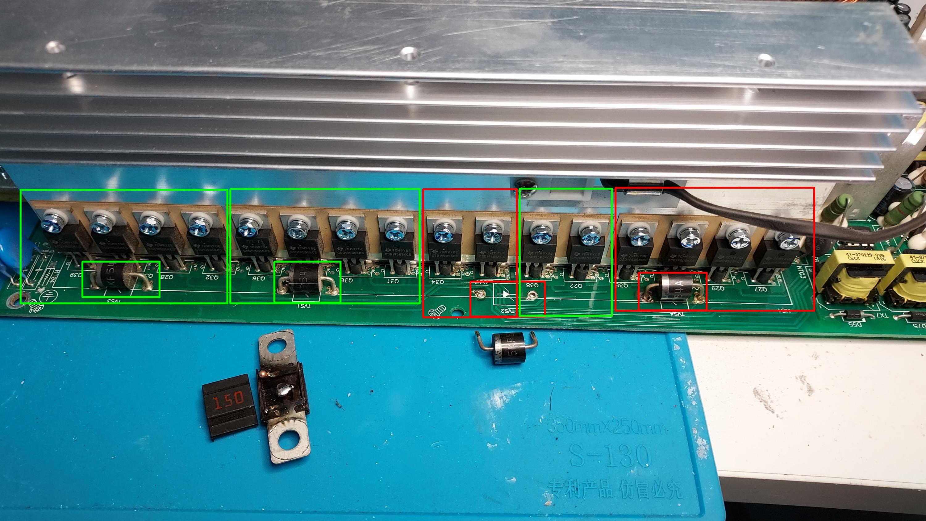

    I see that 150A fuse is gone and the DC input is shorted.
    This is the summary I've seen when I removed the PCB from the cabinet:
    Red is bad.......green is OK
    1st question: Is it ok to just change the 8 mosfets from the right as long as they go in groups of 4? Otherwise this repair will cost quite a lot :-)
    As soon as I've removed the TVS(4) and all the mosfets input shortcircuit has been removed............. but there are other possible shorts......which maybe are "ok".

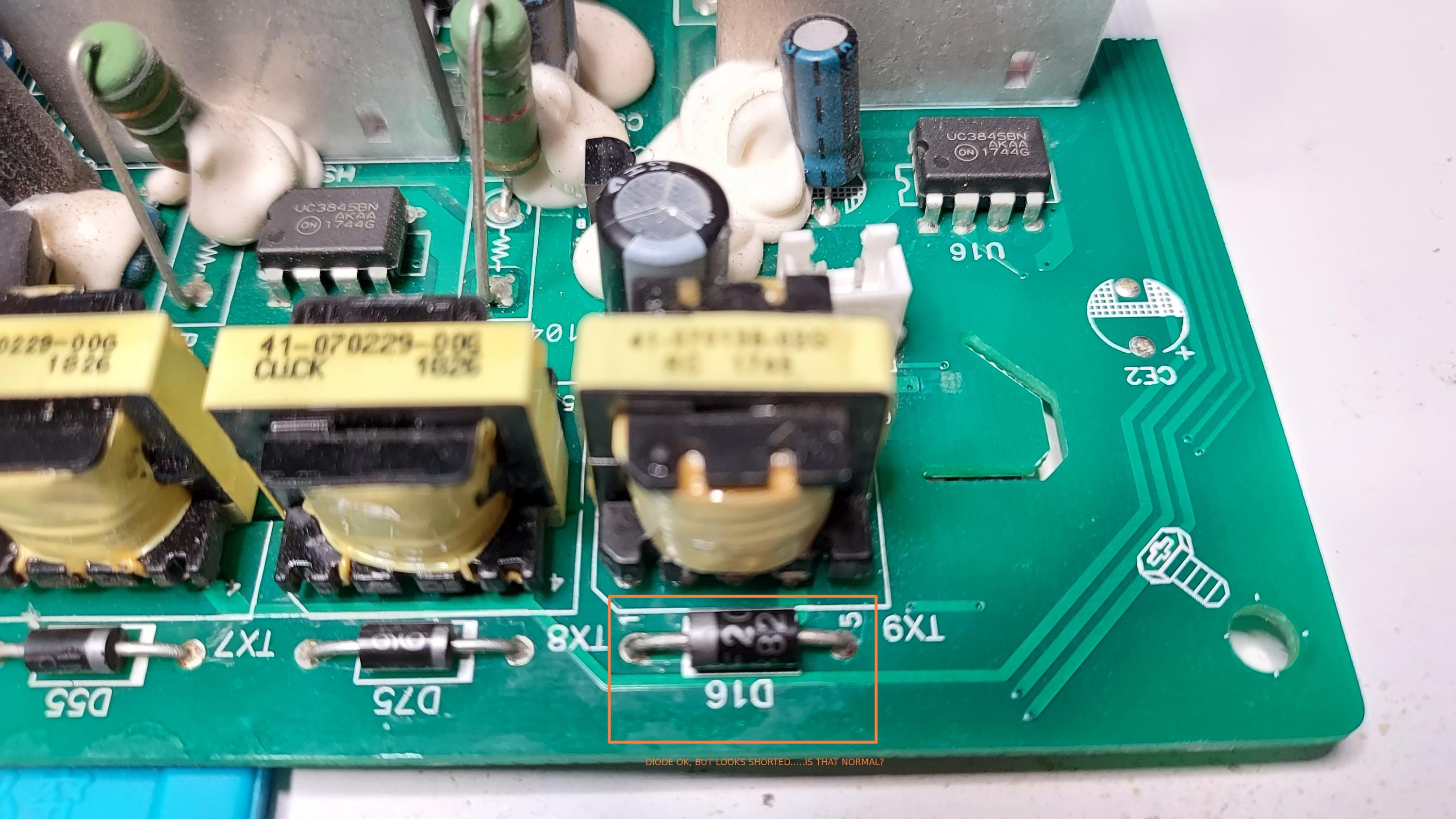

    I am trying to understand the short on D16........but I haven't found it yet........maybe there is a reason behind it.

    The 5KP54A TVS diode is unidirectional and fires off at 54V reverse standoff in order to protect the circuitry by usually shorting a protecting voltage rail to gnd and blow a fuse. So it does make sense what you found.
    So you found a blown fuse, a shorted protection diode and shorted mosfets. Now look if the mosfet is shorted to the gate pin, if it is, check the gate drive circuit of the mosfet too.
    If you can find original mosfets, I’d change them out in banks (2 right banks). Now if you have to sub something else into it, I’d be changing them all.
    Got no idea what D16 is, but it is rectifying voltage from the transformer.

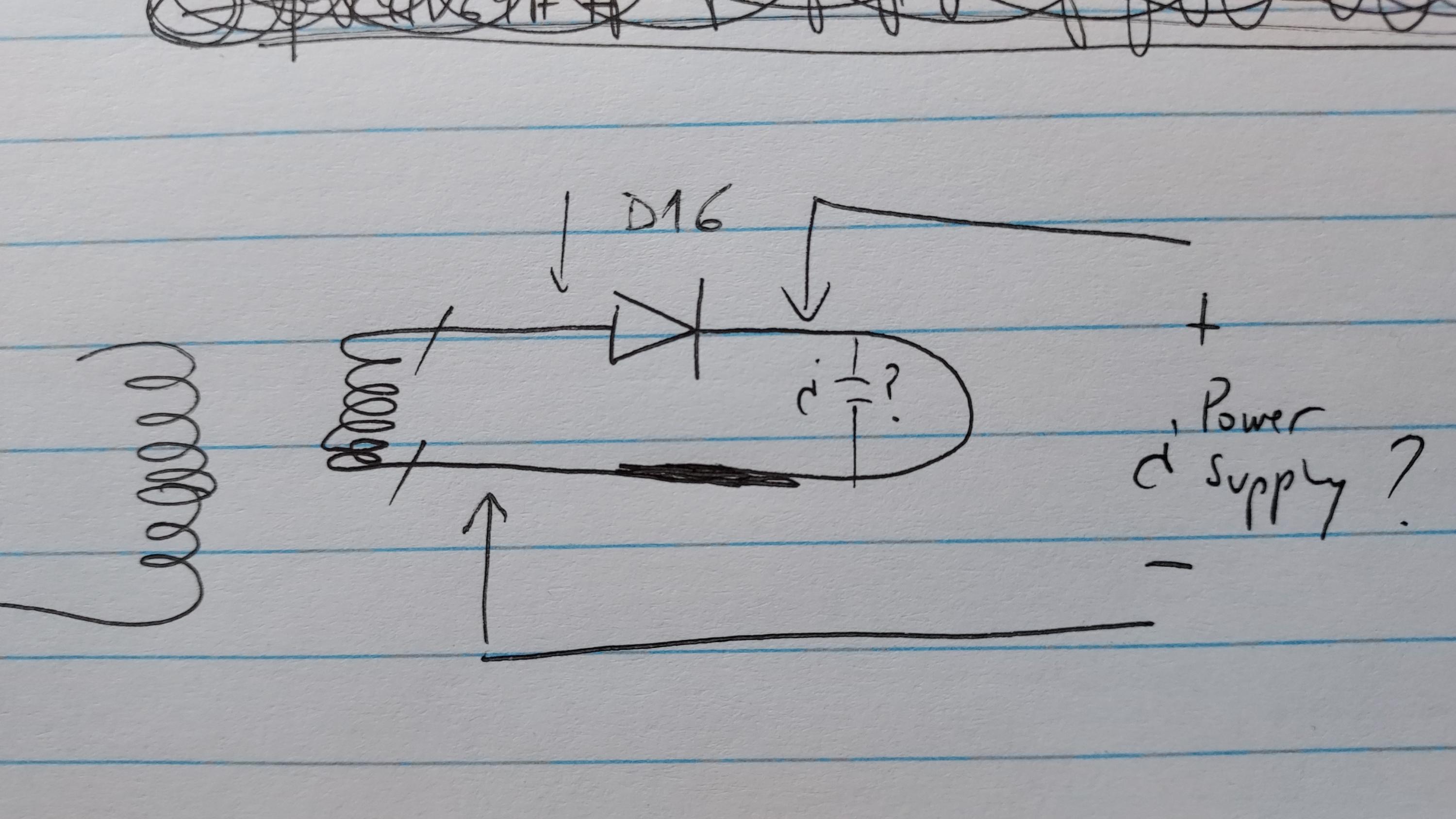

      In the meantime I am trying to "understand" D16. If I remove the transformer the short is gone and the diode reads ok..... so it's something like this right?
      And this means that something is still wrong in that circuit......right? I could try to inject voltage there.........what do you think?

        This is o.k… it’s just a simple half bridge rectifier. Just a small mistake in your drawing, since you shorted negative and positive together after the cap. You didn’t put a load there.
        Just fix the TVS, the mosfets, the fuse and check the parts in the gate drive to the mosfets. Hopefully that’s all that’s wrong with it.

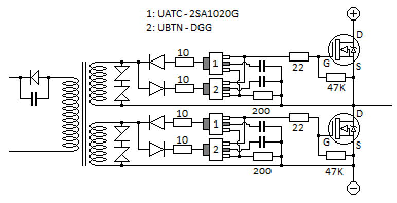

          I leave an schematic for the drive part.......just if someone needs it (I found it and it's very usefull).
