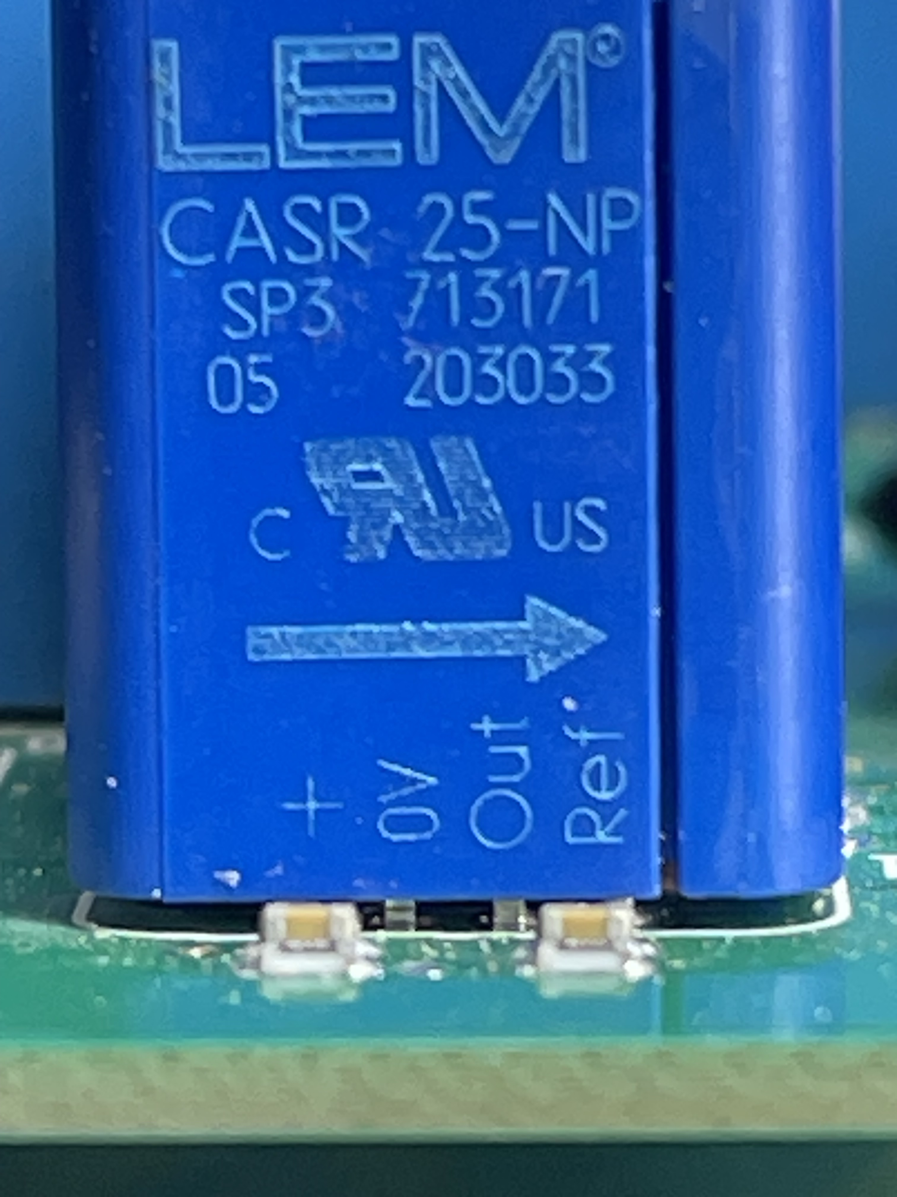

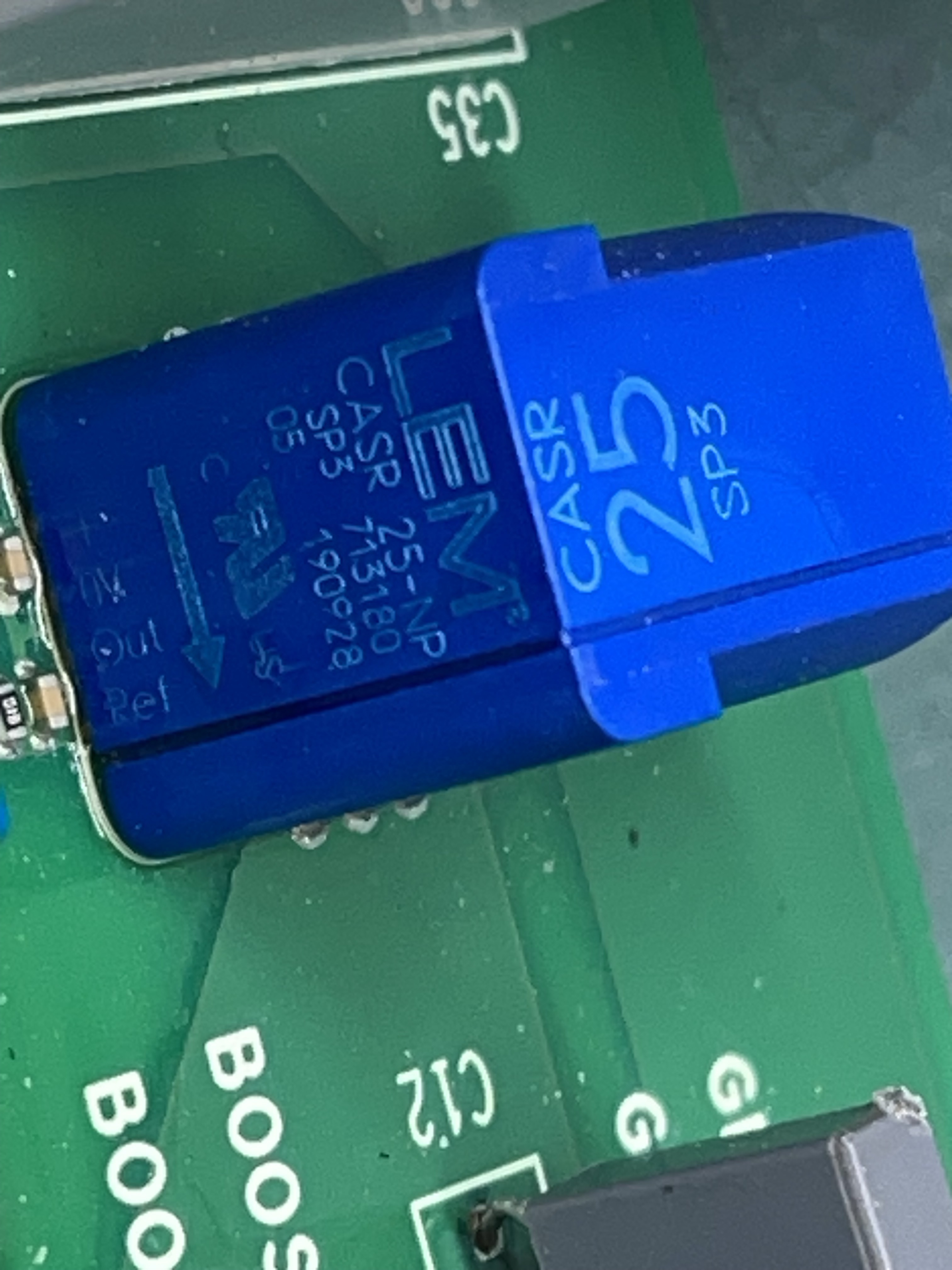

    Hi ssrkh, thank you for chiming in. Couple questions if I may please...
    There are two CT devices on the DC side. There are another two on the AC side. I suspect the error is on the DC side because it happens even with no AC connected. Of course there is another CT which I have already replaced so I will not bother you with that one. Attached are some photos of these CASR CT devices and the datasheet is here: LEM Catalogue CAS_CASR_CKSR_09
    Can you please tell me which pins I need to jumper? Also when you say "ground", are you referring to earth ground? Just want to make sure I do it right. Thank you!

      u r welcome dear simple jumper circuit ground to the CT output pin that will bypass the sensing of the current and ampare will start vary but yoiu can check after that the system is vcompleting the initialization process

      Hi CapLeaker, I'm not sure I understand. My understanding of the CT devices is that they are just measuring current and reporting back to the controller. It seems that if I remove them and test with the megger again, the readings may change because there is no pathway going through them to the rest of the circuit. Road will be blocked so to speak. So I'm not sure what this would point me to. Can you please help me to understand?

          Why not marking the 4 CT's, take them off the board and measure them against each other?

            Do you think the CT themselves could be the problem?

              I grounded the output pins of the CT devices to "earth ground" and still no change. I decided to test the voltage of the output pins. Red probe to pin and black probe to earth ground and got -78V. Not sure what is going on here as the data sheet for these devices state output voltage is 4.65V max.

                  Ok I just did the test again differently. This time I jumpered to a ground pin of another IC (not earth ground). This time I got a reasonable voltage reading from the CT devices.
                  on the DC side I got as follows:
                  CT #1 = 2.354 vdc
                  CT #2 = 2.352 vdc
                  on the AC side as follows:
                  both read 2.464 vdc
                  does that indicate the CT devices are working properly?
                  there was no AC connected during this test. I don't think having the AC/grid connected would make any difference anyway due to there not being any current on that side seeing that it is shut down due to the GFI error.
                  CapLeaker does this information help with comparing the CT devices?
                  by the way, I did jumper these pins to ground to no avail

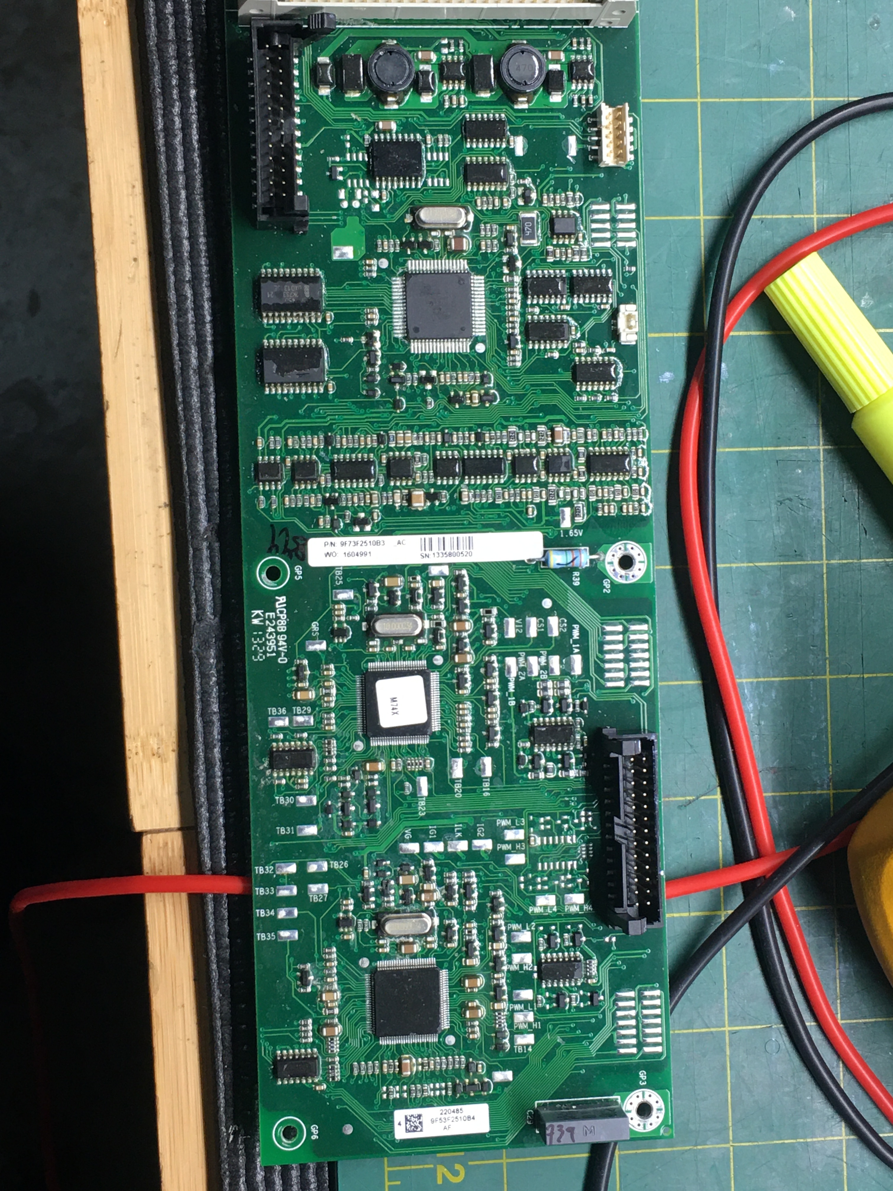

                    Now if I can only figure out which one is the embedded controller. I will try and clean off the goop and see if I can get some decent photos

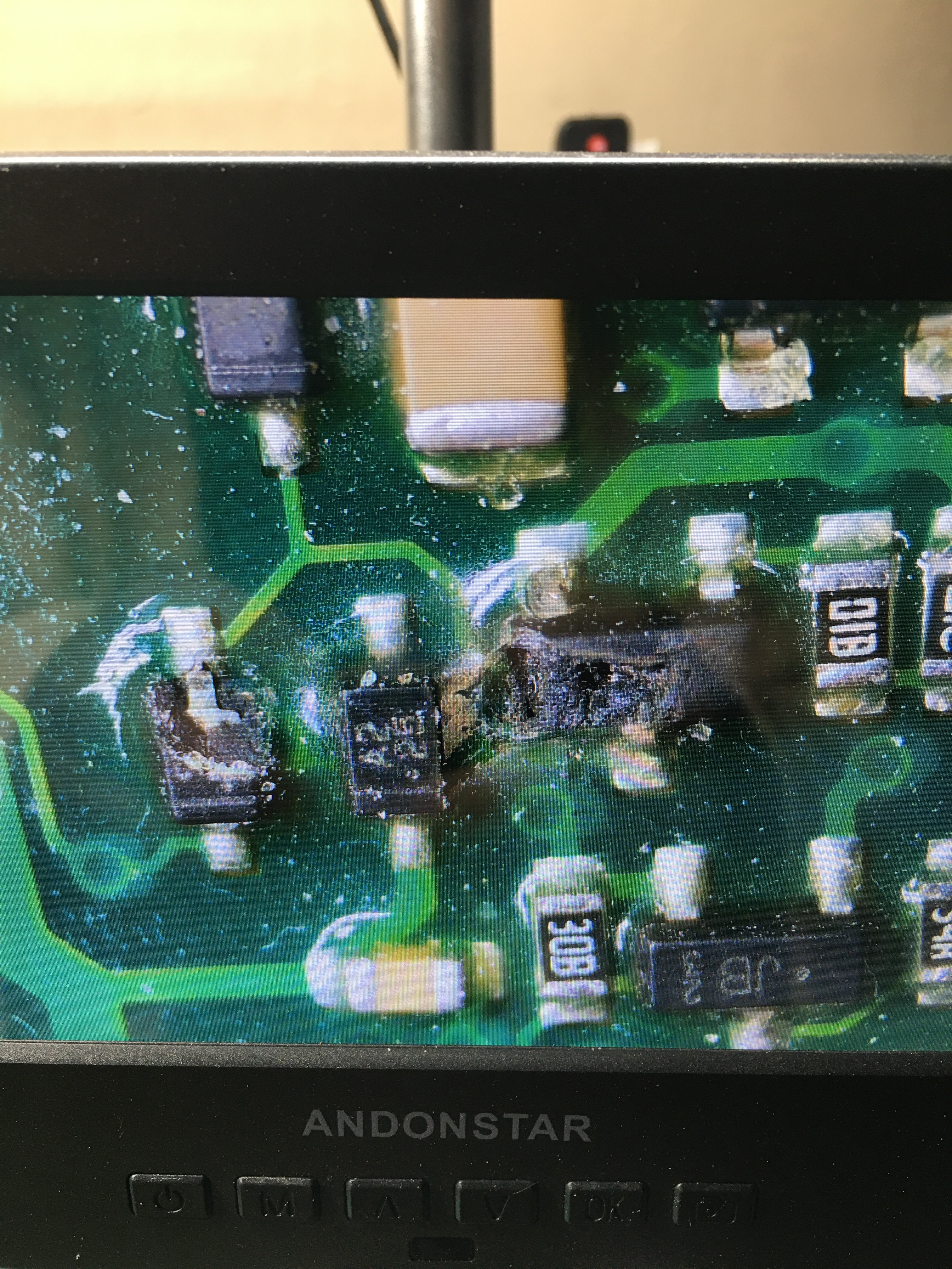

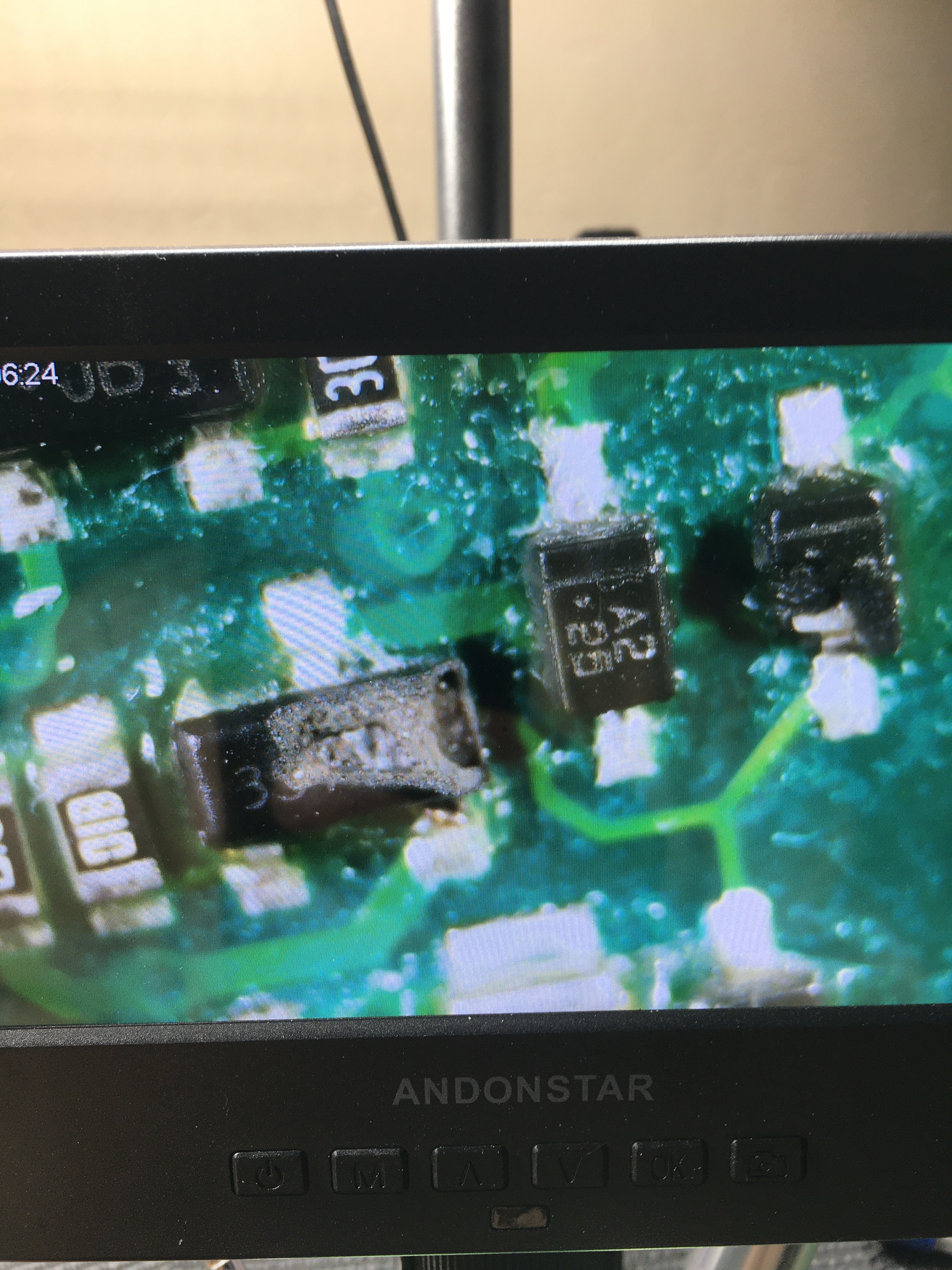

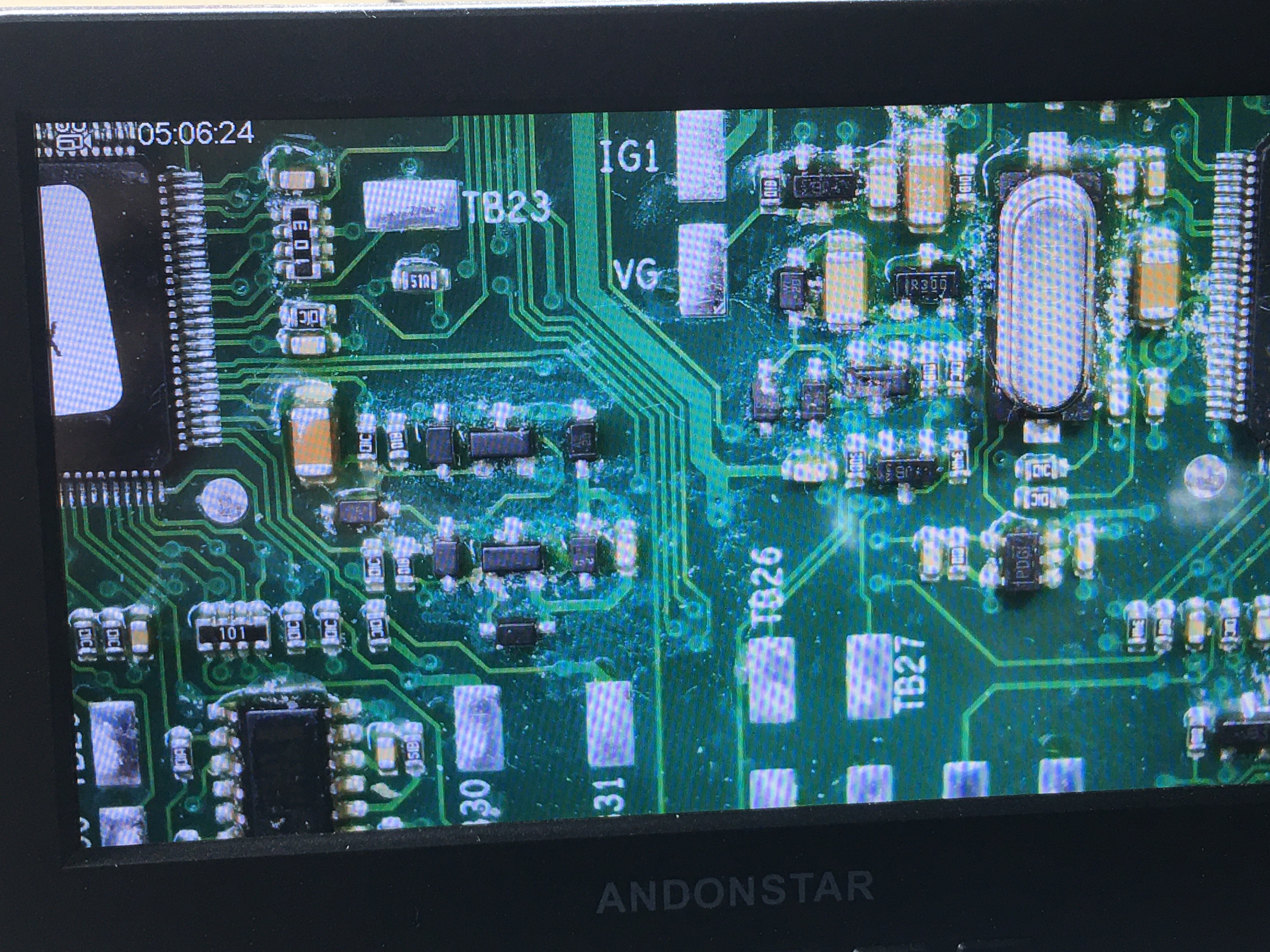

                        OMG! I think I found something on the logic board. I was trying to trace the output of the CT to the logic board and I think I may have found the issue. I don't think it was a true ground fault at all. Look at this photo if these two burned components. One diode and one transistor. Omg how am I going to identify these parts? They are burned. I can read the first two characters looks like a “35” maybe. Now look g to see if I can find another one on the board like it that I can read.

                          • Jul 2011
                          • 6070
                          #173
                          Now this might be real big issue with why you are getting this fault light if this is the part of the circuit that does this function
                          But this is what you need to be looking for any type of visible damage like that this could help you a lot
                          I would agree that if you are getting a GIF error light there has to be some voltage finding it way to ground or the circuit that is suppose to be measuring the voltage leakage is not functioning correctly now the question is what part of circuit is not functioning correctly and where on the circuit board is fault is actually taking place and like what was mentioned earlier not having a circuit diagram for this inverter it is going to be difficult at a minimum but not impossible if you have the background in these types of circuits
                          google tear down of this inverter on YouTube and see if there any that would be worth looking into first and you might get lucky and someone else has had this issue before or find another inverter just like yours on eBay and look for “not working for parts”
                          hopefully it will not be the same exact issue that you are having with your inverter beyond that I do not know what else to suggest to you
                          I have done this in the past when I have had a device that I really like and it malfunctions and I want to repair it I look for the exact same model and I make sure that the boards look the same or as close as possible it makes it easier if can find the same exact one like the one you have

                            I think I may have found a twin. What do you guys think?

                              #175
                              Sam, I agree with you 100%. My mistake. I should have visually inspected all boards under the microscope. The burned components were actually on the logic board where I focused almost no attention. Lesson learned and I will definitely pay more attention next time. Thank you all for helping me learn. I'm still not done but I am cleaning up all the goop and trying to find some kind of signs to lead me to the part numbers on those components. There are at least 3 zener diodes and that 351A part. Making good progress. I will post more photos after cleanup. Thank you again. You and CapLeaker and Peter have been great!

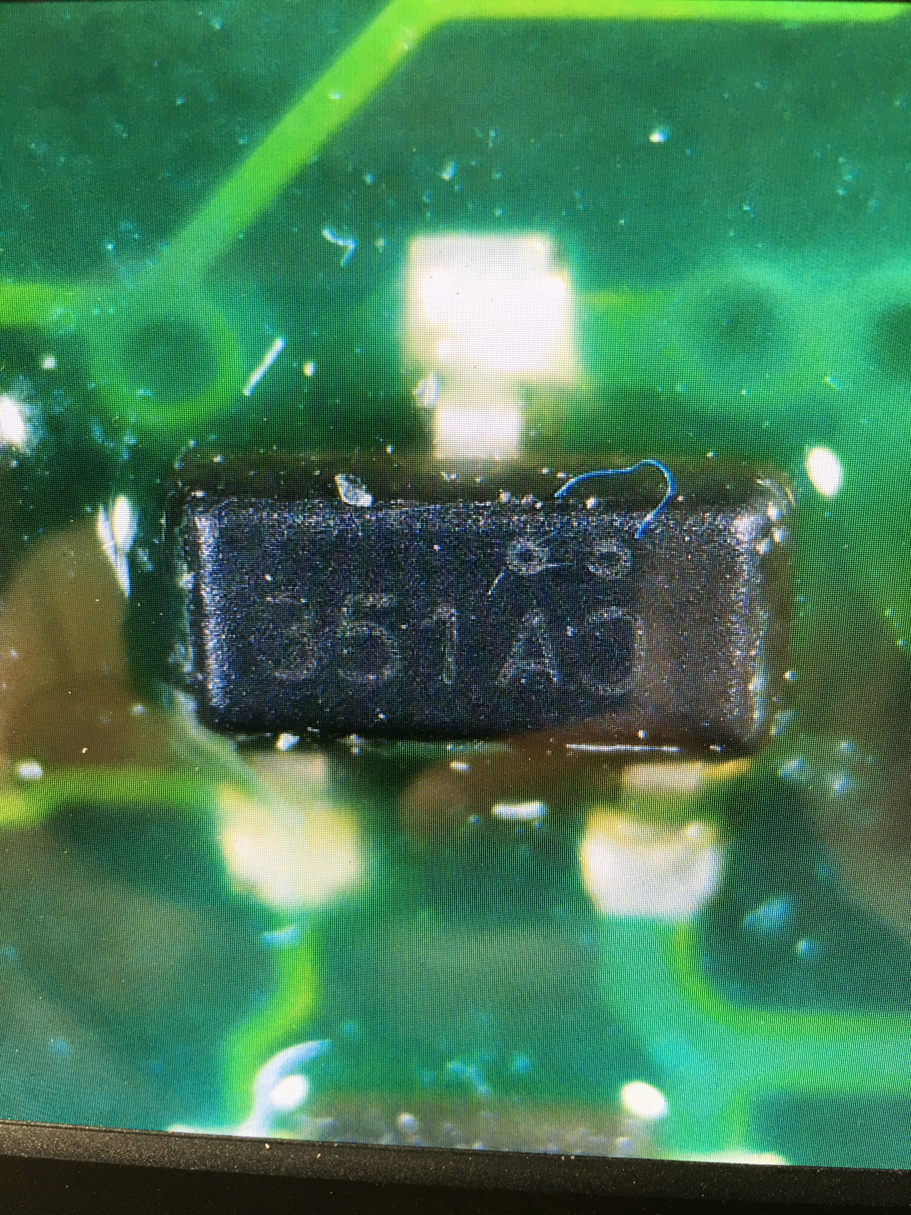

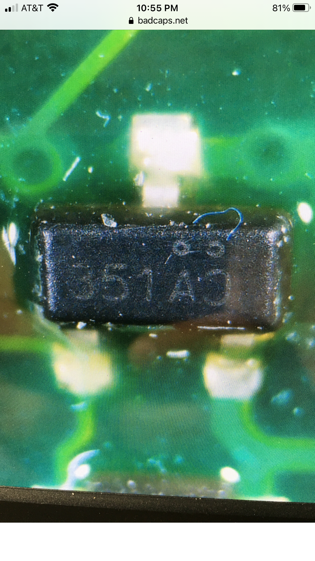

                                #176

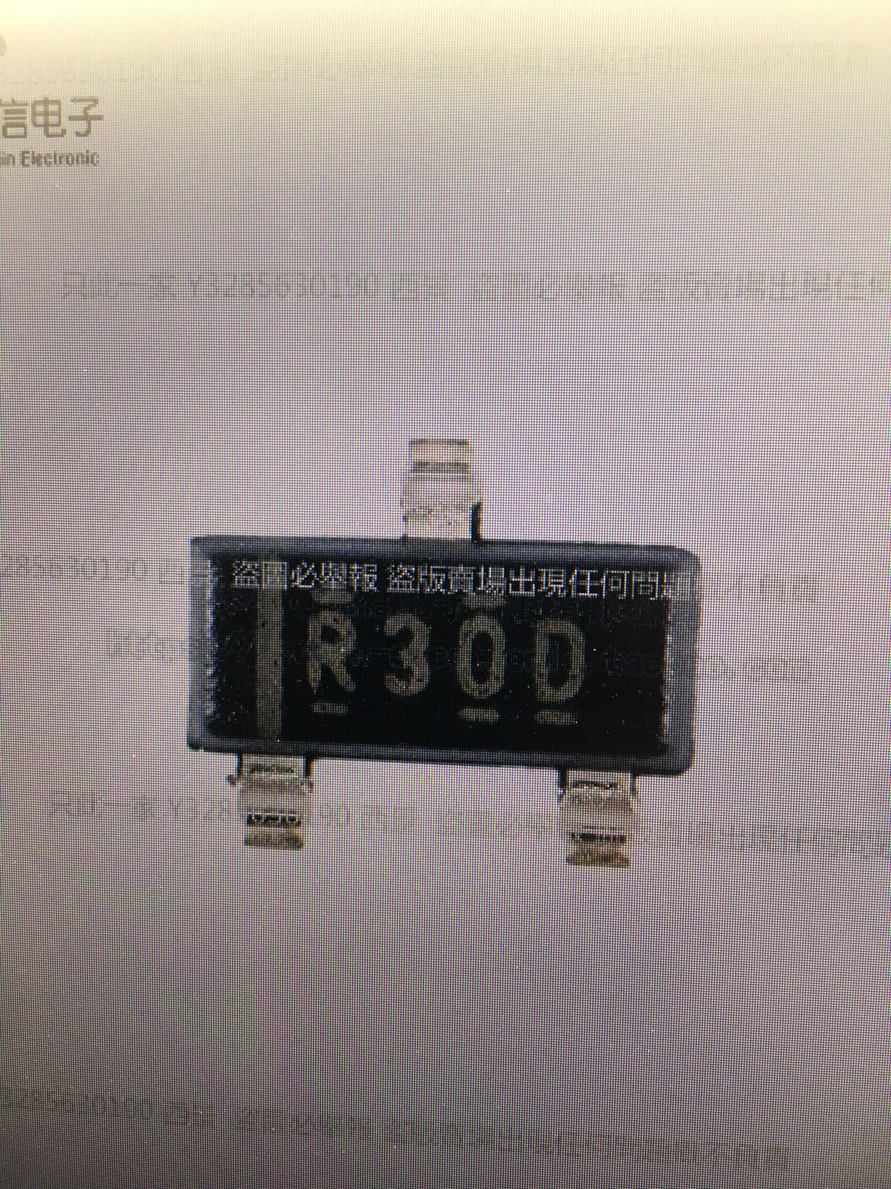

                                Anyone know what this is? It is a SOT-23 package I believe.
                                • CapLeaker
                                  Leaking Member
                                  • Dec 2014
                                  • 8352
                                  #177

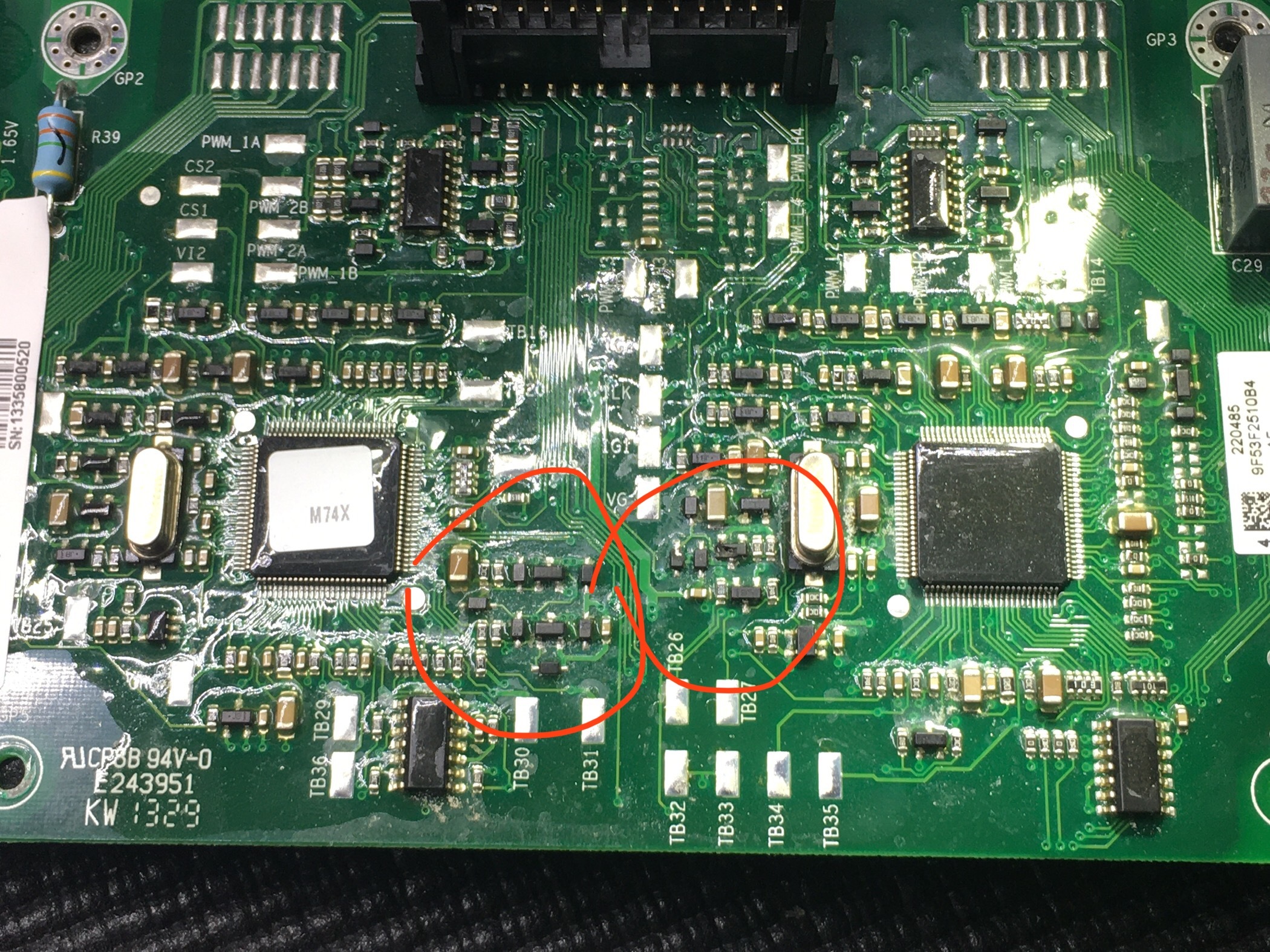

                                  Awesome! You found more damage! Maybe circle the area in a picture where you found them. I was thinking about the output circuitry of the CT. After all it goes into a fluxgate, a driver and a differential amp, plus a reference voltage, That does explain at least a part of the GFI instant error, but you would still have a GFI fault problem with these voltages you measured against earth ground. Keep in mind the location of these little components.
                                  • mitsu2k
                                    • Aug 2013
                                    • 219
                                    #178
                                    I will get that photo to you shortly. Please forgive the less than optimal quality of the photo. I sent my phone out for Repair so I'm using my spare old phone right now. But just to let you know, I found several diode‘s, Zener diode‘s, and those 351A MOSFETs that were shorted in that general area.I think I have identified them all and hopefully I'll be placing an order with Mouser today after I check other components

                                      #179
                                      • petehall347
                                        • Jan 2015
                                        • 4450
                                        • United Kingdom
                                        #180
                                        the chinese translates to . You must report any pirated pictures. Any problems in pirated stores.
