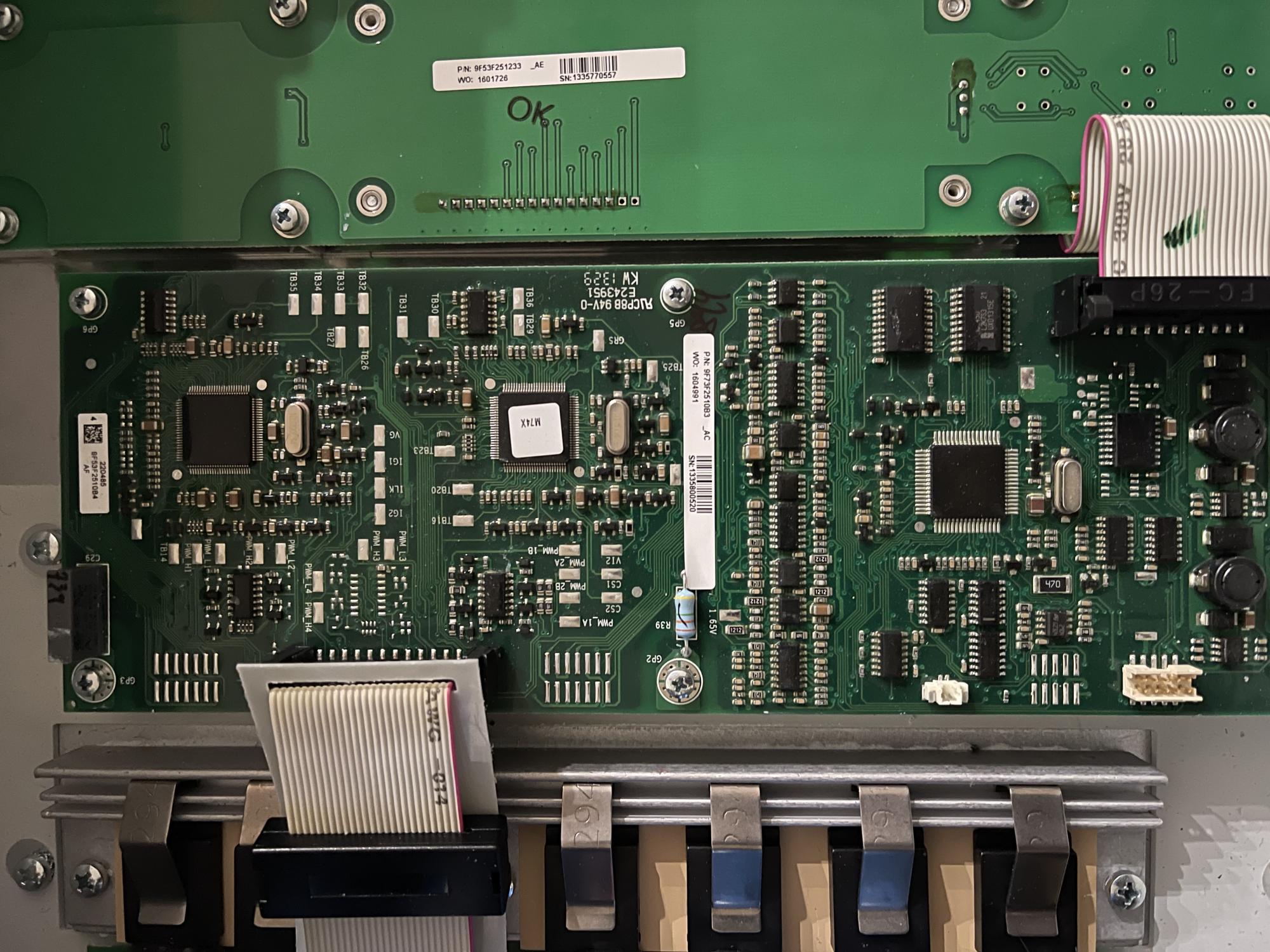

                #107
                Re: Power-One solar Inverter driving me NUTS!!!
                On another thought, I recall reading in the manual about the Riso low GFI error. I read that this error of the GFI LED will come on at below 1 megaohm. This would indicate a leakage to ground on the PV side. The way, I understand this, is that the inverter is made to work on 1 megaOhm or above. When I power it on, and it does the RISO check, it comes back at 20 megaohms which is good and normal. So I guess what my point is, the 1 megaOhm that I am reading with the megger when the second board is connected may be normal.
                • CapLeaker
                  Leaking Member
                  • Dec 2014
                  • 8116
                  #108
                  I am not so sure about this. There is no real guideline one fits all approach. To me anything that’s 1 MOhm or below inside the inverter, is garbage in my book, but then I don’t know your inverter either.. If you look for a specific value, you find these are all over the place. But generally speaking the 1 MOhm is what most people go by unless they only deal with one unit or know it well enough to know the exact threshold, ins and outs, etc.
                  What really gets me is that the GFI error comes on right away, but yet no error codes. That leads me to believe it may be something the computer doesn’t monitor. Some older units have a 1A fuse installed between neutral and earth ground, but I don’t see it in your unit. Next on the list are the MOV’s and they all measureing fully open, no resistance at all. Could be leaking caps, IGBT, diodes, a bad relay, but so far nothing.
                  So all I can come up now with is this: these charcoal burnt spots. Is there maybe a via or trace where the black goes from the hv part of the relay to somewhere as carbon is conductive. Just very little moisture on the exposed black PCB can give you a reading on the DMM or better the Megger. Try it with 99%IPA and you will be surprised.
                    • Jul 2011
                    • 6033

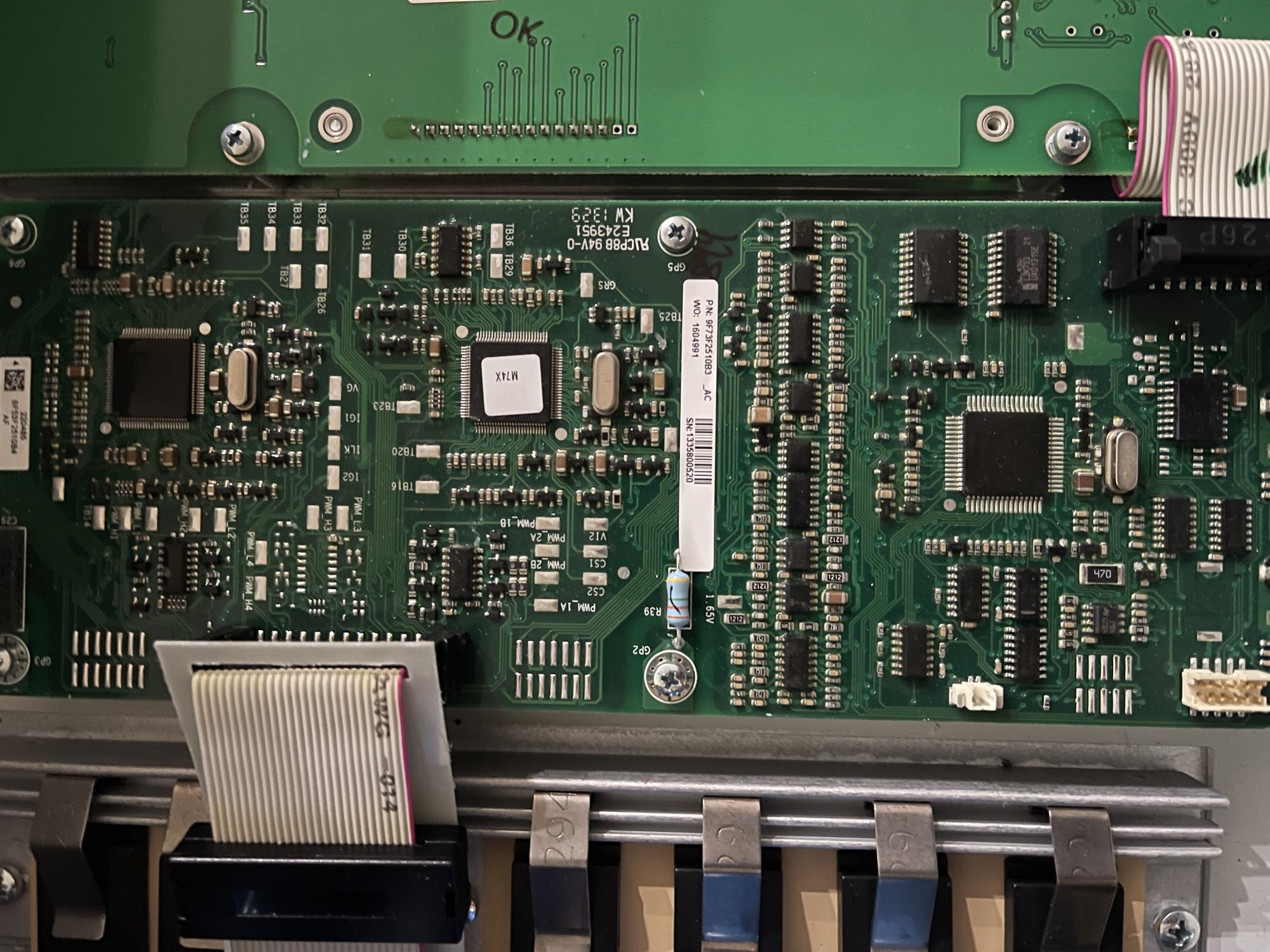

                          #112
                          Here is what I am referring to as the computer board.
                          • CapLeaker
                            Leaking Member
                            • Dec 2014
                            • 8116
