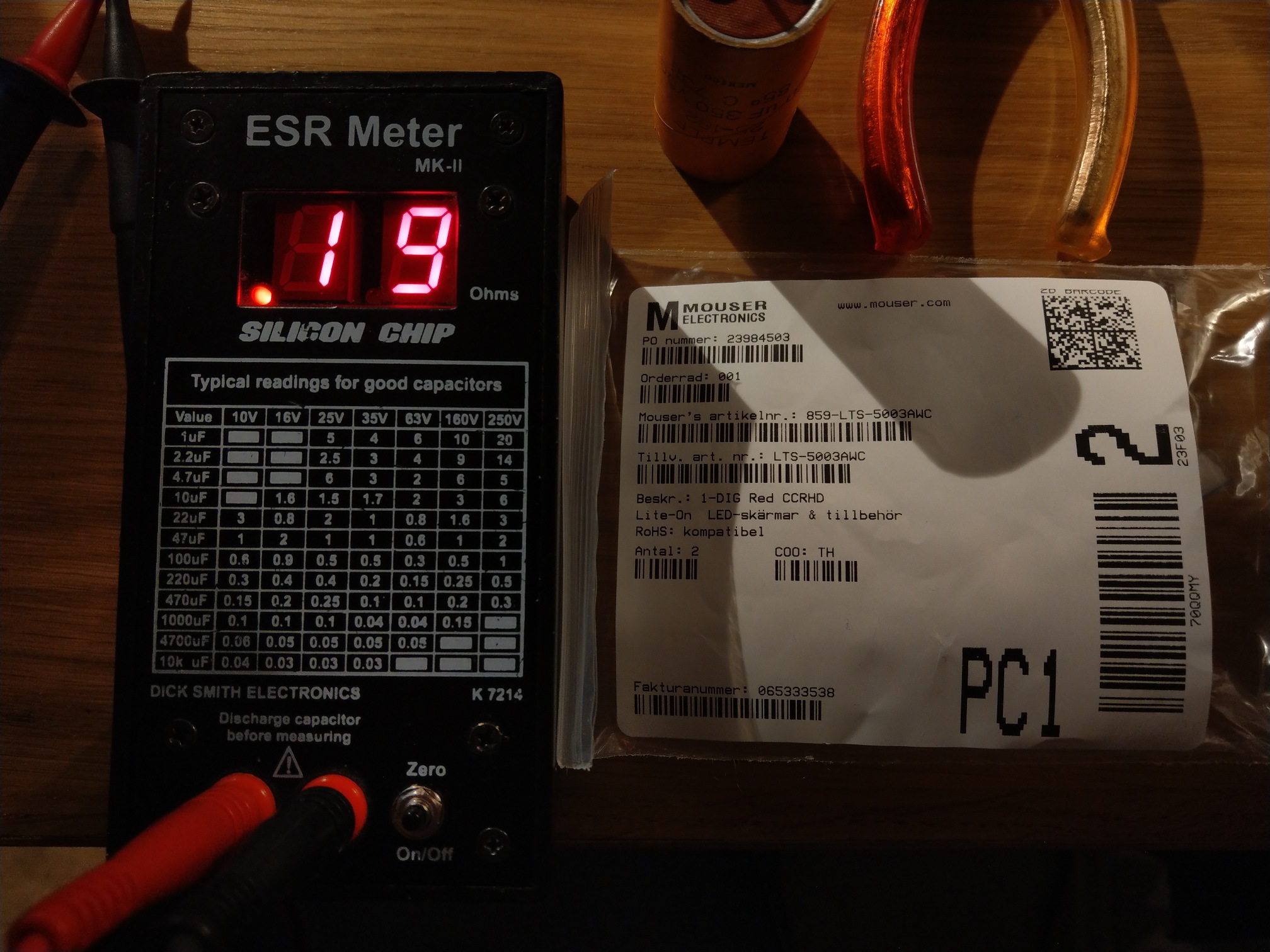

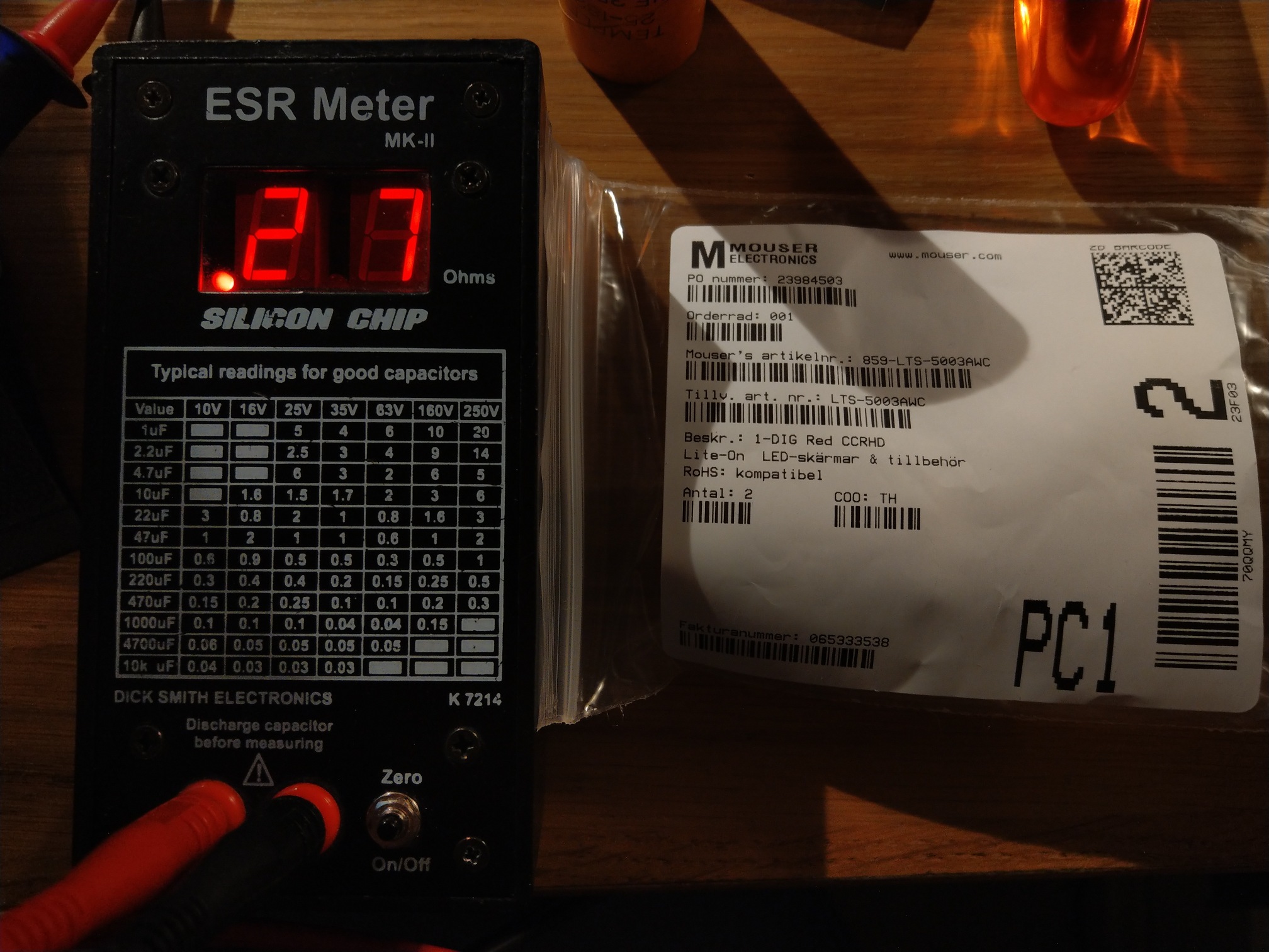

                        #1111
                        Re: ESR meter upgrades
                        Considering the title of the thread I didn't want Bop Parkers great ESR meter to feel left out!
                        So here it is with some nice new bright Lite-On LTS-5003AWC 7-segment LED's before and after
                        Original LED's:
                        Replacement LED's:

                            #1113
                            Original LED's:
                            Replacement LED's:
                            Thanks Per. It's amazing how much brighter even cheap Chinese displays are, compared to what was available back in 1995 when I designed the original meter! 👍
                            It is a good shrubbery. I like the laurels particularly...

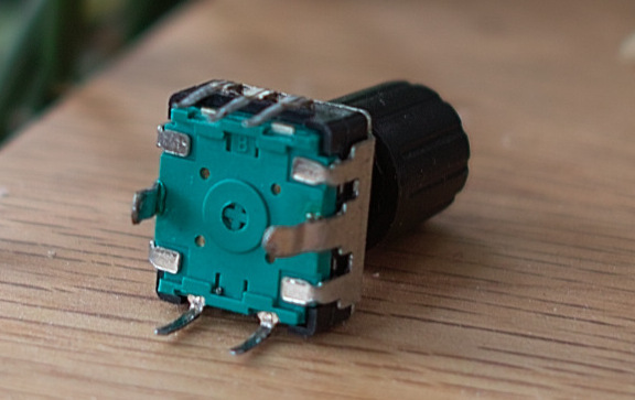

                                    • Per Hansson
                                      • Jul 2005
                                      • 5895
                                      • Sweden
                                      #1118
                                      You can see a photo of the top of the encoder in my original build photo way back in this thread: https://www.badcaps.net/forum/attach...6&d=1468518476
                                      Here is how the bottom looks, it is light green, this is what was delivered with the DIY kit...
