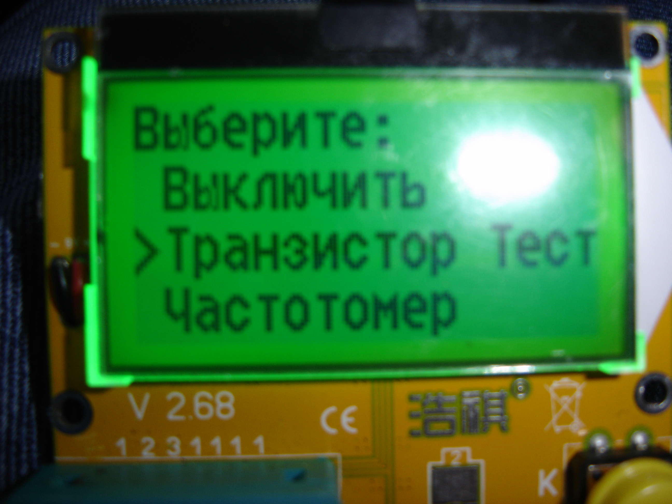

                  Have been trying to find suitable firmware for the upgrade to 16mhz for my
                  LCR-T4-H, and down loaded this from a RUSSIAN site, any help would be appreciated.
                    • 31025
                    #909
                    Re: ESR meter upgrades
                    vext?? never seen that before.
                    i wonder if it was modified in some way for a lithium power source.
                    • TEDDIBEAR
                      • Oct 2014
                      • 45
                      • england
                      #910
                      This is the firmware that has given me the vext screen.
                      LCR_T4StripGrid_Ver736Ru_8x16t_Vext_Encoder_16MHz.zip\
                      If I could get the english version I think it may work on my LCR-T4-H.
                      John

                          Is there a way of changing the language easily as I would like to give this firmware a go unfortunately it has Russian text.
                          John
                            • 31025
                            #913
                            not unless it comes with the makefile / source

                              Have just received encoder and fitted to my LCR_T4_H along with two 10k & two 1k resistors, also changed 8mhz crystal to 16mhz but seem to be unable to find any firmware that will work the \LCR-T3,4_v1.12k_r660_ENC13.zip\LCR-T3,4_v1.12k_r660_ENC13\ works of sorts showing capacity at double the value
                              and locks up as soon as you move the encoder to blank screen you then have to disconnect the battery to reset it. any help will be appreciated.
                              John
                                • 31025
                                #915
                                i'll see what i can do later

                                    I have now found firmware for my LCR_T_4_H as stj has suggested it uses T4 stripgrid, every thing seems correct as far as component diagnostics with the 16mhz crystal and encoder fitted.
                                    The problem I have is I can select items from the menu with the encoder but can not open them, with any amount of pressing the button, any ideas.?
                                    Thanks Gabiz I have tried that one with no luck. Sorry thumb nails are bright and poor focus unable to reduce contrast.
                                    John

                                      • TEDDIBEAR
                                        • Oct 2014
                                        • 45
                                        • england
                                        #919
                                        so long-press does not select?
                                        what i'm looking into is a new makefile that auto-calculates some settings.
                                        for example the number of menu lines can be derived from the display "y" size divided by the vertical size of the selected font.
                                        so no need to change it manually for different hardware or font settings.
                                        Have tried many combinations holding button down from a quick click to 30 seconds, I was wondering if there is an enable contact on the chip that could be switched.
                                        John
                                          • 31025
                                          #920
                                          well i'm confused.
                                          there is only one button input, and i assume it works because you can power the unit on.
                                          maybe that assumption is a mistake - let me check the schems.
