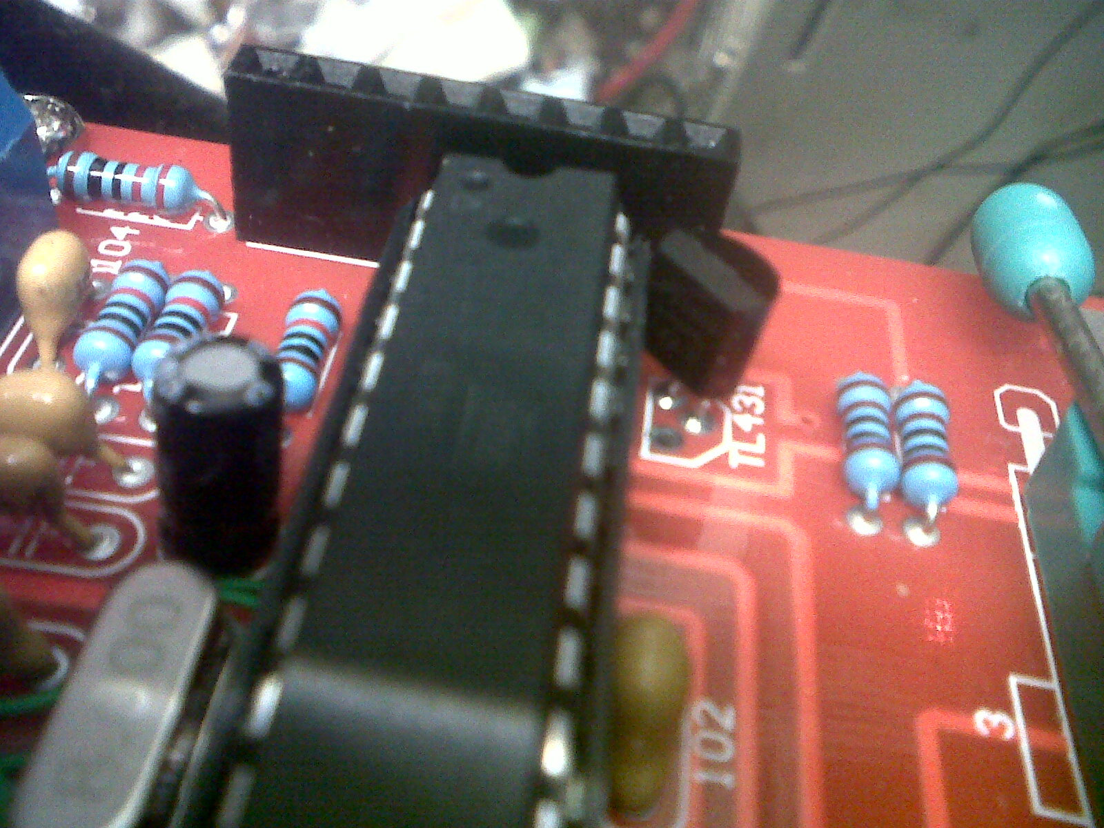

    Re: ESR meter upgrades
    here is your foto of using an LM4040 inplace of the TL431

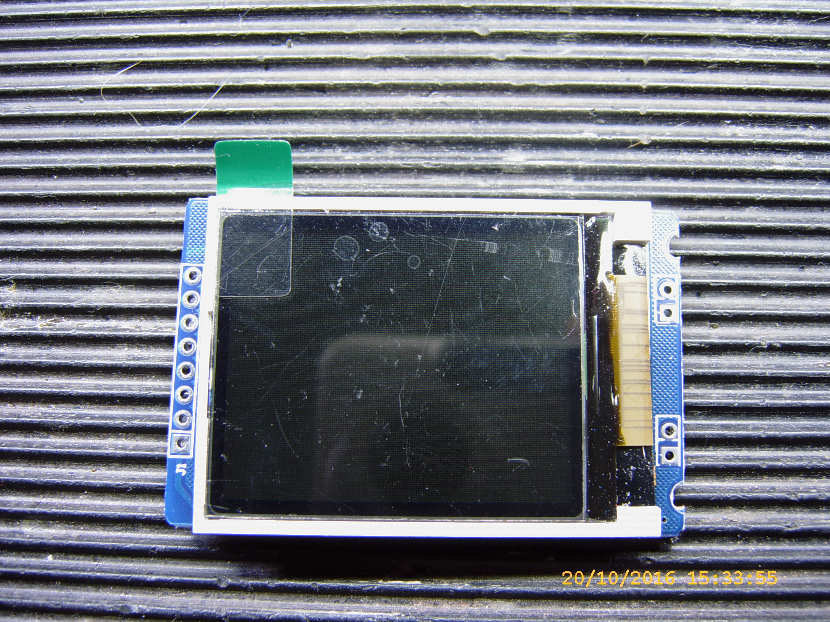

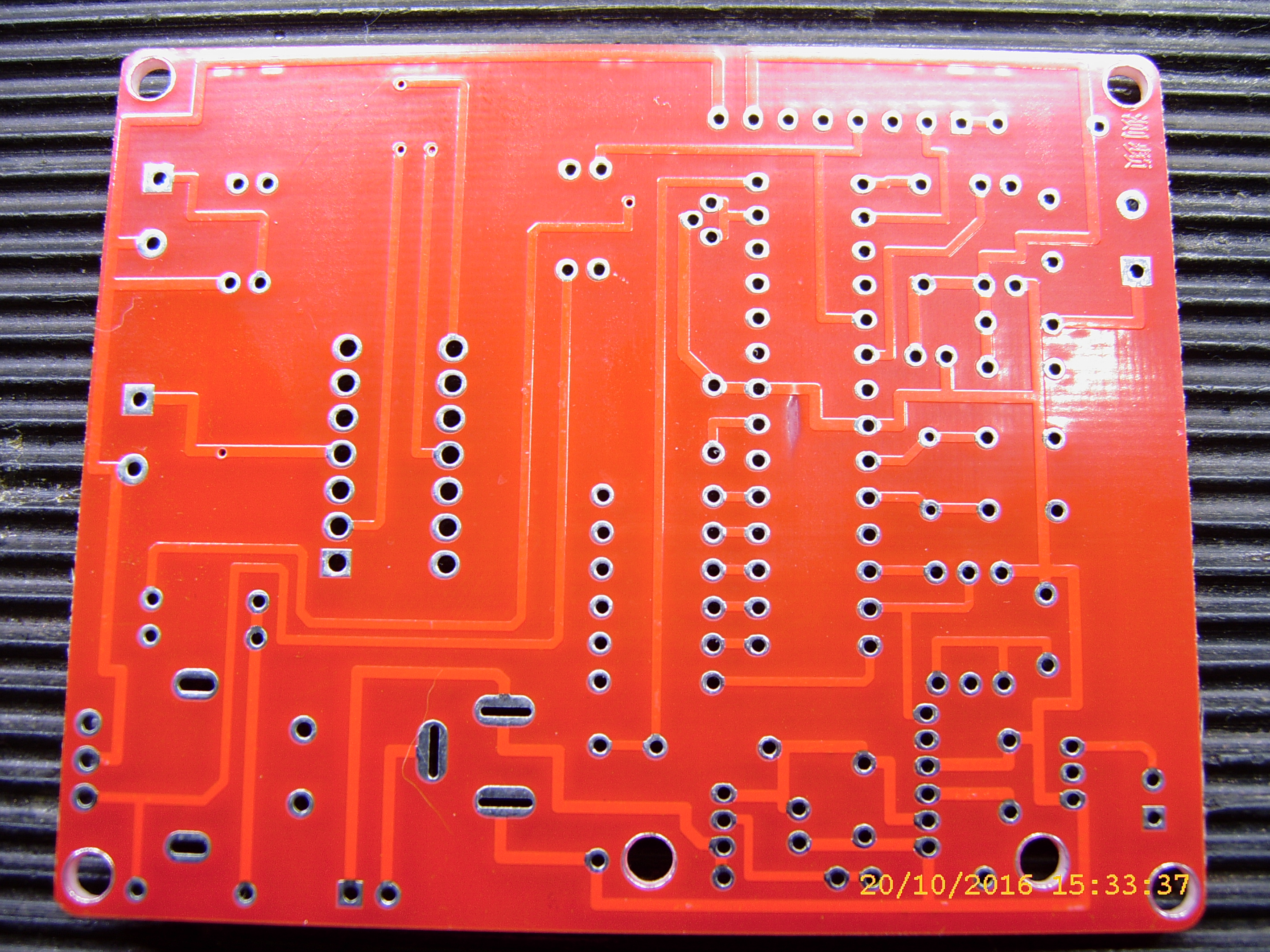

                            A few days ago my Tester DIY Kit arrived. But without any documentation. Only the PCB and the parts.
                            My question is if someone with the same tester can take a picture of it without the LCD installed? That would help a lot.
                            And i want to ask if it is possible to protect the tester against a charged capacitor. Or better protect the tester in case i forget to discharged a capacitor.
                            That are the parts i got from ebay (the 16Mhz crystal is still in transit but the LM4040 is already here)
                              • 30979
                              #714
                              i dont know why a foto would help? all the part values are marked.
