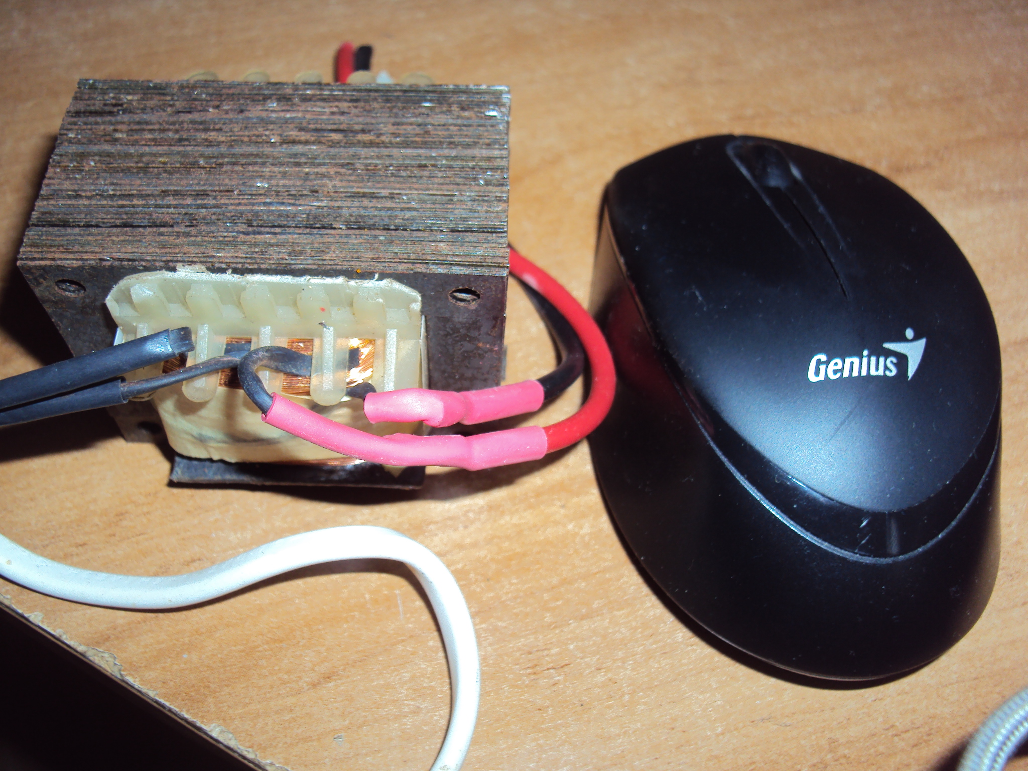

                  Re: Isolation Transformer - Use One!
                  Here is mine.
                  Obviously not using it

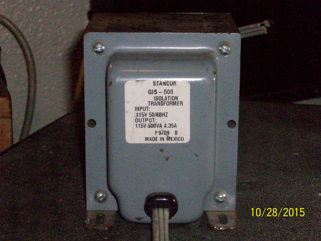

                    I have this one, unused, bought new for $20 back in 2000. A dog chewed off the output cord before I ever got the chance to use it.
                      That is a good isolation transformer.
                        Thanks for the pdf Bud. Yeah, I knew it to be a good quality unit when I bought it and when was fiddling with tube amps. I've got to get it wired up to an outlet or power strip. I don't like molded in-line ac jacks that much so the dog picked the right wire to chew off
                        It seems heavier than 16# though.

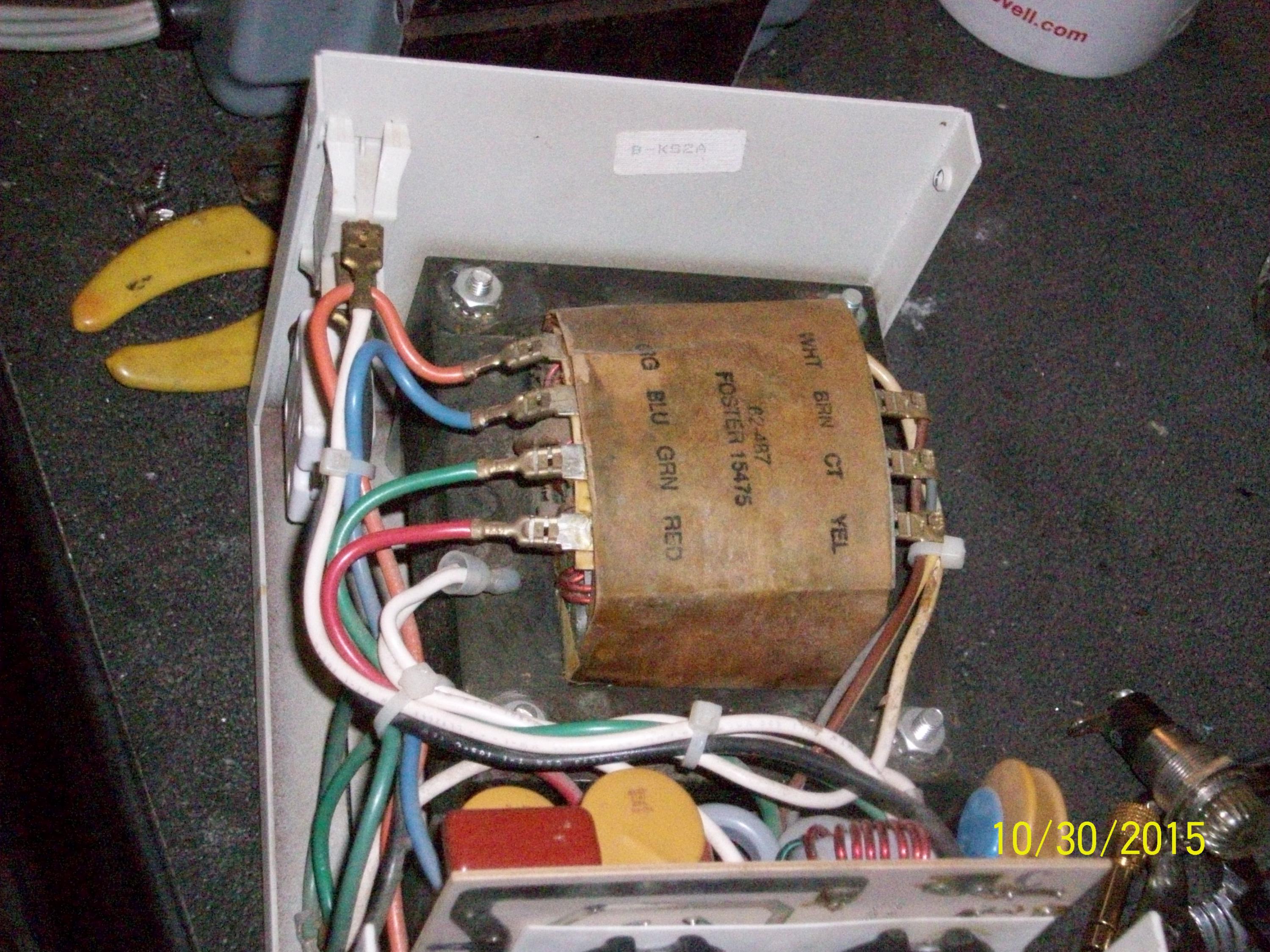

                              I've got an older Trippe-Lite LC-1200b line-conditioner with a big fat transformer in it. I don't know if it is isolating or not. Can't find enough tech info about it. It's switching with relays between different transformer taps.
                              There's a 1K trimpot on the board but no indication of what it adjusts. Last time it was used the output was 110vac when connected to 120vac.

                                Nope, not an isolation transformer but I adjusted the trimpot to switch to the 120v tap with 120v input.
                                  It is AC Voltage regulator (switching taps on the transformer using relays to maintain AC output) and Line conditioner.

                                    I do know what it is, just not sure of exactly how it is doing it.
                                    Measuring the transformer disconnected there is isolation between one winding and the other but I don't know which is pri or sec. I know in operation there is continuity between input neutral and output neutral and that is not an isolation. I can't find a schematic for the board so I guess I'll just have to get the board out and trace it out to see how it's being used if I really want to know. If I can. If I care enough to.
