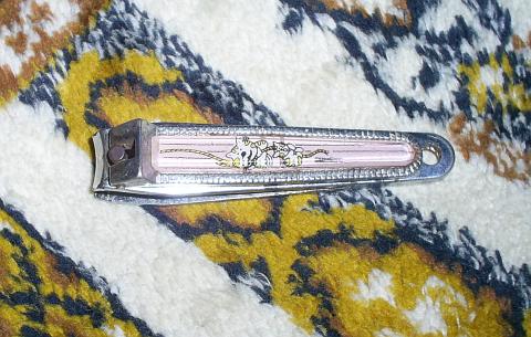

                  I simply use a nail cutter it has been working great since i was in junior high school... It dont let the remaining lead to jump/escape to everywhere.. It keep my works clean.. I rarely need a plier/cutter to cut the leads.. (except for the transformer/coils).
                  days are so short when you actually do something..

                      .....i'm just using a plain old fingernail clipper....works fine, snips right where i want to....

                        Preferably I use cutters like the ones will posted photos of
                        (the idea be more to cut the component leg not crush it off)
                        Nippy "type" cutters should result in minimal stress to the joint
                        Al thought those that you posted harvey look like a good one and
                        should avoid the problem (smaller as you say)
                        (like the nail cutters)
                        The only thing is (in my opinion) whatever you use should "cut" not "crush" the component leg off
