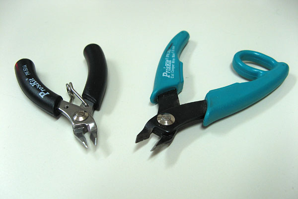

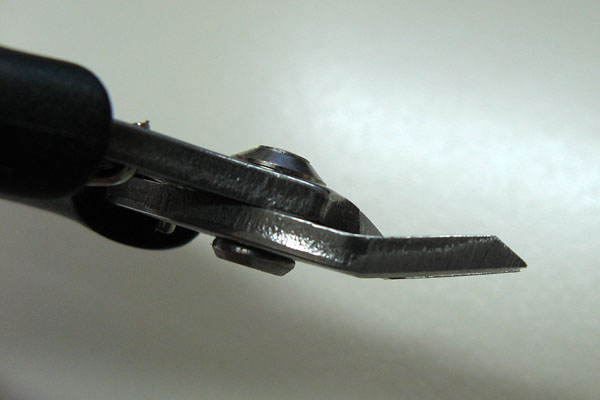

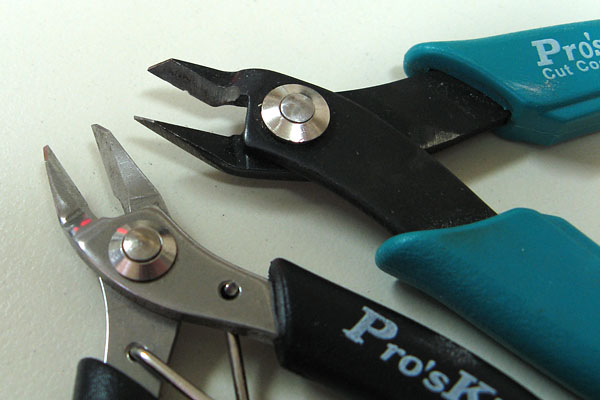

      Re: warning!xcelite flush cutters!
      well i dont see this as a reason to not buy xcelite brand, just to pay attention while using them. give some people the finest tools and they will screw it up by not being careful.
      i use ProsKit which i have recommended before. but any small lead clippers would work.
      the most important thing is that the blades are angled like the last photo. so while you hold the handles at a comfortable angle, the blades are parallel with the board. and there is not need to cut everything very low, just equal to the existing leads sticking out of the board.

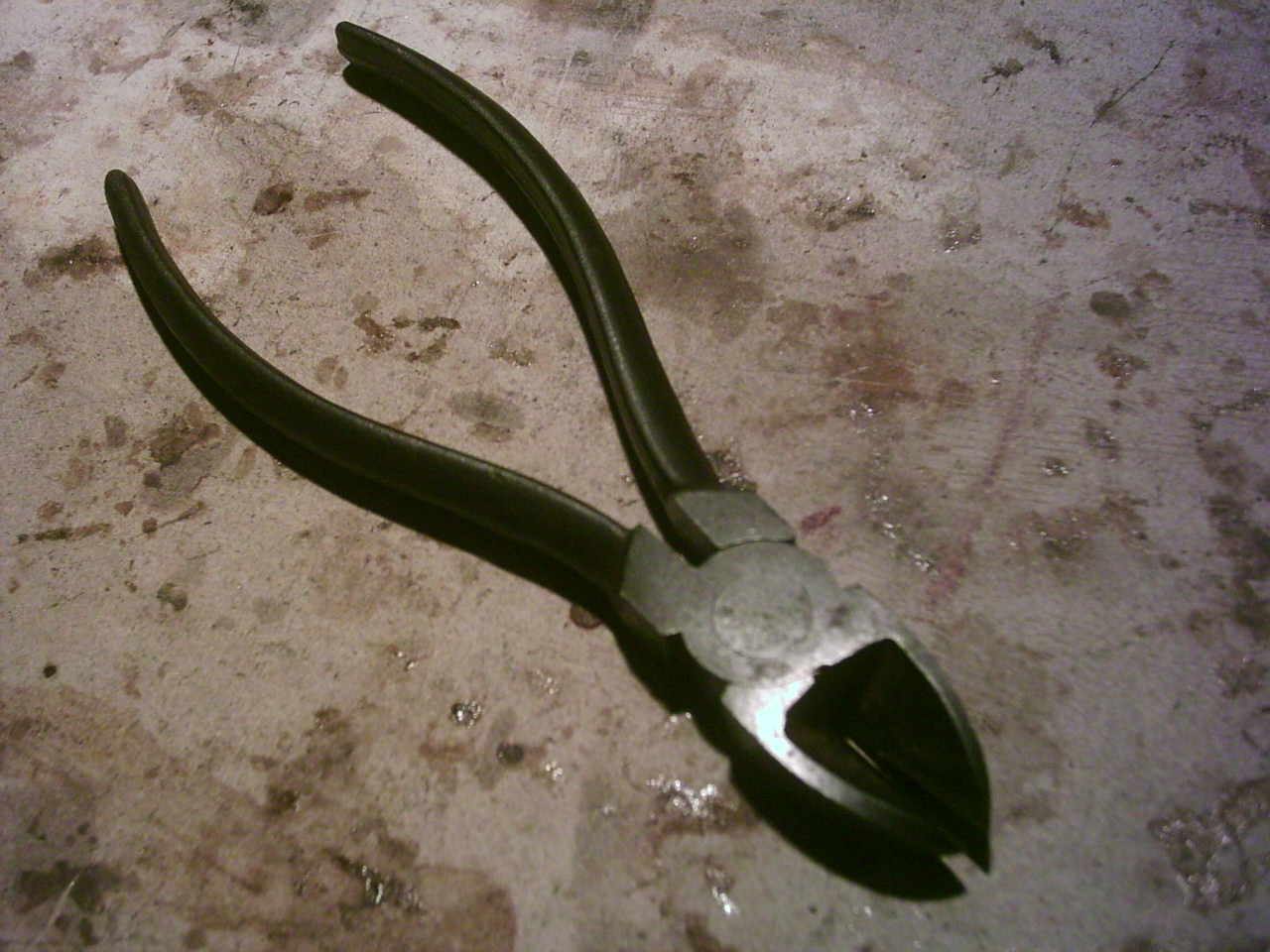

                Well this pair of side cutters does the job for me, not remotely as nice looking as those pro'sKIT pieces, but the cut is closer than whatever the mass soldering machines (or skilled monkey's) use
                I suppose they could use some new rubber grips or heatshrink though

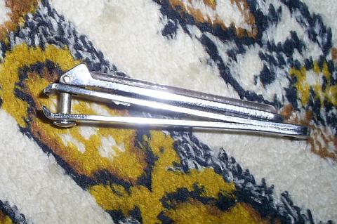

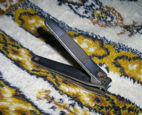

                  I simply use a nail cutter it has been working great since i was in junior high school... It dont let the remaining lead to jump/escape to everywhere.. It keep my works clean.. I rarely need a plier/cutter to cut the leads.. (except for the transformer/coils).

                      .....i'm just using a plain old fingernail clipper....works fine, snips right where i want to....

                          I use side cutters like the ones Taz pictured. I would never use something with sharp tips like that.
                          If I can't cut the leads while applying light pressure downward I bend the leads slightly upward then make the cut so I don't have to jab the cutters down into the board hard and tear traces up.
