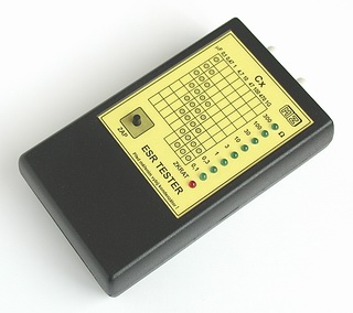

    Cheap ESR meter
    I bought this as a DYI kit http://www.zajic.cz/esr/esr.htm
    Assembling was not hard and it works fine. It's not as good as ESR meters with display, but still good enough to test many caps.
    As you can see from the photo, the PCB is very simple.

            Re: Cheap ESR meter
            thats the big brother, bob parker design same as this one
            https://www.badcaps.net/forum/showthread.php?t=1287
            difference is that this one doesnt have an lcd readout, it has leds.
            the interesting ones are ohm 0.1, 0.3, 1.0, 3.0
            if we check my example readings, it will catch the bad caps because they will measure above 0.1 and more likely 1.0 to 3.0. its not perfect but useful.
            Sanyo WG 2200uf 6.3v : 0.0 ohm (too small to measure)
            Panasonic FC 1000uf 50v : 0.01 ohm
            Panasonic FC 3300uf 6.3v : 0.02 ohm
            Ost 1000uf 6.3v : 0.04 ohm
            Chhsi 1000uf 6.3 : 0.06 ohm
            GSC LE 3300uf 6.3v (bulging) : 0.27 ohm
            Gloria 1000uf 50v (bulging) : 1.1 ohm
            Jackcon 1000uf 10v : (bulging) : 1.5 ohm
            Jackcon 1500uf 6.3v (bulging) : 1.6 ohm
            JPCON 2200uf 6.3v (bulging) 2.1 ohm
            Lelon 1500uf 10v (bulging) : 2.78 ohm
            Gloria 1500uf 6.3v (bulging) 5.0 ohm
            on another matter, say if i measure a cap on the board as 0.04 ohm, when i desolder it, it will measure 0.05. i dont know if this is damage from the desoldering or just a more accurate reading from when it is off the board.
