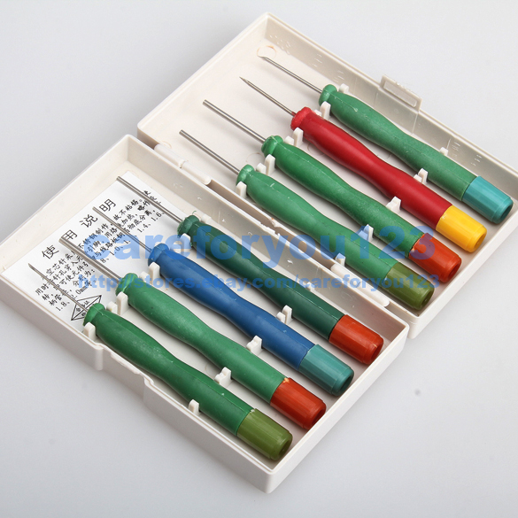

Looks like the Chinese are on to the needle method!
  • Agent24
    I see dead caps
    • Oct 2007
    • 4953
    • New Zealand
    http://www.ebay.com/itm/8pcs-Hollow-...-/140634502886
    Got to love the Chinglish
    "Use the needle penetration component pin, heated with a soldering iron, slightly rotated, you can make the copper component pin and line separation"
    -David VanHorn
  • retiredcaps
    • Apr 2010
    • 9271
    Re: Looks like the Chinese are on to the needle method!
    Geez, the fit and finish of the tool is terrible. It looks like it is made of candle wax.
          Looks more like a Molex connector pin removal set. Love the hypodermic tips on 2 of those.
          For $2.31, I might just have a go at one set.
          veritas odium parit
          • PCBONEZ
            Grumpy Old Fart
            • Aug 2005
            • 10661
            It is a pin removal set.
            Or possibly a really cheap leather or gasket punch set.
            [Removable end of the handle may be the exit or clean-out for the 'punchings'.]
            I'll bet if you heat them up soldering the metal will melt out of the plastic handles.
                                    Well, got this fairly quickly. About 10 days.
                                    Attached a pic from the auction.
                                    Box is 4" x 2.5"
                                    Handles are 2-5/8"
                                    Color caps on handle ends just snap on for color coding.
                                    OD of Blunt hollow tips are 1.0, 1.4, 1.6, 1.8, & 2.0mm
                                    OD of Hypodermic needle tips are 0.8 & 1.2mm
                                    ID of each is 2 sizes down from OD - 1.6mm fits inside 2.0mm
                                    OD of Solid pointed tip is 1.2mm
                                    Am going to blunt the hypodermic ones. Just too dangerous to be laying around on the bench.
                                    The flashlights were more interesting than this. One was nicely made and -very- bright for a single LED.
                                    Toast
                                    veritas odium parit
