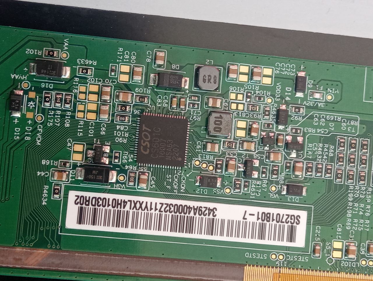

help SG2701B01-7 panel chinese, would this integrated circuit be equivalent? Chinese IC CS601C regulator.
  • valente222
    • Feb 2021
    • 91
    • PERU
    Hi, I'm repairing this Chinese SG2701B01-7 panel. There isn't much information about it. The original part for the panel is a CSOT CS601C regulator. I can't find anything commercial on Aliexpress; there's only the CS601 without the final 'C'. They claim it's a variant. But will it be compatible? Well, my diagnosis on this screen is a video problem; the image is practically black, although there is HDMI communication. The LED light is on (backlight), but there is no VGL, no 3.3V, and no VSS. It seems that this IC is the one controlling these voltages. The monitor worked correctly for a moment and then stopped displaying an image; it seems to be blind.

    Taobao has the CS601C.
      Unfortunately, there is no logistics to try to purchase in my region. I bought its equivalent; when it arrives, I will solder it and try the result.
