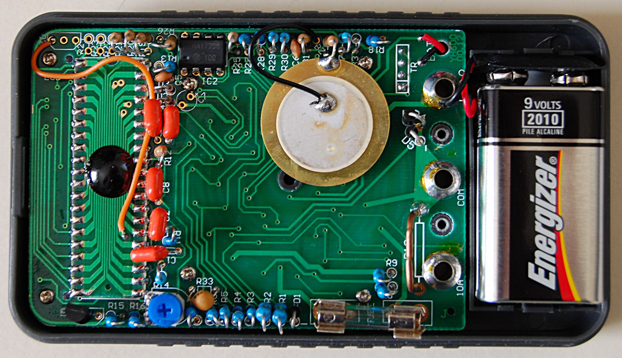

    I want to talk about cheap multimeters a bit. Instead of saying all sorts of mumbo jumbo i'll just go straight to the conclusion, period.

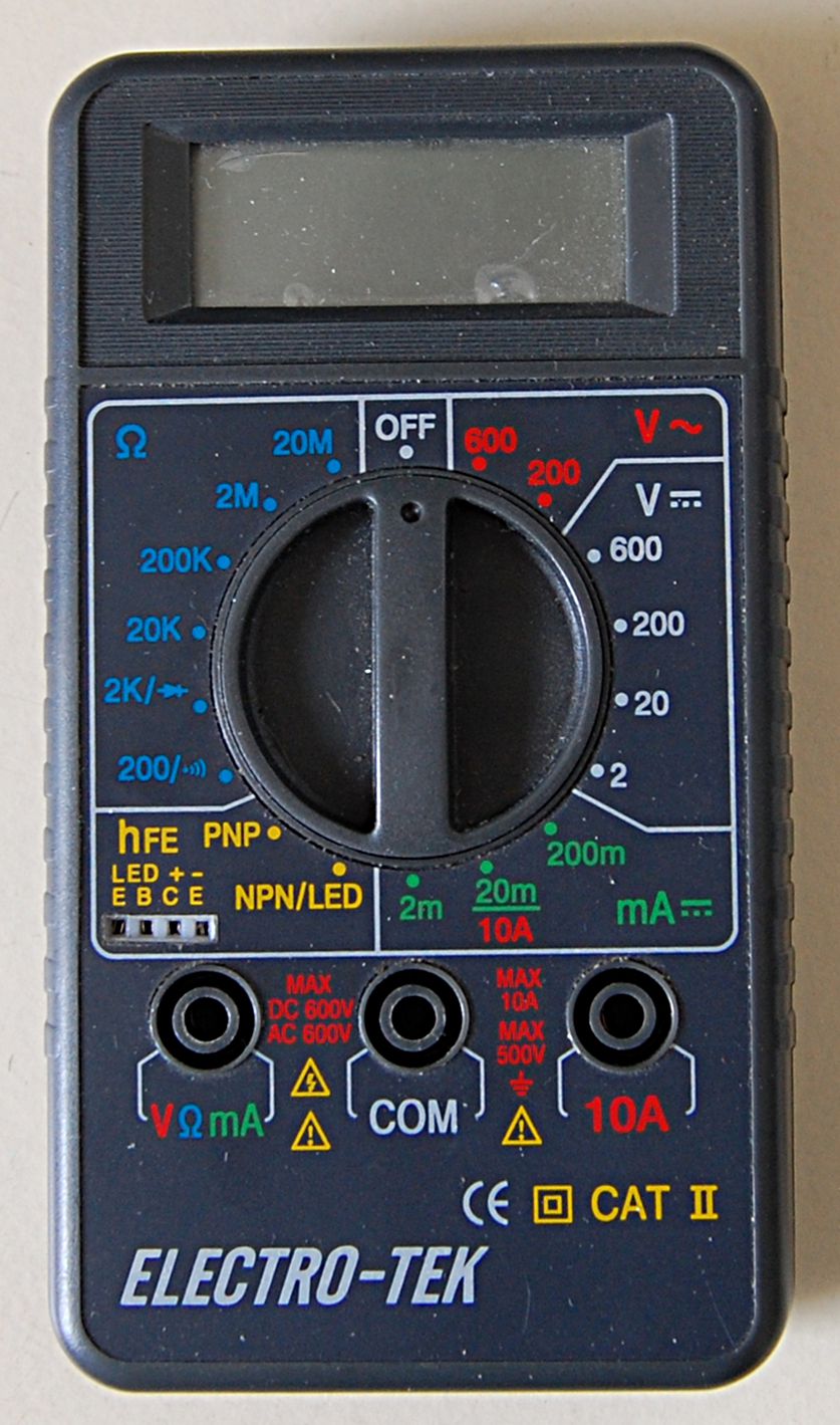

    The DT830B is THE best meter if you only use it for basic measurements. There is one thing that must be said though: The probes that come with 830Bs (especially the noname ones) are a MAJOR SAFETY RISK. If you buy proper probes it is a good meter and meets its specs.
    For those of you who need a little more, the DT9208 might look attractive. After all, it's got frequency and capacitance measurement, something which a 830B can only dream of. It's also got an AC amp meter, a temperature probe and a buzzer. And it only costs like $15, maybe even less. That's just two 830Bs.
    Don't be fooled. The DT9208 is a PIECE OF JUNK. If you need something that really is better than a 830B be prepared to spend $80-$100 to get a meter that really does what it says on the box. Like the Uni-T UT60E, which apart from the slow autorange (but it does have manual ranging too), and the backlight that only works when the battery is full, is a very good and properly calibrated all-rounder.
    Okay, you probably ask why i bash the 9208. Well, for one, the 9208A has several ultra cheap trimmers that bounce around when the meter is dropped. It might have respected the tolerances printed in the manual when it left the factory... but there's no guarantee it still does when you buy it. It's sometimes 10% off even in the voltage ranges, which is totally unacceptable. A 830B does lots better. Secondly, the frequency meter which is one of the main features, on the exact same frequency, it reads differently depending on waveform and voltage... It's true, the freq meter section is spec'd for 3% accuracy which isn't stellar, but it isn't uncommon for it to be not 3% but 20% off. On 50Hz mains it reads 54Hz. Folks, that is 8% error right there, on a freakin' sinewave! Also its milliamp section stopped working on mine (no it's not the fuse), it reads overload on all ranges even when just 1mA is applied.
    The only things that work properly are the buzzer, 20A meter, resistor and capacitance meter. But the cap meter also suffers from the cheap trimmers and it only goes to 20uF. Only useful if you do a lot of radio work.

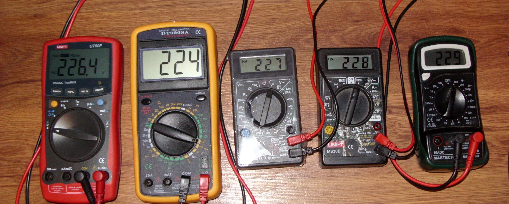

    In conclusion, take a look at this pic. From left to right, UT60E (reference), DT9208A (and that's a CALIBRATED one, it used to be off by quite a bit more), 838 (a 830 with buzzer and temperature), and two 830Bs, all measuring the same power strip. The 830Bs all read a tad higher on 50Hz mains because they are not true RMS and they are designed to work with both 50 and 60Hz mains, so they are calibrated at 55Hz. But they are very close together (actually the last digit fluctuated on all three 83x meters, it's just coincidence that the pic caught them that way), while the 9208A is, well... out. In conclusion, need better than 830B, spend some dough on a proper meter.
    The problem with the 830B "brand" is the all the variations on ebay. Some have no fuses whatsoever for measuring amps. The one that I ordered from ebay came with no fuse and is so shockingly bad in solder and build quality, I'm glad it arrived DOA.
    The 830B probes too are finicky. Brand new, they measure 0.8 to 0.9 ohms and fluctuate when hooked up to a Fluke 75. With quality probes, I get 0.2 ohms steady on the Fluke 75.
            ALL low end multimeters come with no fuses on the amps range. But seriously, why would you need one? An amp meter is a series device so it doesn't require a fuse unless you do something dumb with it like hooking it directly to a car battery or to the mains. The device you are measuring current on should have its own fuse, so why would you need one in the meter? It's just a pain in the ass IMO, actually i jumpered the 10A fuse on my UT60E.
            Even if 830Bs did have 10A fuses the leads they come with melt at 5A.
            PS. If you have time, I would love to see photos of the insides of all these meters.
            Dave Jones over at the EEVBlog already took apart the UT60E. For the rest, will do. I dug a bit inside my 9208 and found it has a bad reference - that explains why it's wonky on all ranges. But more on that later.

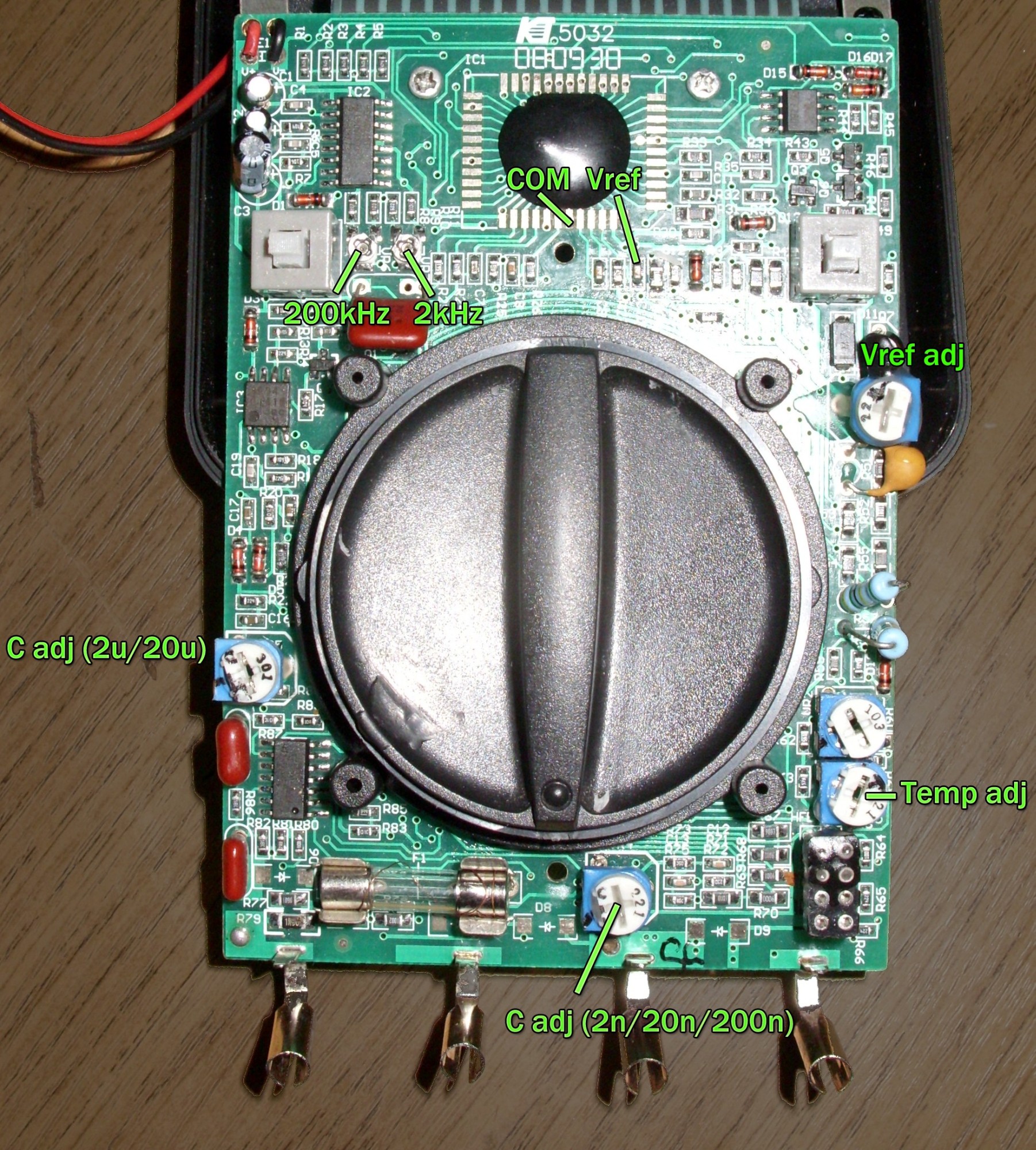

                        A meter very similar to these was just given to me. The story was that it was being used near a bug zapper, went zzzt and didn't work any more. The internal fuse reads 0.3 ohm. Everything looks fine, although that round yellow blob at R33 (marked "75S") by the blue pot makes me wonder. Display comes on and works, it even gives measurements.
                        But an AA battery that reads 1.625 volts on my Fluke shows 0.66 volts on this fine unit, and two of them show 1.33 volts. Probably not worth fixing, but it would be nice anyway.

                          Looks like the reference is wonky. Standard procedure applies: You have a trimpot. Turn it.
                          Here's the guts of the 9208A with information on the trimpots. I tweaked the main reference (which naturally messed up everything else), and even after aligning everything the frequency meter still sucks, the higher ranges of the capacitance meter got so bad that i had to pencil one of the resistors near the trimpot to get the trimpot back to useful range, and since the main Vref controls both AC and DC voltage readings (along with pretty much everything else but at least there are separate trimpots for the other ranges), i had to choose between getting proper readings on either AC or DC. Not both at the same time. I chose DC.
                          Well, to sum it up... The ohm meter works, the diode/buzzer works, the amp meter works, the cap meter sorta works, the temperature probe works. The frequency meter doesn't, the volt meter doesn't. In conclusion: A plain 830B does better. Get the 838 and you also get the buzzer and temperature. There you go. And yes the pic was photoshopped for clarity.
