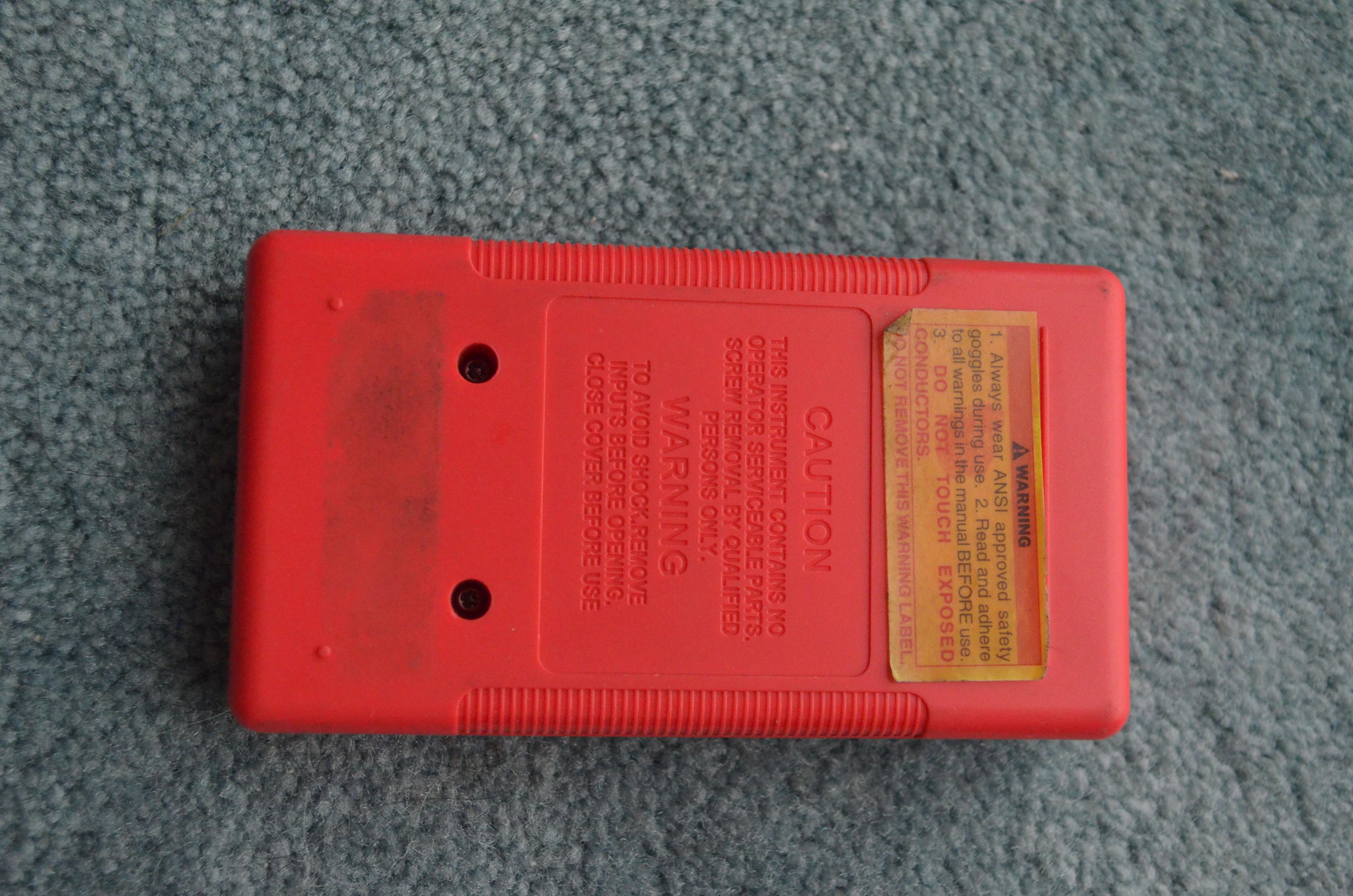

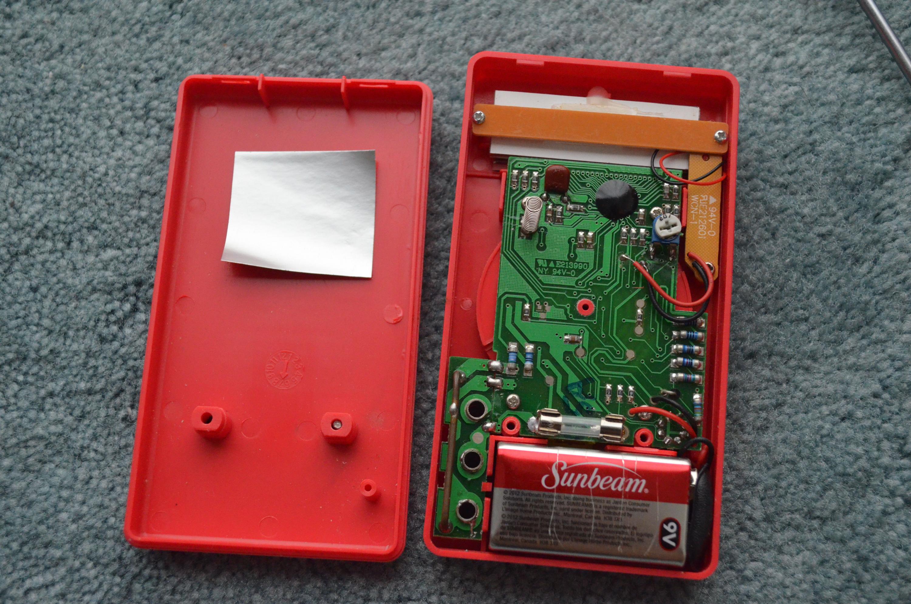

                                      I have a small pile of the FWP (Free With Purchase (coupon)) Hazard Fraught Tools meters. They are indeed made cheap.
                                      I have one meter that uses the A23, but it's not an 830 clone... and yes I hate the A23 - doesn't last long and hard to get cheaply...
                                      Attached is one variant of the HFT meter - that has a backlight...
                                      And speaking of pointless repairs, I did try to "repair" this meter multiple times - fixing broken probes, fixing the common connector and melting the case, and ... replacing the battery ... when all of these could have been "fixed" buy getting another free unit (This is my garage/automotive repair meter that I toss around...)

                                        funny label on the battery. "(c) 2012 Sunbeam Products Inc"
                                        i'd swear PP3 battery's have been around much longer than 2012!!
                                        are they really claiming copywrite over it??

                                          I think they're copyrighting the label design - not the battery. The label, which just like any artwork, can be copyrighted...
