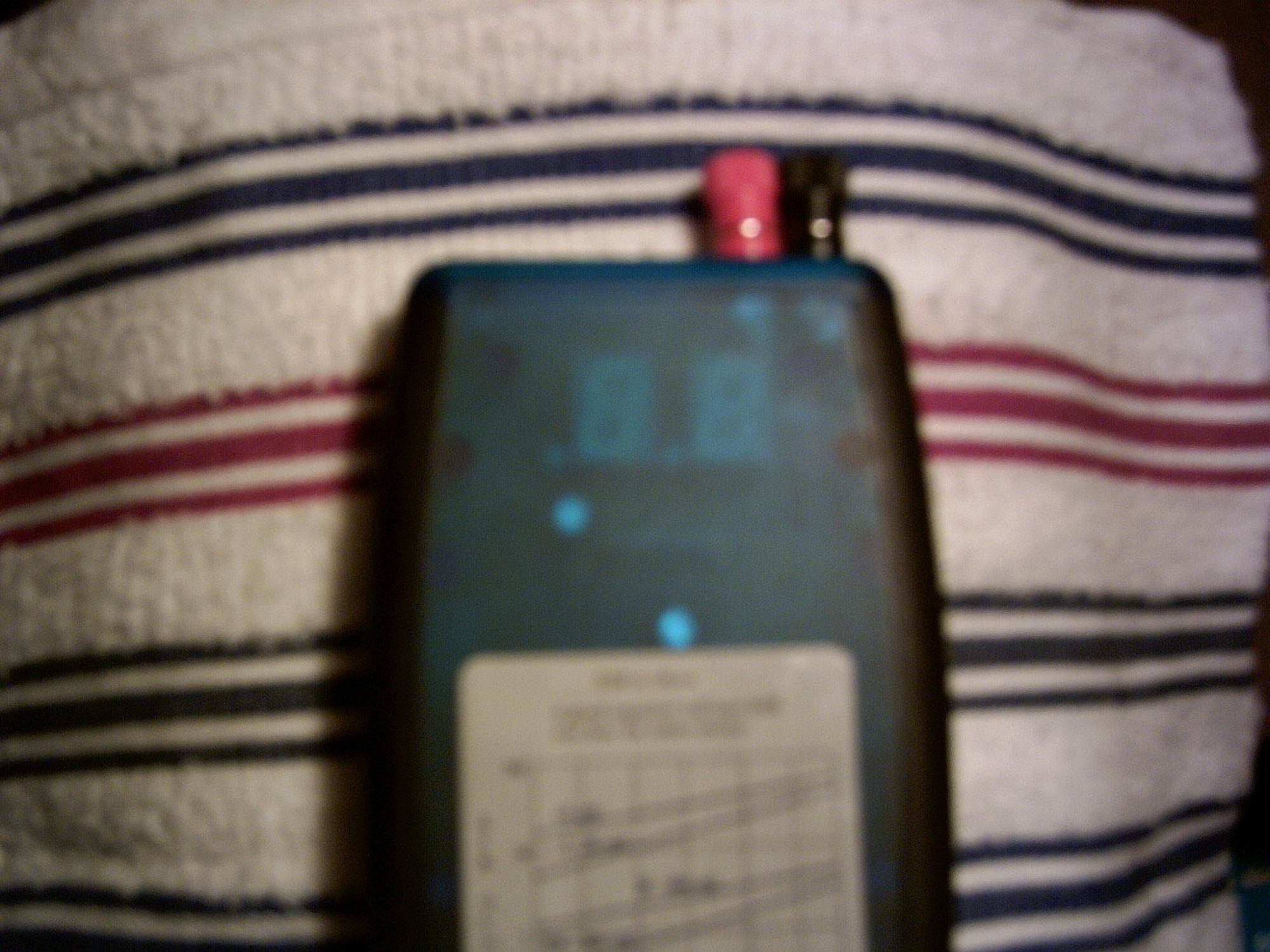

          I made the Blue esr a couple months ago. I left out the resistor for auto-turn off also. I did add some jacks as I like to use different leads , hooks, probes, clamps.
