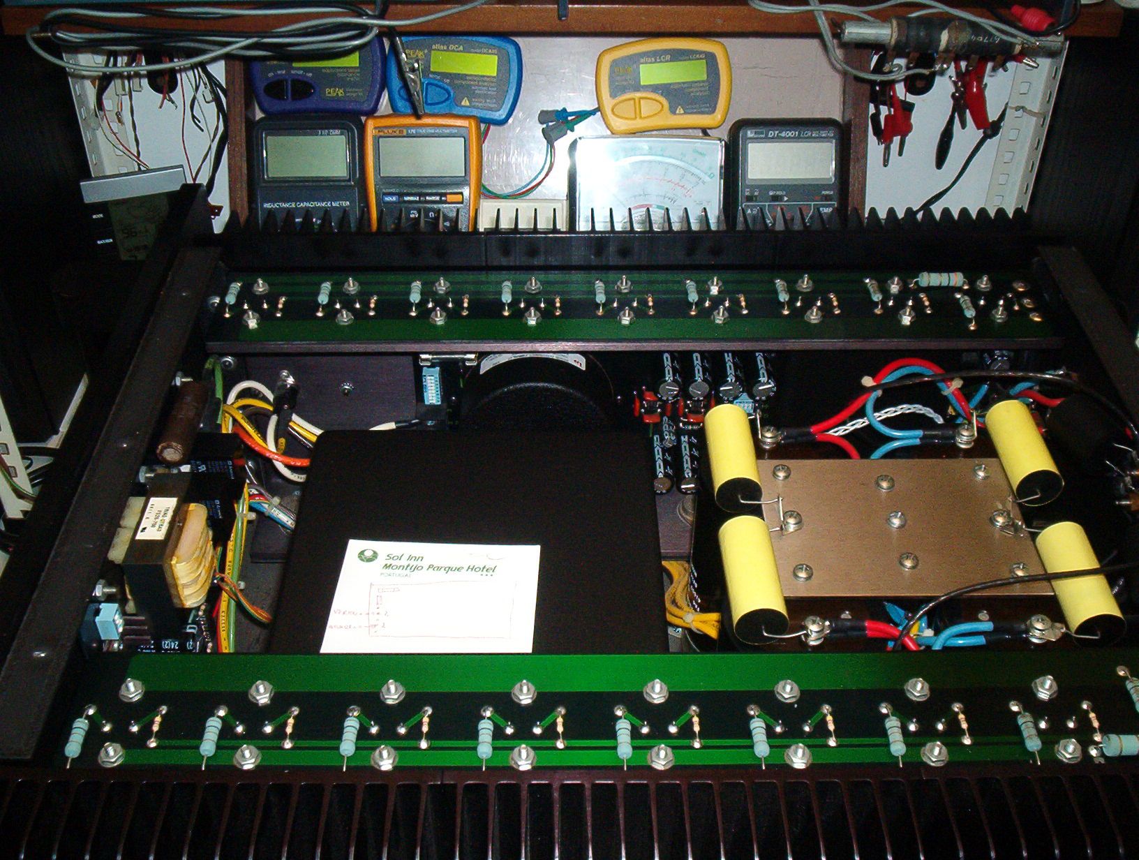

          Originally posted by pr0cess0r View Post
          i have those 3 tester i dont know how to use them yet!! i wanted an esr meter and my boss got this big kit and i willlearn to use it!
          http://www.peakelec.co.uk/acatalog/jz_dca55.html
          http://www.peakelec.co.uk/acatalog/jz_lcr40.html
          http://www.peakelec.co.uk/acatalog/jz_esr70.html
          I have the 3 tester too, and I love them. Precise and easy to use... Life will not be the same without...
