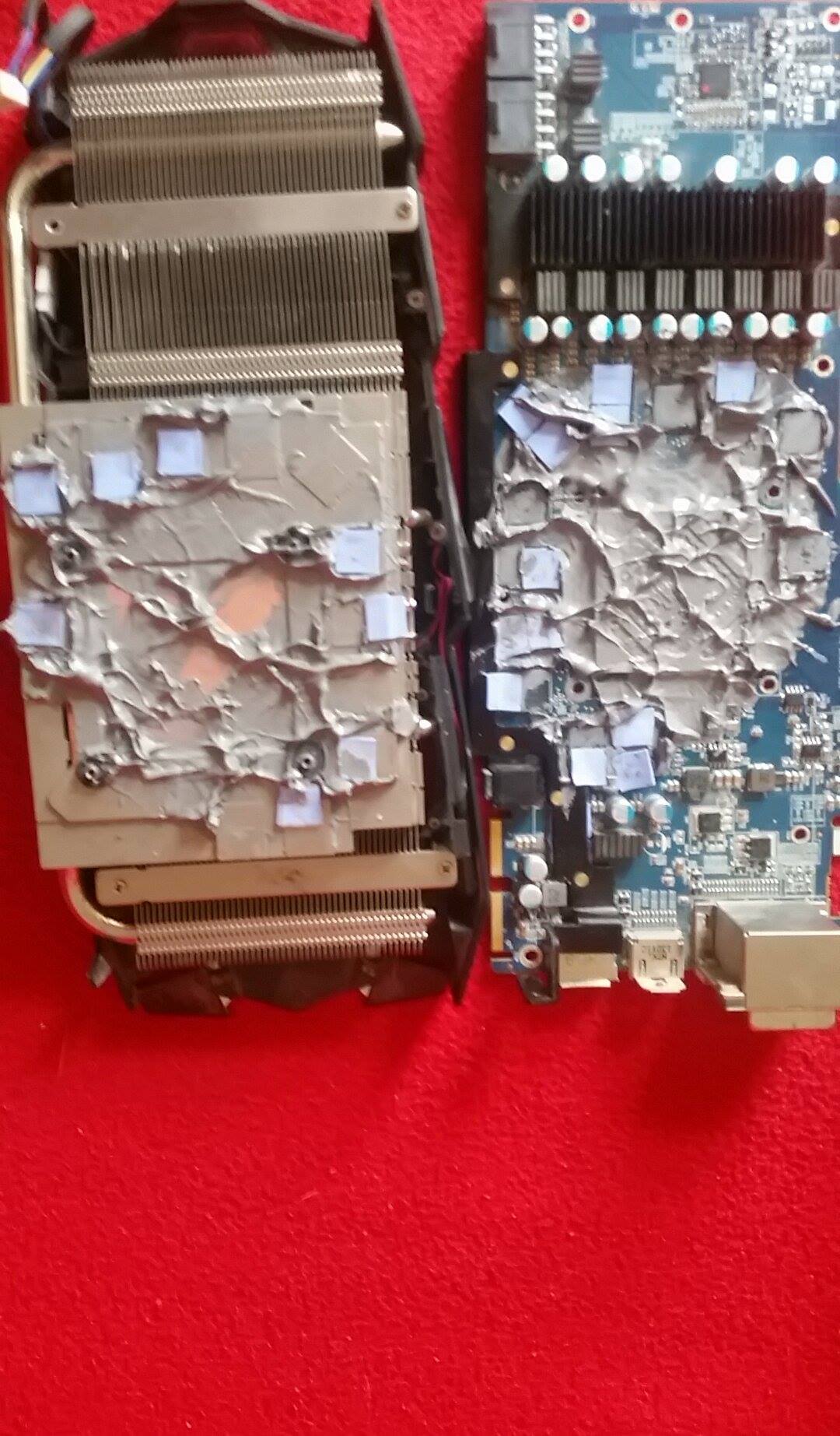

    Well had 2 cards come in today for repair... First was a GTX 780 that was shorted to ground... Blatantly obvious where it had gone as had 3 vaporized ceramic caps and a very burnt and cracked inductor. Swapped them all an all working
    Next was a HD 7970 that failed to display.. So off I go strip the card down ready to pull the GPU and reball and I find this :
    Took me some time to clean that off I can tell you!
    So anyone who needs to apply thermal compound and has never done it before... The above is NOT how you do it!

                  Re: Need to change thermal compound? How not to do it!
                  Yes that must of been an entire LARGE tube of TIM!
                  GPU has been reballed and reworked onto the card = All working

                        man wtf is this? thermal paste shaving cream? no surprises why the gpu failed there from too much thermal paste!!!

                          Non conductive, it was a BGA connection fault - Reball sorted it out.
                          I think it was more of a case of the owner thought it would fix it by changing the thermal compound (Seems a lot of people auto think that changing it will somehow bring the card back to life :S ) and had no idea what they were doing! I have moaned before when finding a mess under the heatsink but this took the biscuit! I ended up just dropping the entire card into a bowl of IPA and getting the toothbrush on it.. bloody messy job!

                            you say non-conductive, but it has a capacitance.
                            you cant use it on high voltage parts!

                              no, im talking about the way how applying too much thermal paste acts as a thermal insulator instead. the ideal proper way to apply thermal paste is as thin a layer as possible. too thick of a layer just acts as an insulator instead of a conductor. that is the proper way!
