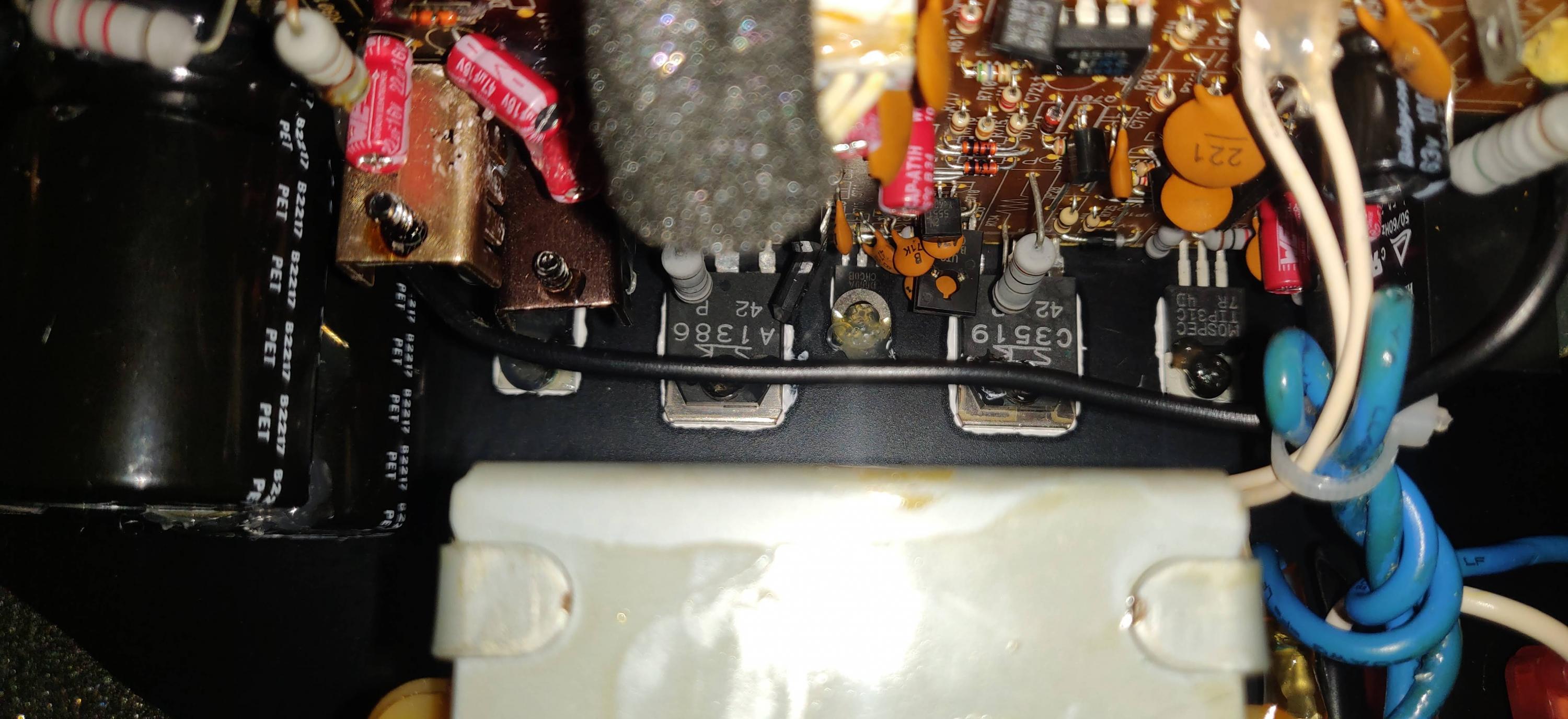

    I have a Velodyne DPS-12 subwoofer that was making weird noises. Upon taking it apart, I noticed there was yellow glue all over the circuit board which had turned brown, so I scraped it all off and that fixed the problem. I used hot glue instead around the various components.
    There was also one bulging capacitor, and another that must've been in a really hot location because the labelling looked like it was scorched. You can see in the picture the circuit board has discolored over time from this heat. Could either be from the MOSFET (with heatsink), or the resistor. I decided to just go ahead and re-cap the entire board since it was only $20 in capacitors.
    I have two general questions:
    1. Looking at the discoloration of the circuit board (picture 1), should I be concerned with heat? Like I said, everything does work fine. This picture is before I re-capped it. When I re-capped, I did somewhat try to angle & position the capacitors away from the heat sources as best as I reasonably could.

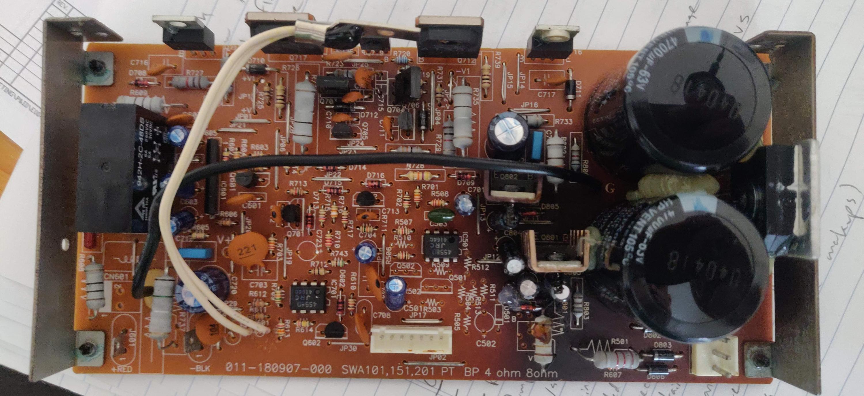

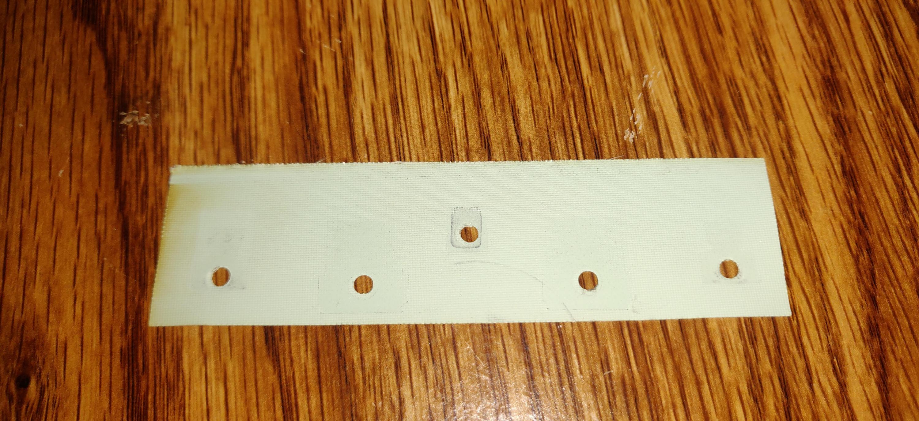

    2. On the main amp backplate, there are several transistors screwed onto it, along with a thermal pad. When I assembled this, I removed the old thermal pad and used heatsink grease instead as I figure this would help with cooling. However, now that I think about it, the thermal pad would be an electrical isolator. Do you guys think I should re-use this thermal pad, or is it ok for the transistors to be attached directly to the amplifier plate like so? The plate appears to be anodized aluminum so it's not conductive on the surface, but of course I don't want to be taking any chances if this is not good practice.
    Picture 2 is of how I re-installed these and picture 3 is the thermal pad that came off.
    Love to hear your thoughts. Thanks!

    So, if the original screws are metal connecting the transistors to the heatsink you will not have to worry about isolating the transistor with a thermal pad. In my day they use to like to use thermal pads because the heatsink grease would dry out. I do not believe that is a major issue today. Perhaps younger techs could elaborate on this more. The yellow glue may not be a glue at all but an old conformal coating when exposed to heat turned yellow over time. Again, a younger technician should be up of all the modern-day coats that help isolate the board from the elements.

      On the screws, two of them had a plastic isolator and the others were just a screw. That's why I'm having my doubts and think I should just use the thermal pad instead of grease.
      As for the glue, it's a well known problem with electronics, similar to bad capacitors. It should be yellow but with time and heat turns dark and conductive. On older equipment (20+ years), I make it a habit to take things apart to check for both bad caps and the yellow glue plague. If you catch it early you can prevent premature failures.

        Plastic isolator. Exactly what type. Was the plastic isolator a piece of plastic on the back of the transistor heat sink? Was the plastic isolator an insert into the mounding hole of the transistor. Is the screw and the nut plastic? Not that it matters much. If it is electrical isolated, I am just curious of how.
        Have you measured the resistance of the heat sink pad to find out what the electrical conductance of the heat sink pad is and what characteristic you will have to match? Also, one needs to measure the capacitance of the heat sink pad to determine how isolated it is in capacitance. I am sure there are thermal grease that is also non- conductive with capacitive listed on the data sheets.

          If the designers put in an insulation pad then you should put it back IMO.

              We can see it in the photo, why would it wear ? it doesn't need substituting, just fitting back.

                    In the second picture, it looks like there is a plastic insert in the screw hole for the TIP31 on the right. The two larger parts are in a package that usually has plastic molded inside the screw hole, so they don't need the extra plastic insulator.
                    I would say that the pads and plastic insulators under the screws are there for a reason. You can replace them with new insulating thermal pads if you want (there are also pads that are electrically conductive, which you don't want for this).

                        Thanks for the info. Just to be safe, I decided to not take any chances and apply the insulator along with some heat sink grease to improve cooling. I've re-capped this unit with better than OE quality caps to keep it going for a long time. It's a really excellent sub!

                          The only case where it's clearly a superfluous insertion of a insulator is if the package is something like a TO-220F or TO-3PF where the body is completely plastic. Heatsink compound is still recommended but the insulator sheet is not needed or recommended. It's *possible* to not need it, but almost always, if there's more than one metal tab and two dissimilar devices, the insulator is needed.
                          Heatsink compound/grease is there for a different purpose than the insulator sheet. The grease is for thermal conductivity. The sheet is solely there for electrical isolation. You may have gotten lucky that your device didn't short out - anodized aluminum surface is not conductive and the plastic shoulder washer helps against the screw shorting, and most transistors are collector/drain to metal case, and this is does not help any of the transistors as for class AB drivers, none of the transistor cases are at ground level.

                              There's no heat marks and no friction to wear it down. The device failed due to conductive glue.

                                      I think the OP's decision to remove the thermal pad is because they "learned" from CPU "delidding" and other ridiculous ideas as to reduce thermal impedance. This is not acceptable for amplifier design because CPU heatsinks tend to be isolated from any electrical potentials (for desktops at least; laptops usually do have some constraints) and even if the CPU shorts to the heatsink, it may not matter as the heatsink is completely shrouded by the computer case.
                                      Amplifiers do typically require electrical isolation between heatsinks and semiconductor devices due to sharing, if not also for electrical potential requirements since the heatsink may be exposed to the outside of the chassis or even *is* the chassis, as running the case at high voltage potential with respect to ground typically is not a good idea for UL approval.
