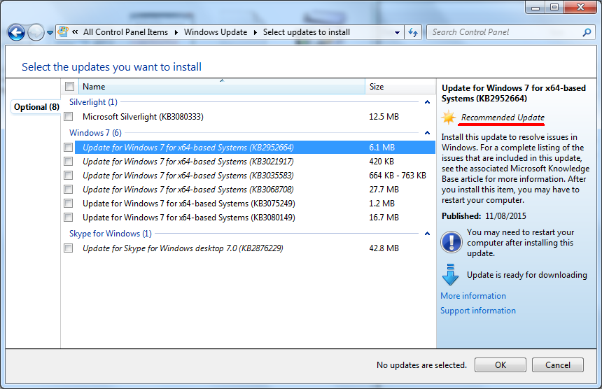

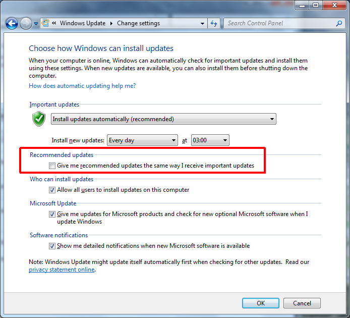

      Well that was not my intention of the thread, my intention was so you'd know which updates to skip if you don't want the free Win10 upgrade offer.
      Simply not ticking the checkbox "Give me recommended updates the same way I receive important updates" in Windows Update (it's off by default).
      Will mean that all these updates show up under the "optional updates" category:
      And thus they wont be installed without user intervention, simple as that

                                      I've added KB3083710 to the OP, I see no reason not to install it; please adjust your tinfoil hats
                                      Microsoft updated KB2952664 to revision 14 a few days ago.
                                      When they did the update was actually listed twice by Windows update but that appears to have been fixed this afternoon.
                                      They also revised update KB3035583 so it's now at revision 2.
                                      As I've mentioned before when Microsoft releases a new revision to an update which you had formerly hidden it will show up for download again.
                                      So that applies to those updates, but as long as you don't have "Give me recommended updates the same way I receive important updates" enabled that is not a problem.
                                      Because then recommended optional updates will not be installed anyway.
