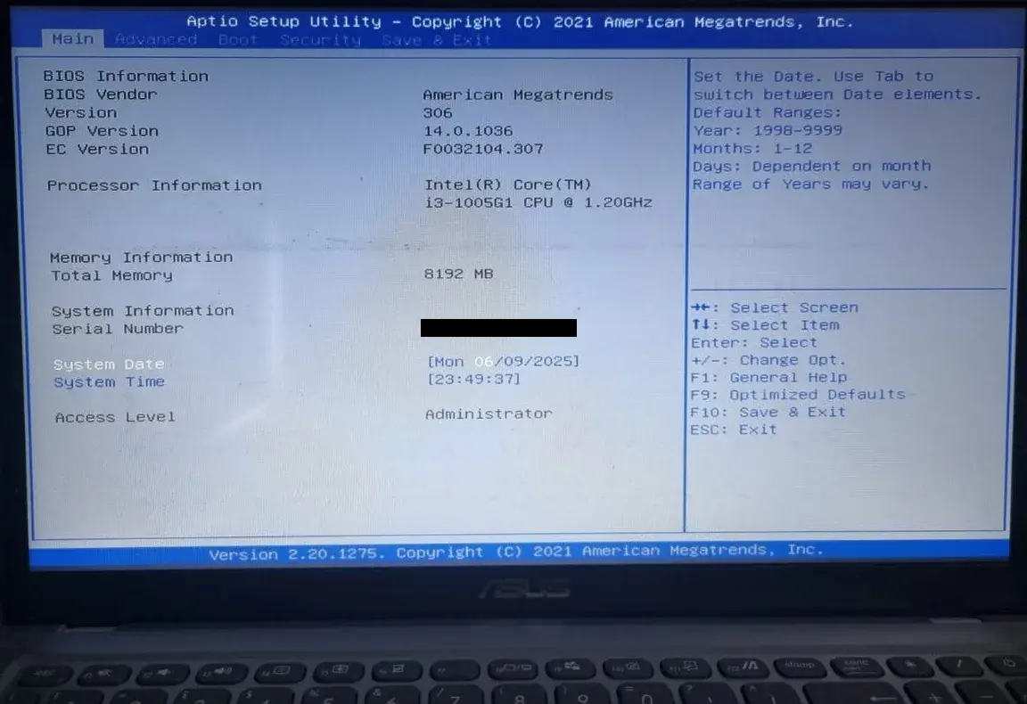

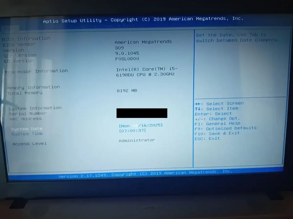

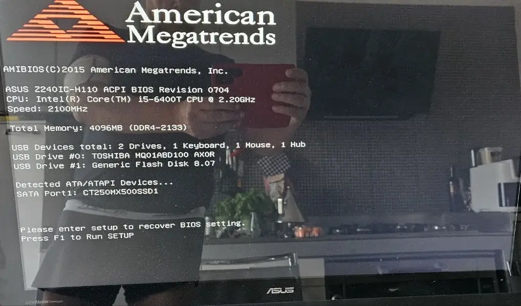

    I had 3 people contact me in a week because Windows suddenly didn't boot:
    Click image for larger version  Name:	1.webp Views:	0 Size:	47.2 KB ID:	3661480 Click image for larger version  Name:	2.webp Views:	0 Size:	61.8 KB ID:	3661481 Click image for larger version  Name:	3.webp Views:	0 Size:	34.1 KB ID:	3661482
    As you can see, all 3 are ASUS computers, but I believe the common factor is the BIOS being American Megatrends (AMIBIOS/APTIO).
    The first two recovered just fine after a restart, but the third one didn't and was brought to me. The model is F541UV (X541UV).
    Setup allows to add a boot option manually and the operating system boots just fine from both bootx64.efi and bootmgr.efi. However, there is no way whatsoever to save the option(s): upon a reboot the machine goes straight to the setup and the boot list is empty.
    Further investigation reveals that the BootOrder environment variable is missing, the issue is pointed out by both efibootmgr on Linux and EasyUEFI on Windows. The latter also mentions the BIOS should recover itself, but it didn't even after a CMOS reset.
    The solution consists in rewriting the BIOS, which I'm attaching here along with the faulty one, but I believe this is a critical problem that shouldn't happen in the first place.
