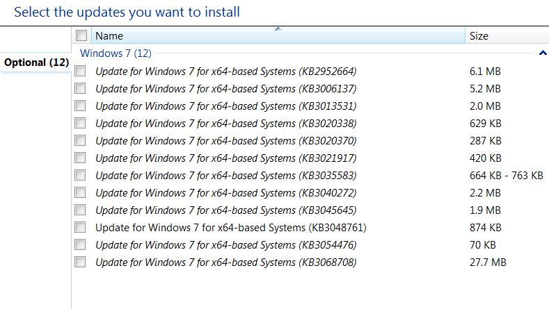

    Win7 updates for upgrading to Win10
    The following is a list I have compiled of updates pushed for the seamless upgrade from Windows 7 SP1 to Windows 10.
    The list has two uses, either you want the free upgrade to Windows 10 and then it confirms what updates you need to have installed.
    Or maybe you prefer Windows 7 SP1 or you have a company computer where you want to restrict the upgrade to Windows 10.
    In the latter cases you should untick the checkbox "Give me recommended updates the same way I receive important updates" in Windows Update.
    Follow this link for a post with more details with pictures of that setting.
    Code:

    [URL=https://support.microsoft.com/en-us/kb/3161647]KB3161647[/URL] Windows Update Client for Windows 7 and Windows Server 2008 R2: June 2016 (Replaces: [URL=https://support.microsoft.com/en-us/kb/3138612]KB3138612[/URL] [URL=https://support.microsoft.com/en-us/kb/3135445]KB3135445[/URL] [URL="https://support.microsoft.com/en-us/kb/3112343"]KB3112343[/URL] [URL=https://support.microsoft.com/en-us/kb/3083710]KB3083710[/URL] [URL="https://support.microsoft.com/en-us/kb/3083324"]KB3083324[/URL] [URL="https://support.microsoft.com/en-us/kb/3075851"]KB3075851[/URL] [URL="https://support.microsoft.com/en-us/kb/3065987"]KB3065987[/URL] & [URL="https://support.microsoft.com/en-us/kb/3050265"]KB3050265[/URL])
    This last update adds the ability to force Windows to not give the option to update to Windows 10 in the local group policy editor.
    gpedit.msc path listed below in italics, further explained in: KB3080351.
    I recommend you install it because it also addresses an issue in which system performance can be decreased during scans.
    And errors you may encounter with Windows Update.
    Computer Configuration > Policies > Administrative Templates > Windows Components > Windows Update
    Double-click "Turn off the upgrade to the latest version of Windows through Windows Update", and enabled the setting.
    Please note that Microsoft is constantly revising these updates with the data that the telemetry provides them.
    For example KB2952664 is at version 13 as of this writing.
    For this reason when you uninstall KB2952664 it might appear that nothing happens because it just reappears again with the only change that the "install date" changes to the current date.
    Actually what it's really doing is downgrading from KB2952664-v13 to KB2952664-v12 if you previosuly had version 12 of the update intalled...

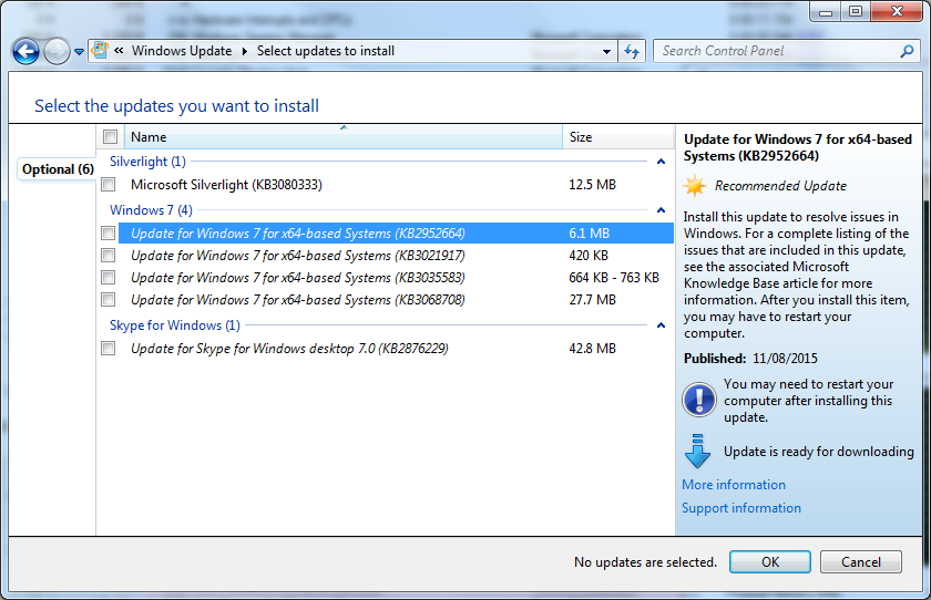

    Re: Win7 updates for upgrading to Win10
    This is good to know.
    My computer has all of these except KB3068708 (it still has KB3022345 instead) and KB3035583 installed.
    KB2952664 keeps appearing in Windows Update, even though it's already installed. Updating the updates could explain that. Also, it won't uninstall. Attempting to uninstall it just causes the date it was installed on to change.
          You might need to uninstall it up to 13 times, since removing for example the latest KB2952664-v13 update would mean going back to KB2952664-v10 if you had previously installed that update.
          Please try it and see if I'm correct, it's only a theory
          EDIT: I saw the same thing as you on my company laptop, I had to uninstall 5 editions of KB2952664 and then it finally does not show up as installed anymore

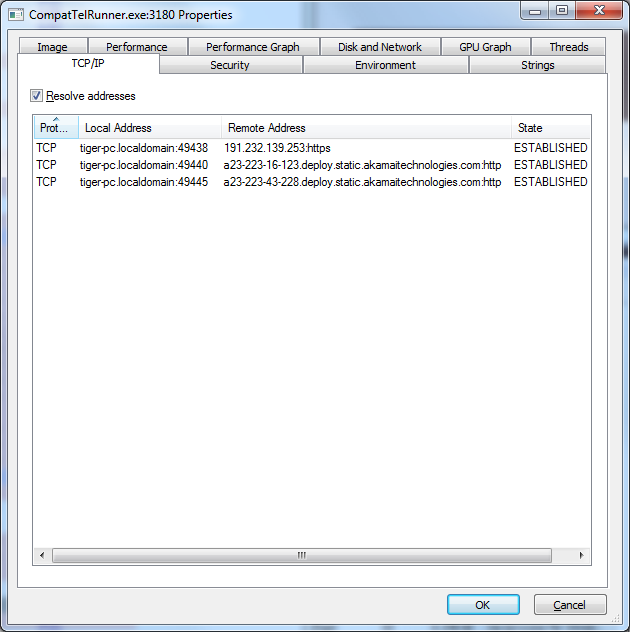

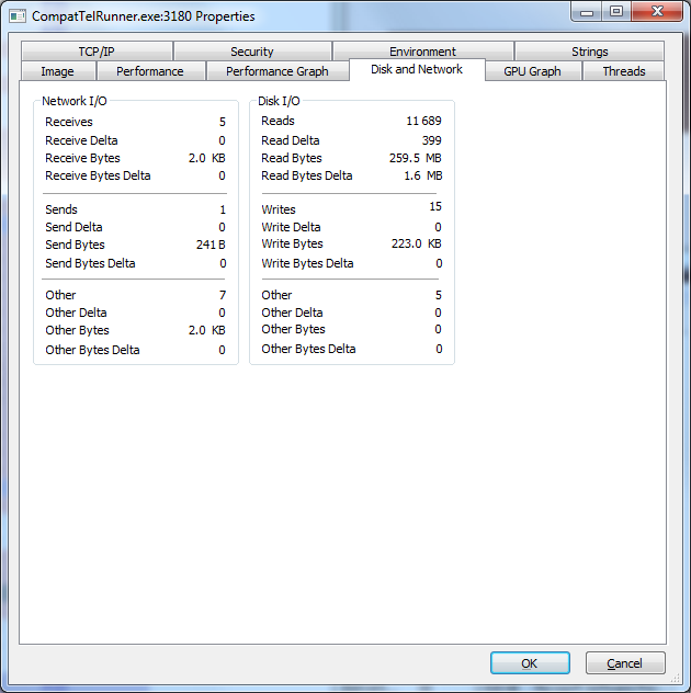

                      Saw the telemetry in action on my parents PC today, it's a Dimension 9200: Socket 775 with a Xeon X3230 CPU (2.66Ghz 8MB cache) 3GB memory and two 500GB 7200RPM HDD's in RAID-1
                      Firefox felt sluggish, it's running Win7 SP1 with all updates applied.
                      Fired up Process Explorer and saw that CompatTelRunner.exe (Microsoft Compatibility Telemetry) was causing allot of disk I/O.
                      So yea, unless you are intending to do the free upgrade probably best to just uninstall those updates listed in my OP...
                      The file is included in the update KB2952664 which gets constantly revised. (Currently at revision 13 as said previously).
                      Also I found out that this particular update has a version that is compatible with Win7 RTM: KB2977759
                      All the updates I've listed in my OP require SP1, and Microsoft has said the same when it comes to upgrading from Win7 to Win10 (requires SP1)
                      I found a list of what it checks on my work laptop on which I have deleted all those Windows updates in a leftover Temp folder.
                      Basically it's information about the hardware and all installed software, so the system can advice what things you need to upgrade etc for compatibility with Win10.
                      Last edited by Per Hansson; 08-31-2015, 09:05 AM. Reason: Added links to pictures.
