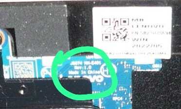

        Hi, the board number is here, it's not quite clear from the picture
        Should be something like NM-****
        From your part number (5B21H70694) /laptop model (15IAL7) i found this, please confirm
        JS574 NM-E401
        Please update your post on the schematics request forum with the proper info, someone may have it

          m1ch43lcm, yes I see that number stamped on the board, Js574 NM-E401 the number you found, Rev. 1.0 Thanks for the info!

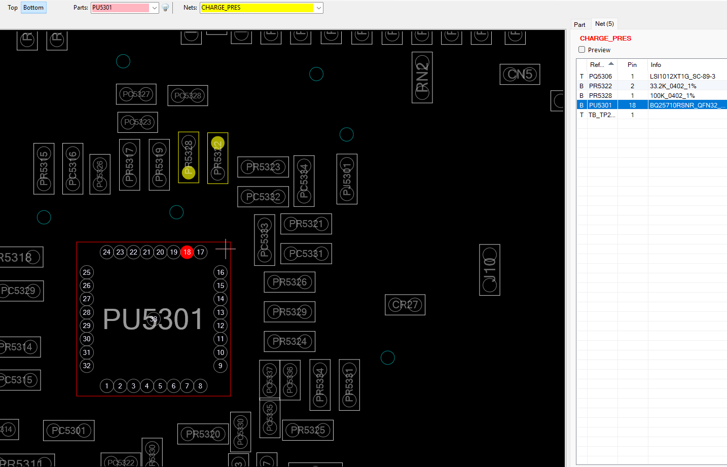

                PU5301 is your charger IC = BQ25710.
                Carefully measure the voltage to ground on pin # 18 = CHARGE_PRES with the power adapter connected. This is the sense pin to gauge if the power adapter is connected or not.
                Test with only the power adapter. Then test with both, the power adapter and battery connected. Post all measurements.

                    Review the 2 voltage divider resistors that mate with pin #18.
                    PR5322 = should be ~33k ohms. Pin #1 should be mated to the raw adapter voltage so ~19v.
                    PR5328 = should be ~100k ohms. Pin # 2 should be to ground.
                    Together, they will lower the adapter voltage to a safe value to allow the charger IC to monitor the adapter presence. Ideally 2v7 or higher is the normal value here. With 0v, maybe one of the resistors is missing or is defective.

                              The PCB trace that connects to pin #18 on the charger ic is mated to the 2 resistors. This midpoint connection must offer a low voltage here. Google ‘resistor based voltage divider calculator Digikey’. You will find a drawing and a calculator. Stuff 19v and the resistor values in ohms. The calculator will provide the expected voltage for pin #18.

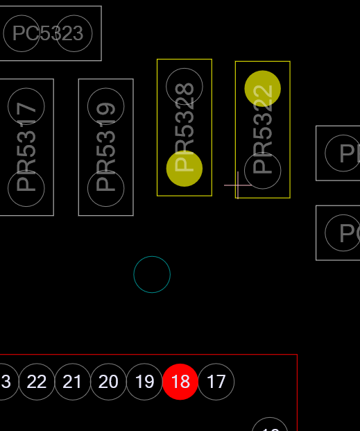

Name:	Lenovo board.png
ID:	3632536 Mom2, by " midpoint : connection, do you mean that solder point that is circled in the picture? I have continuity between pin18 and pr5328 but no continuity between pin 18 and pr5322. It seems I'm not getting any voltage anywhere. I'm only getting 5 volts on the usb-c tester with the power adapter plugged in. Whent to the digikey site for the voltage divider, didn't understand it.

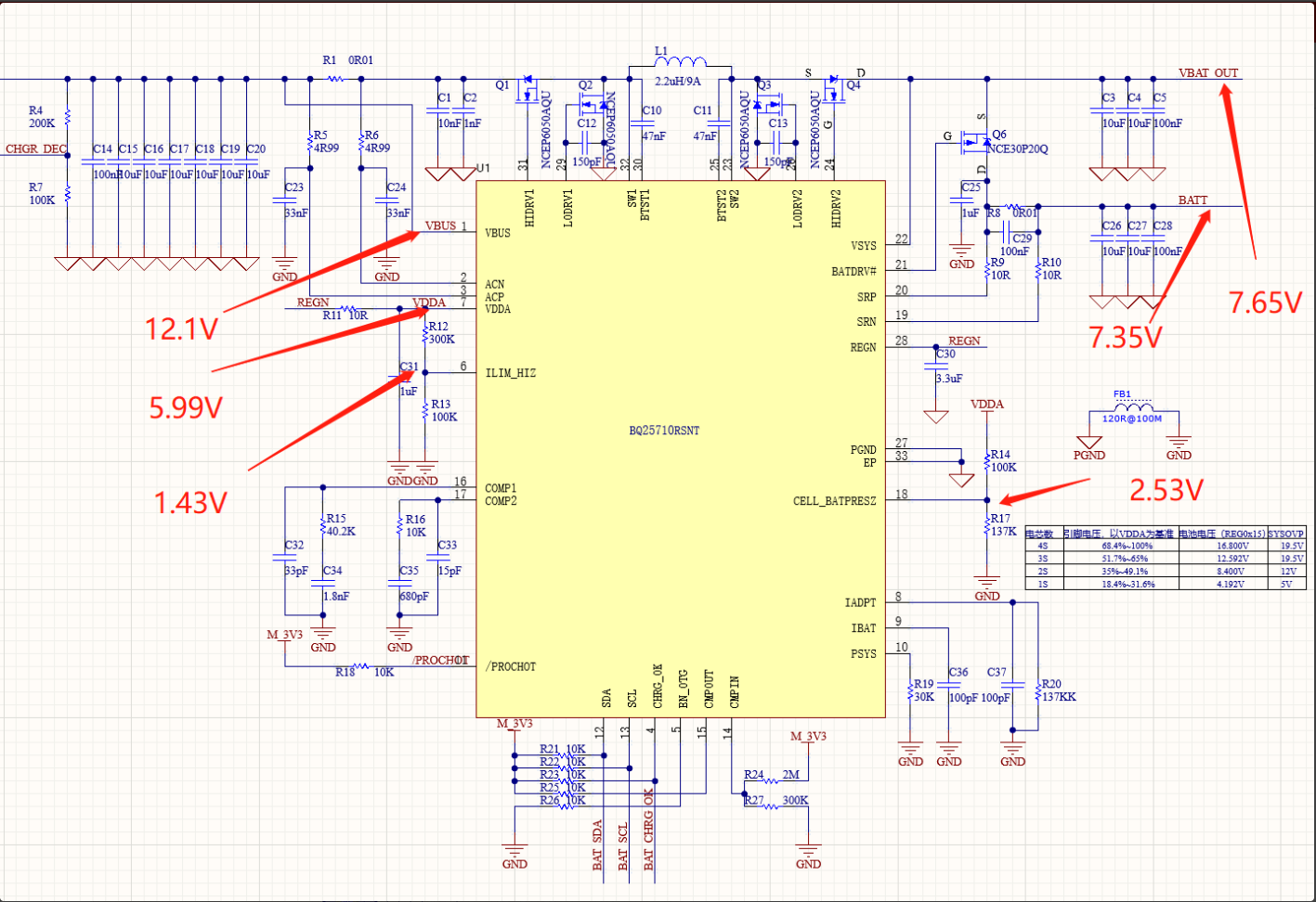

                                  Can you read the topside markings of this PU5301 chip? Should have requested this earlier. Want to be 100% sure the charger IC is the same as the BV file reports.
                                  See attached - my yellow lines. You must have conductivity from pin #18 to the yellow line end points - should be ~0R ohms otherwise there is a trace break somewhere on the board.
                                  Confirm it.
                                  On this note, the label of this pin has me following the wrong path. This pin #18 defines the battery pack charge voltage so for now, probably can be ignored. It is not the CHARGER_PRES - it is CHARGE_PRES.
                                  See attached for a reference schematic for this charger IC. Your logic board will be very similar.
                                  Confirm the voltage to ground for the following pins (with the power adapter) - be sure your meter probes are small enough for this task:
                                  VBUS pin #1
                                  ACN pin #2
                                  ACP pin #3
                                  VDDA pin #7
                                  REGN pin #28
                                  Click image for larger version  Name:	ref_design.png Views:	0 Size:	373.7 KB ID:	3632640
