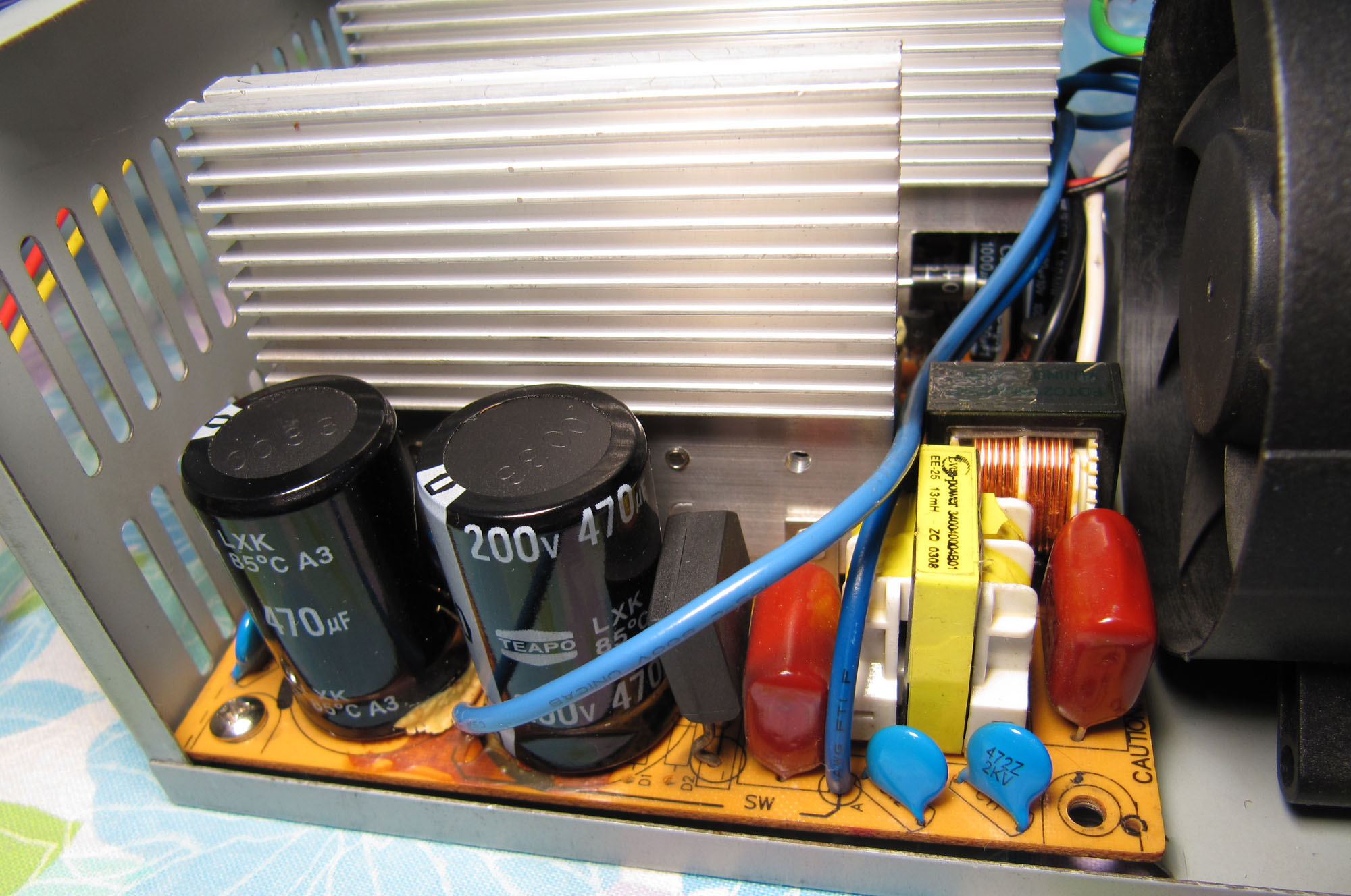

                                        I was playing with a cheap psu once and I removed its HEC primary caps that had real capacity 423uF to replace them with Teapo LXK 200V 470uF with a real capacity of 490uF.
                                        I plugged the psu to AC, turned it on and everything was ok at first but then started a boiling sound! 1 of the primary caps I had connected backwards!! I was lucky to stop it before the cap exploded. When I touched it after AC disconnection it was hot enough to burn my finger.
                                        Oddly, the cap survived! It didn't vent and its ratings (esr, uF) didn't change. The cap got lucky!
                                        It's the cap on the left.
