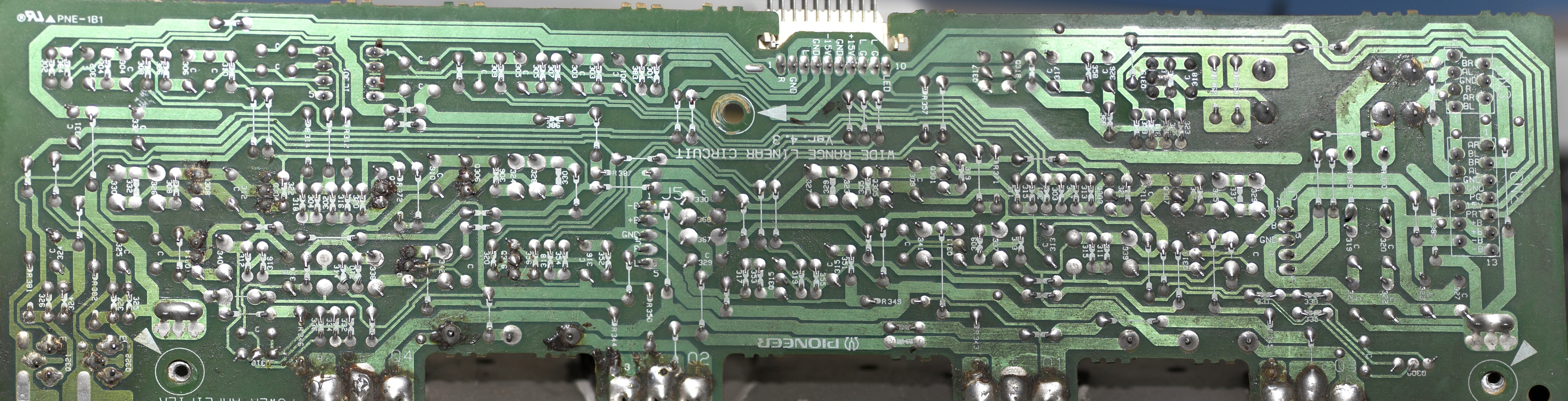

                  Here is another high quality large pic for the whole pcb, hope that helps
                  • CapLeaker
                    Leaking Member
                    • Dec 2014
                    • 8340
                    I see many cracked (rings) solder joints that need to be fixed.

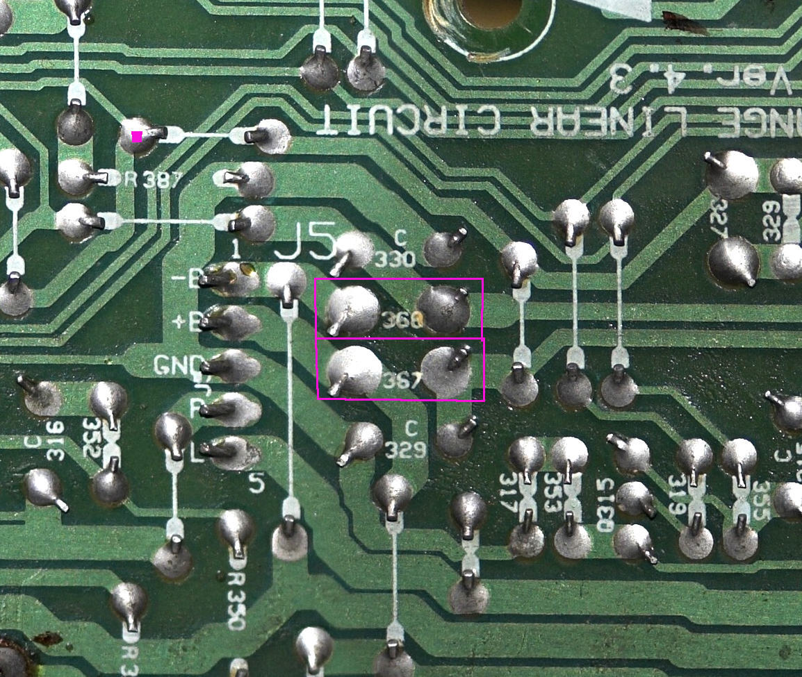

Name:	Pioneer A-205 PCB 1_R368.jpg
                      Look at these resistors on the other side. I think R368 is 4.7Ω 1/4W fusible and is open, so the -15V rail would be gone.
                        R368 = read 8.8 ohms
                        R367 when positive lead is on left, negative on right = short, when flipped the leads = open
                        shall i pull it out and test out?
                        many thanks for ur help
                            btw the +15v is the missing, -15v is there as mentioned before
                              yeah man i got the 367 out and it is giving me mega ohms!
                              shall i just replace it and test or there might be other issues?
                              thank u so much, u r really good

                                Lift a leg on both of the resistors and take an ohms reading. A 4.7ohm resistor reading 8.8 ohms is out of spec! A 4.7ohm resistor reading mega ohms is basically open. So both need replacing if that's the case.
                                A component is best tested out if circuit.
                                  agreed , i will also measure the one giving me 8.8 ohms and let u know
                                  how did u guys know the original value without seeing the color code which i did see and it is gold gold , violet and yellow (4.7 ohms)
                                  i could not find it even on the service manual
                                  another question, what if i did not find that fusible resistors, what can i use as a replacement?
                                  thanks
                                  • GraphicMan
                                    • Aug 2018
                                    • 124
                                    • Egypt
                                    i got it out and it is 8.6 ohms using 2 DMM, it has the same color code as its sister , should be 4.7 ohms,

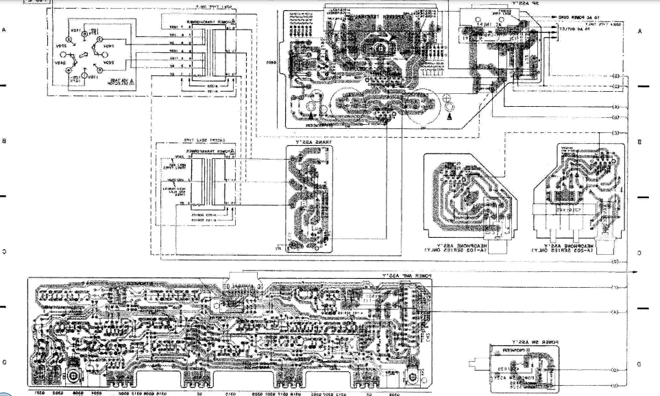

                                          attached page 19 from the service manual i have, it is terrible pdf, can u share the one you are looking at? i could not find any other better version, it is the only available one
