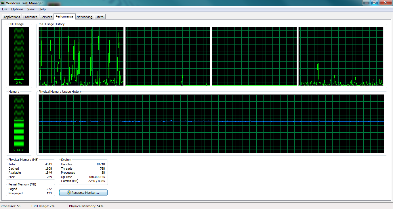

    Is anyone else having slowdowns and crashes on the Net? Is anyone else having more and more bad experiences surfing?
    I am. And I'm getting a bit pissed. I'm using a recent machine, Windows 7 64-bit, I think I have an OCZ ModX-Stream 600 PSU, decent security patches, and IE 9. My video card is the PCI-Express (x16) Gigabyte 6770 passive-cooled (GIANT fins, but I put a fan on it anyway). I run IE 9. (Firefox is version 24.0, but I never really use it anymore.)
    Are webmasters driving the updates? Is Adobe? Is there any way to reduce crashes or bad experiences (give a later browser ID string, stop Java, whatever)?
    Any help would be appreciated. (And BTW, please put answers.com into your hosts file. It has the most ads and is the least responsive and most buggy site I've ever seen.)
    Please let me know any tricks you all might have. Thanks!

    IE 9 IS the problem man upgrade it to 11 (it's available for a few months now) And firefox 24 is still better than IE9 by far but upgrade it to 32.0.1 (current version) then you won't shouldn't have any problems with web browsing. I had 9 and it always crashed on me, until 10 and 11, please upgrade the browser, it's at least 3 years old!

      Yes, IE11 is okay if you insist to stick with the Microsoft browser. Or you can upgrade to the latest Firefox 32.0.
      And if you're annoyed by ads, you don't need to block an entire site with your hosts file - Adblock Plus is your friend. And yes it's available for IE too.

                                Check Event Viewer for possible clues. The OP was too ambiguous for any kind of diagnosis. One suspect is a bad cable modem, possibly due to (drumroll)... BAD CAPS. Or power supply to the cable modem/wireless router. For example of it requires 12 VDC and it's only getting 10.5 VDC, it's going to be intermittent. Reinstalling the O/S is not going to fix that.
                                Google Updater is POS and frequently breaks, as does Adobe Updater, Java errors, etc... Event Viewer might give you a clue. Had one machine with intermittent performance issues because the never-used optical drive (that would be CD/DVD drive to you) was in the process of failing. Disconnect the cable and problem disappeared. Reinstalling the O/S wouldn't have fixed that one either.
                                Windows Defender scans in the background and doesn't tell you. I hate the POS. Scheduling issue, and Reinstalling the O/S isn't going to fix that either. Hard drive errors. I think chkdsk runs every time you install the O/S, so in that situation reinstalling the O/S would "fix it, but that that's the retard's route around the block and the more you emulate the behaviors of the retarded, the greater the chance that you'll turn into one, so I'd advise against this method.
                                Bad power supply and heat will both cause data corruption, which could include system files, and while reinstalling the O/S might fix the problem at first, it would just be a matter of time before the machine went wrong again, so again a retarded solution to a problem that's really just a symptom.
