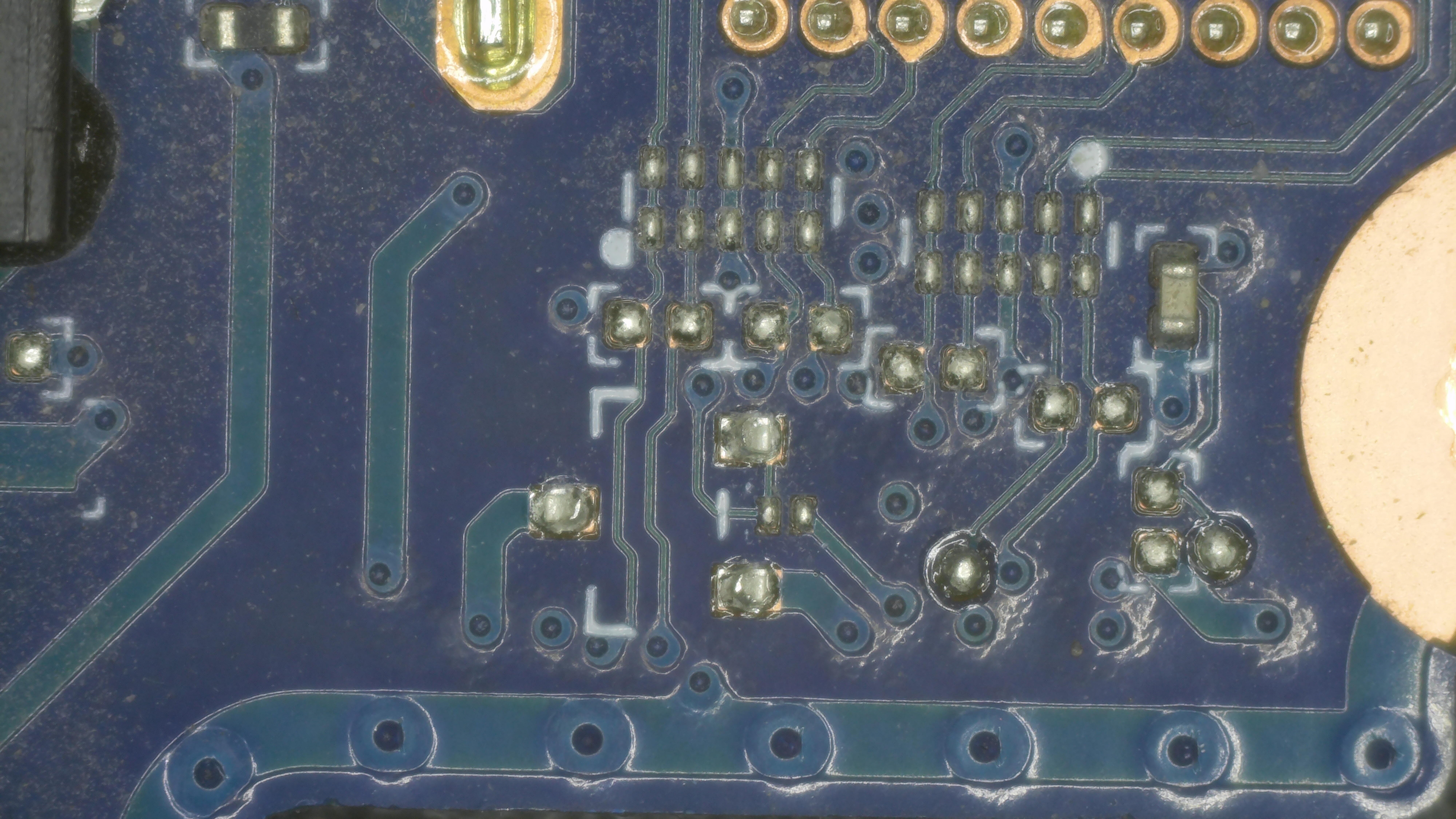

    Hi, hope you have solved your issue ? I have the same laptop/mainboard and I am desperate for high resolution pictures of the mainboard front & back because I have a loose 3 PIN SMD component (probably voltage regulator) and looking for where it is missing. Could you provide me with some pictures please ? Big thanks !

      Yes, I already have the board, still working with the crashes issue,
      Please take a photo from your board where the 3 pin smd is located and I will tray to find out which component is it.

        That's the issue .. I have the part but not the location on the PCB ! The part is a 3 PIN SMD with reference X32A. I added a picture.
        Click image for larger version  Name:	2021_1105_000118_002.jpg Views:	0 Size:	773.3 KB ID:	3219607

            [QUOTE=tony.knors@live.com;n3219606]That's the issue .. I have the part but not the location on the PCB ! The part is a 3 PIN SMD with reference X32A. I added a picture./QUOTE]
            It seems a little mosfet, but could be a bipolar transistor or a double diode. I will tray to locate it in the board and send you a photo of the area it is located.

              Here you have a photo where the 3 pins smd is located. Seems that it is the LID sensor chip, so the laptop has to work without it.
              The central pin is connected to gnd, and one of the other is feed wirh 3,3 volts.
              Hope it helps you.

                  Thank you so much but are you sure we have the same mainboard as I cannot seem to locate this part of the PCB ?
                  Click image for larger version  Name:	IMG_1670.jpg Views:	54 Size:	3.80 MB ID:	3220058
                    Seems to be the same board, can not see the revision in your board. Look near the hdmi connector, it is located very close to it.

                      Hi Francisco ! Really appreciate your efforts to help me out ! If you need my help, let me know ! This is a picture of the area around the HDMI connector. The board revision is : MODEL G7EL - DAG7ELMBAC0 REV: C
                      Click image for larger version  Name:	2024_0221_092036_001.jpg Views:	47 Size:	2.73 MB ID:	3220494

                        UPDATE !!!! I found it ! It was on the other side of the PCB and as it was still mounted in the laptop I didn't see it ! THANK YOU SO MUCH Francisco !!!!!
                        Click image for larger version  Name:	2024_0221_140721_008.jpg Views:	43 Size:	2.32 MB ID:	3220691
