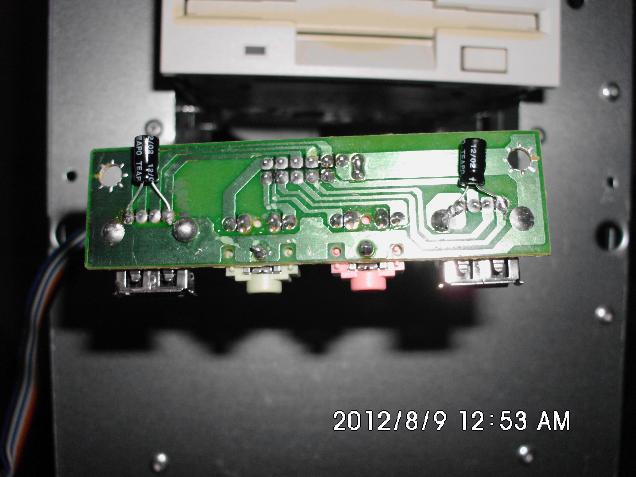

              • tmiha71
                • Apr 2010
                • 130
                Re: CheapMemory card readers programmed to fail?
                What I sometimes do (see pic), and USB-anything during power-on, or power-off is a big NO-NO ( It is 47uF/10V 4x7mm ). Same thing with readers, only it's 100uf/16V 6.3x7mm as near to chip as possible (usualy on solder points of cable on PCB, no special precautions - allways connected)...
                Seems working OK (did not checked with any instrument), can't remember of any USB disconnects...
                • Kiriakos GR
                  Banned
                  • May 2012
                  • 940
                  • Greece
                  The black one in the picture above it costs some real money, but it is faster.
                  But by looking just the reader its like looking the half picture, the condition of the USB plug is the other half.
                  Especially for flash drives, wiring and mounting must be internal (in the case),
                  and special care to be given for protection against vibrations.

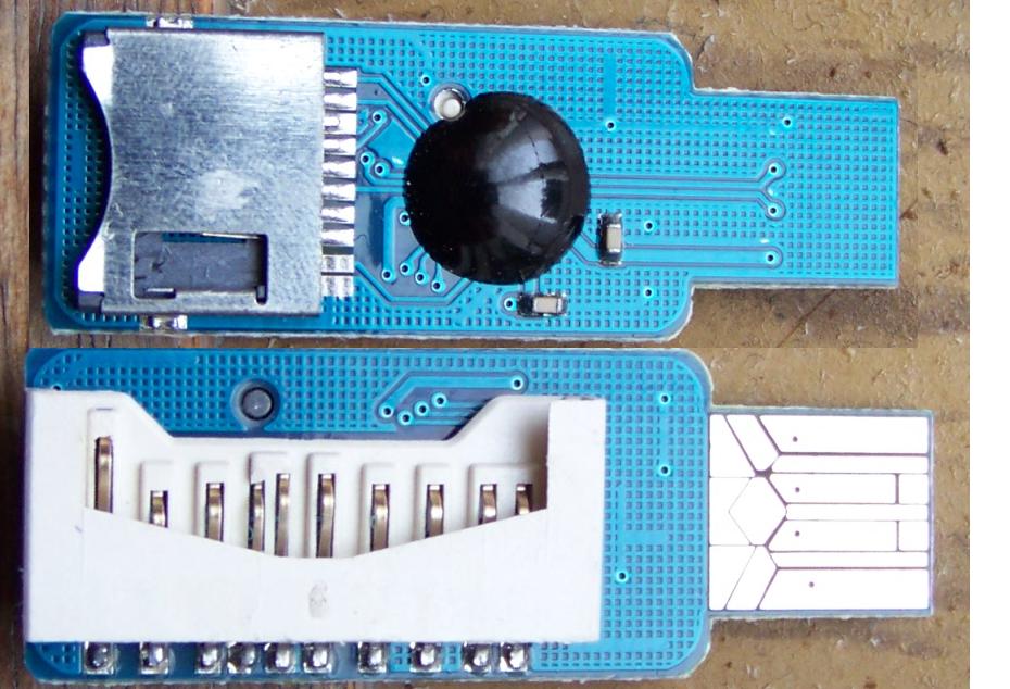

                    Just in case anyone has any problems with the word cheap I thought I would post a picture showing ALL the parts.
                    Perhaps I should be asking the ebay sellers how long they should last?
                    These are in the UK not China!!
                        Pretty impressive. One chip, two capacitors, and some connectors... hard to get cheaper than that. I'll bet the number one reason for failure is ESD. Looks like it has no protection against any of that.
                        • ben7
                          Capaholic
                          • Jan 2011
                          • 4059
                          I second that! That was the first thought that came to my mind when I saw that picture

                              There are ESD suppressing chips, you would have to solder one in, which would mean hacking the traces and stuff on the PCB. But I am not familiar with these chips so I don't know how well they will work.

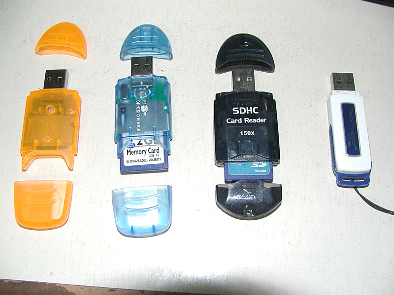

                                All such cheapo devices I tested stopped working after an usually short time.
                                For the record, I share them here:
                                Last one lasted a little longer (a few months) and is still somehow working, however spitting read errors in dmesg more and more often.
