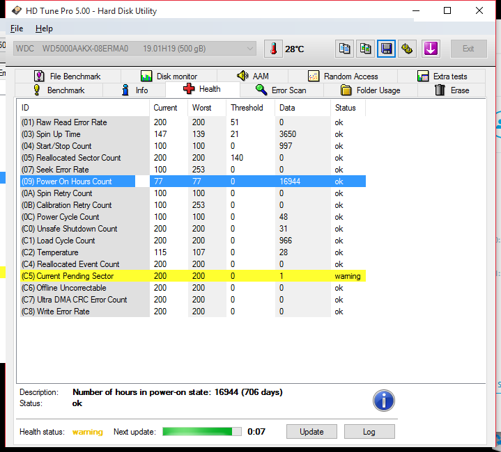

                    #49
                    HDD Hall of Fail
                    This is a new thread im creating for people to post their HDD failures or drives that are starting to fail..
                    Il start..
                    Just today my WD blue 500GB drive has started to fail , it has served me well for around 2 years of constant usage.
                    ps. It would be nice if you could post pictures of SMART data or tell a little description of how it died
                    • SteveNielsen
                      Retired Tech
                      • Jun 2012
                      • 2327
                      #50
                      Re: HDD Hall of Fail
                      You could also post a report file, don't most SMART monitors have that capability? Plus we'd see all the data available, not just one window of it.
