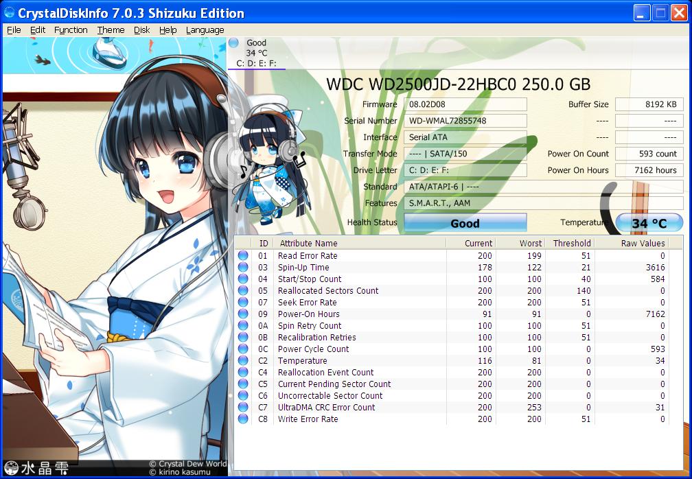

                I recently tried similar with a WD2500JD
                Went from:
                CLACK----CLACK----CLACK----CLACK
                To:
                clack-clack-clack-clack-clack-clack
                Used Deoxit Red (on overnight) then Deoxit Gold
                Didn't think of tinning though - hmmm, has joined list of stuff to try

                  Oh, I have one of those as well. This was one of the WD HDDs on which cleaning the contacts did *not* work (HDD still clicked the same afterwards.)
                  So tinning the pads will by no means revive every bad WD HDD back. But it's one less thing to fail (and still worth a shot if nothing else works), so that's why I do it.

                    #129
                    Re: The hard drive failure thread
                    Originally posted by momaka
                    clean the head amp PCB pads, and often even tin them with Leaded solder
                    To remove the Deoxit, I cleaned the pads with a typist's eraser pencil (from back in the day), then tinned them with 60/40, finally removing excess solder with Chemtools wick
                    Wasn't that optimistic, but pleasantly surprised to hear Bzzzt heads loading noise instead of clack-clack... with drive being detected by BIOS
                    Then went through WD Data Lifeguard Full Scan, Full Erase and Full Scan again without missing a beat
                    Finally put it in a HP dc7800 to use instead of a bigger drive, and left it installing Win7
                    Came back to the screen for entering user & machine names and after entering something, CLACK---zhzhzh---CLACK---zhzhzh... instead of cleanly coming out of sleep mode
                    Damn thing - <7200 hours on it

                      #130
                      Well, at least it "lived" for a bit longer. Perhaps the full scan + full erase was too much for it? IIRC, those particular drives tend to run hot - especially in an enclosure. Not sure if that plays a part or not.
                      Also, it's interesting to note that, based on your description, the drive is still trying to power on / calibrate but fails somewhere halfway there? On that note, I wonder if putting it in different orientation will do anything. Just makes me wonder if the brief amount of time you got it working was a coincidence or really a result of cleaning the pads. Could be that the HDD was just intermittent before too??

                        #131
                        I had put it aside with a note saying undependable
                        Anyway, while walking dog, I thought about differences between my testing setup and the dc7800 - namely IDE vs AHCI
                        So I changed the dc7800 to IDE and did another full scan, which came up clean
                        Then I continued to set up triple boot - XP, Win7 & MXlinux - which all went well, although I was nearby, not letting it go to sleep
                        I did Google "WD2500JD sleep problems" and "WD2500JD ahci problems" in case of a firmware update, without finding anything
                        Does pic look like a drive with problems?

                          #132
                          Not at all. Looks pretty clean, actually.
                          Only "unclean" value I see is Ultra DMA CRC Error Count, which typically results from a bad SATA/IDE cable or bad PCB contacts with the headstack / head amps. But since bad SATA cable is unlikely to be the issue and since you also already fixed (tinned) the PCB contacts, most likely any value left in the UDMA CRC Error Count is from before, when the drive had the dirty/tarnished PCB contacts. IIRC, UDMA CRC Error Count can never be reset, even after zero filling. So probably nothing to worry about.... but do watch it. If the UDMA CRC Error Count keeps going up, the drive likely still has problems with the PCB contacts or possibly the headstack itself.
