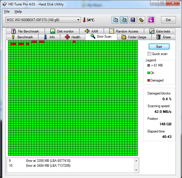

            Re: The hard drive failure thread
            Western Digital
            WD1600BEKT
            18 Aug 2009 (under warranty until 2014, hooray)
            1420 POH (yes, 1,420)
            SMART reads "Pending sectors", system gets stuck in a reboot loop. Error scan shows this-
            I was able to copy off the data, except for a few small files.

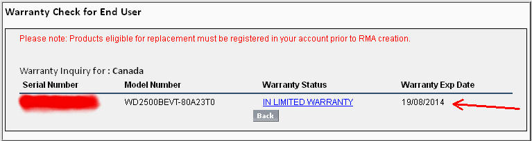

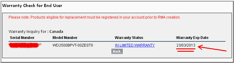

                                    Western Digital tries to pull a fast one on me:
                                    The RMA'd drive:
                                    And the replacement:

                                      Isn't it standard practice that all replacement drives (refurbished of course) only have 90 days warranty or such?
                                      -David VanHorn
                                      • c_hegge
                                        • Sep 2009
                                        • 5219
                                        Nope. The replacement drive should be covered until the original warranty is up. WD
