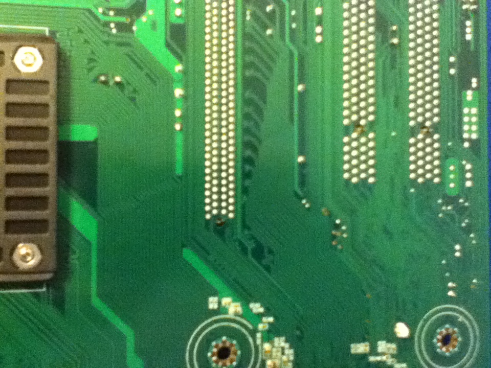

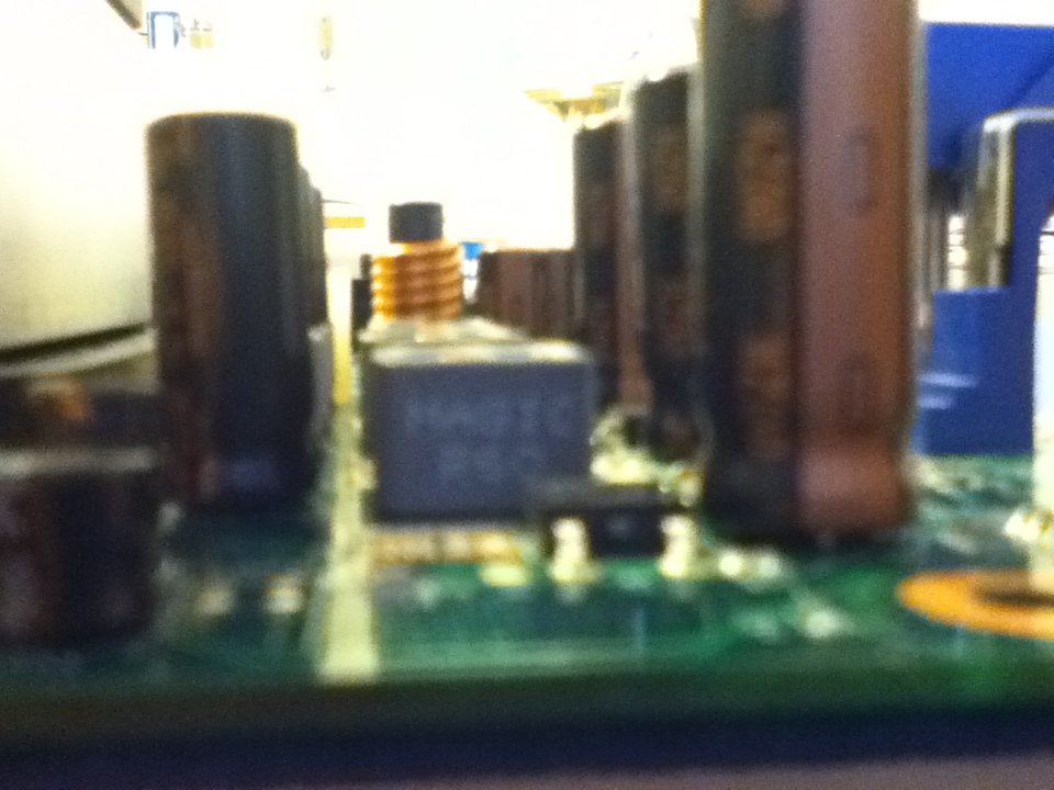

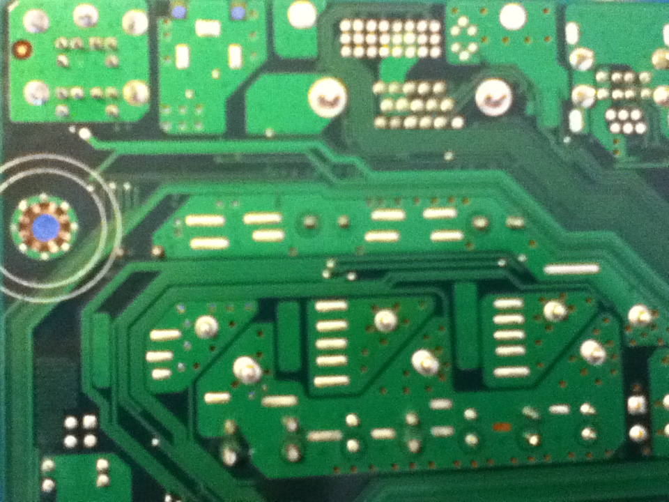

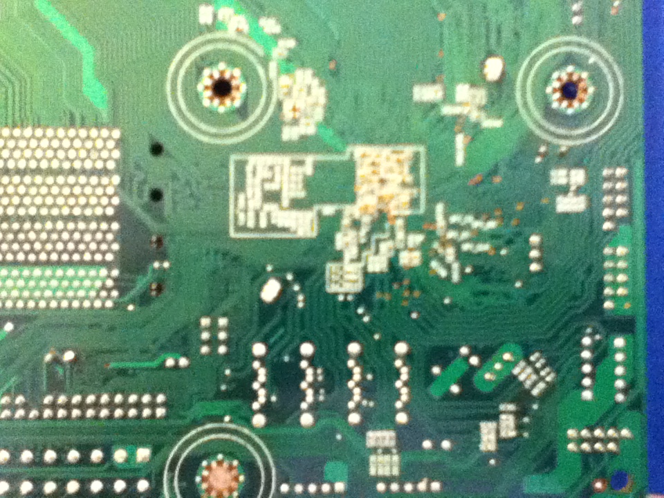

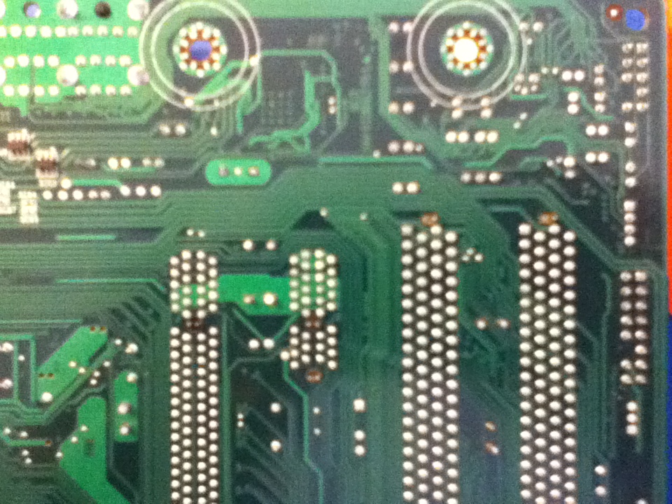

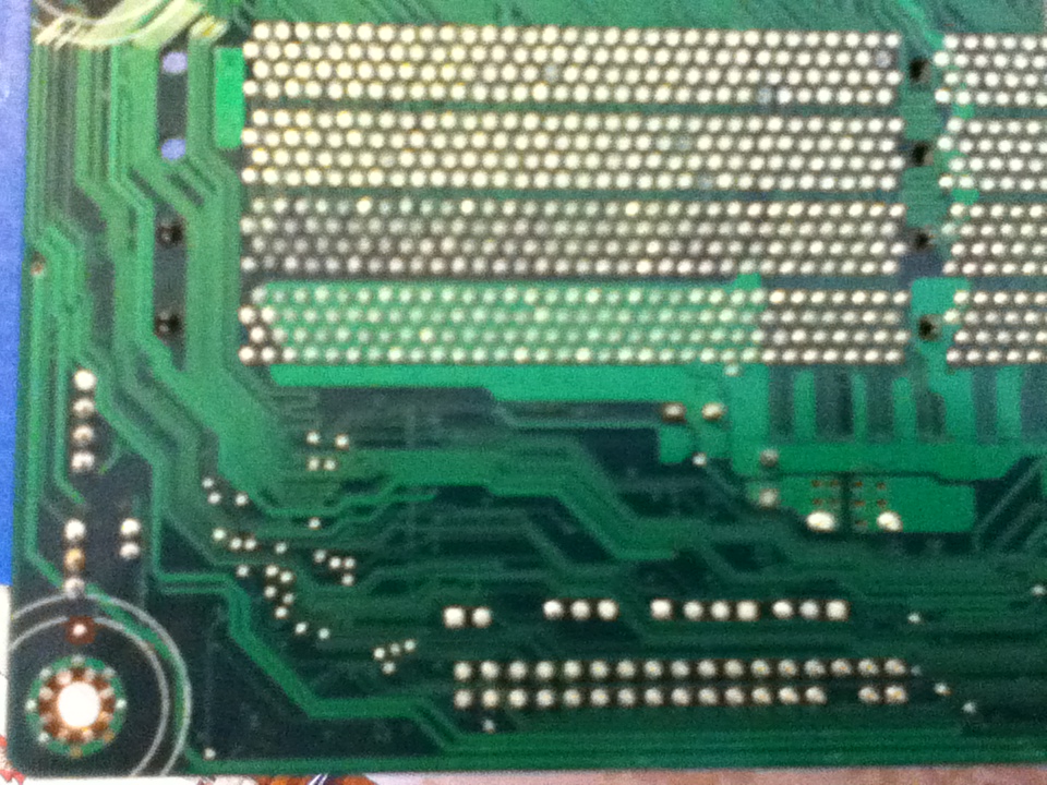

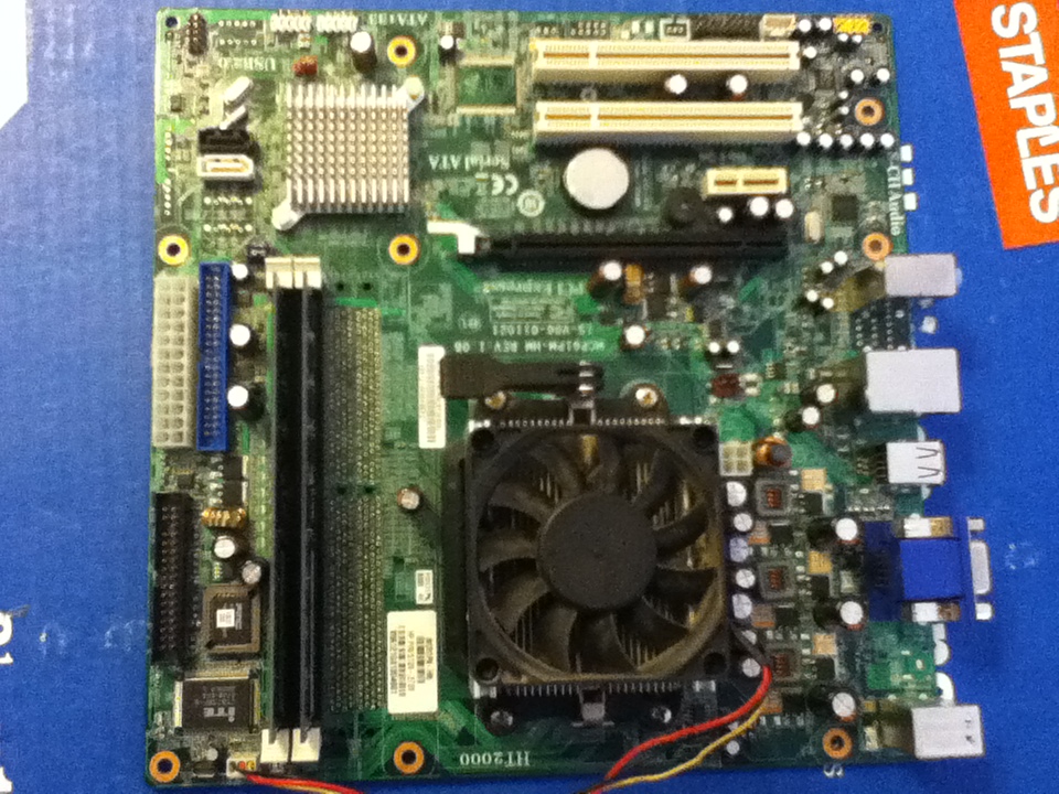

    I have recapped my MOBO and I now have new problems. Before I was able to POST and the computer would crash but when it was running it was running at the correct speed. Now after replacing all the caps that came in the pack of 24 (swollen and not swollen) my computer is so slow. I don't just mean 286 slow I mean real slow. I thought it wasn't working but it just took for ever to load. I went through and reloaded windows and wiped the drive. This has taken a week to get it done at this speed. But now I finally have it booting up to Windows Vista. There must be some problem. I don't know if I did something wrong or what. Any ideas? My computer is an Athlon 64 with a ECS (Elitegroup) MCP61PM-HM motherboard Compaq Presario.

      Hi can you get this MCP61PM-HM into the title.
      What make caps did you use - where from?
      Can we have a pic of the motherboard (max resolution 2000x2000 and 2MB) using the manage attachments button, which is found by clicking "go advanced" under quick reply.

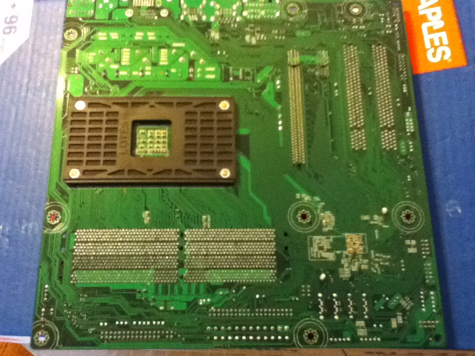

        Attached are pictures from my Ipod Touch, I know it is real grainy but I lost my good camera. I pulled the battery for the BIOS when I soldered so it should be reset. I also pulled the memory, CPU and heatsink before soldering. I ran the computer with no cards and used the onboard video. I did remove old and apply new thearmal wax to the CPU and heatsink. I got rid of all my spare parts so I really dont have anything to swap power supplies, CPUs or Memory sticks. The video card I used prior to the failure had the capacitors go and the vented. After pulling the card I examined the MOBO and found the swollen ones on there as well. Do you think investing in a new Power supply is a good idea? Funds are low.

            Its getting late over here - couple of things- did memory show in my computer and in the bios. As koda says try one stick at a time if they are not a matched pair try changing slots.
            If its not a solid check that the heating compound has not spread over
            and down the edge of the cpu.
            Did you loose any drivers when you wiped disks.
            Check the bios carefully for wht speed things are running at.
            Anthing show up as odd in device manager.
            As your not really running anything it probably wont make any difference
            but have you set up a windows cache.
            How much ram is in there.

              On the PSU
              If you don't have a good known PSU at the very least open up the unit you're using and check visually for bloating caps. Do a voltage test if you know how, if you don't know just search google, lots of info how to do it, also check voltages during load and write them down and post them here (when plugged in and running on the motherboard). Those are simple tests and easy to do if you are careful, if you dont feel up to the task don't do it, just buy or borrow a good PSU.
              Since your graphics card had vented caps my money are on the PSU going/being bad.
              Also as selldoor said if you have multiple sticks of ram try using one at a time in different slots and see if that improves the situation.
              As for the BIOS, I have seen mobos holding BIOS settings for quite some time without battery so just try loading the BIOS default settings, it will only take you a minute.
              One more thing to check, that heatsink in the lower right corner, see if it gets too hot to hold a finger on it.
              If you have a POST/PC Diagnostics card do a test with it and see what comes up. If you don't have one I recommend you get one from ebay. Costs a few bucks but can be very useful sometimes.
              Also do visual examination on the whole board to see if you damaged some traces.
              Last thing to do, download a windows/linux live cd and boot windows from it without your hard drive being connected to the motherboard. Swap of cables for the hard drive and the cd rom drive is also preferred.
              That's all I can think of at the moment, do these tests and post the results and we'll move on from there.
              Also don't forget to plug in the 4pin connector next to the CPU heatsink, it's a rookie mistake that anyone can make and can cause symptoms such as yours.

                I owe you!! I have a new computer again!! I'm so happy!! I reset the BIOS and pulled the memory sticks out and put them in one at a time in each bank. Now they are both in and the computer is fast again. Thanks so much!! So I either didn't have the memory sticks seated or the Bios needed to be reset. Either way it works now!!
