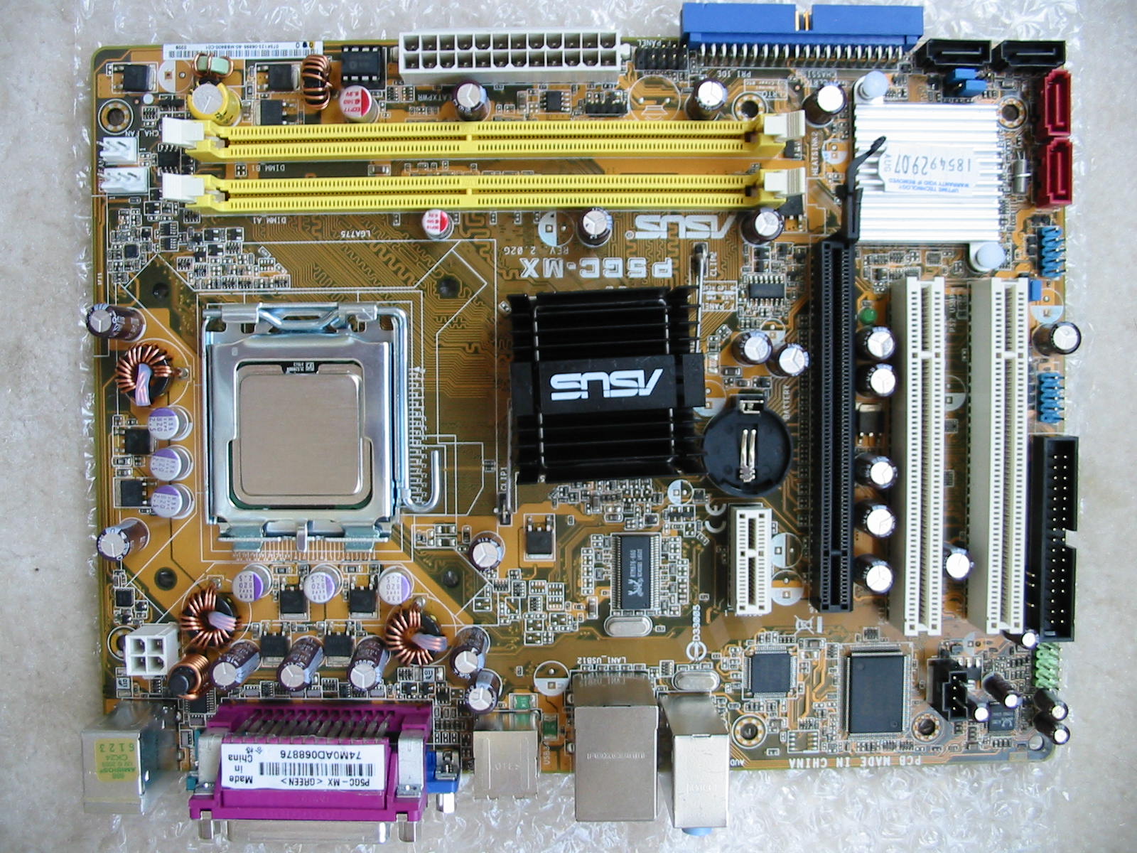

    Here’s another motherboard that needed a full recap: an ASUS P5GC-MX.
    This one was gifted to me some years ago by user Pentium 4, along with a few other goodies. It actually came in working order with no bulging or leaking caps. However, I noted there were United Chemicon KZG caps everywhere on the motherboard. The CPU VRM output (CPU V_core) was the only exception: it had only 2x KZG. The rest was 6x UCC TMV 4V 680 uF caps… which aren’t any good news either.
    So here is what the motherboard looked like with its original caps:

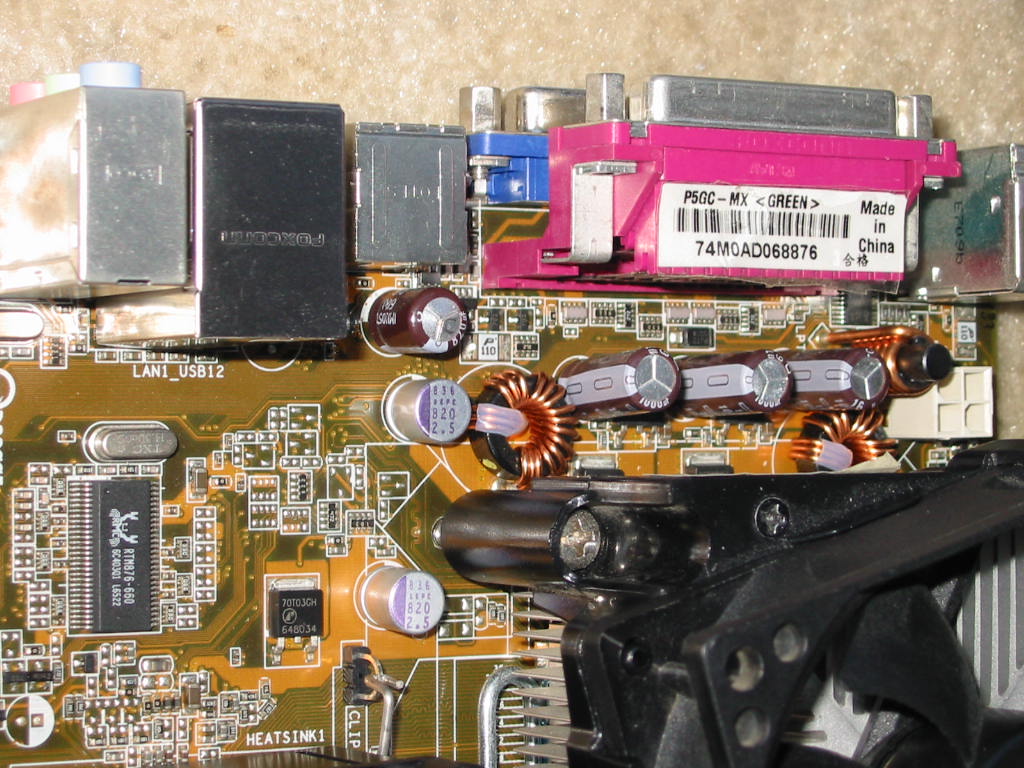

    CPU VRM area up close…
    https://www.badcaps.net/forum/attach...1&d=1611813246
    And the rest of the lower half of the motherboard:

    I didn’t have any immediate plans for this motherboard at the time when I got it, but it was one of the best motherboards I had back then, so I started thinking what kind of system I should build with it. In the meantime, I decided to at least recap the CPU VRM output, since I remembered seeing threads here on badcaps.net that showed UCC TMV caps going bad. Moreover, I was told the motherboard had several 10k’s worth of power-on hours. So that weighted in even further on the decision to do a preemptive CPU VRM recap, rather than wait for caps to start failing on their own.
    Because these Chemicon TMV caps are right along the CPU socket (and in the path of hot air from the CPU heatsink), I thought it would be best to use polymers here. Also, since buck-regulated circuits put more stress on caps, I went after a few of the KZG on the RAM V_DIMM (RAM V_dd) as well.
    And speaking of voltage rails, it wouldn’t make sense to talk about them without showing a cap diagram. So here is that:
    Since no socket 775 CPU runs at over 1.4V on its core, 2.5V polymers on the CPU VRM output (CPU V_core, rail #2) should be fine. For these, I used 6x Sanyo SEPC 2.5V, 820 uF – a slight (but welcome, I’m sure) boost in capacity over the original 680 uF TMV. Meanwhile, the RAM V_dd runs at 1.8V (though some DDR2 RAM could require up to 2.1V), so I figured it’s probably safer to use caps rated for at least 4V there. Unfortunately, I didn’t have any 4V polymers at the time. However, I did have 2x 6.3V, 560 uF Apaq –branded polymers that came from a newer parted ASUS motherboard. So I pulled one 6.3V 820 uF KZG cap from the RAM V_dd rail and then substituted those two Apaq polymers. I then concluded the recap done for the time being, which was this:
