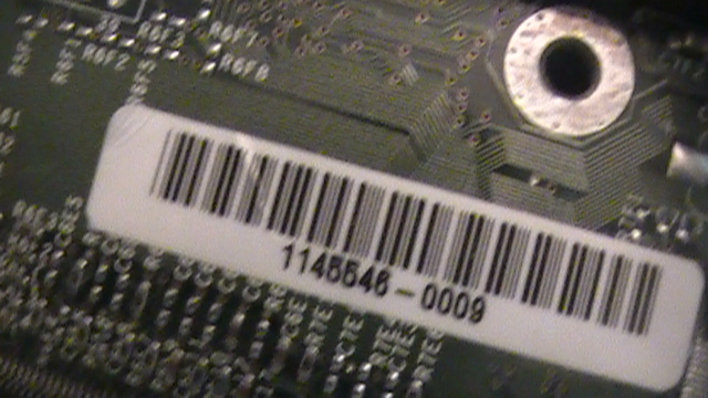

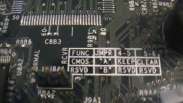

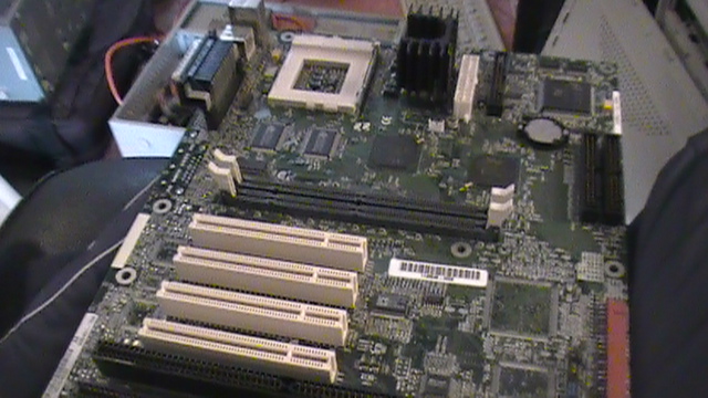

    What motherboard is this?
    Hi all, I thought I would share an old motherboard... this one's a generic Socket 7 ATX board. No branding on it whatsoever. It has diagrams to show you how to set it up properly, but I don't know how to set it up to accept an AMD K6-2 450Mhz, and am questioning whether it can actually support one... Originally had a Pentium MMX 233Mhz in it.
    Pic 1: Overall shot of the board.
    Pic 2: Bar code.
    Pic 3: Other numbers.
    Pics 4-6: Diagrams

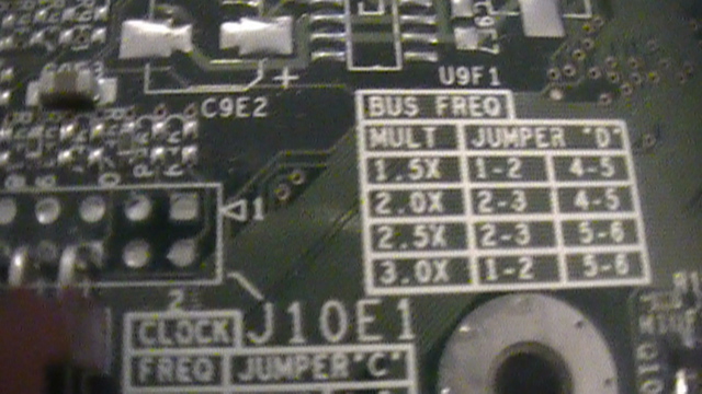

    What does the BIOS say at the POST screen? Specifically the bottom (or two) lines, which contain the chipset and motherboard revision info.
    Also, even if it could run at the 100FSB needed for that CPU, the VRM might not be sufficient.

          It would need a jumper for a 100m clock to support the 450. Does it have a setting for 100m clock, your picture show the multiplier but does not show the clock speeds.

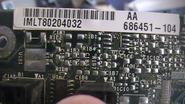

            On further checking, the board was made by intel for hp. The correct part # is the 686451-104 number. Still do not know if it will work with the amd k6.

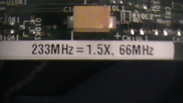

                          It looks like that board has the jumper for the frequency removed, so it only supports 66 Mhz.
                          The multiplier also shows 1.5x to 3.x but on some Super7 boards, you could set the multimplier to 1.5x and get 3.5x or 4.5x - I had a PC Chips Elpina M577 that did this, if I remember correctly.
                          That board looks like it does a max of 3.0 x 66 Mhz - I'd say don't bother with it.

                              It's an Intel LT430TX board.
                              An "AA" number is a dead give-away that it's an Intel board.
                              No, it's not Super-7. - Has TX chipset.
                              Takes P-90 (non-MMX) to P-233MMX.
                                Odd, this came out of a Micron PC.

                                  You're right, it did have a Pentium MMX 233Mhz. I guess it doesn't support AMD K6-x processors

                                      The model number is LT430TX
                                      The AA number is funky on that sticker. It's normally written like AA686451-104
                                      AA stands for "Altered Assembly" and is more or less a build version number.
                                      If (say) they change MOSFETs it will get a new AA number but the "LT430TX Rev.(whatever)" won't necessarily change.
                                      Sometimes the AA number determines what CPU's or RAM are supported.
                                      Sometimes searching the AA number is a good way to look them up.
